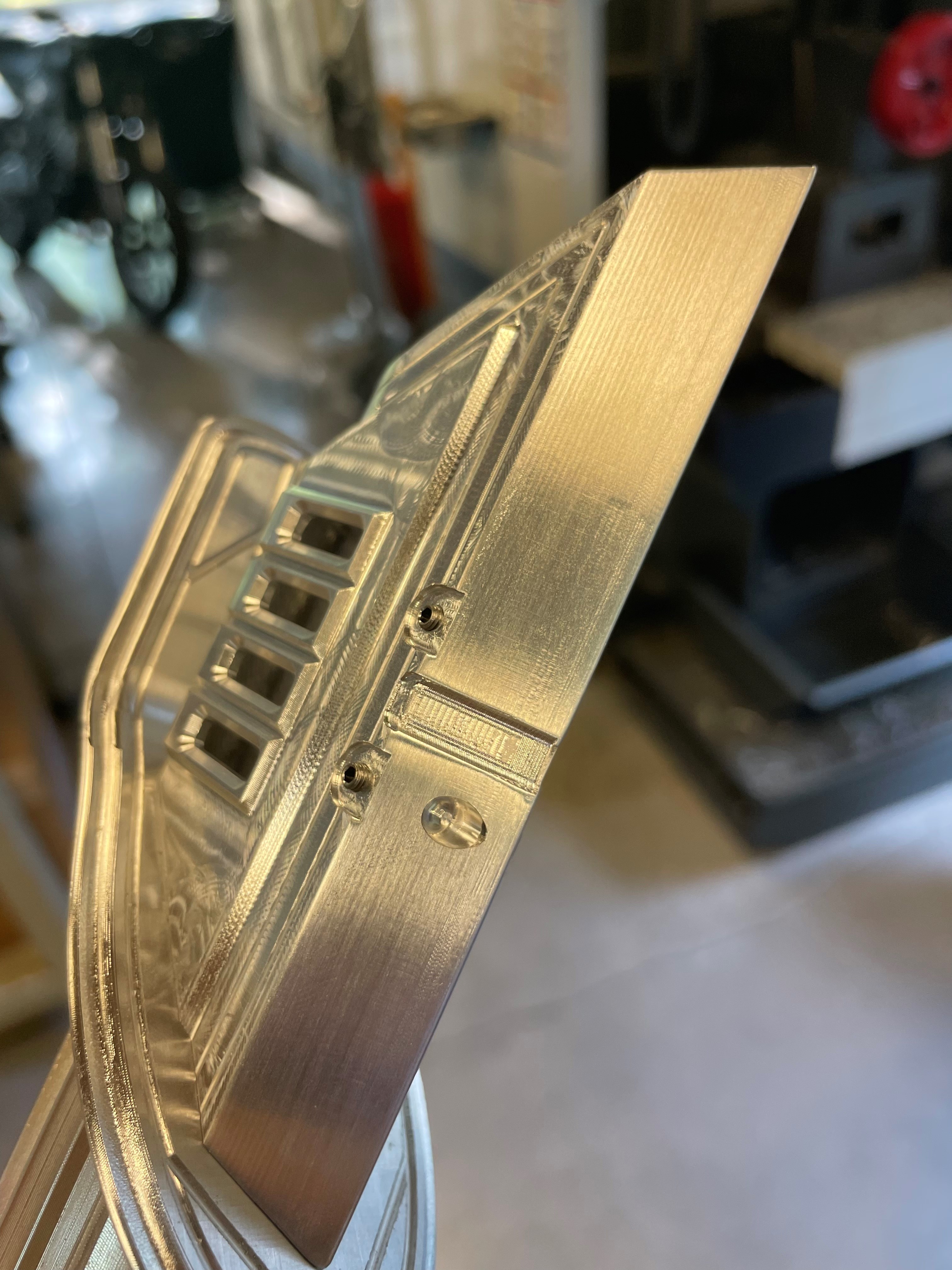

We are adding the final accuracy touches to our hilt as we get closer to anodizing. We have added the last detail needed so that our hilt can be as accurate as possible. We have also just finished some 3d modeling to assist the anodizing shop in getting the two-tone effect. We believe it is going to have enough contrast to be noticeable but not at the expense of accuracy. Here is a picture of the quick change we were able to get programmed and cut in a day with the capabilities of a 5-axis machine.

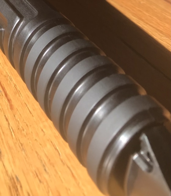

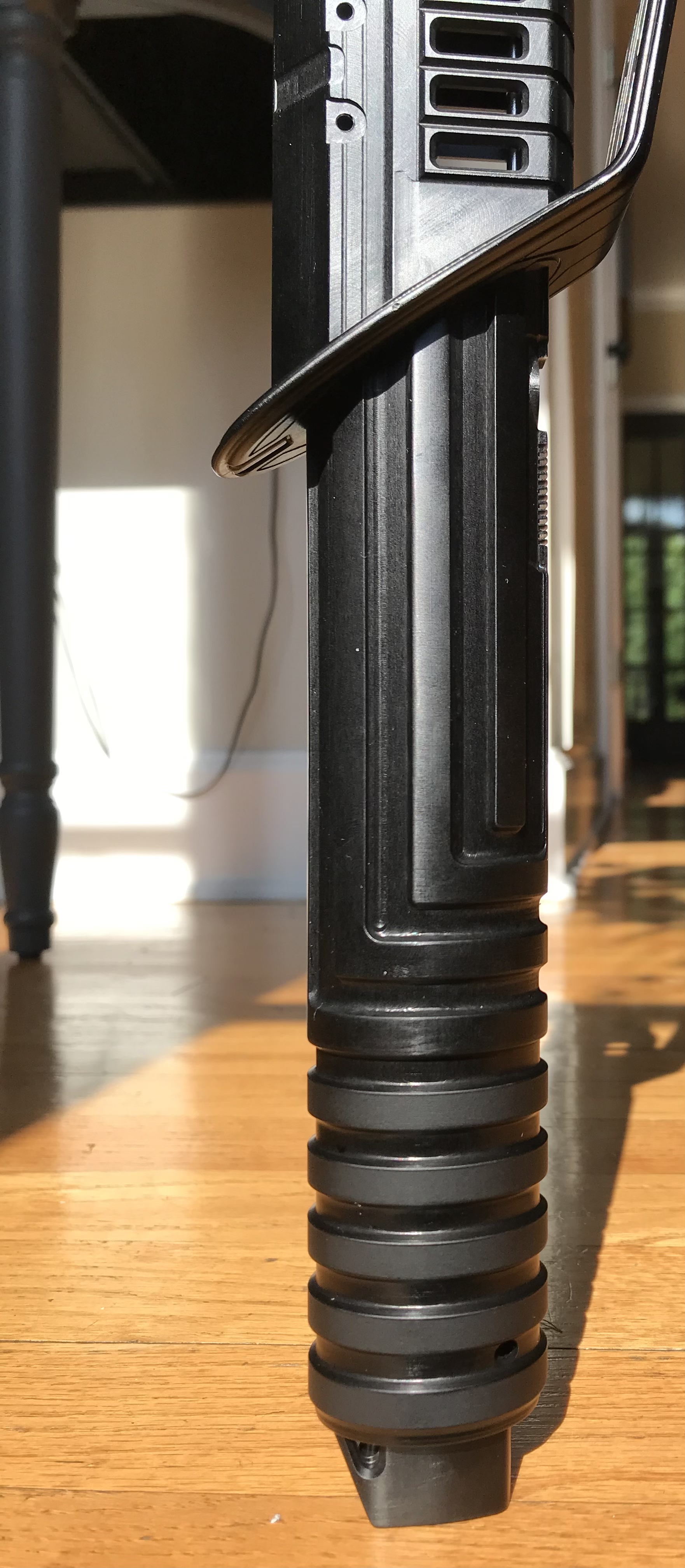

Here are some pictures of the anodized hilt. The overall finish is very good, but there are some minor differences between the 4 pieces of the hilt.
The head & crossguard was lightly etched and anodized black.
The middle grip is just anodized black with no surface prep.
The most interesting piece is the bottom grip. It was aluminum oxide blasted selectively, and anodized aluminum over that.
The bottom grip was a test on the process to get the raised grips to have contrast. We believe that it came out very well. We are going to polish all of the hilts before anodizing, and use a more abrasive aluminum oxide to make the contrast even greater. We’ve done some research and have come to the conclusion that this is the screen used process for the finish.
We would like to hear any and all feedback on the contrast of the bottom grip.
