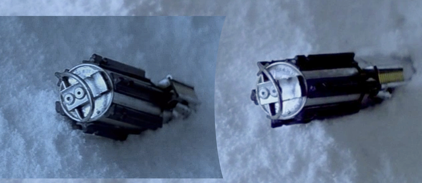

I can’t tell what’s under the hand cut plate. I was thinking maybe I should post up really good images of the wampa cave next to this shot to compare the damage.
The best I can tell… for some reason they needed the endcap to come out and possibly they destroyed the nice holes and had to patch it to reinstall the kobold?
It has crossed my mind that there might be material in the bottom can. However the empty holes in the DV6 tend to make me vote NO there…

this is also good material for checking out the D ring block. The kobold I am banking on being the same. V312 and I found all these pieces of damage and tarnish that match: left of the rivets, bottom edge.... 2 or 3 dings on the sides... for example
To be honest, I think the shrunken kobold is an optical illusion because of the missing rolled lip.
I measured a folmer here at around 38mm in diameter and a real kobold here at 30mm long. I shrunk that MoM image down until the tube was 38mm and the kobold was dead on 30.

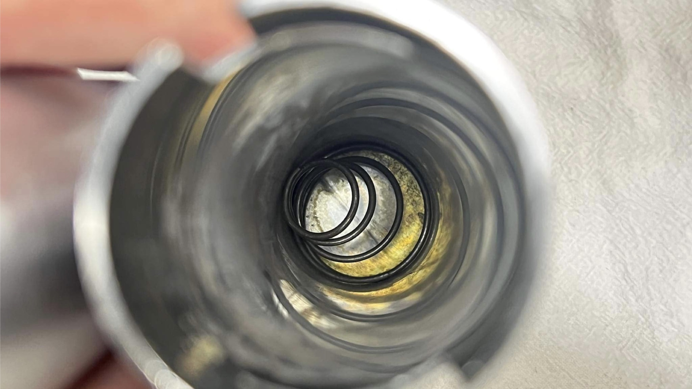

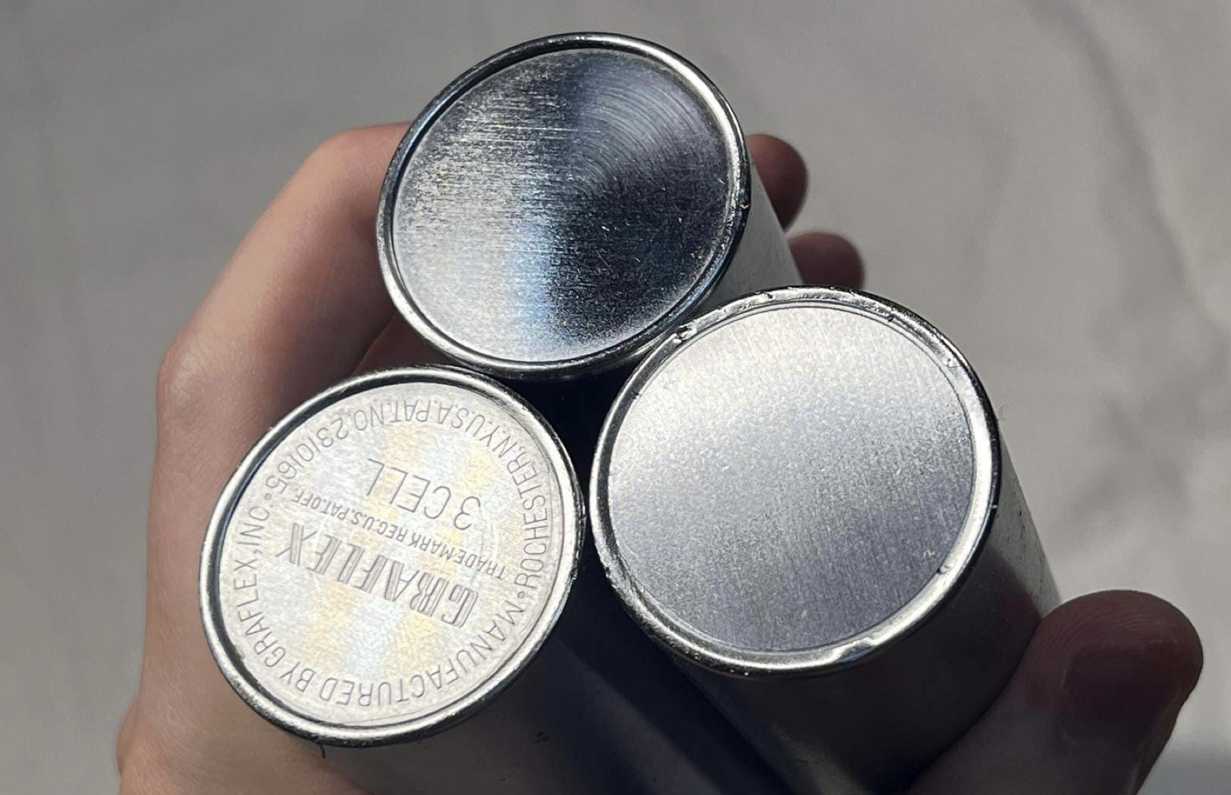

I have never been able to fathom how the wall could be so thin. The Graflex itself is almost 1/16" in thickness and then today.... an idea struck me. Where is the graflex wall thinner? Why... where it's milled for the endcap to sit! I sacrificed a 2 cell bottom to learn about the cross-section myself. Sure enough, I found a lip thinner than T track.
View attachment 1637846View attachment 1637836View attachment 1637837View attachment 1637838View attachment 1637839
At this point the Graflex started to look like the DV6 but I couldn't find the seam-line of the endcap and wall!
so I dropped one of my metal files, handle down in there, and whacked it with a wooden mallet. The cap fell out.
View attachment 1637841View attachment 1637842View attachment 1637843View attachment 1637844
I almost think they put the endcap back in place. Maybe upside down? Maybe the hand-cut "kobold plate" is the original endcap but flipped? I'd love to hear people's thoughts

Actually, what I'm seeing that is interesting is that the lip looks ground down a bit on the ranch saber in a similar way to which your 2-cell looked when you started machining off the lip
Oh my gosh, great eye! Yes… it looks like when I just started to grind the lip. What the heck were they doing?
