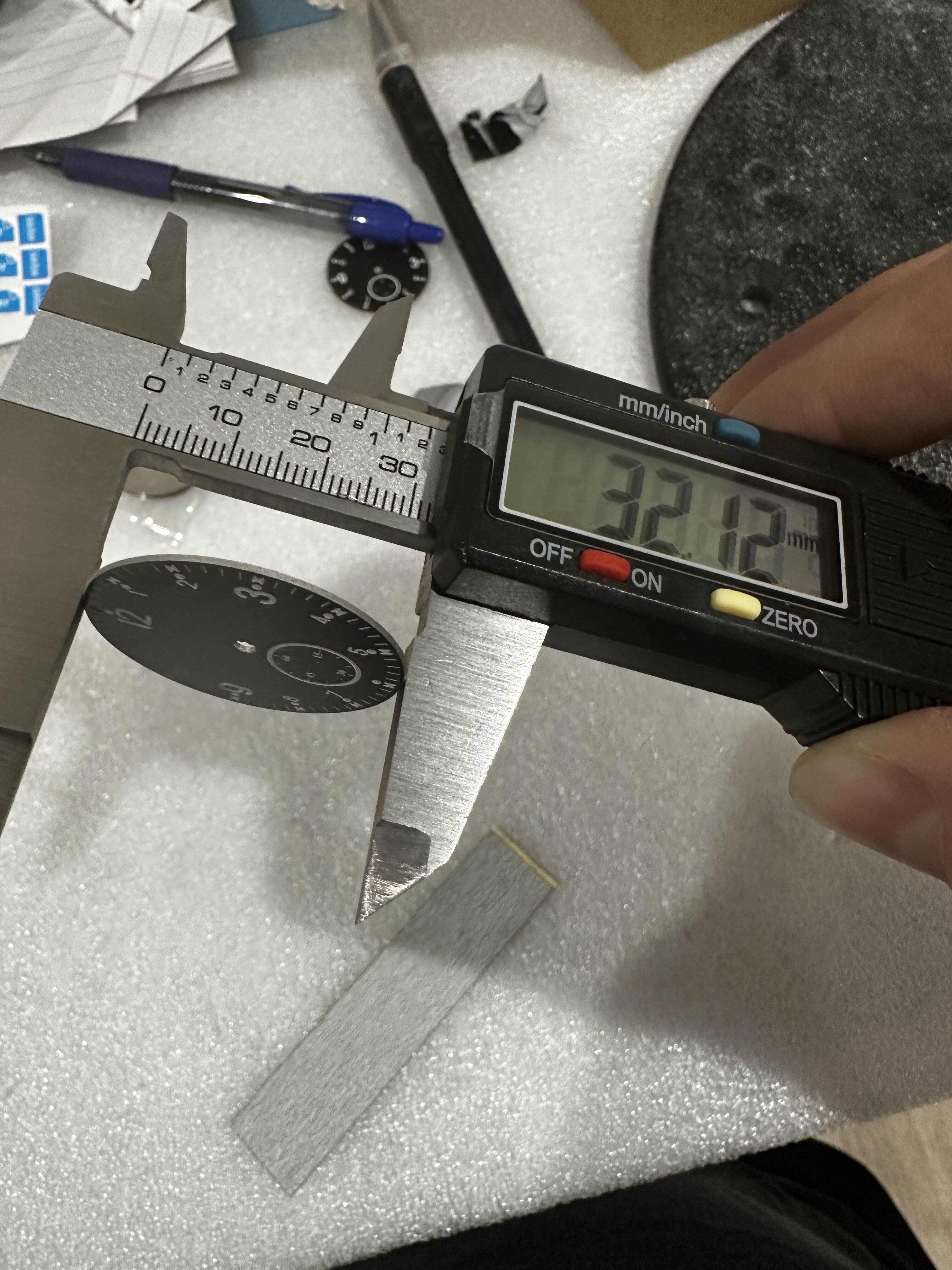

Got the watch dial from my Etsy maker. Looks amazing!! Who would have thought that the laser etching would have been an option. After the laser does it’s thing, it leaves a white layer underneath that looks perfect.
Needs minor adjusting though.
The dial metal is around .66mm, where as the Timex Weekender 38mm dial is .35mm thick - so there’s some sanding that needs to be done there, so that the movement is able poke through as much as it needs to for the hour hand with the AL55 movement.
Also the sub dial is missing a marker lol.

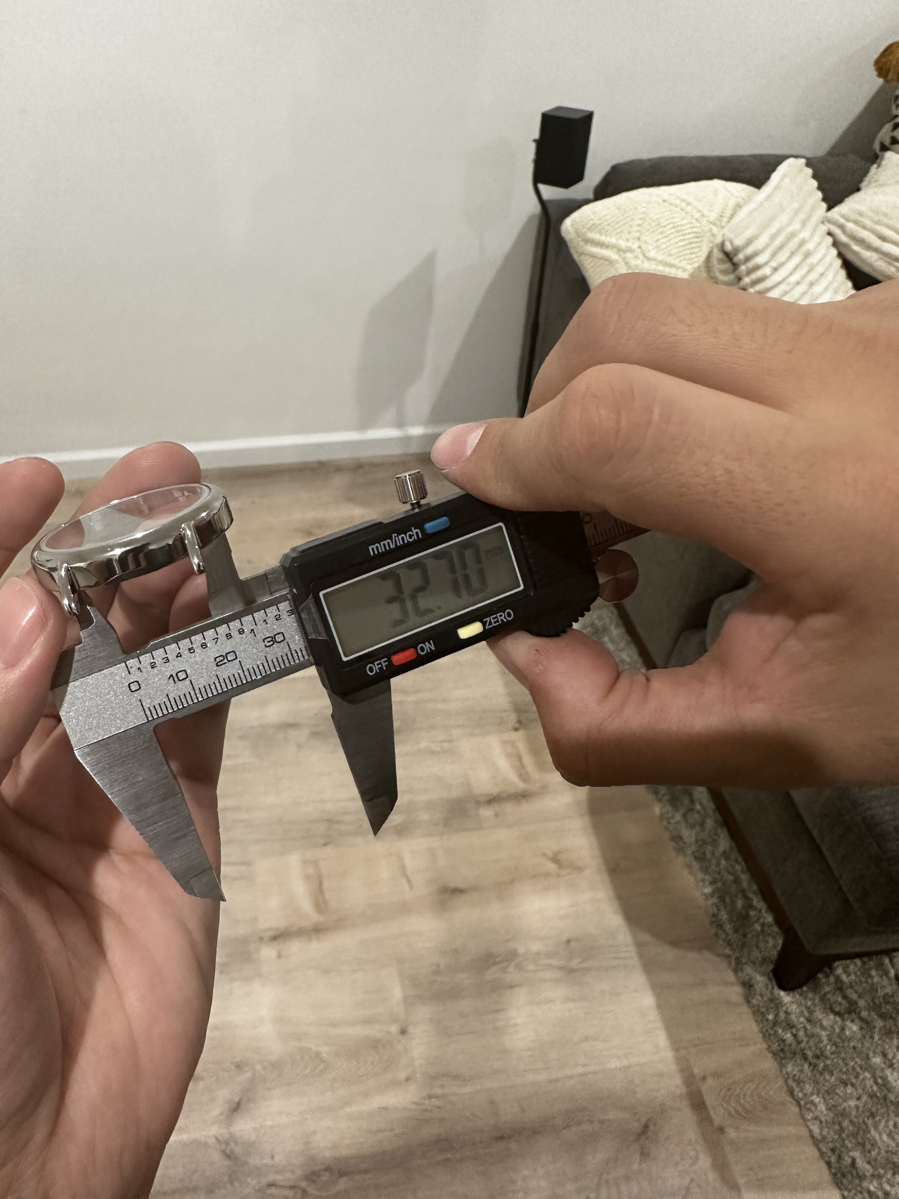

Also the diameter is 32.12mm wide, while the case is 32.70 mm wide (and the original dial is 32.08mm), which allows the dial to move around in the case a little. But I’m sure this can be resolved somehow - I’m just picky lol. Though, with the absence of the original movement inside the Timex (which acted like it’s own movement holder too), this dial from Etsy will move around I’m sure, but I know our minds can come up with a solution.

You should be able to secure the dial to the movement and that should help with it moving around. I think you may also be able to get a shaft extender to give you enough room for the hands to to though instead of sanding.

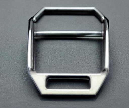

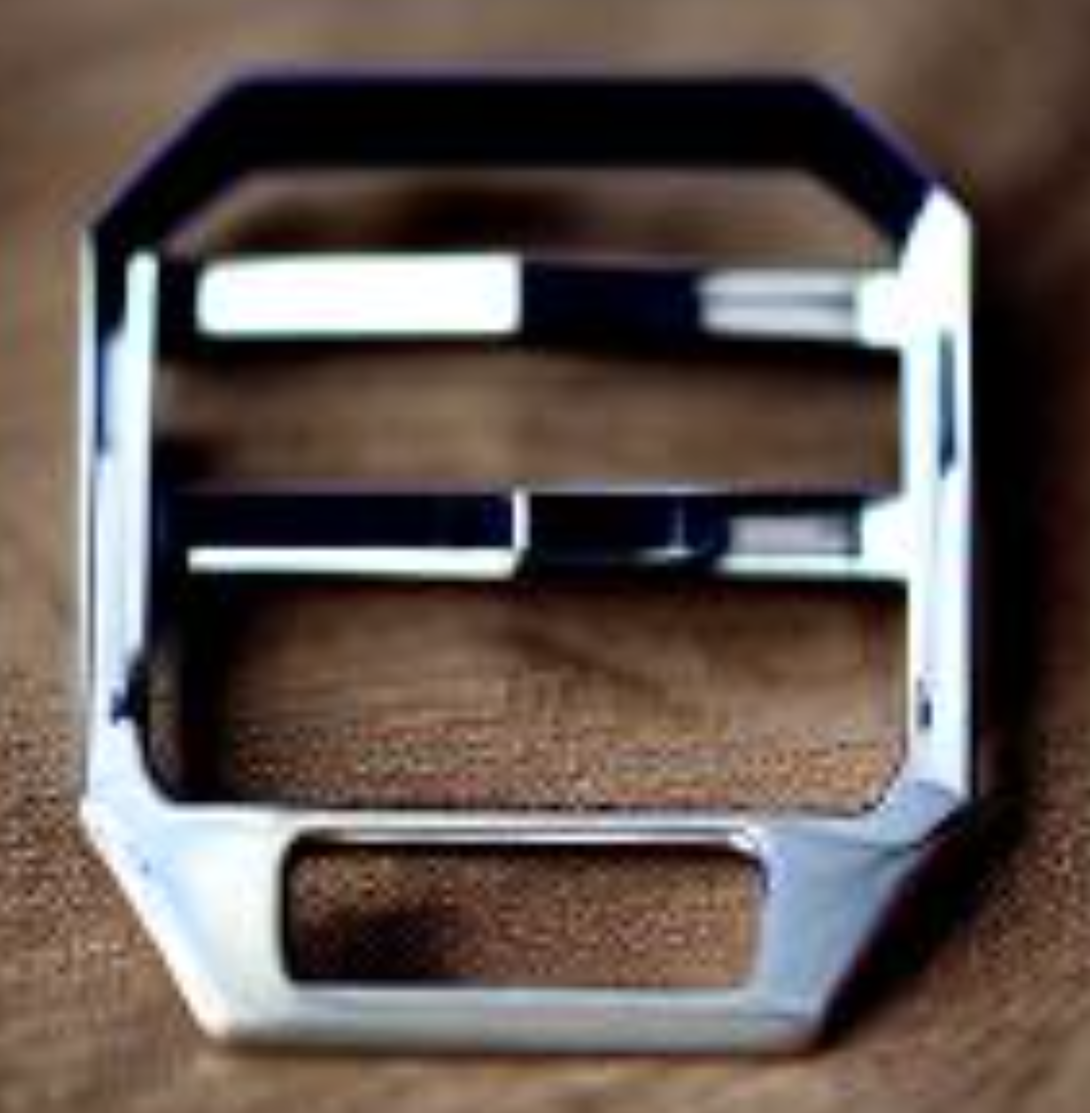

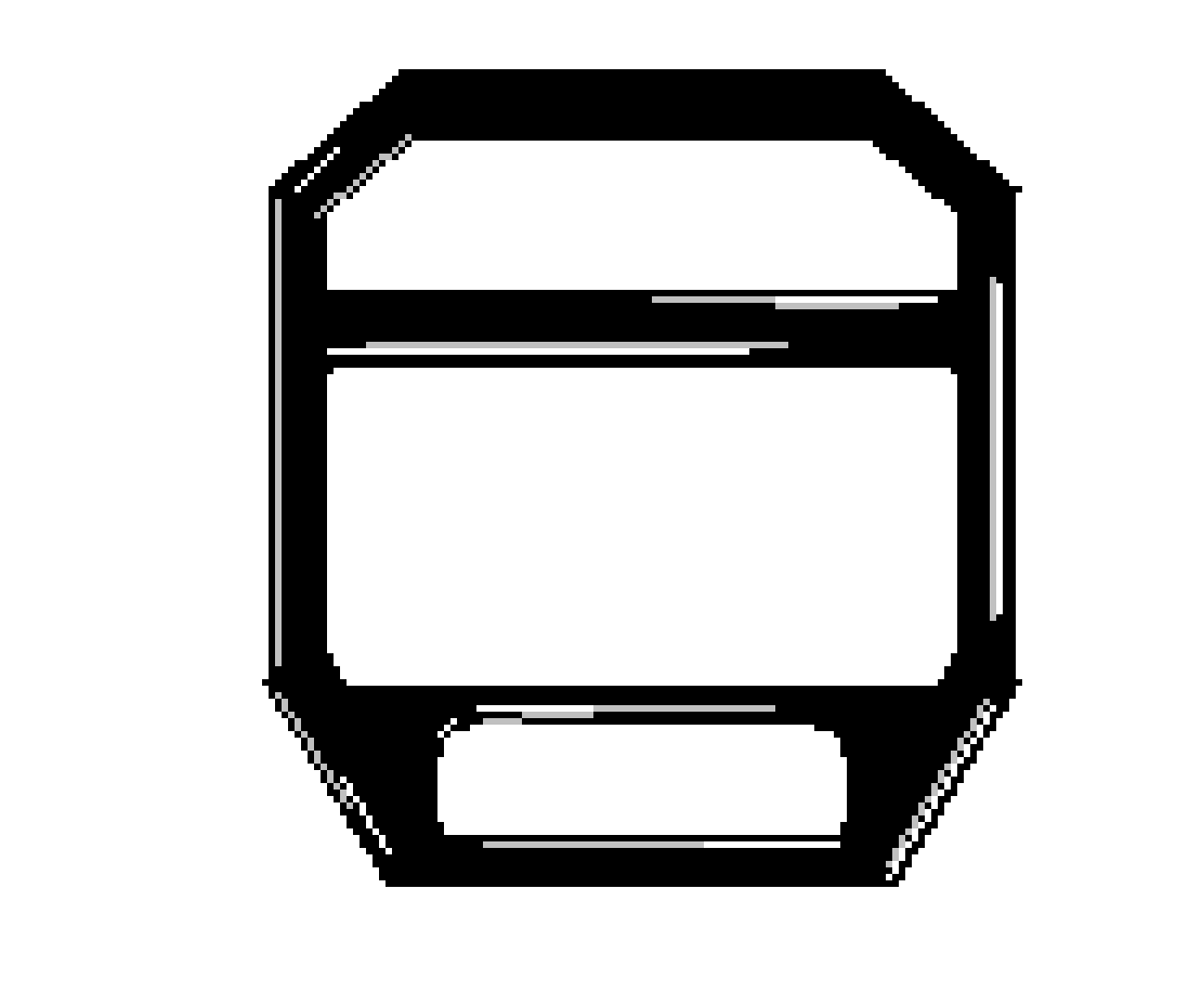

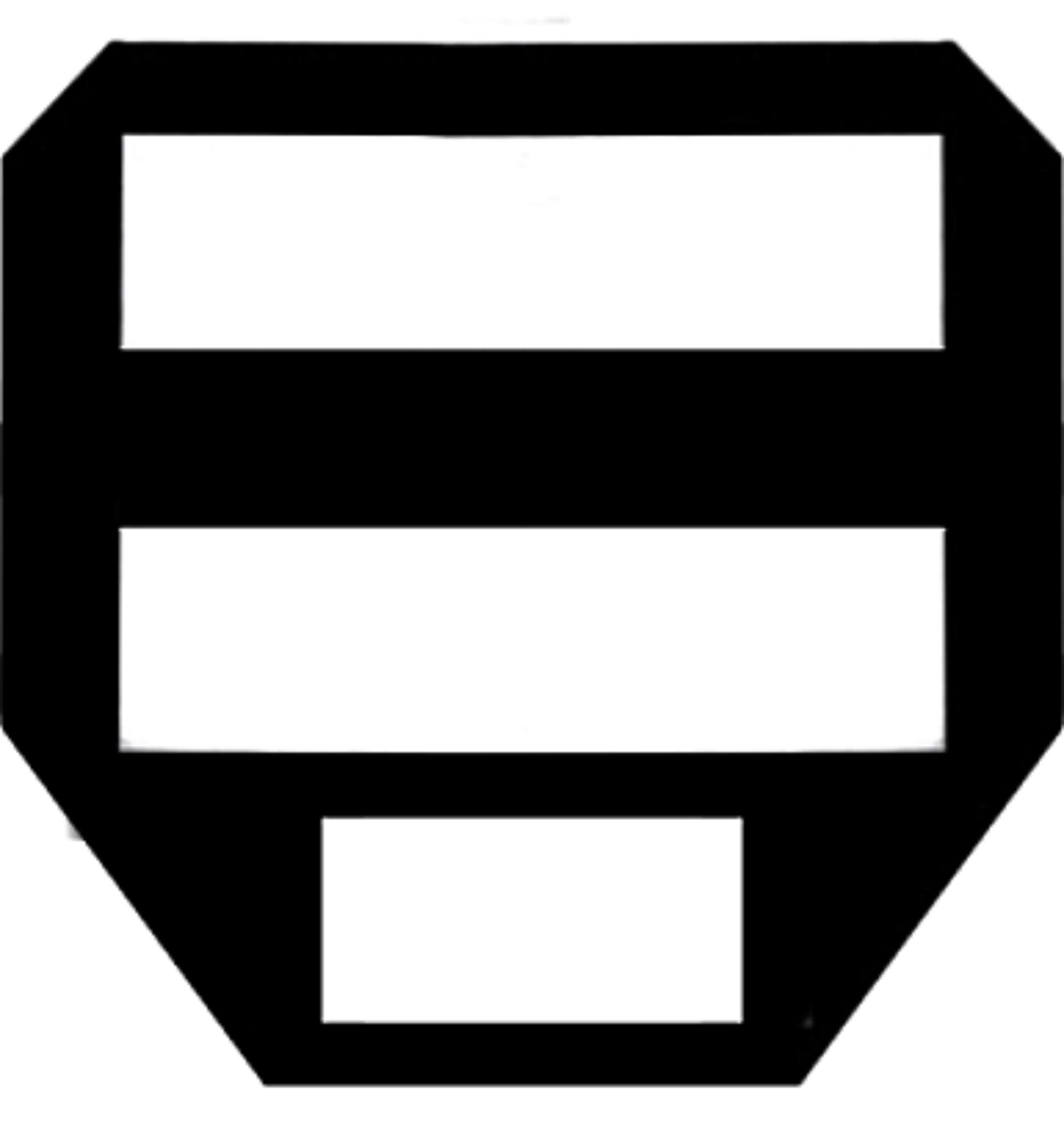

For that difficult backpack buckle for Backpack #1, I drew out the shape of the buckle in MS Paint (don't hate, wanted to do it quickly lol), and then I uploaded that shape into AI to create a photo real model. Tried to use that to reverse image look up visual matches, but couldn't find anything. I'm trying to train it to find a similar buckle, but need help. I uploaded the MS Paint variations, and the photo real AI buckles. Please let me know if you guys think it's the 1 bar or the 2 bar variation (can't really tell in reference photos):
I'm doing this to source the buckle at first - to rule out the custom CNC job lol.
This looks great! I am actually talking to someone about laser cutting them out of aluminum and for a decent price i actually tried my hand hand at designing it, I had to have it made in to a file for cutting but here is the png I made for it
If you need help getting an idea of measurements I can try my hand at it lol. But also the edge of the buckle is not very sharp looking. It looks like almost like magnesium, with a tapered edge.
I have the size already now it is for a one inch strap and as soon as I get them I will be cleaning them up so they’re not sharp and be sending a few sets to Jameel to see if the work for the bags :)
