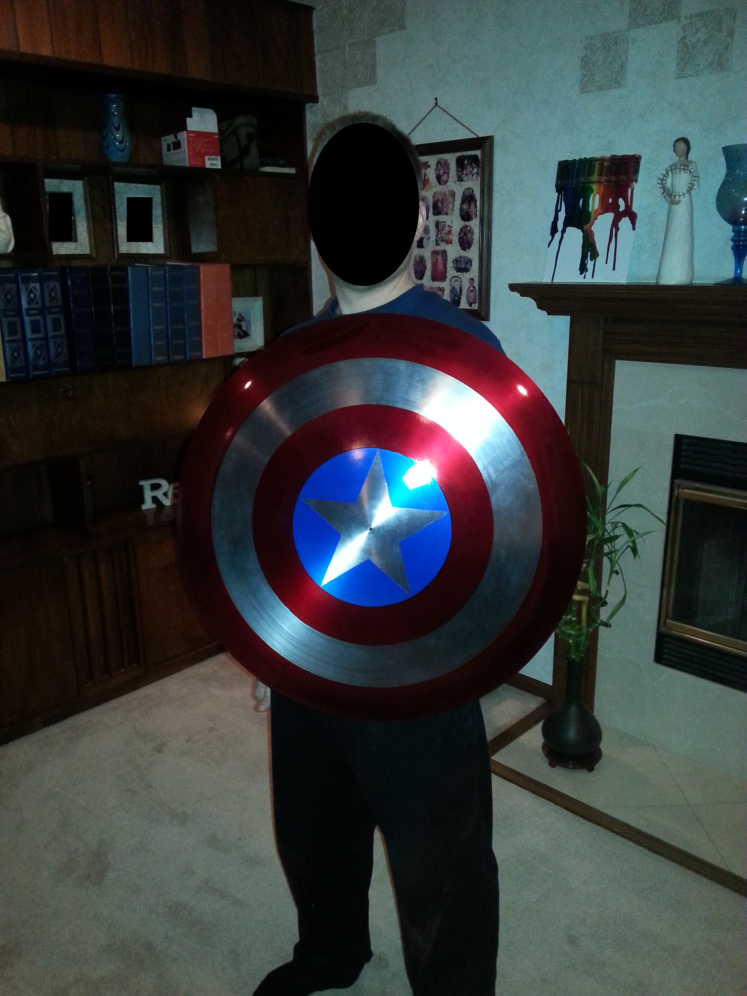

Almost there! Operation sled to shield is almost complete! First attempt painting a shield and I'm really happy with the results. No stripping for me! I highly recommend painting the shield vertically as mentioned and as I did if you're using spray cans as they are meant to be painted with in an upright position. Painting horizontally and holding the cans sideways can and will create problems. Just a few final touches left to make on the star and to attach it, a clear coat, some wet sanding and polishing and I'll be done! A special thanks again to Valor and EVERYONE else who has posted extremely helpful tips to help make this project possible. I have spent the last couple weeks reading every word of these threads and I suggest anyone making a shield do the same, it greatly helped. Great job to everyone!

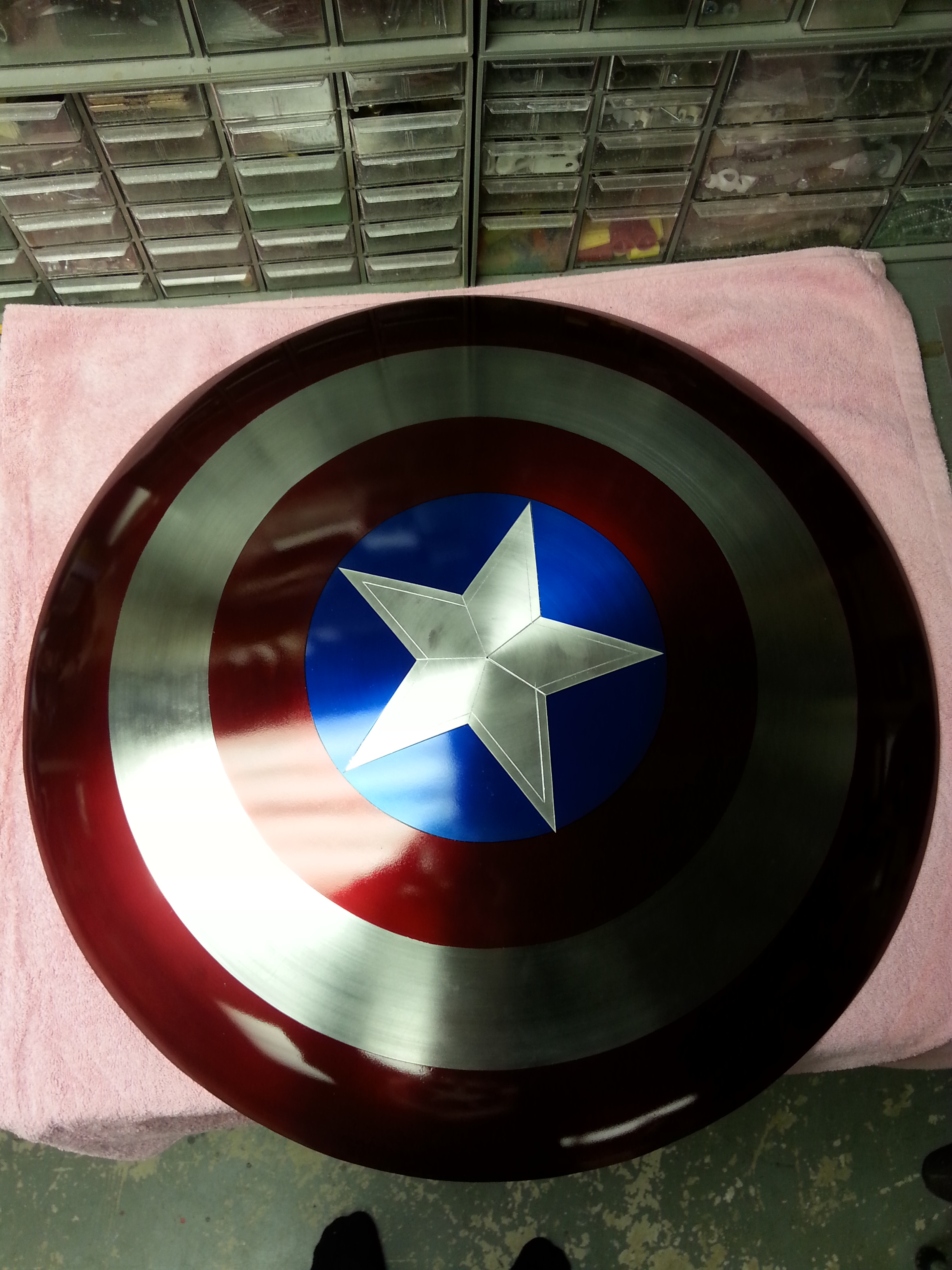

I used the Rustoleum Crystal Clear enamel on my shield and it wet sanded out perfectly after allowing sufficient time to cure. I think I left it for a few days to get good and solid. I used nearly two whole cans in dozens of thin coats to cover both sides since I knew I was aiming for a mirror finish and wanted no chance of sanding through to my base coats. I wiped down my bare metal rings carefully with mineral spirits prior to clear coating...acetone kept leaving a hazy white film that I didn't like. I also had to wet sand a very small section of paint to try to reduce a dirt nib that had landed in my red paint. It wasn't noticeable after the clear went on.
Do make sure you keep your coats from getting too thick...I got too heavy on one coat and ended up with a horrifying sag that took hours of painstaking sanding to get out.
This is how the clear turned out after wet sanding up to 2000 grit and hand finishing with the Meguiar's Ultimate compound/polish/wax products. It was a lot of work, but I think it was worth it.
