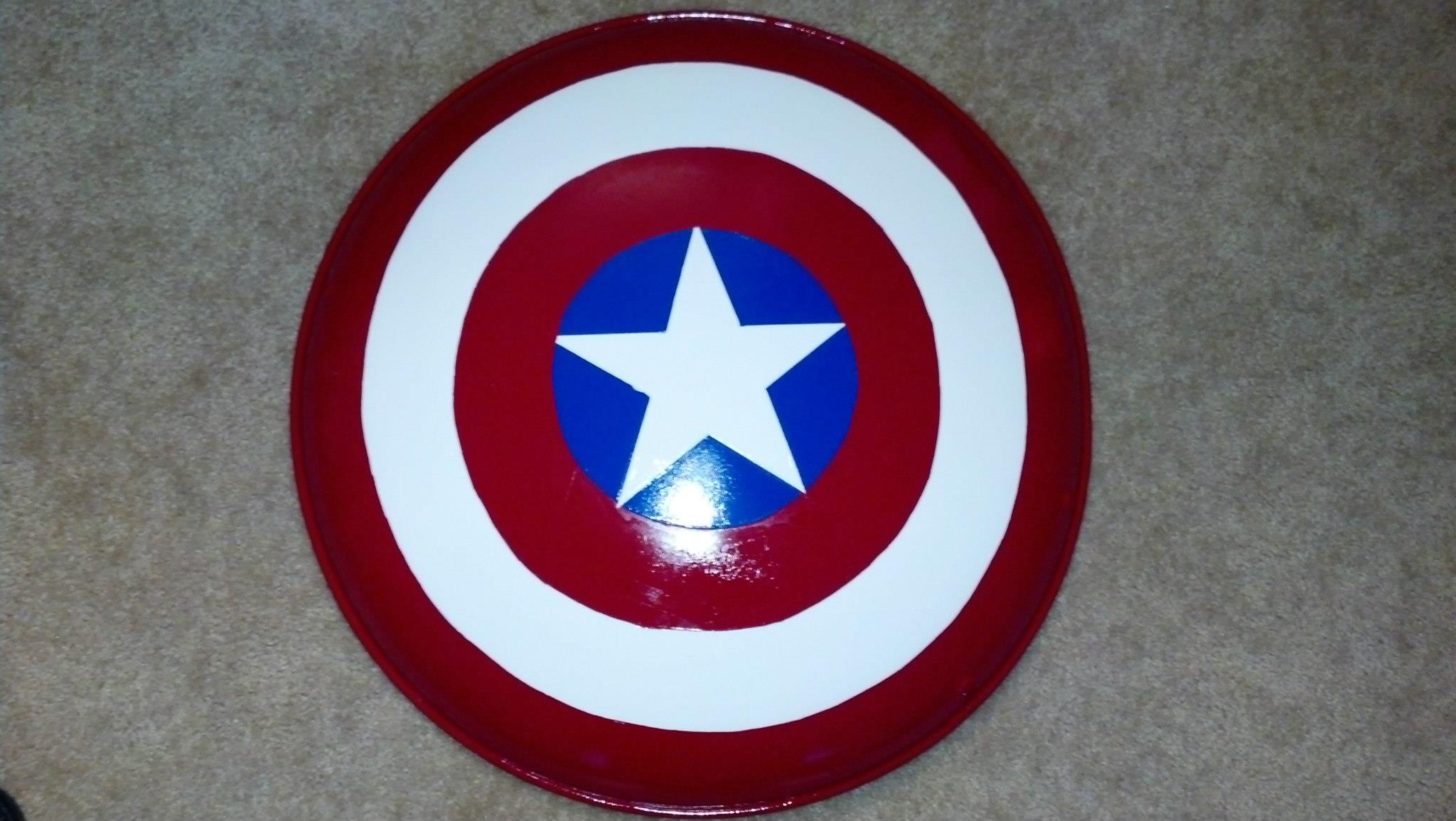

Here's mine. I bought the blank from North East Metal Spinners.
I had to strip the paint one as the paint can spat on the last coat. Im not impressed with the way the cans spray.
The paint stripper i used seemed to react with the metal. There was a mark all around one ring where the tape was. I had to sand it with fine wet and dry to get rid of it in the end.
With the star attached. I didn't engrave the star on this one as i was too worried about screwing it up. Stuck the star on with innotec topfix two part adhesive
Im going to do another with straps and an engraved star. Ive already painted the red.
