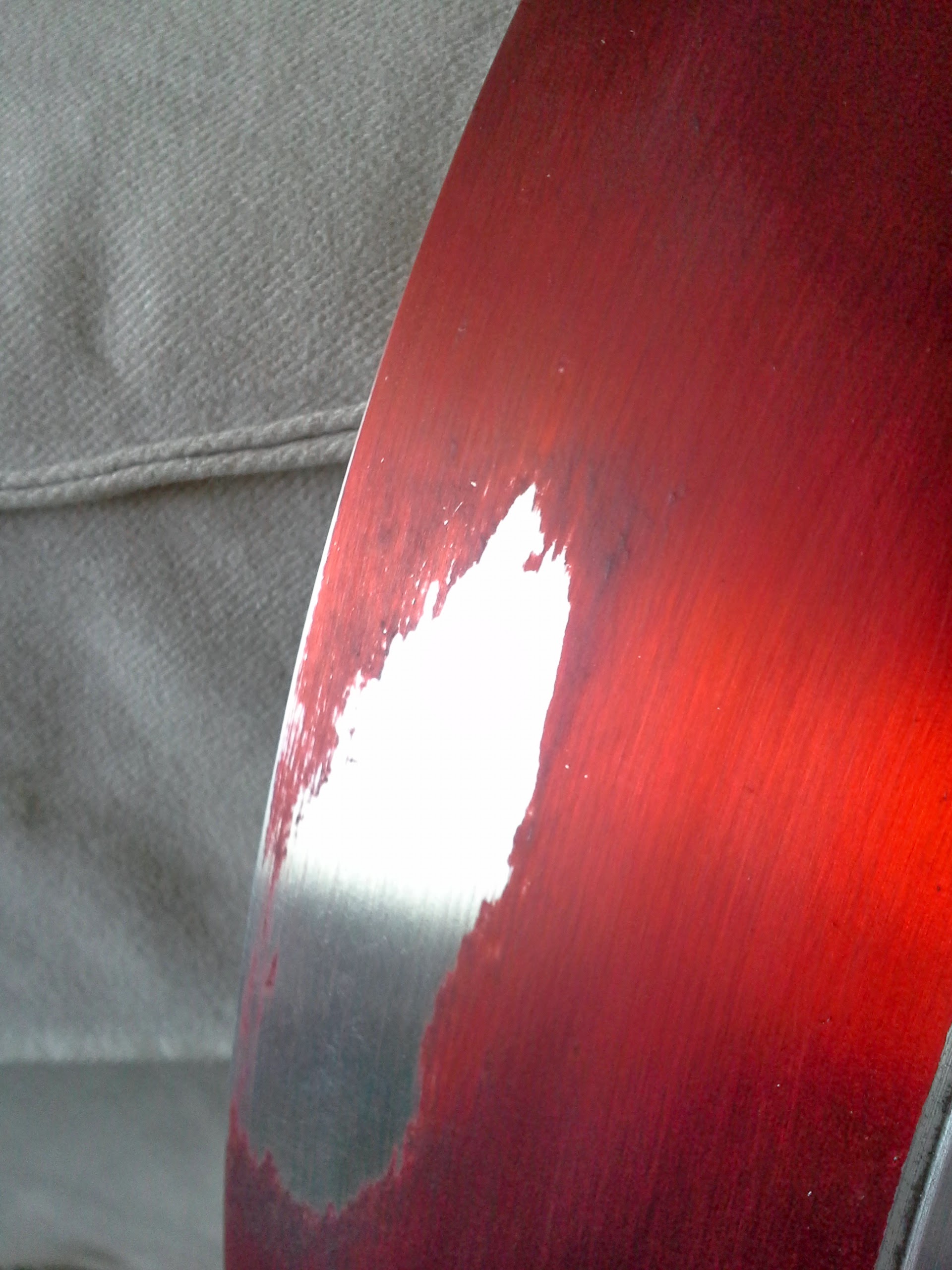

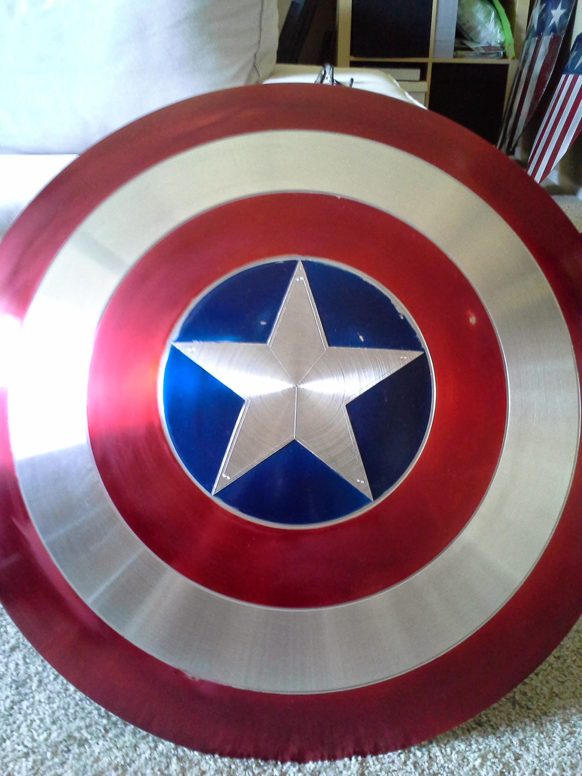

So as an update, I've managed to tape off, spray, use acetone paint remover on certain spots, and use steel wool to get ride of heavily painted areas... and now I'm left with this abominable paint job that I really don't want to have to entirely start over from scratch, but I'll leave that up to the jury (aka whomever replies) if its salvageable or not.

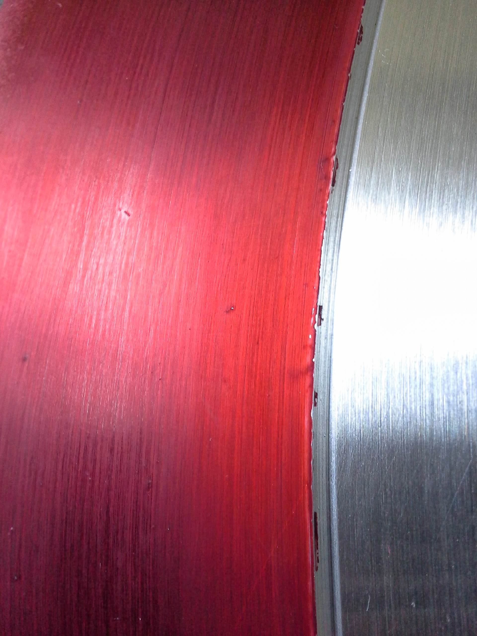

As you can see, its rough. Close up its worse. I found that I had these fuzzy things collecting on the surface, I have no idea if I'm layering on too much or if thats apart of the spray painting...
and keeping the divider rings bare as well, painters tape pulled off sections, and the paint remover I used to clean after for extra spray that made it through the tape took some off as well. I'll have to find a better way to cover those spots without overlapping the lip.. has anyone tried hot glue? I imagine it should work, its easy, doesnt mess with the metal and can be (hopefully) removed with ease afterwards.

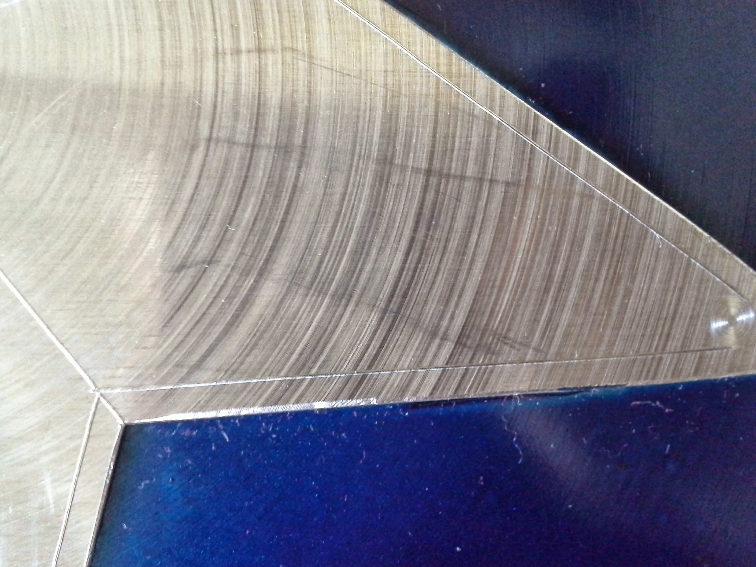

I still have an issue with the bare aluminum, scratches and blemishes on the star for instance and I'm not sure how to fix it: These were caused by magnets to hold the star down while the glue was setting to the shield:

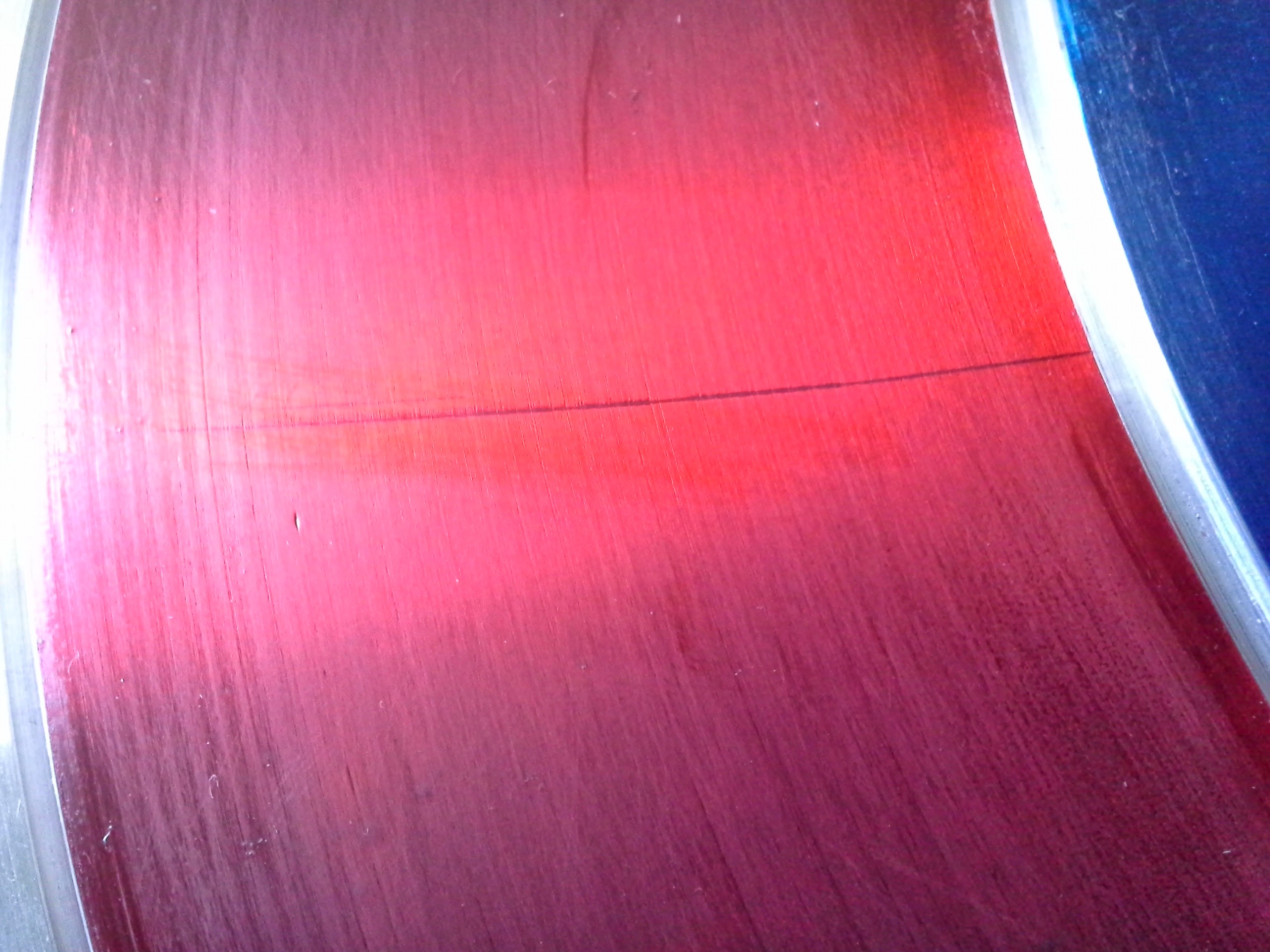

I also have a rather pronounced scratch on the red section but its flat (doesn't feel like its there) but in the right light it catches. How can I resolve this?:​

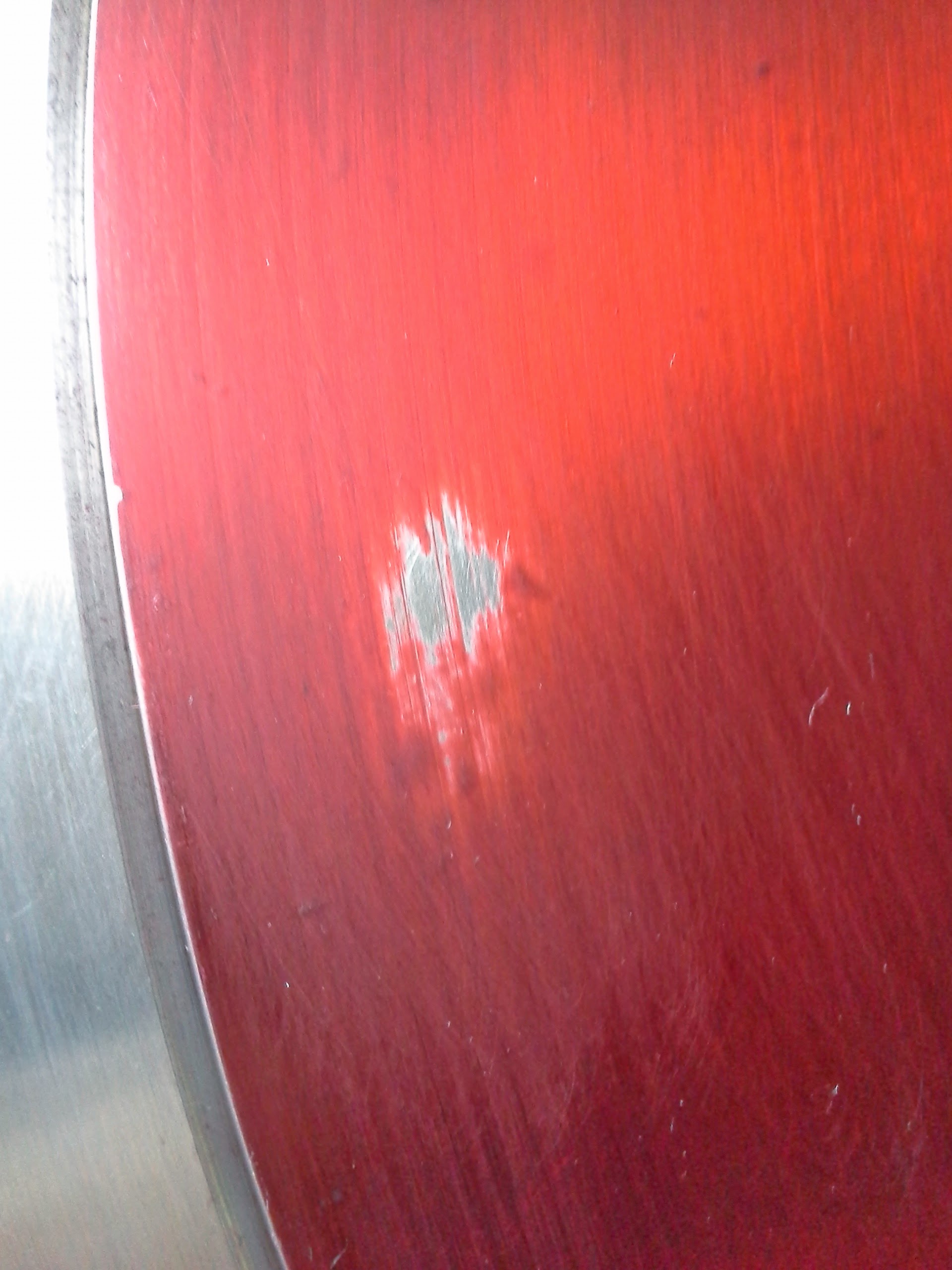

Lastly the biggest spots that I need to navigate are these wonderful dabs of paint remover used on heavy paint spots... I initially tried using steel wool to shave down the heavy sections but they didn't cut it. Now I have these lovely marks to try to correct my attempt at fixing it...​

I would start over. Some of the things I can help you address:
1. That debris is most likely from particles that landed on the shield as you were spraying or more likely as you were waiting for it to dry. This happened to me when I let my shield dry in my garage. I remedied it by bringing it in to the cleaner adjoining laundry room. You can also remedy that by creating a plastic cover to place over the shield as it dries.
2. You don't want to leave the divider ring between the blue and red bare. Ideally you want to split the ring 50/50 so that the ridge on the blue side is blue and the ridge on the red side is red. Mask the entire shield and remove the tape on the blue circle by cutting away near the blue ring side. Fold the tape down so it covers the red ridge. When it comes time to paint the red rings, recover the blue and re cut the tape near the red ring side this time. Then fold the excess tape so it covers the blue ridge.
3. If your painters tape is pulling up your paint job then that means you either have some bad tape / not using the appropriate type or you are not letting the paint job dry completely.
I use Scotch Blue Tape specific for metal surfaces. I get the widest tape roll so that I can mask the entire shield. Paint the blue first, let it dry a minimum of 24 hours before you cover the blue up with painters tape and move on to the red rings. (If you don't already do this paint both red rings simultaneously)
4. To even out your paint job its all about technique, make sure you are doing several light even passes over the entire shield. Do not start your spray directly on the shield. Start the spray off the shield and pass over the shield completely.
Which leads me to your heavy spots you tried to shave down....
5. Those bare spots alone are reason to start over in my book. Ive accepted that I won't try to spot fix a paint job. Its either entirely satisfactory to me or I'm starting over completely.
The paint job should be even and uniform. Shaving heavy spots of paint may cause you to scratch the aluminum itself.
6. Most importantly, be ok with the idea that you may/will have to start over completely a couple times or more. This shield is a beautiful piece when you apply a good paint job and unfortunately it takes practice. Rather than using Acetone to wipe out that much paint, many of us use Citristrip to get it off en mass and then clean it up with an Acetone rub down. Further back in this thread I have a string of posts that shows me having to start over along with pics. Check it out. Don't feel bad about starting over and good luck with a repaint!
