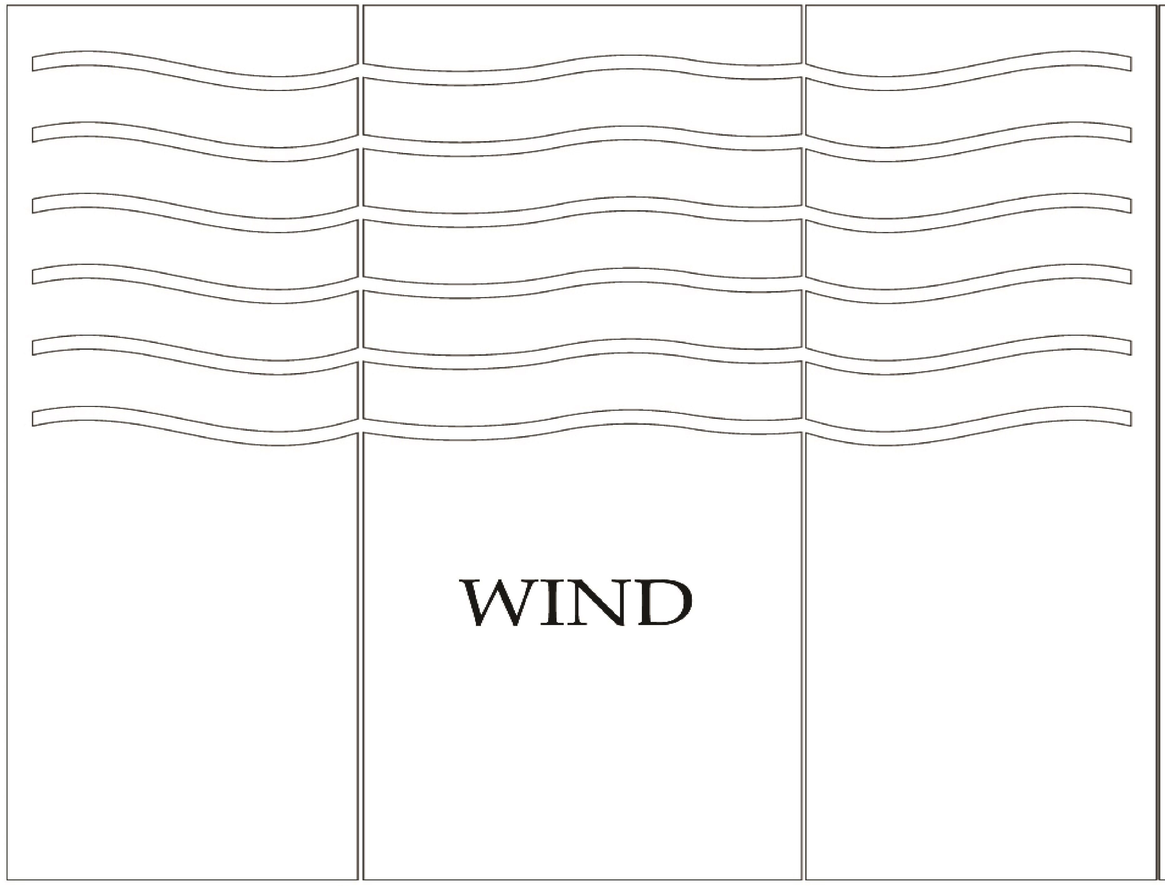

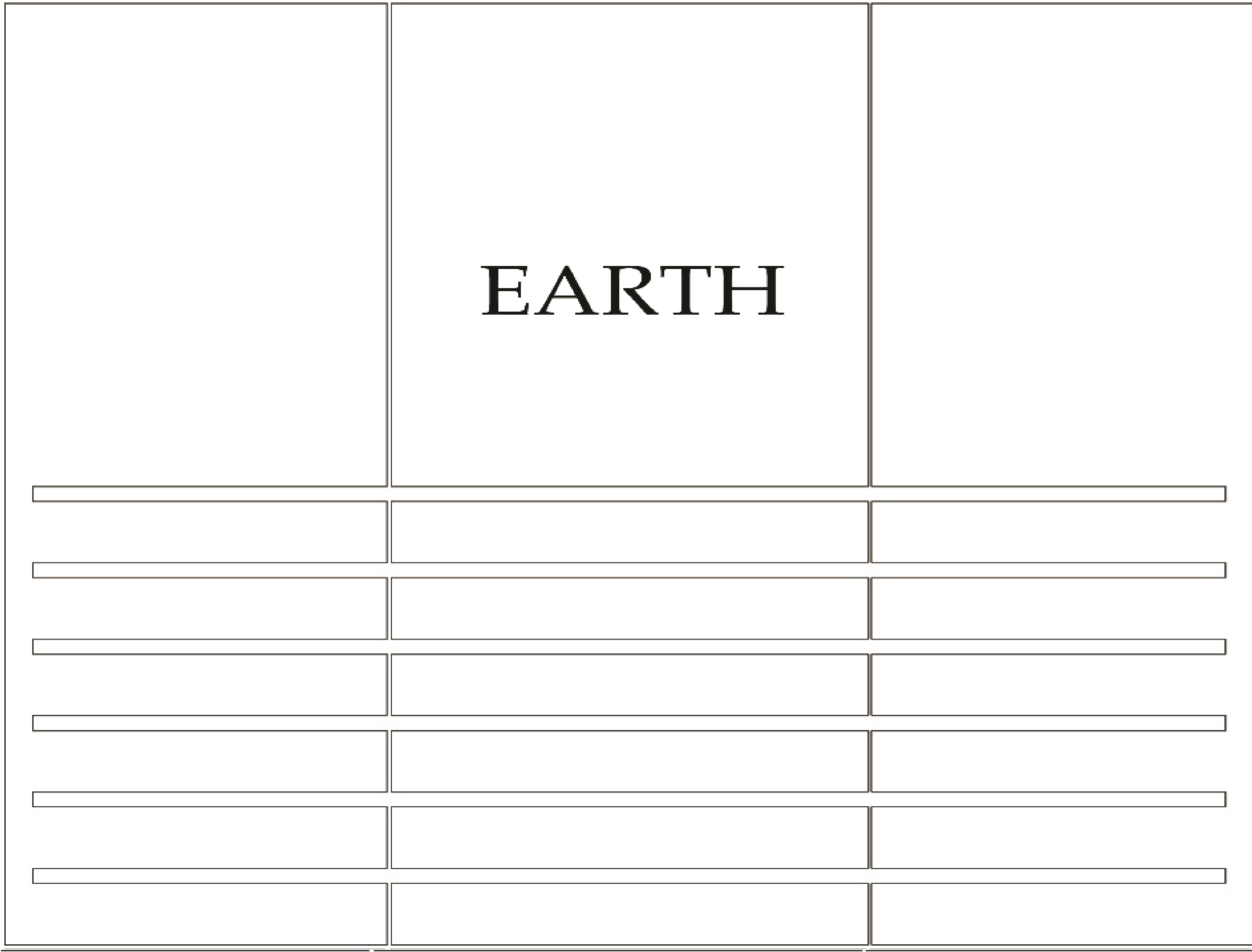

UPDATE: I stuck my printed decals on to find an issue.
So what I discovered was that this file, when scaled for the 12.0cm width I need, is the 29.5cm tall version and I need 24.0cm.
So I just remapped all 4 files to be 240mm tall. This means I have had to slightly vertically compress the image which will distort the waves slightly, but not enough to look bad. Ideally (based on my last stones) the patters should be half the height of the stones themselves.
The new version of the files are here.

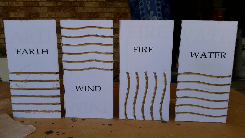

And what the new decals look like.
Front of the stones needs a flat edge. So the edges of the paper look to be my guide.
Backs
Now you can see how I have altered the graphic to make sure that the pattern are half height.
Sent from my SM-G900I using Tapatalk
Thanks to really rough (not to mention dangerous) setup using the 5 inch grinder and #16 sanding disc.
My stones now have a flat face for the front.
