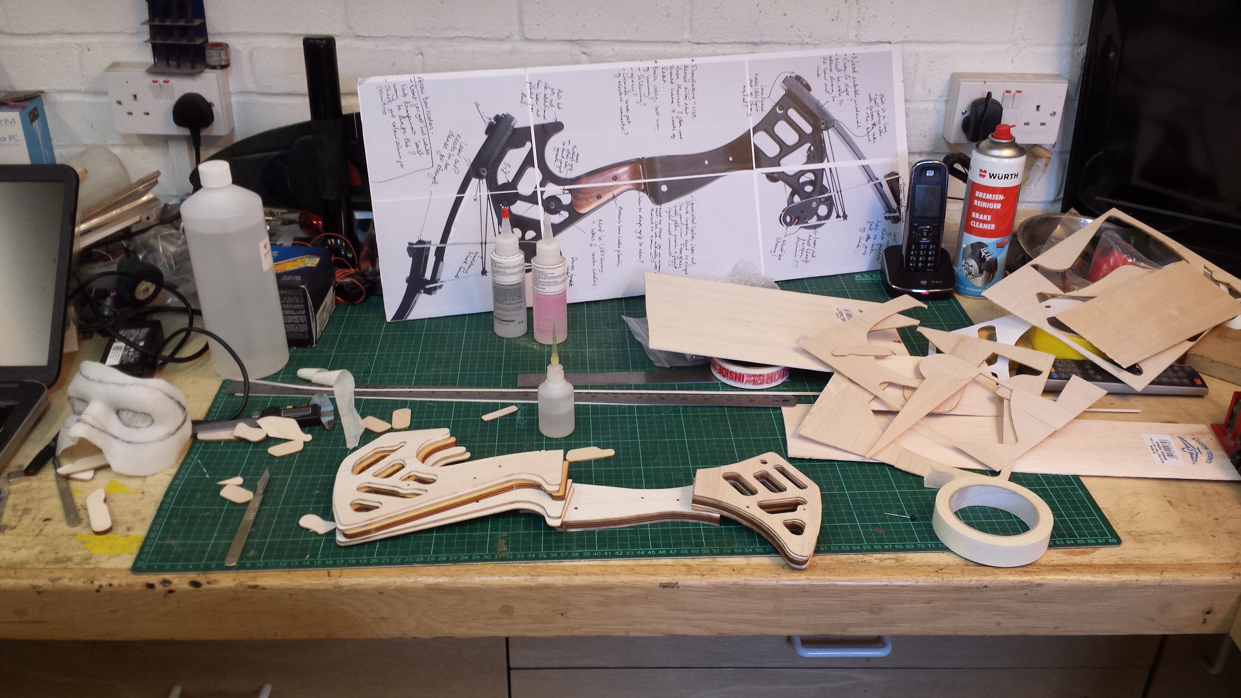

I've just started work on my one, I've got 4 months to do it. I drew up all the parts & laser cut them with a birch plywood core, balsa exterior (for shaping), then going to rout the edges, shape the curves with a drum sander and then fibreglass the whole thing before priming and painting. Going to take lots of pictures and i might do like a how-to thread or something.

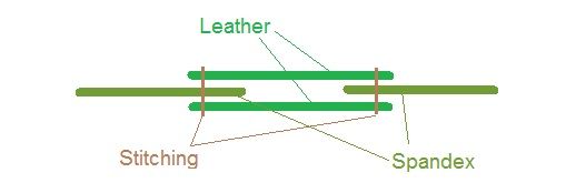

Actually just about every seam on the jacket and pants is two pieces of raw edged leather sewn together with thin strips of spandex. similar to the backs of the knees, just all over, including the collar, shoulder seams, side seams, back seams, etc if you look closely. Pretty sure none of the seams were folded at all. This can be seen in the hi-res pics from 2012 and it's still the case as I've examined two of the suits in person.
From that description, I am picturing something like this:
