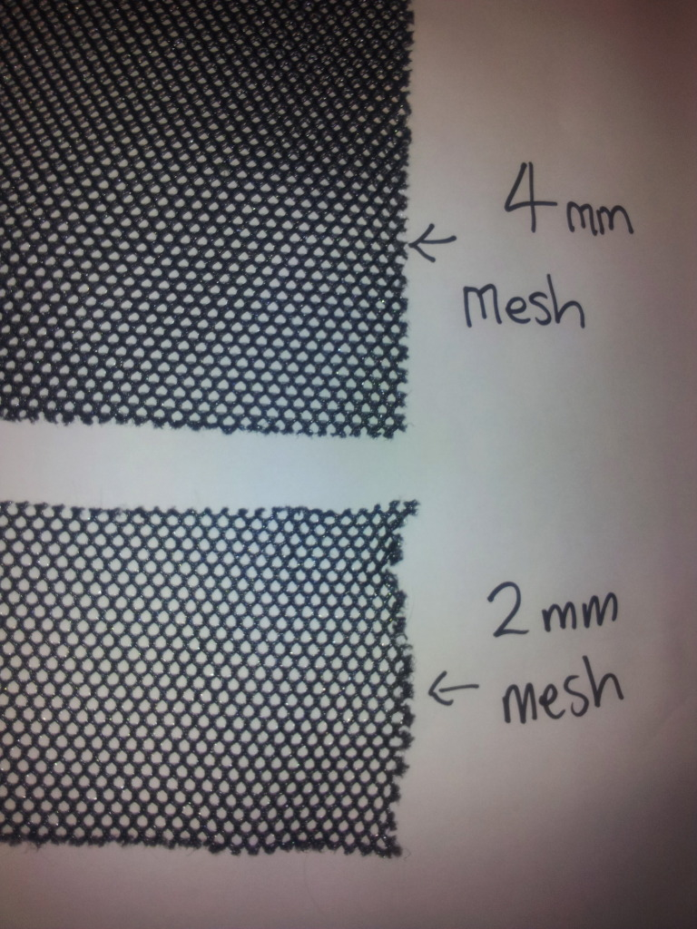

There is 2 sizes of mesh 2mm and 4mm and the black fabric that was used to line the mesh all no longer made anymore
Is that the thickness of the material or the size of the holes in the mesh?

The sizes are the thickness. And they used the same mesh fabric for neck as they did for the suit.
