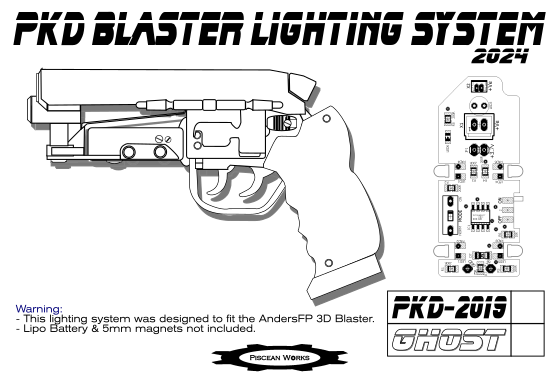

I hope so. Thanks to the images you sent me last year, the measurements were quite close with a ± 1.5mm difference. So, I readjusted the PCB design a little to allow the 4 LEDs to flex a little more. Otherwise, they (all the 5 LEDs) would have to be de-soldered off the board and re-soldered with some wires.

1. The Green LEDs gets their electrical power from the Red & Black wires coming out from the Circuit Board. So, if you do not want to light up the Green LEDs, you can either de-solder the Red & Black wires or, just cover them with tape (but don't short them together).
