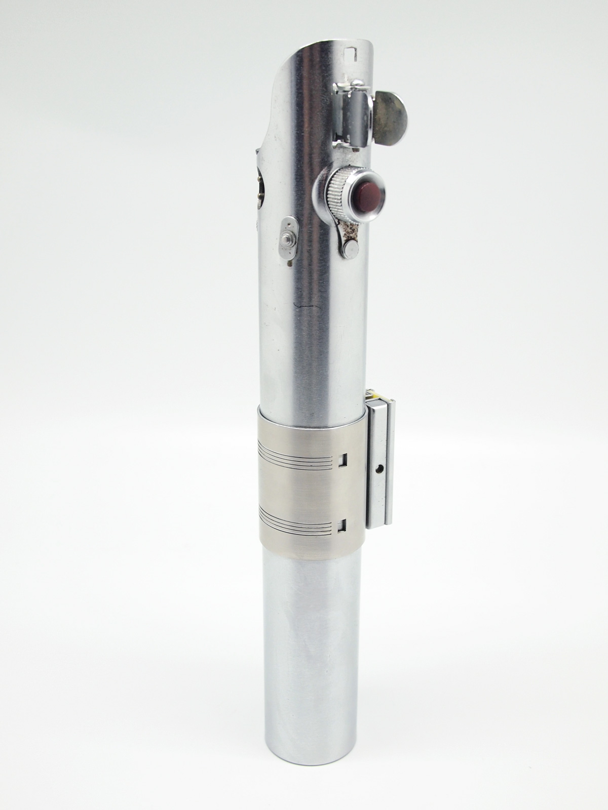

As you can see I also have a clamp cover in this picture. This is a sample version.
It's not available yet, I actually need your opinions!
Here are some more pictures:
This part is stainless steel (0.15 mm) sheet. This is much tougher than you might think. (I tried 0.2 mm, but that's too hard to bend)
As you can see, I made the grooves as cutouts instead of engraving (also called embossing). This gives a very sharp and precise definition.
I also created tabs that go underneath the rectangular Graflex bars. This is a very convenient method of assembling and it's not at all visible as was the case with the much thicker Force FX clamp test.
The surface of the steel comes mat and without brushed texture, but you need to brush it by hand (with 600+ grid sand paper)
So the question is: shall I make THIS version available? (price $15, available in 1-2 weeks)
Or shall I continue the development and make it with engraved grooves and WITH a brushed texture? ($15, available in 5-6 weeks)
Let me know what you think!
That's some nice work Roy. Do the tabs that go under the bars keep the cover rock solid? Does it cause the bars to push out at some wonky angle, or do the sidebars stay as parallel as they would without the clamp cover?
I'm so ready for these parts! BUT, I would much rather purchase it with the correct texture in place. Hand brushing with sandpaper has never given me quite the finish I'd like. I'd much rather have it done in factory. So, my vote is to wait a few more weeks.

Yes, it's rock solid and it's perfectly straight. It doesn't make the bars wonky at all.
Texturing is very simple, can hardly go wrong, but I understand what you're saying.
Cut or embossed: I can only judge from the images! I'm worried that embossing makes them too soft, but the picture I took in the cinema from Maz's chest it looks like they're embossed rather than cut. But the in the pictures from the exhibition they look cut. :rolleyes

Haha BELIEVE me, I have gone wrong with texturing many times. I'll buy whatever version you offer, but I'd MUCH prefer it pre-brushed :) Circuit board looks great too btw.

I'd hold back until you are definitely sure - it always looks embossed to me though.

In my opinion i would wait to see whats accurate regardng the clamp covers.
While the cut iut lines look cool im afraid they may look too deep. Do we know ifnthr screen used saber has the cut out lines?
I would also prefer the brushed steel.
I'd want to wait until we know exactly how the clamp cover was done on the hero saber. I'm in no hurry on making a TFA Graflex, so I'm perfectly happy to wait for total accuracy.
