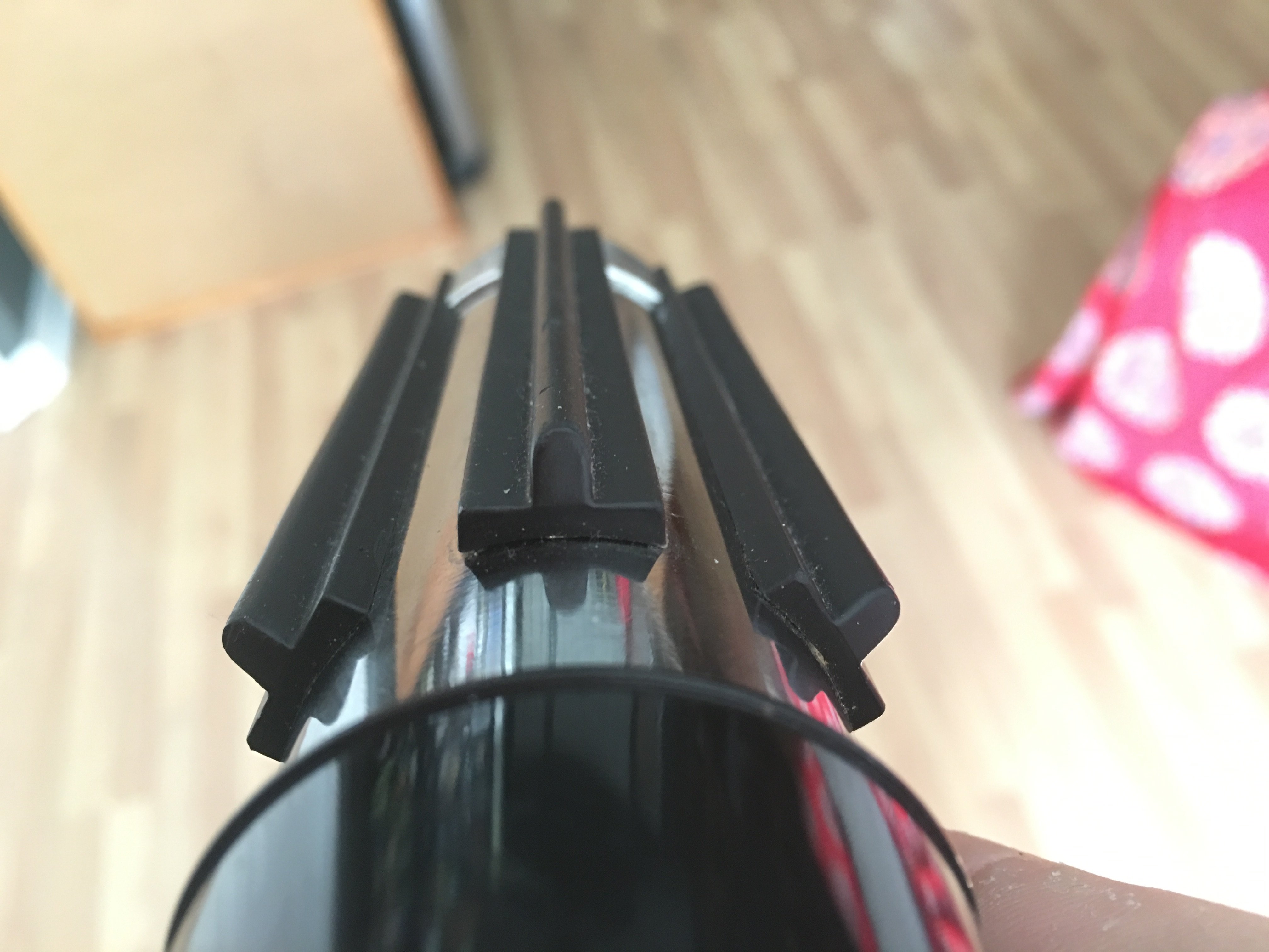

The problem is: I still think that the Wired picture is the screen used saber, but the profile is not the same as on the Launch Bay sabers and the Prop Shop sabers. To me it seems that the profile in the Wired pic has a glue channel whereas the LB & PS don't.
So I'm still not convinced that those fully curved bottom profiles are correct.

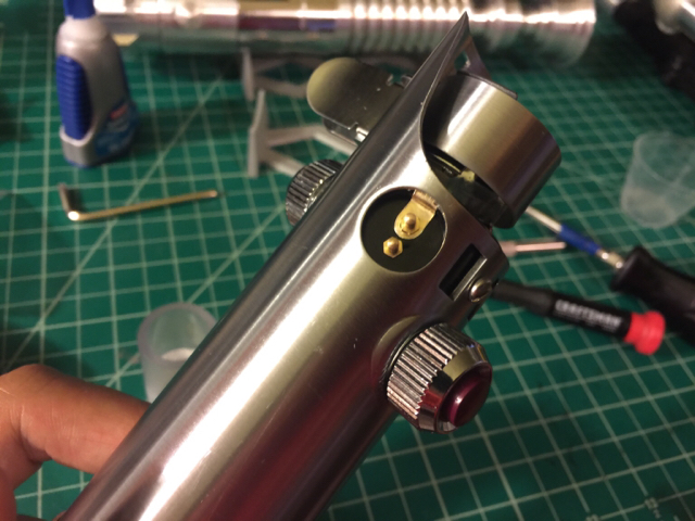

Here we see my newly flattened beer tab. My vice had an odd hammered-steel texture, so I put several layers of packing tape. This actually worked!
https://postimg.org/image/eei7mhe6t/

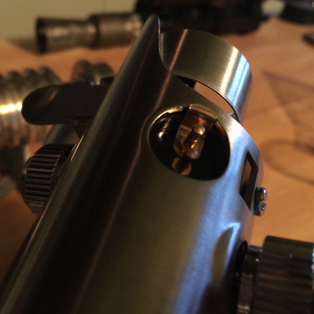

I also tried to flatten the side switch, the 2.0 has weird rounded edges. This really didn't do anything besides making me notice the chrome more, which prompted me to sand it very lightly. Not too bad, but I wish I hadn't done it.
https://postimg.org/image/lfswf1lpx/
It did leave some "crease marks" so in some lighting it looks like it is still bent.
https://postimg.org/image/nfp4h2l31/

I'm inclined to agree with you, I think it's a screen used one too. Do the grip lengths match up when overlaid with your models? I'm seeing raised edges exactly like your glue channel on the wired one too rather than a fully curved bottom. Also the raised parts look straight and parallel like the 2.0 or MR rather than the accurate flared profile on yours, particularly noticeable on the other shot from the emitter end.
Comparing to my MR Force FX Vader the part that joins the body looks thinner and the raised sections look either thinner or protrude further:
So we can count that out at least, if all the MR grips are the same...

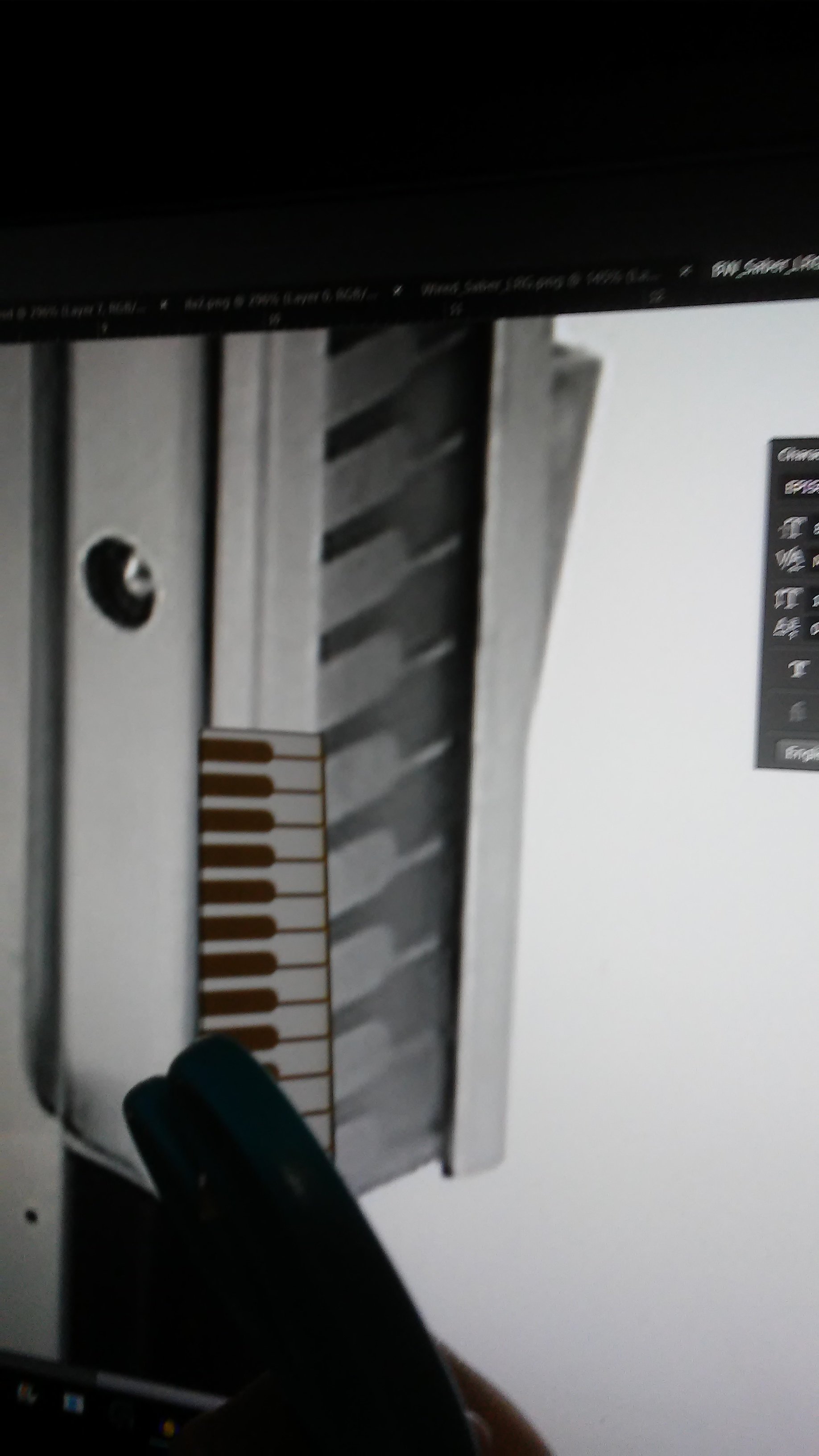

This is so interesting. This picture must be a real practical prop, not CGI, right? The Finn/Rey backpack variant. It's a little hard to make out, but I think it has the left hand traces. I also think the CGI one that cuts to the practical one when Rey pulls it out of the snow with the force has left hand traces. It is entirely possible that there were separate models, but I don't know why they would. Unfortunately I can't find the frame where it shows the card during the forest duel, I can't scrub the movie frame by frame on my phone.
Here is a shot of the CGI saber (and can also be found several pages back on this thread, along with some pics of Finn holding the saber where you can clearly see which way the thin lines are going).
Umm, yes but you see two different orientations in those scenes. The CGI spinning saber has right-side thin traces coming from the bottom of the thicker traces, while left-side thin-traces-from-bottom was seen in the Maz-to-Finn hand-off scene (indoor hero) and the saber-on-the-ground (outdoor hero) scene.
Yea, I knew that. Meant to add that you can see them going the opposite direction in the Finn scenes. Opps
