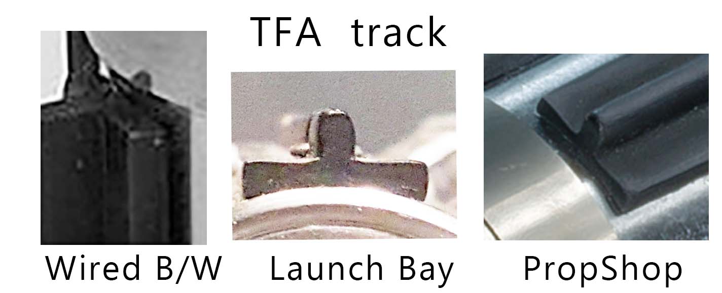

Do you have a photo of your elastometer track? Might get it because it says that they used rubber grips here:

Yes, these are my rubber grips:
It's almost the same, but slightly less accurate and consistent. It's also bend and harder to apply.
I have no idea what PS/LB grips are.
What I meant by PS/LB grips is prop ship &launch bay. And, also maybe Wired saber too. Remember the B/W saber pic? If you look closely it matches very close to what I have seen on the launch bay and propshop sabers.saber track.jpg
The reason your profile overlayed so good (probably) is because the thickness at the ends, the width, and everything else is the same, minus a glue channel. Like Blastech or TCSS or Parks, just to name a few.
I still don't see a glue cjhannel on the wired or anything else.
I have to agree! It indeed seems to be completely curved on the bottom. A logical shape of course.

Great! Thanks a million!!! There was one unboxing review online where the guy said the propshop saber had "accurate plastic parts" as his hands brushed against the grips but that wasn't really definitive. This settles it.

I was concerned about that article as well, but so far it's the ONLY source that has mentioned the hero TFA grips being rubber, and since we've now confirmed the Propshop grips are plastic, that leads me to believe the CineFx article may be mistaken. I have tcss rubber grips on mine now, but I'll probably swap them out for some plastic ones soon.
