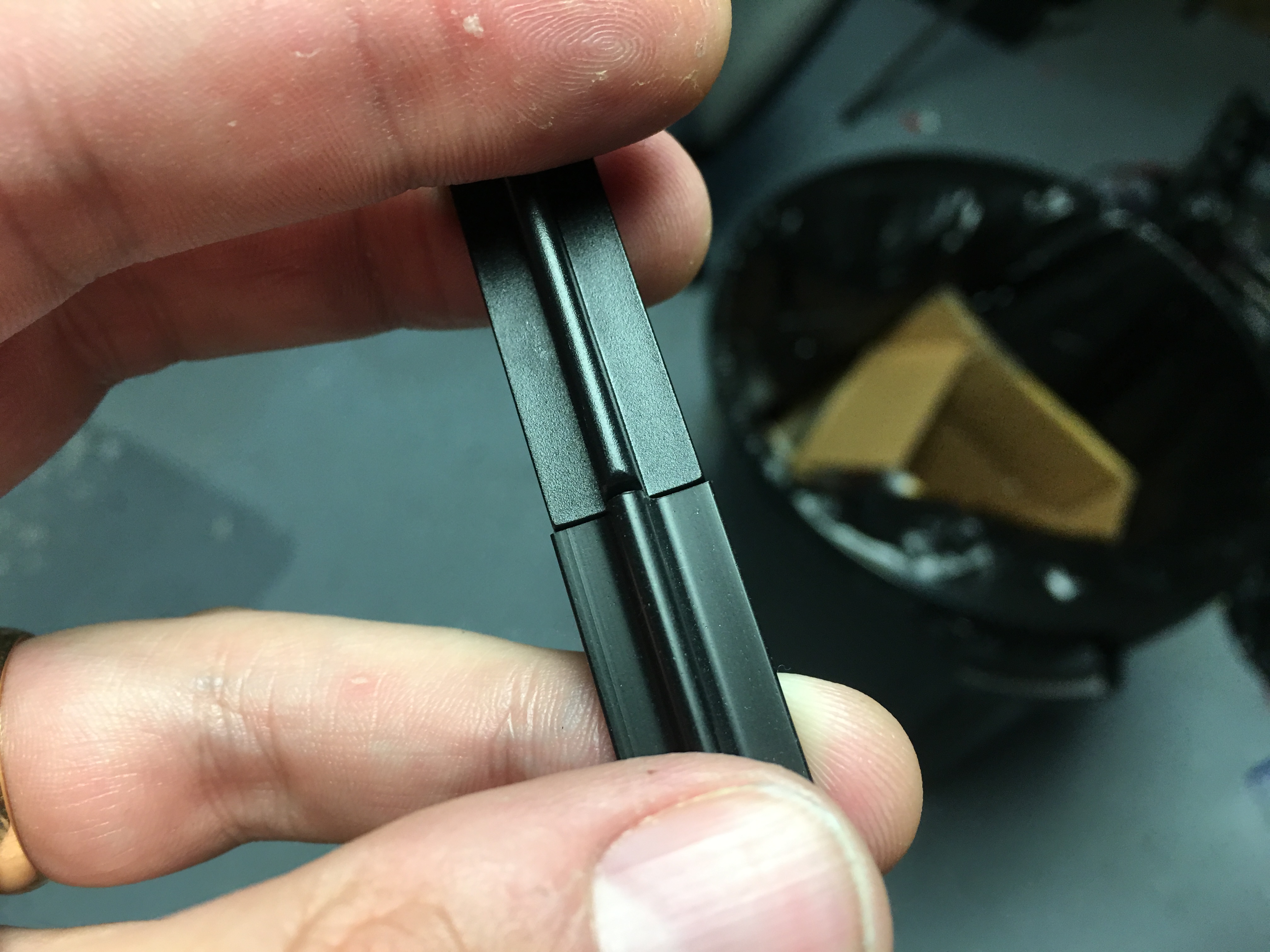

That being said here are the Graflex 2.0 grips compared to Roy's:
Not perfect, sure, but not super far off...
They're just shy of 92mm, the cutout on the ESB style is about 10.1mm from the end and 10.2mm wide, so according to Roy's calculated dimensions cutting down the ANH Graflex 2.0 grips and slotting them will get you accurate sized TFA grips that are similar but with a slightly different look to Roy's accurate t-track :)

I've left the stock grips on my 2.0 so far. The placement of the rivet/screw might not be 100% accurate, but I've got a gap between the clamp and the top of the grips and they fit flush against the saber, so it's good enough for now until someone starts extruding a TFA-profile grip.
Thanks for the comparison. Looks like we need some new t-track!

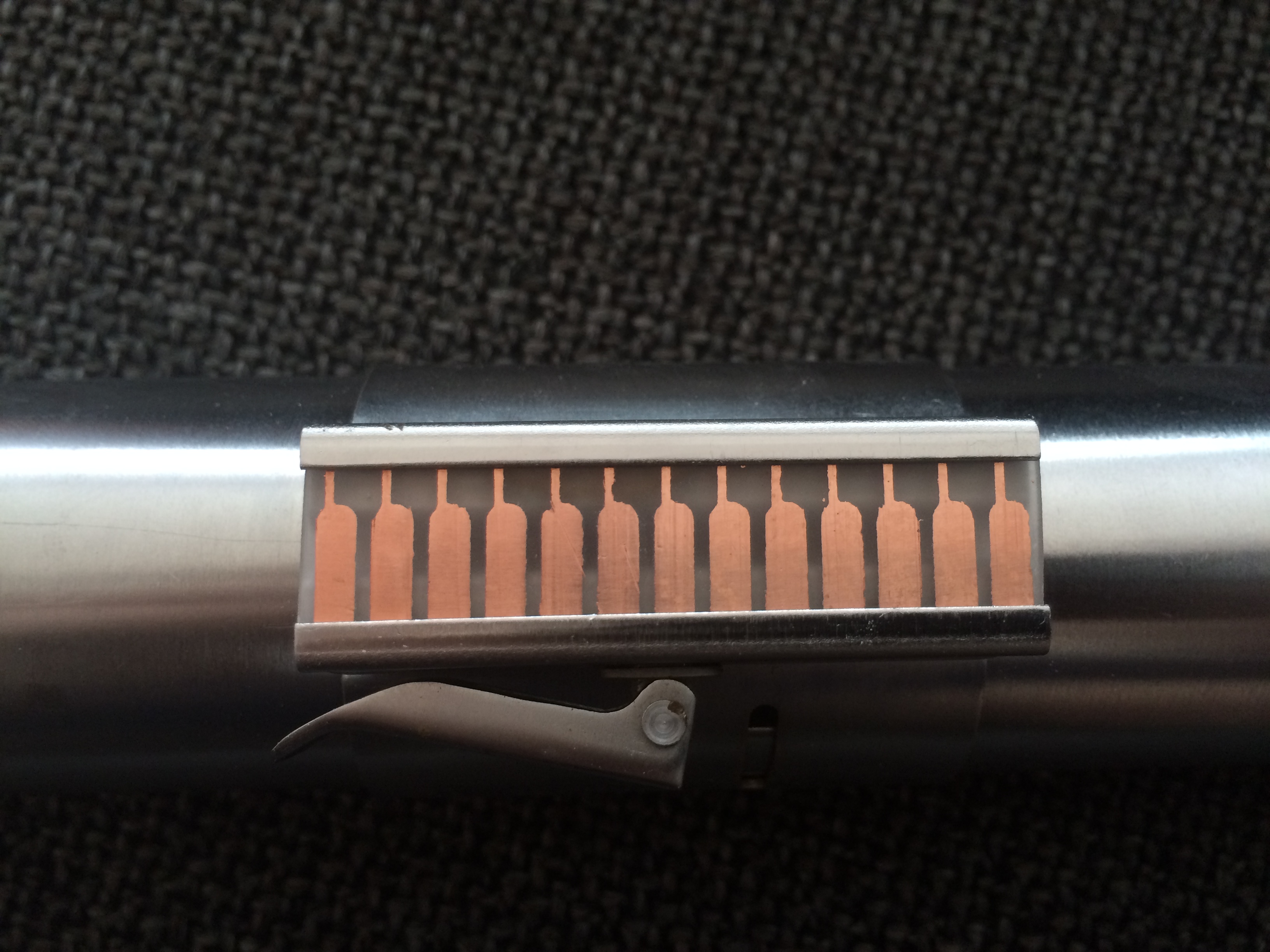

Hey guys!

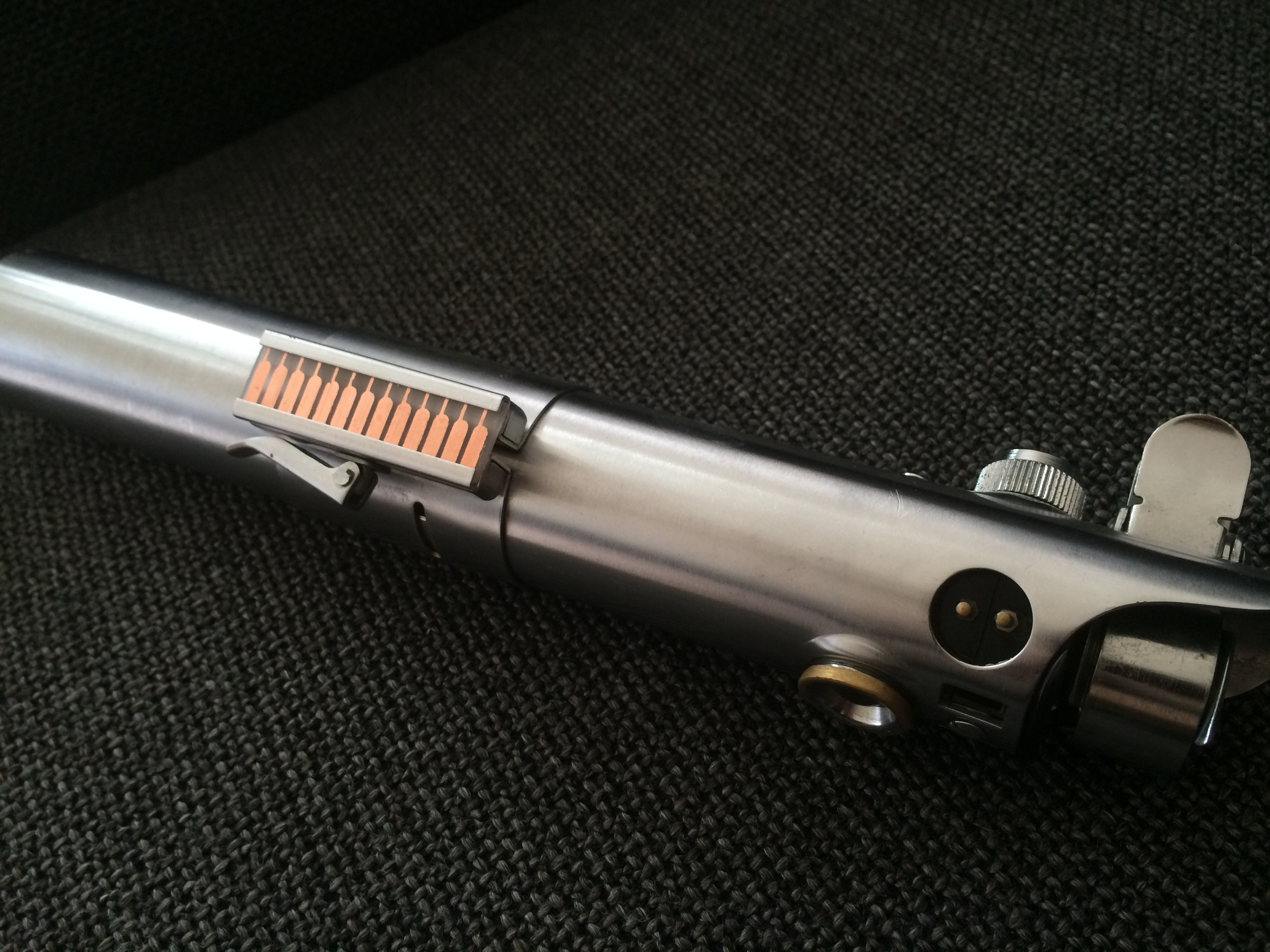

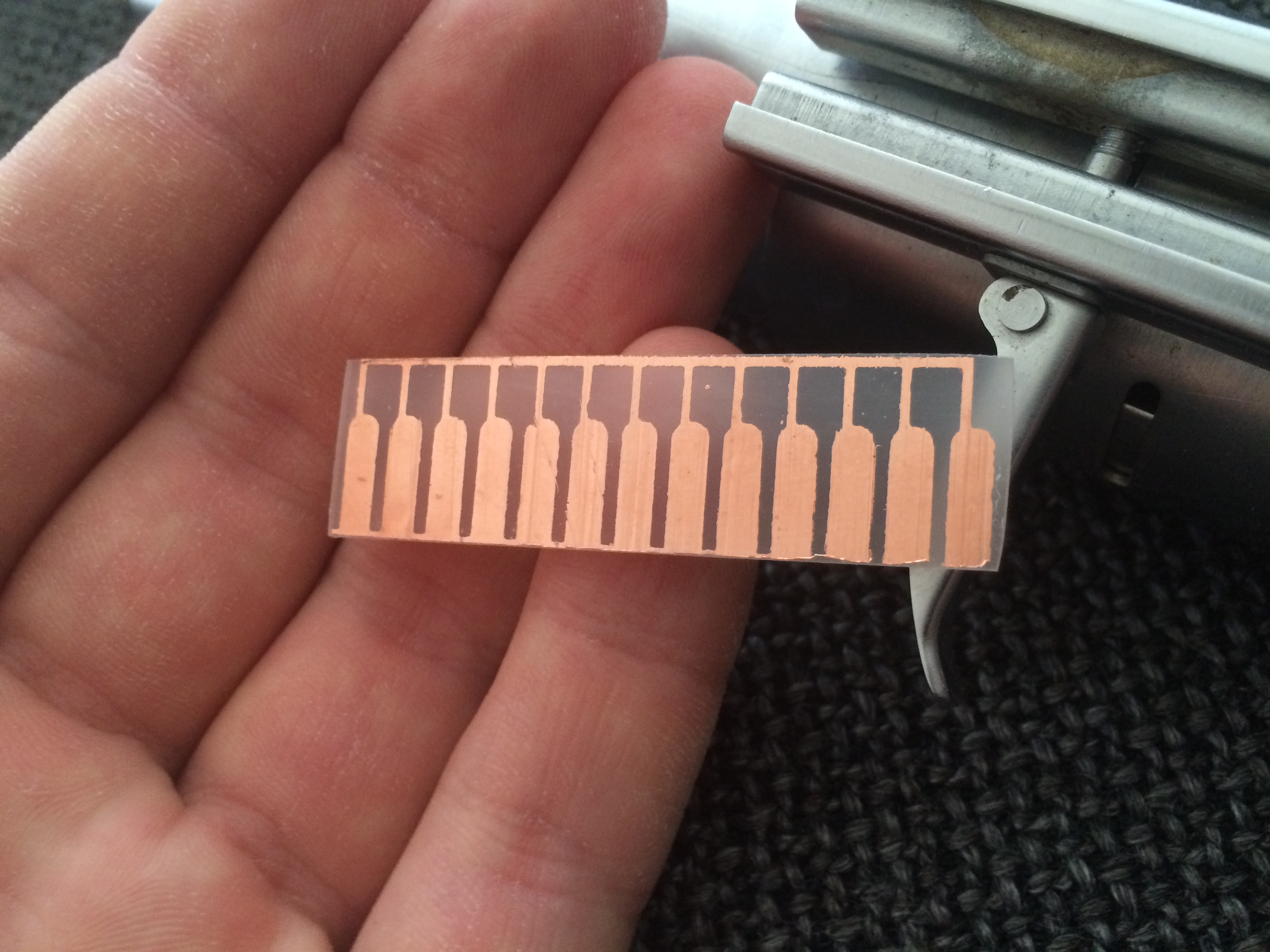

I just finished our first protoype TFA clamp card. It is not yet gold plated (The finished version will be) and the etching came out pretty rough because of several small things that I will fix next time around. We are currently working on a system to sell these and I hope to get an interest-thread up in the next few weeks. :)
These will be 100% handmade, by the way...
View attachment 638207View attachment 638209View attachment 638210View attachment 638211

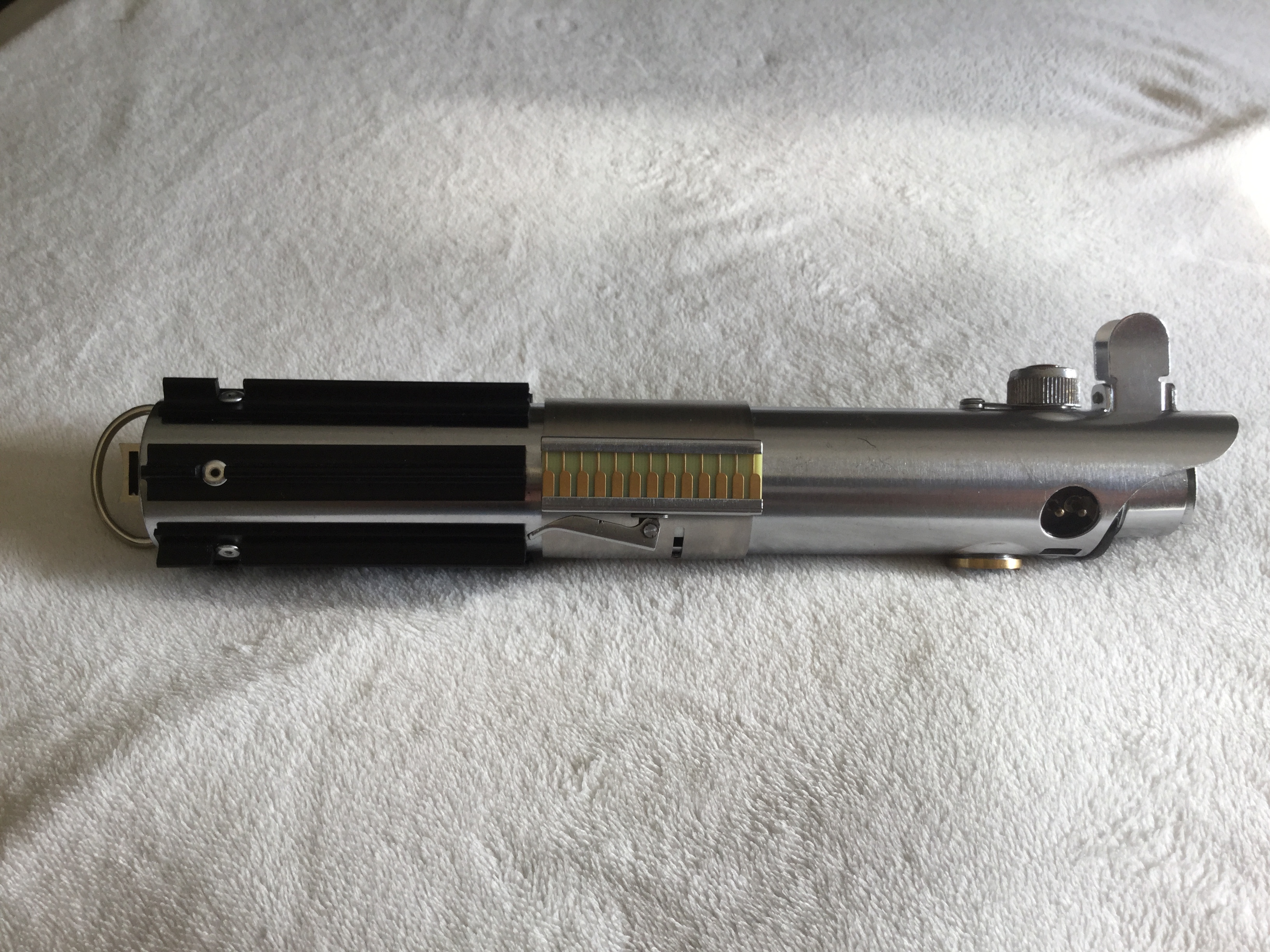

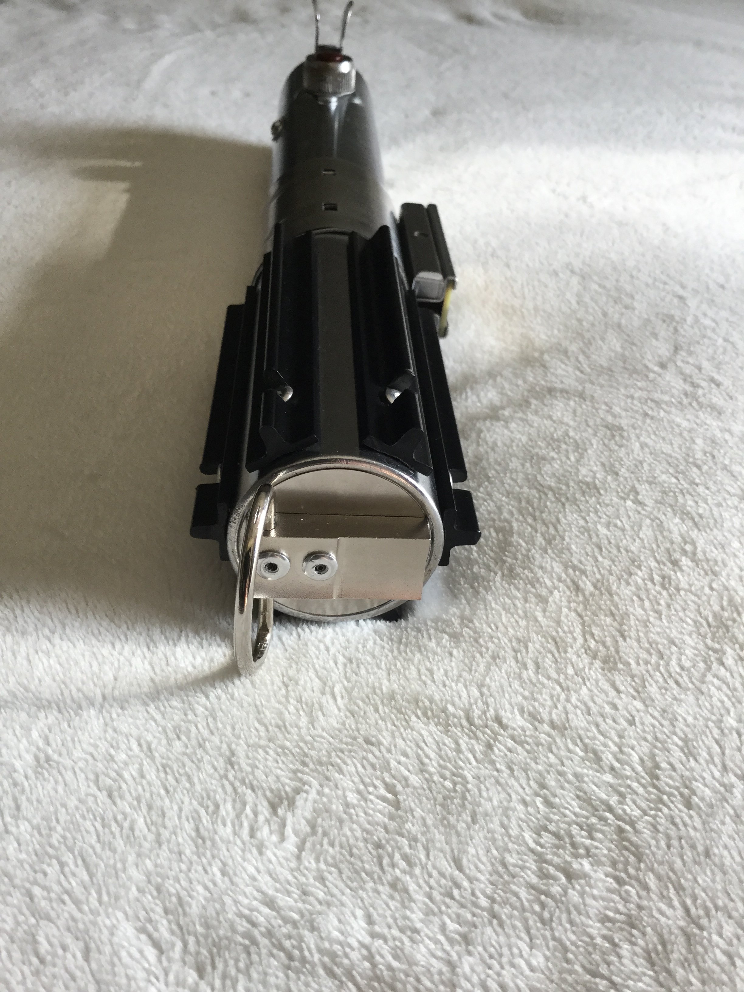

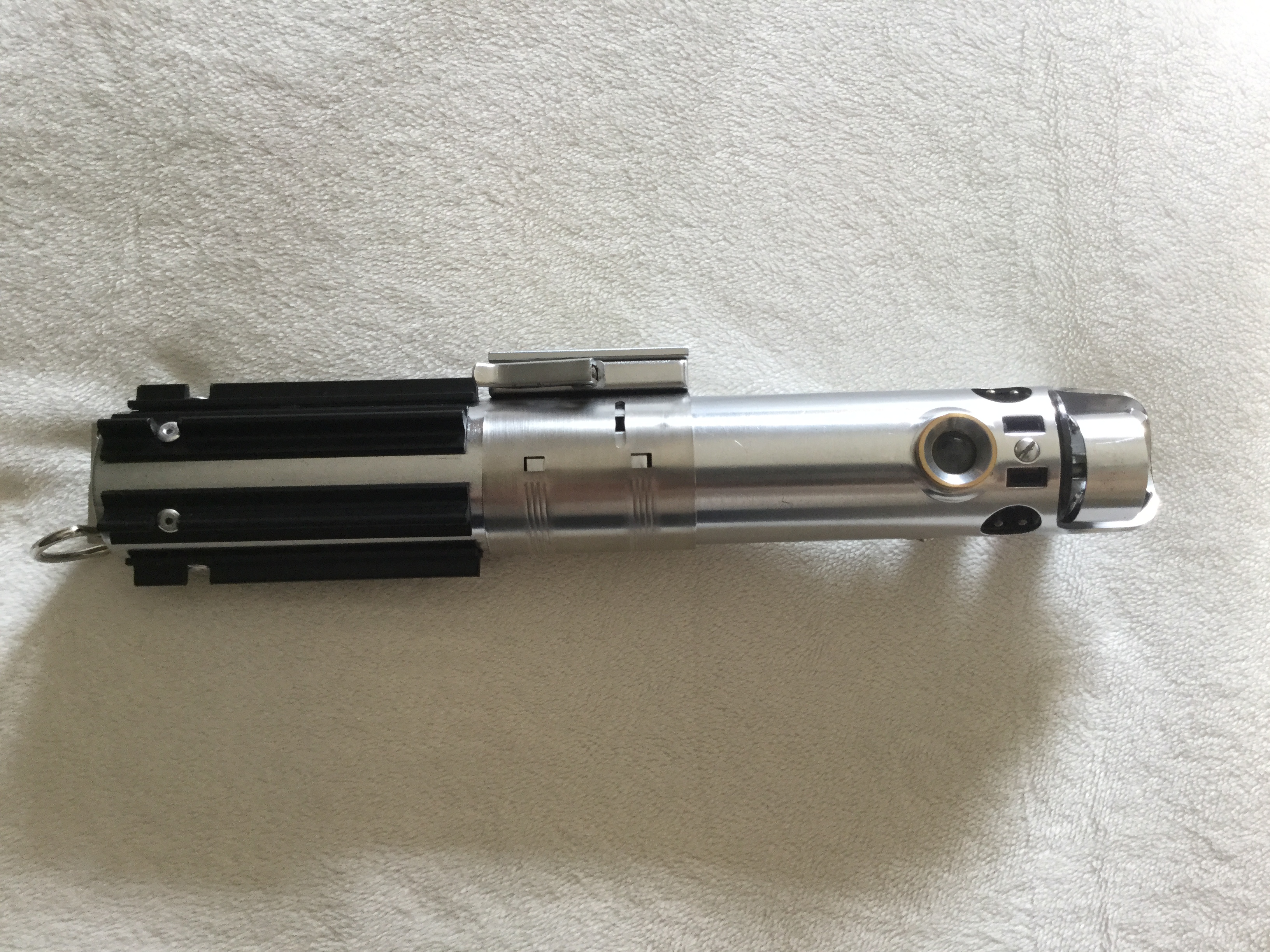

I've been following this thread since early this year and have learned so much from all of the great members on here. Thank you all so much for your insight, inspiration, & attention to detail! That being said I wanted to post a few pics from my vintage Graflex TFA build. I chose do the Maz saber. The grips, Kobold clip, clamp & bottom cover are from Roy. The card is Slothfurnace. Still waiting for someone to do a translucent card. I used 3mm rivets on both the grips & Kobold.
