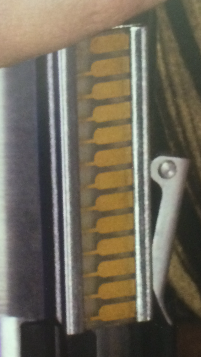

I went back and looked at the saber from the Wired photos and you can see the circuit card is clear plastic.
You are so right! How can we NOT have seen this?!
I will dive into replicating it. I wonder if this transparent material is a standard PCB base material.
Is still wonder why and how the Launch Bay saber got the mirrored version. Perhaps just a silly mistake!
I think on the surface. Because you don't see a lot of shadow on it close to the edge.
I was thinking the same, but thought I should mention the possibility anyway as it popped into my mind. Kind of eliminate what it is not in order to establish what it is.
A semi-transparent frosted edge card is super cool. It IS a great nod to both the bubbles and the original edge cards at once. I want one for every custom saber I make :)

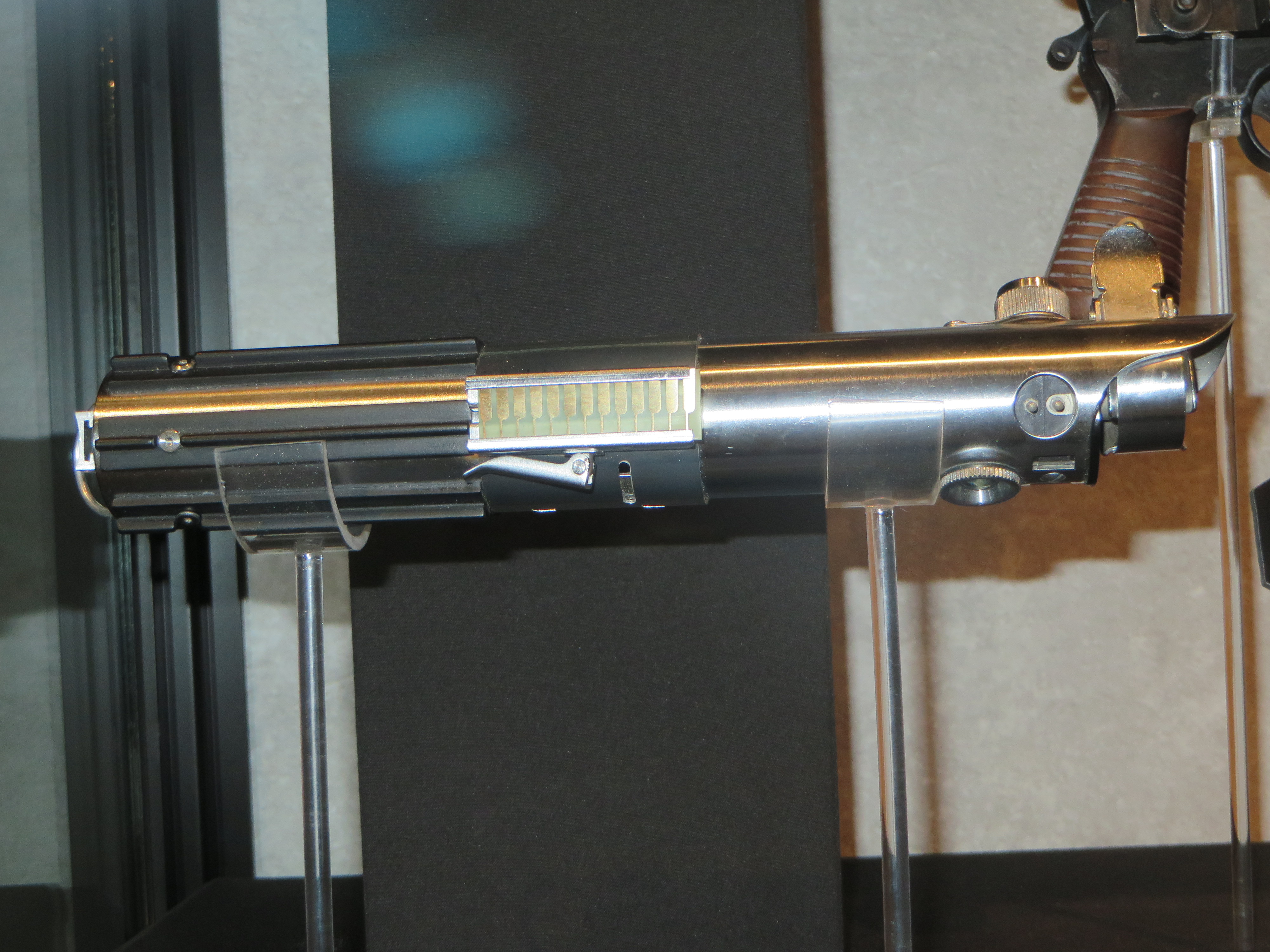

I've been giving this a lot of thought and here is my take on the EP7 lightsaber.
First, I feel that we can throw out the Launch Bay sabers as screen accurate:
1. The grips are too long and go fully from clamp to end
2. While the circuit board traces are accurate-ish, it's a solid card and not translucent
3. You can see the Graflex info on the end cap, it's not covered
4. The glass eye is not turned smooth
5. Uses socket head screws instead of rivets in the grips
The only thing the Launch Bay sabers have going is the clamp cover. I don't know if they were made by ILM, Disney, or someone else but they look more like display pieces and don't match the film sabers.
With that in mind, I feel that there are 2 main 'Hero' sabers. The 'Maz Box' saber, and the other saber that is seen with Finn during the fight at Maz's castle, was the saber sticking out of the snow, and was the one Rey presents to Luke.
So I feel the Finn saber:
1. Has the turned-smooth eye
2. Has a clamp cover
3. Has a cover on the bottom covering the Graflex info
4. Has grips that go all the way down to the end of the bottom tube
5. Has grips that are cut short on the clamp side, and not short because the tube is pulled out but grips that are actually short
6. Uses rivets on both the grips and the dring
7. The circuit board is clear/translucent plastic
This is the most widely seen/used lightsaber in the movie and is the main 'Hero' prop. This is also the same saber from the Wired photoshoot so if you're wanting to make a replica of the main Hero prop, this is the version to copy.

Well, translucent circuit card clears up the graphic anomolies I was seeing, so that's all well and good, but I don't know how we're going to replicate that part.
My manufacturer doesn't list "translucent/transparent" as a base material.
You could photo-etch the traces with the correct spacing on a sprue, glue down just the traces to the plastic still attached to the sprue, then cut away the sprue after the glue dries.
Or it could be foil that was laser printed on plastic.
