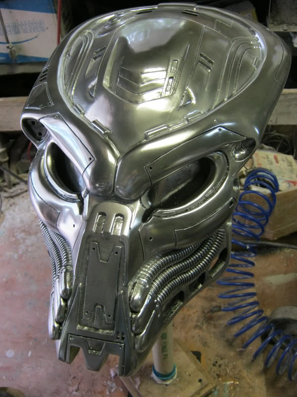

Looks great. I've got to say I really like it, but that is (to me) a lot of work to clean up. Have you spoken with other makers how to lessen the bubbles/pits? Have you checked for voids?
How to lessen? Using products from smooth on, because i do the same steps as other makers make, unfortunately the shipping prices to PR are too expensive, so i have to use whatever i find on the net(low quality), i said it before and im gonna say it again , i dont consider mysef a prop maker, im just a fan that want to share his works with the world ( community) if it has flaws i say it before selling, so if people are down with that and they still agree to buy it, its their responsibility, i try my best in each project, and this was the first time i used the brush on silicone, and i didnt like it a bit, just wanted to try other stuff, im used to the pour one, you can see the difference in smootness if you compare to the gorilla bio, and thats it

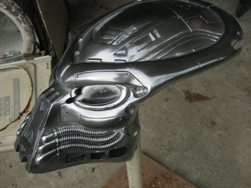

I came to realize maybe the problem was the resin , i just casted an iron man faceplate and the mold is bubble free then when i demold it , the cast is a lil warped and with bubbles all over the place
Will do , but im going to try another resin, the site i order my silicones now has a similar resin to onyx even the cans are like smooth on gonna try that next time
In natural light, not much difference
Now comes the real challenge, alclad cant be touched too much, so it needs to be sealed, the problem is when sealing youll be loosing the chrome properties, so im going to seal with future wax, because its not reactive to anything so far, but it has almost the same problems as alclad, needs to be protected from chemicals for example amonia or a high percent alcohol etc. even too much water could screw it, just so people knowif you choose to wear it, you know your chances
