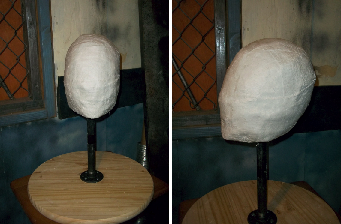

Well, I hope this works, but in order to make sure the mask can fit my big head I made a duct tape head, filled it with padding and then plastered over it with several layers of plaster bandages, as you can see here:
It is not a perfect representation of the shape of my head, but the height and the width, are correct, but there are a lot of odd bumps here and there caused by the duct tape under the plaster.
Once the plaster dries, I might go over it again with duct tape.
I hope its strong enough for the clay to be sculpted on. Maybe I should just carefully fill it with plaster completely.

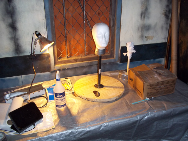

Anyway, I went to Wal-Mart yesterday and picked up a 6ft folding table to use as my work area for sculpting the costume parts. I'm going to sculpt the head first and then move onto the upper body, etc.

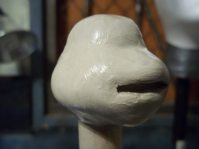

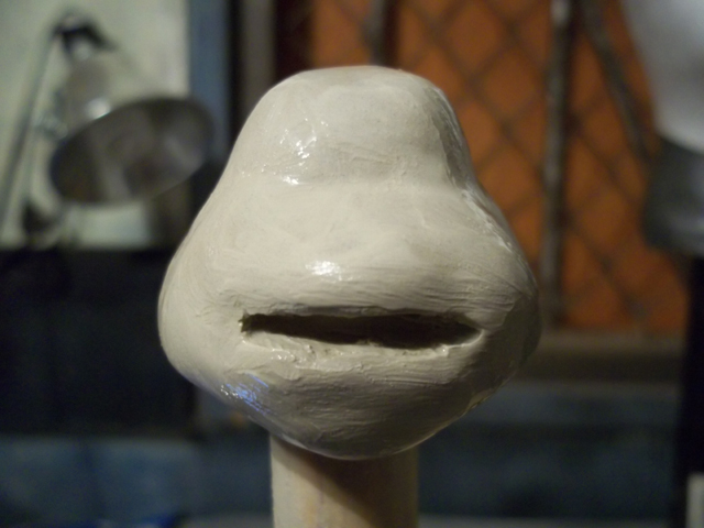

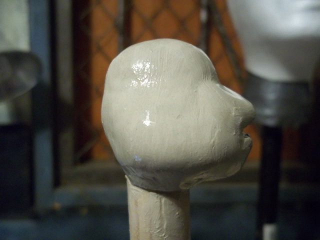

Instead of just starting out with the full sized head I've been working on a smaller scale head, no details, no bandana, just the shape of it for Ralphael. This way I can avoid wasting a lot of clay figuring out the shape of the head. It's also a fun way to get a feel for the clay. I've never worked with WED clay before. It's a lot of fun.

What do you all think of the general shape? I think the chin might need to come in a lot more toward the bottom

I started putting clay onto the styrofoam head i have today, but I removed it all. The head is way too small compared to my big head and I was using a lot of clay to build it up. I need to find a head that is closer to the size of my own to sculpt on.

What do you all think of the general shape of the small sculpt, for Raphael?
For the general shape I think it's a good start. I'd bulk up the top half of the head a little. I think it's too small in proportion to the lower half. Id also fill out the lower portion on the back of the head a little more too. The back of the head just looks a little flat. Keep sculpting...you'll get better and better the more you work on it.
