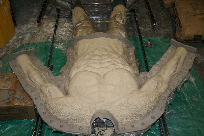

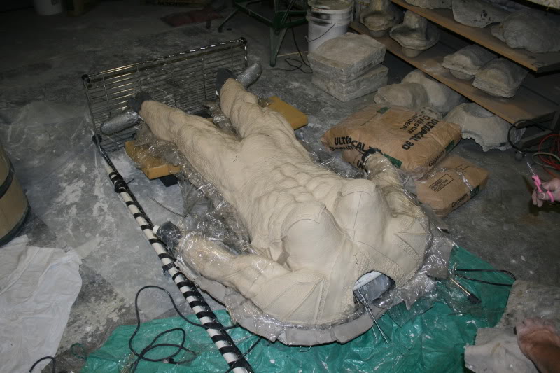

This is the full upper and lower of the Male sculpt. At this point, we have the backside shell in place to give support and protect the sculpting on the other side. When we got it laid down there was some minor repairs to be made. Scott (Mannowar) does this **** in a flash.

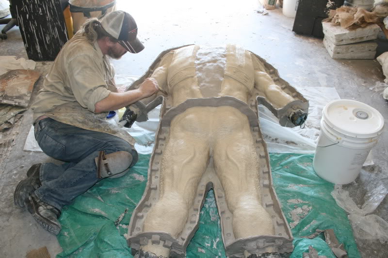

Dams for the plaster and keys in place - ready to plaster the front half of the upper body. Unfortunatley, my camera battery went dead at this point and I didn't get anymore of this weekend.

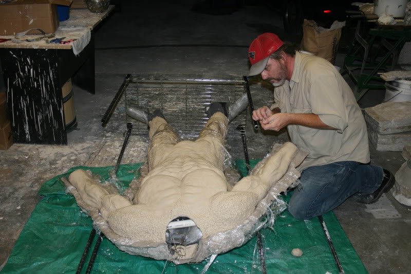

The first weekend we finished the upper male mold. Scott will have to share some pictures of the completed mold. When I got back up there after Dragon Con, we worked on the upper torso for the female and finished the leg mold which, will/can be used by male or female.

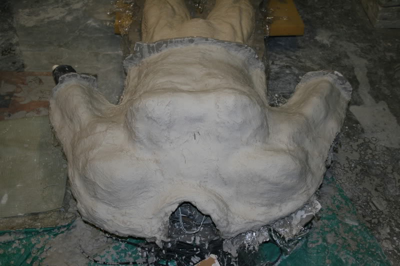

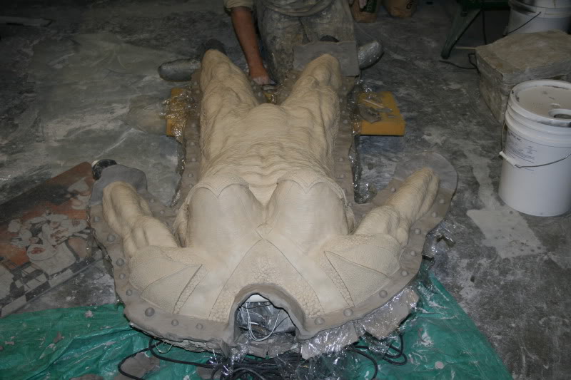

This is the upper torso for the femal and lower for both sexes. Note the awesome armor sculpted into the female. Great work Scott.
Front SIde Female upper molded
Front side Leg Mold

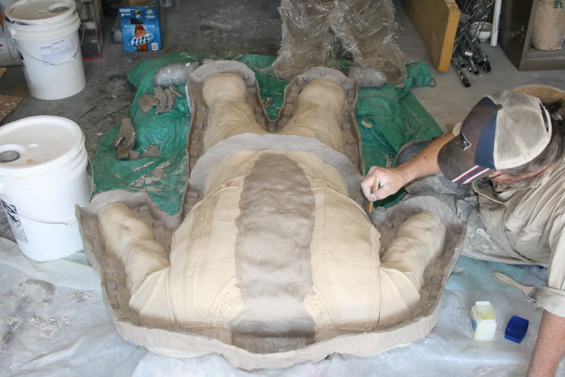

Next day - we flipped the mold, made a few very minor repairs and started building keys and dams to pour the backside upper and lower. Again - not the gap in the middle of the back for the female. I don't think we expect any 56 wide females looking for skins, so Scott made the mold to allow for a narrower build.

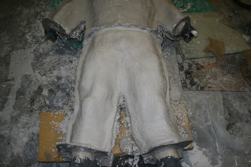

At this point I had to head back to San Diego so Scott would have to fill in the rest. Bottomline, he and Mary finished plastering the backside.... seperated the two pieces.... cleaned the clay from the molds.... and a masterpiece was created.
