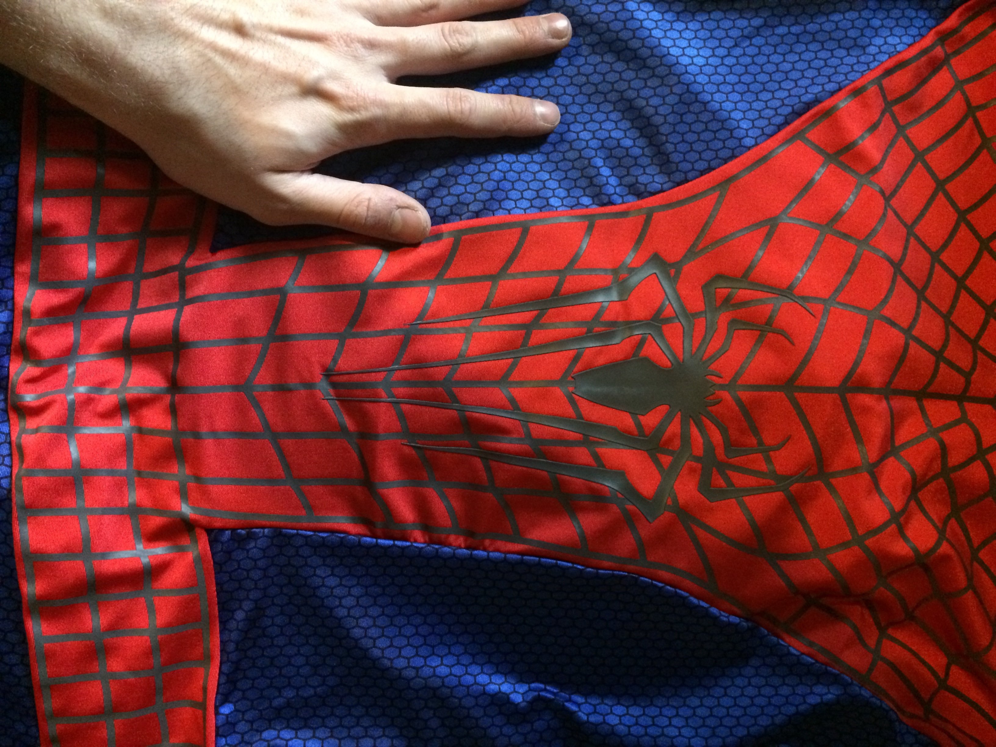

First I started with the base TASM2 zentai from zentaizone.com.
I had it custom tailored so it would fit a little more snug on my body luckily I'm the perfect body size for Peter Parker.

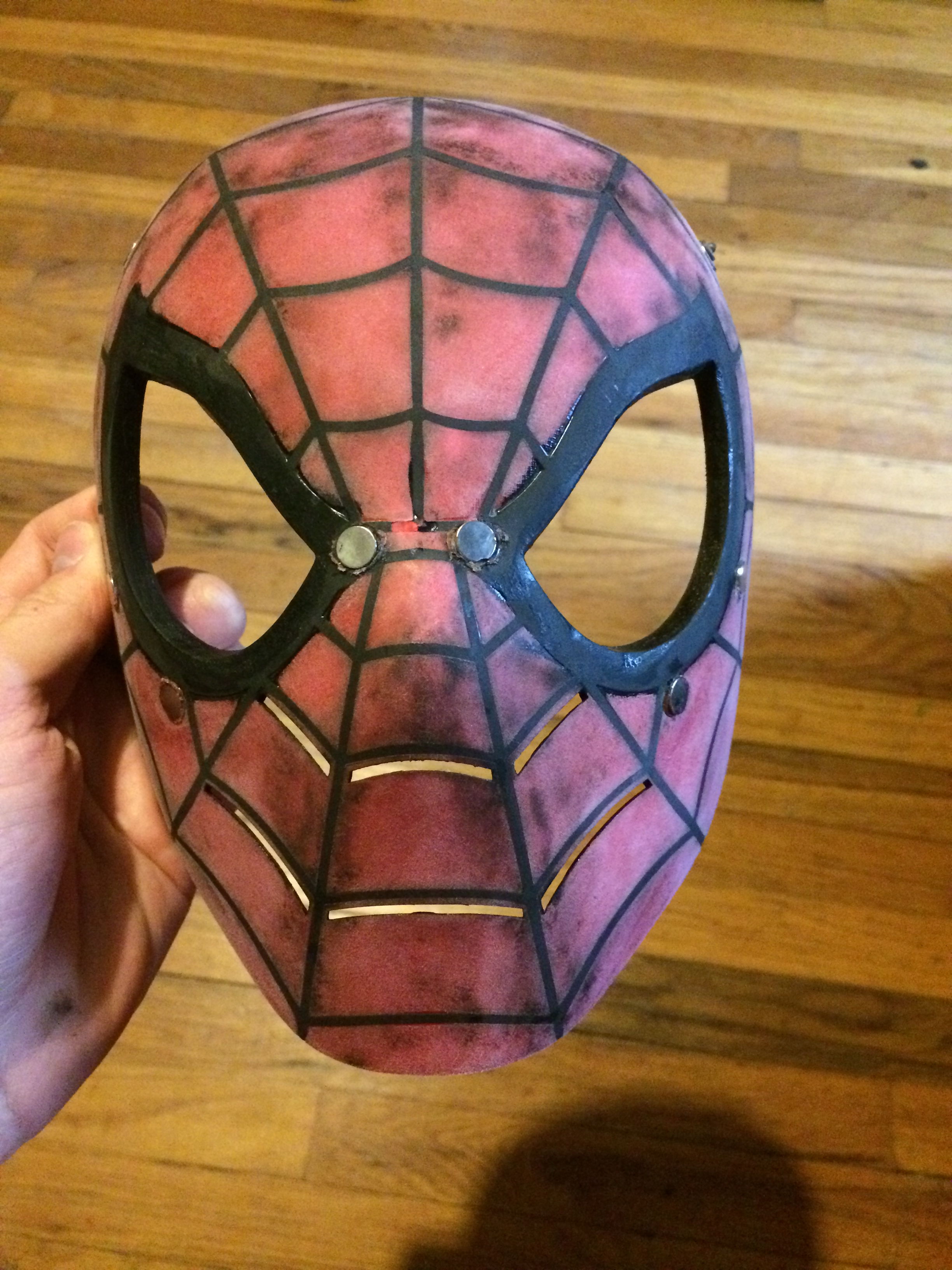

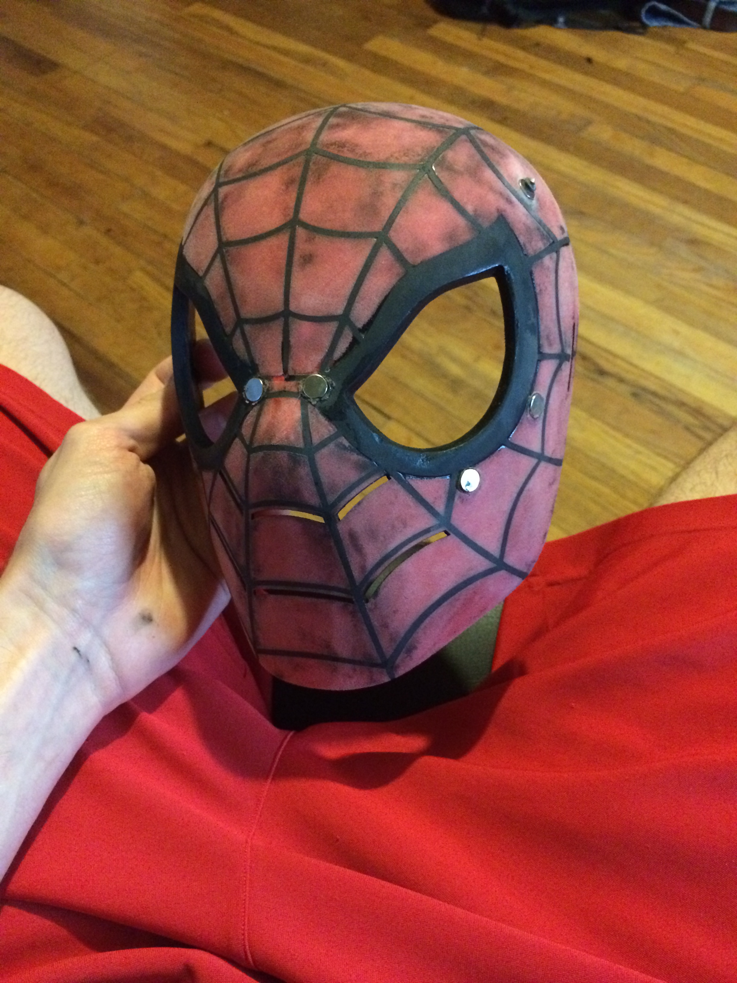

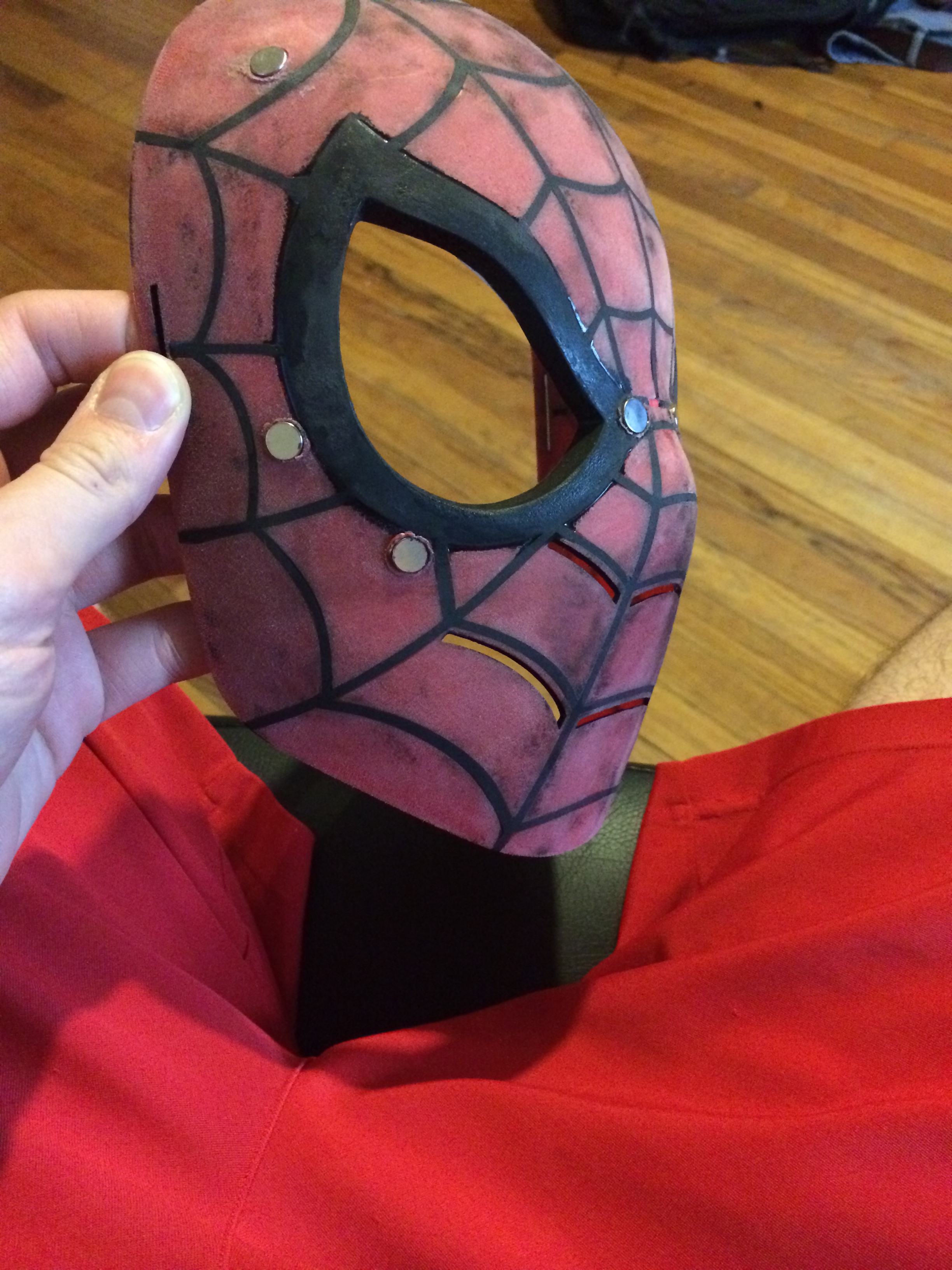

Then I proceeded to build my own face shell out of a cheap amazing spider-man toy mask I picked up for about $10.
I knew the mask needed to be modded so first I took the sander to it to rub off all of the webbing and give the whole mask an even smooth surface.
After that I used a hairdryer to heat up the mask and bend it into a more streamline shape then I rapidly cooled it with cold water so it would hold its form.
Then I carefully made holes in the plastic so I could attach some small earth magnets in the appropriate places in order to attach the eyes later.
Here is the finished product

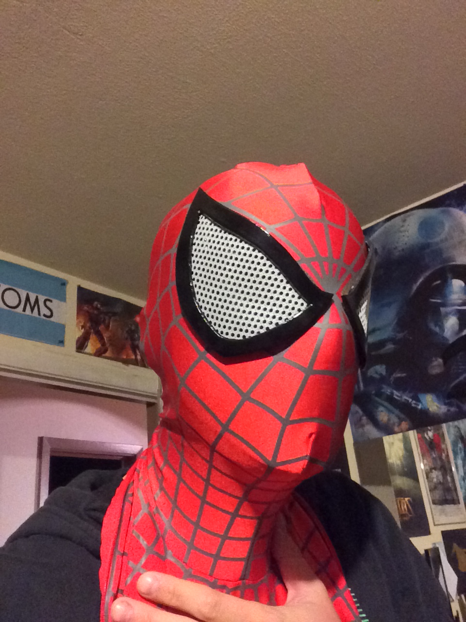

After that I tackled the problem of the eyes.
I did some research and found some great pre-made products here on the RPF and but in the end money was tight so I put my ingenuity to the test.

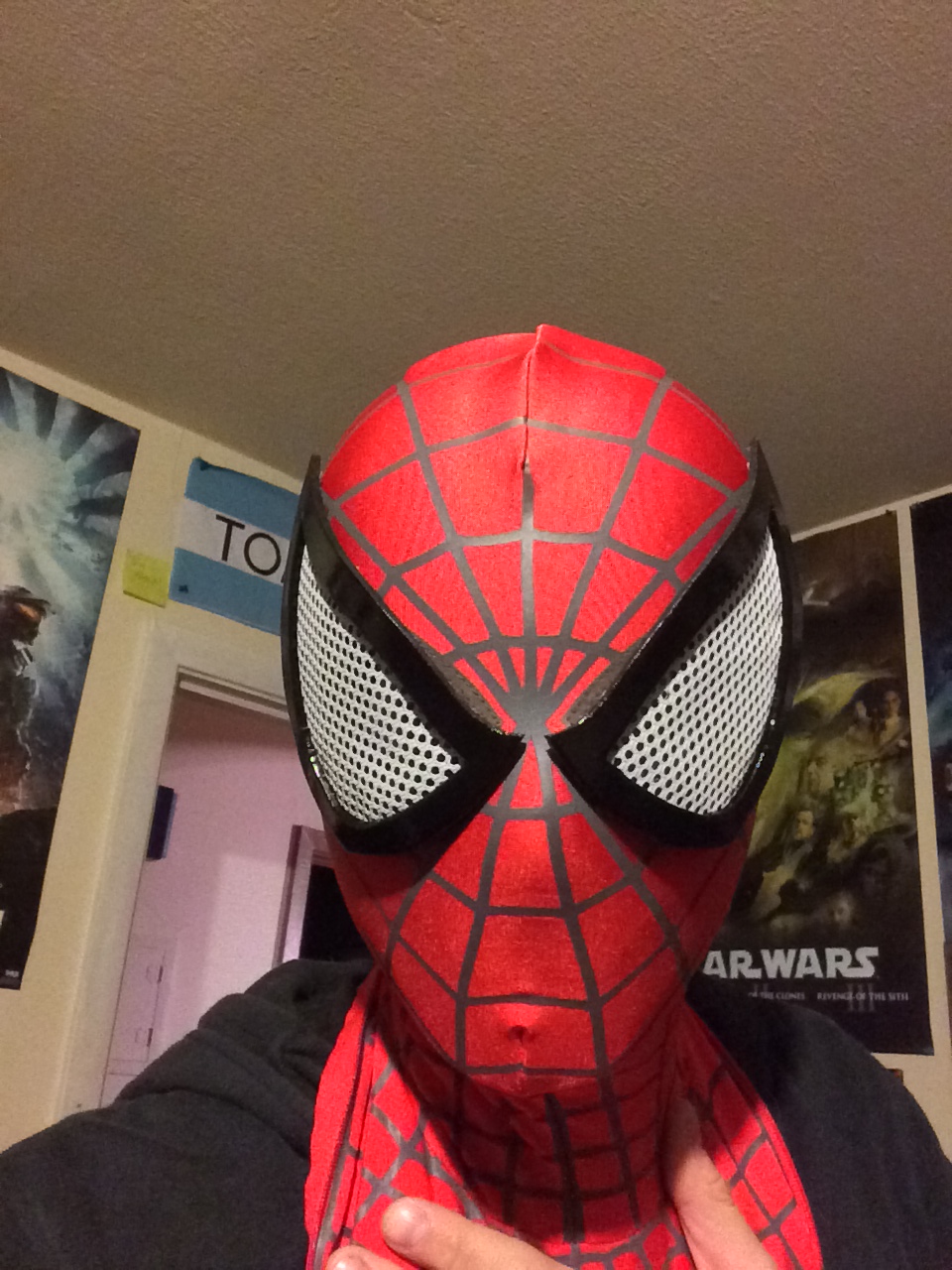

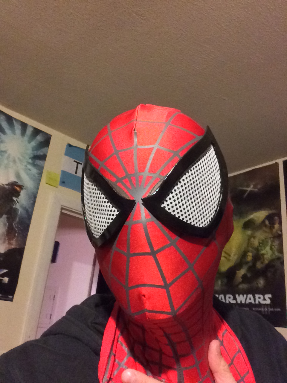

I picked up some medium thickness black craft foam sheets from a local craft store and cut my eyes out from that. I also used some white mesh from a cheap laundry bag and some automotive window tint to create the inner eyes. After gluing them all together in the appropriate order I embedded and glued some small nail heads on the backside so they could be attached to the face shell. Then after a few coats of gloss black paint here is what I came up with.
