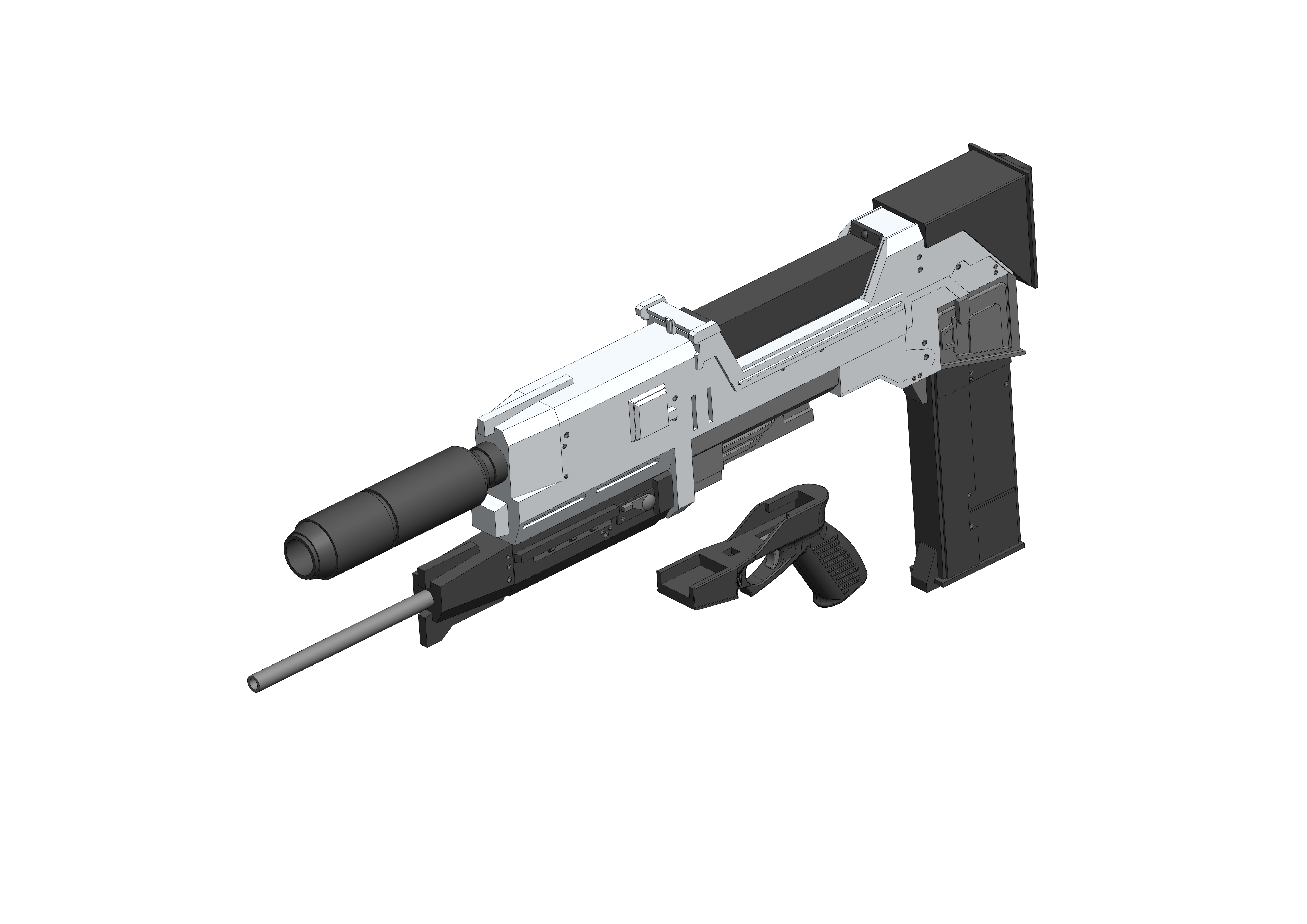

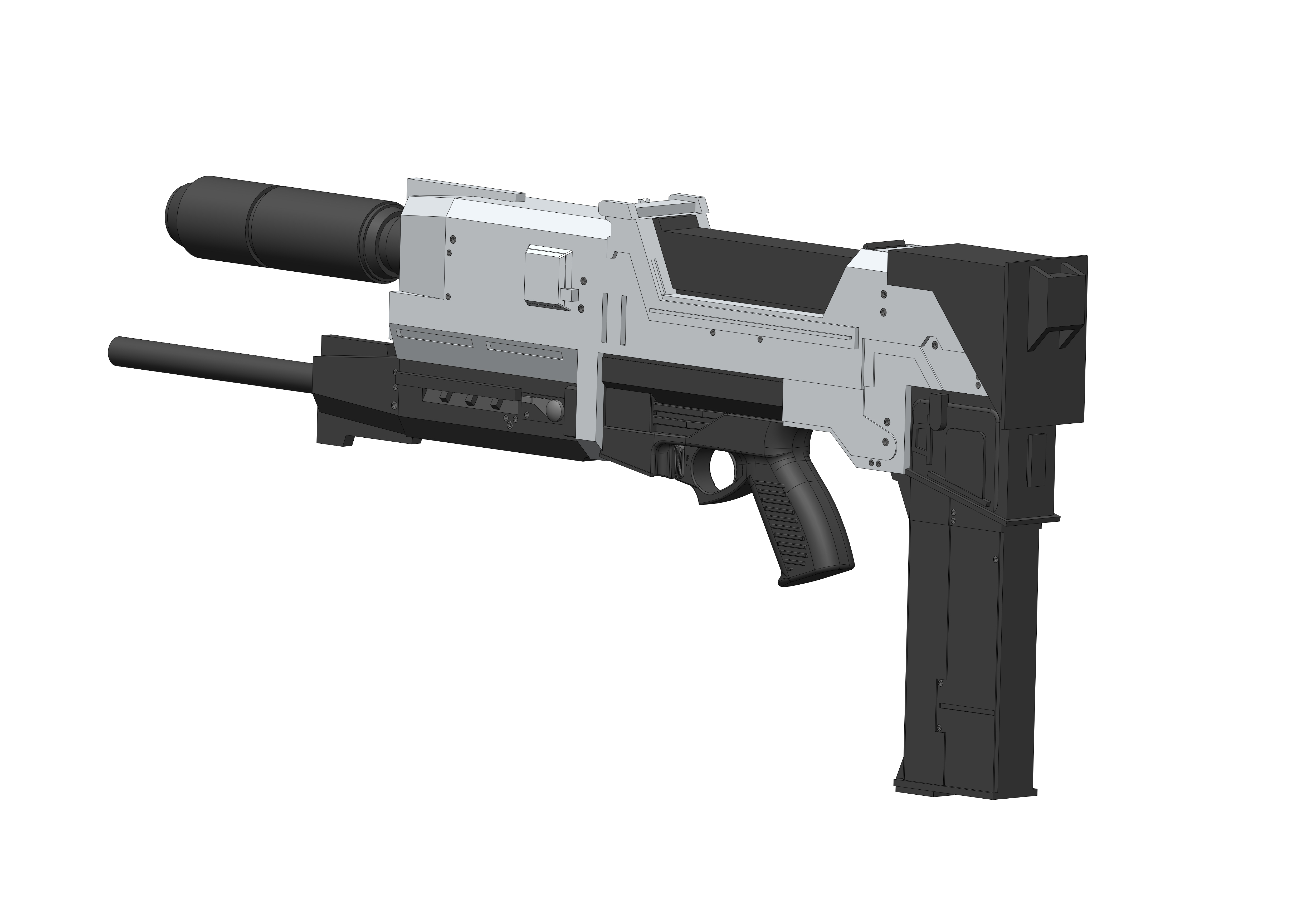

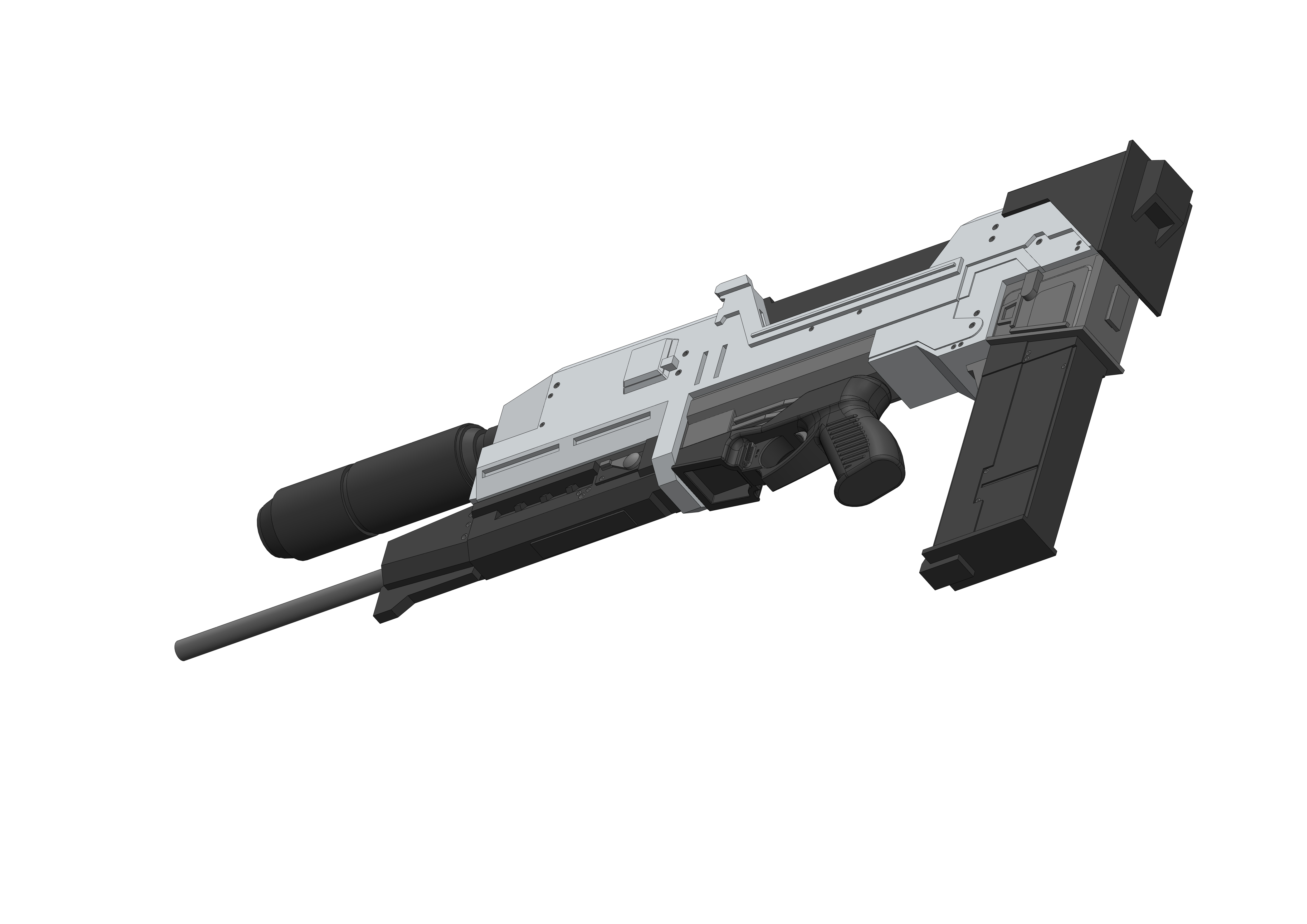

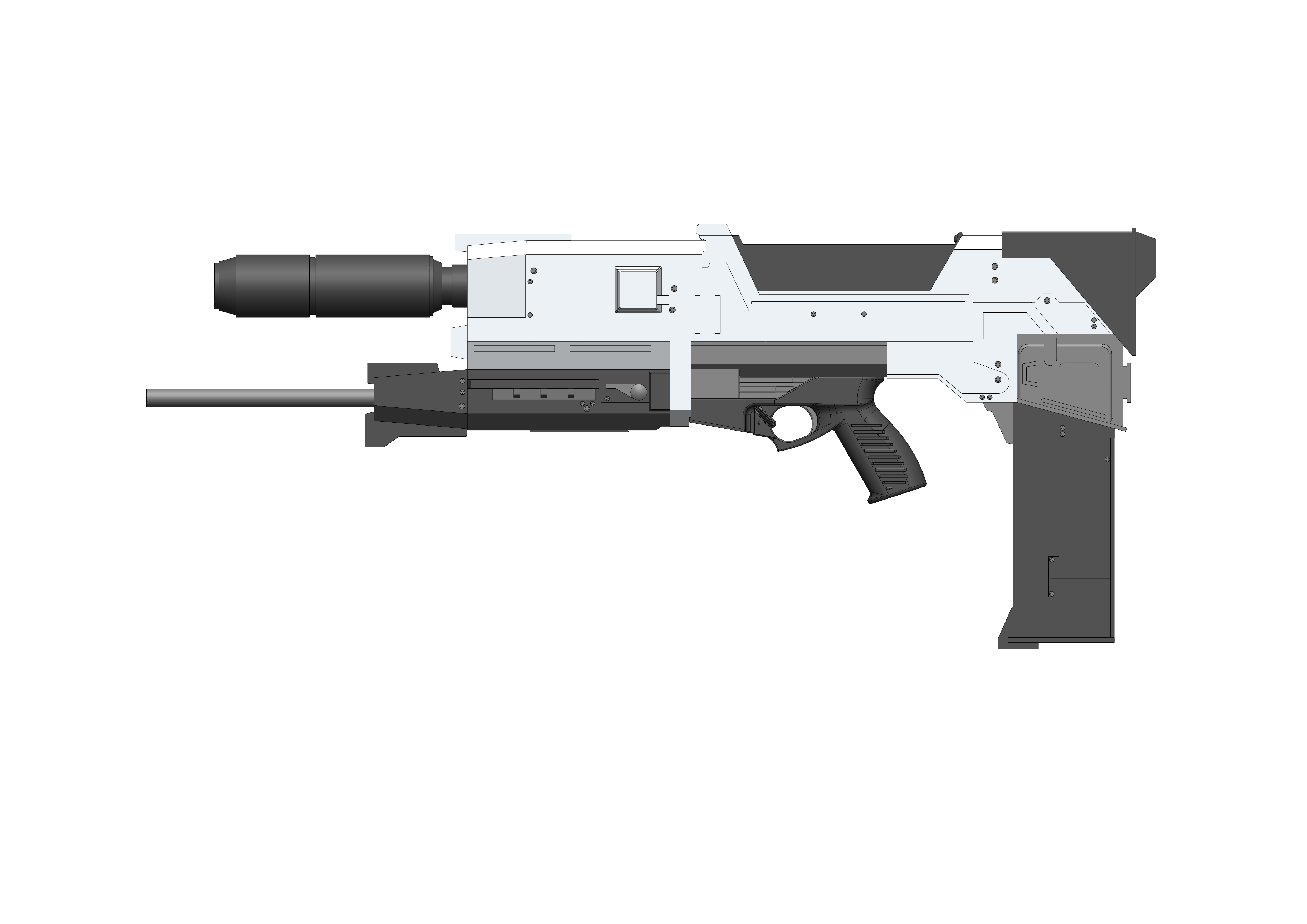

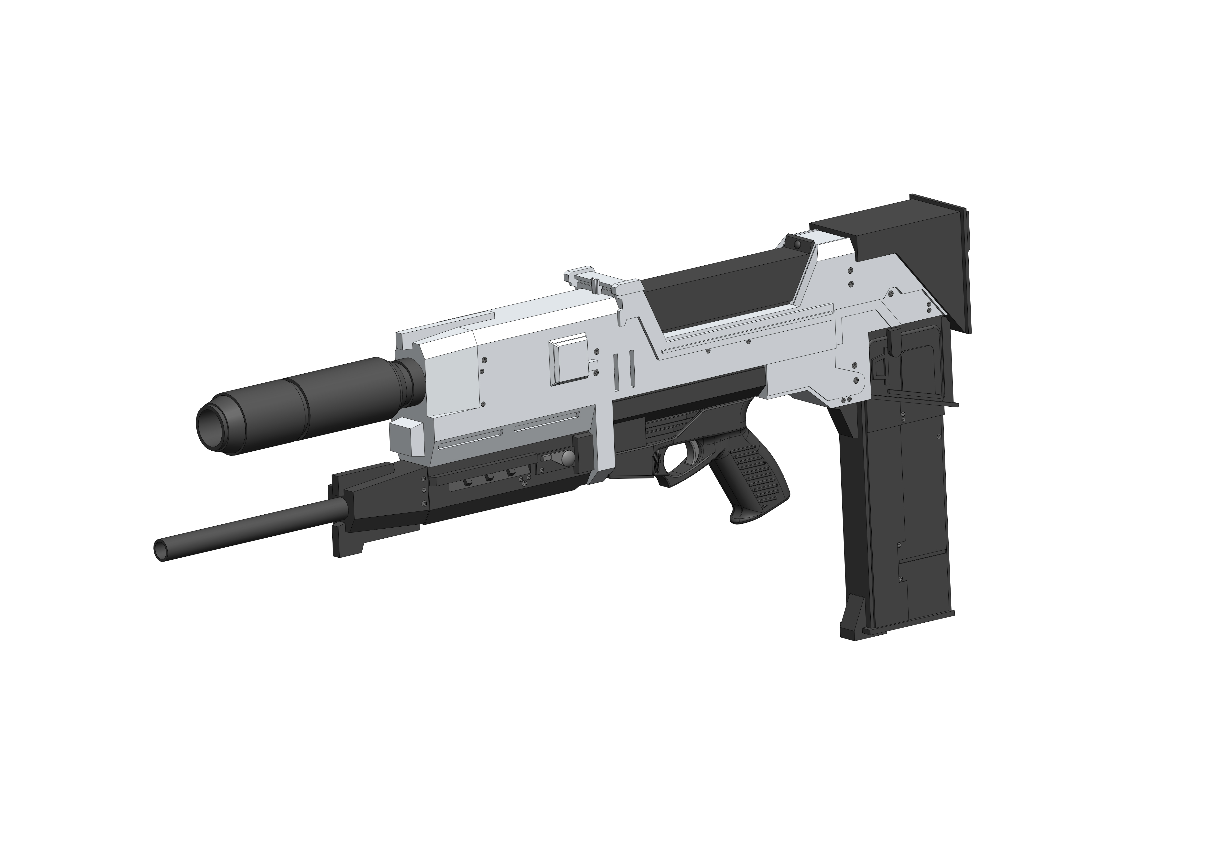

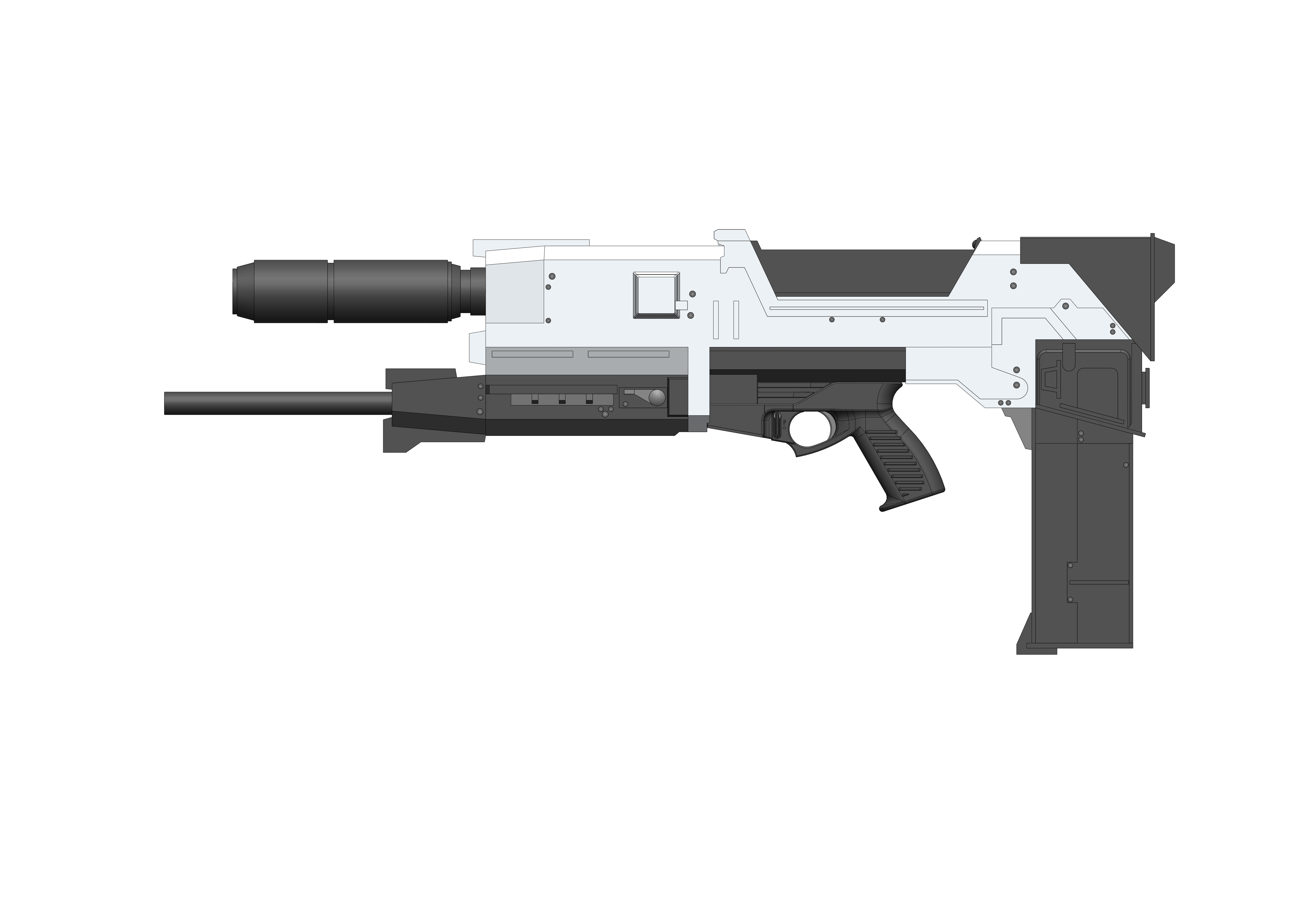

I've been working on this recently, the plan is to have a full-size print with workable selector switches & trigger, and room for an electronics kit.

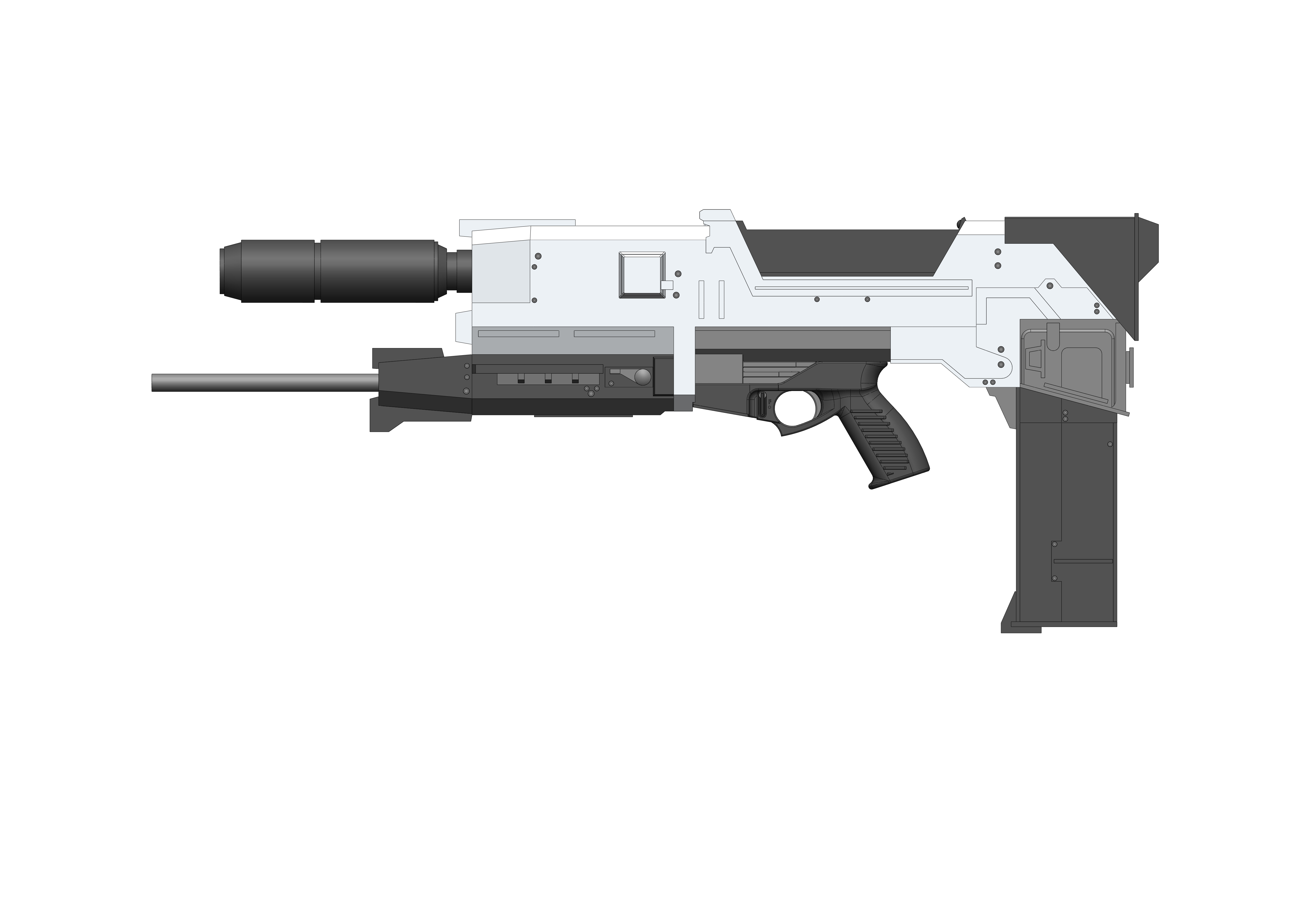

It looks the part, but I'm not sure if my dimensions are correct. (dimensions are in millimeters)
It's based on the pics I found on the Prop Store site, and I pulled and averaged the (measurements) from the 18 inch Neca T800 rifle.
Here's a couple of renders of the model so far.
Thanks for looking!
You should be able to get very accurate size reference for the donor rifle, the Calico SMG and build off those measurements.
Cool, Thanks!

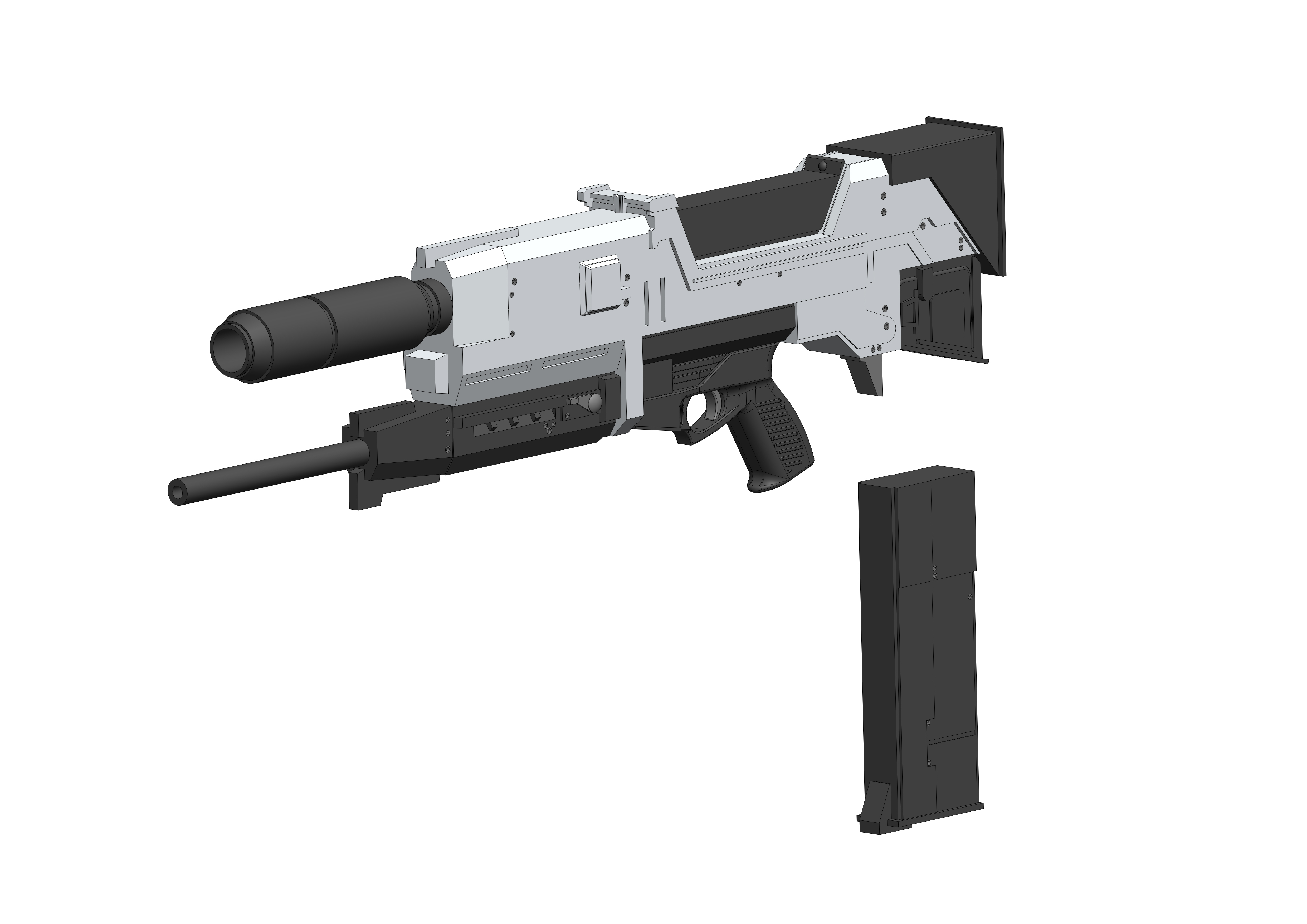

Looks awesome. Hope you'll create it with a detachable magazine.
On the bottom barrel, the bottom thin prong needs to have one of the edges angled a bit more, instead of being almost vertical.
Thanks!
I was working on that exact feature earlier!
I'm not sure what detail goes on top of the magazine, though. Some sort of battery terminal, I guess?
You're right about the lower barrel prong. Here's a quick adjustment.
Im working on a recast from an original, but I think it is a little small from recasting. It is roughly 26.5 inches in length. If that helps.
I would say an original is a little larger.

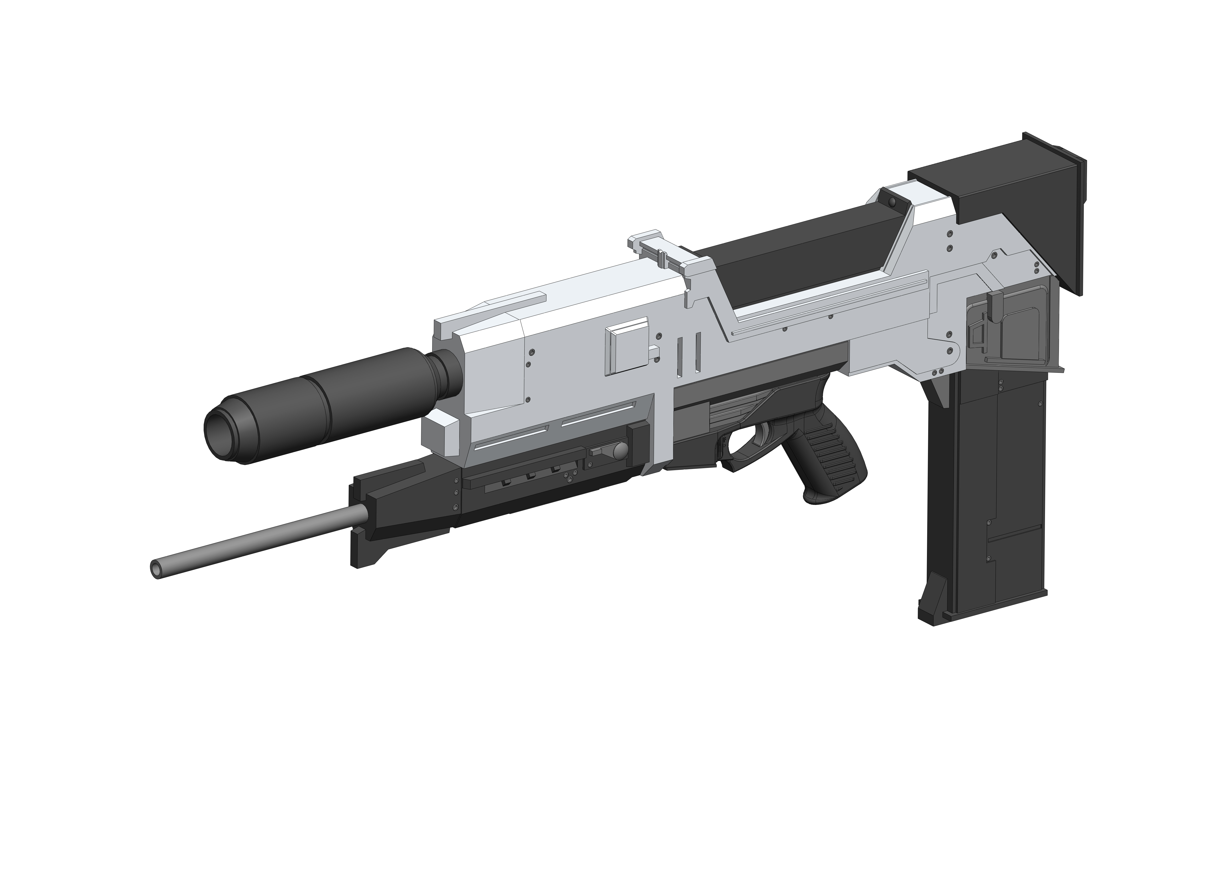

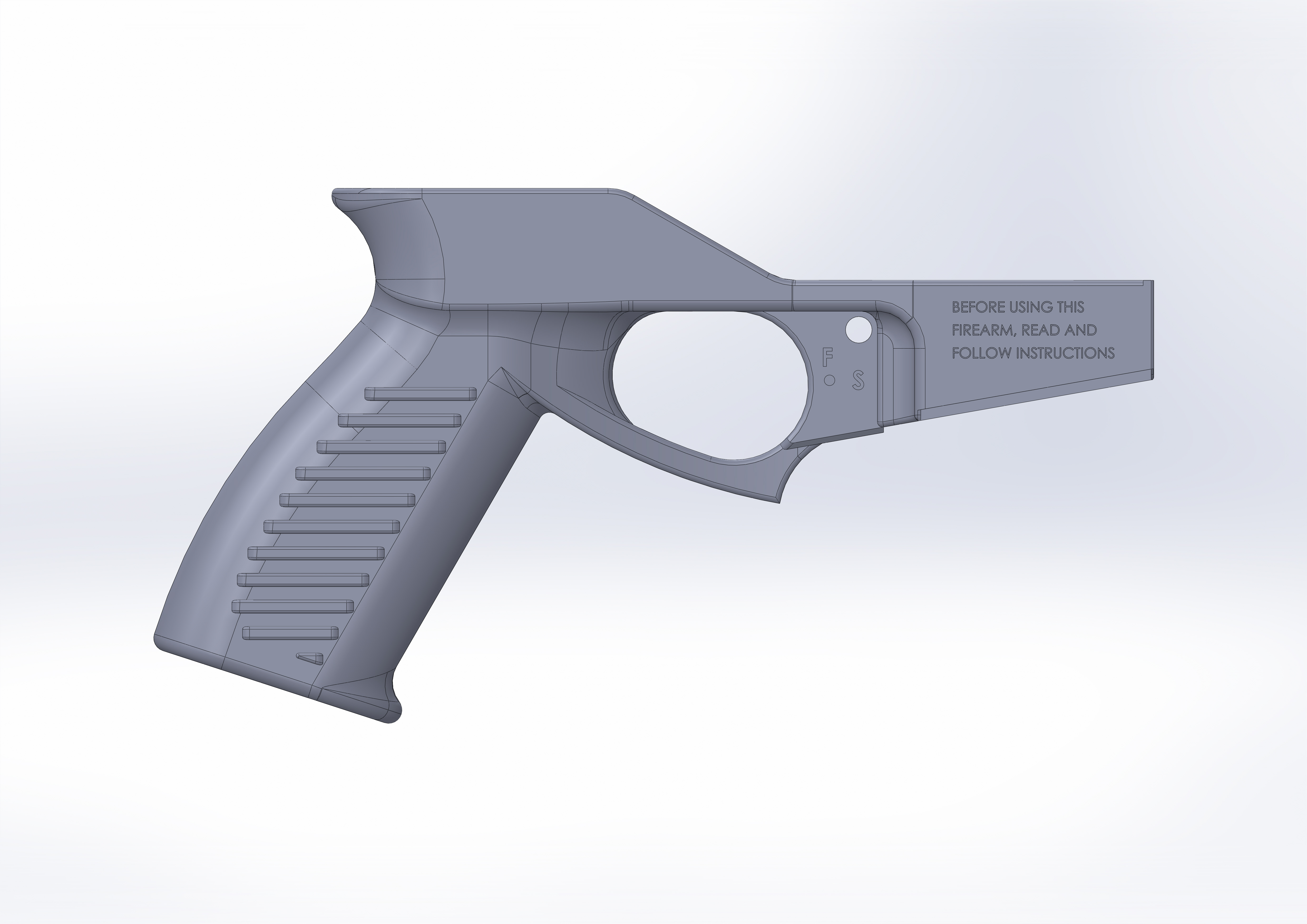

I made some provisions for moving parts in the grip section.
The rest of it will get the same treatment eventually - it almost feels like I'm making a real functional one.

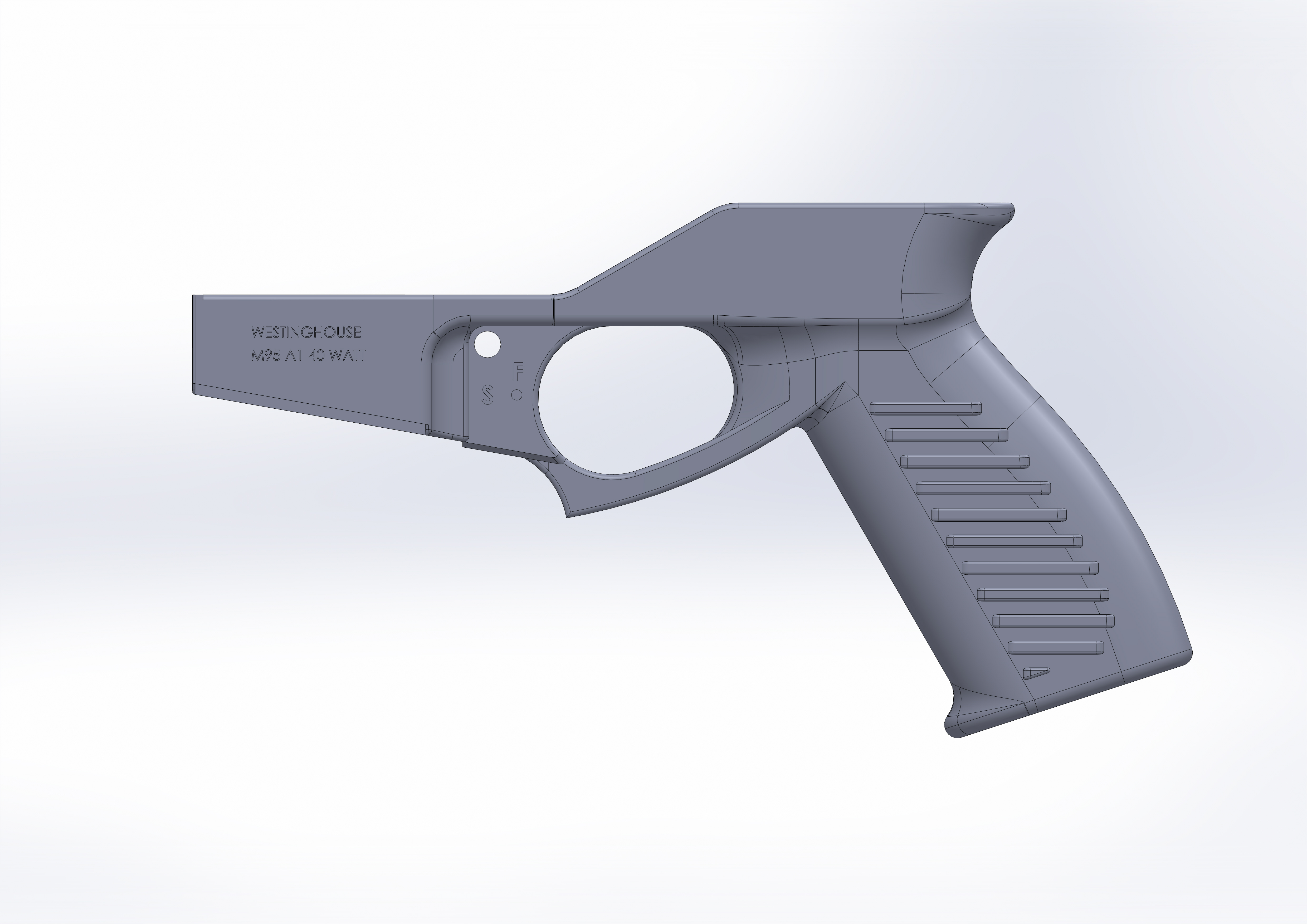

The fire selector now has a "safe" position!
Added some markings on the grip section. I'm not sure if they'll show up on an FDM though.
And maybe something a little more consistent with the prop itself. What do you guys think? (The original text is "Alterations to this firearm are unsafe and illegal").
Looks clean and believable :cool:
Just my $0.02, I'd think about removing the word 'firearm' from the right side stamping ... not from an "b scared o'da ATF!1!!11" [which I'm sure isn't a problem in the Philippines], but rather because it's more of a "laser pew pew", than a firearm, per se ...
Maybe something shorter like "Before use, read the operator's manual"?
Looking cool. I believe Propstore has pictures of their endo rifle sales with measurements included. Better to go with those.
For the top of the magazine, perhaps carve in the circuit board lines as seen in printer cartridges along with a nossle like opening where the material comes out to form the plasma. Though... it will probably never be seen much, so probably no need to go crazy detailed.
I don`t know, as a Terminator, if you need that kind of warning on your weapon;) I don`t think that they would have a safety on that baby!
