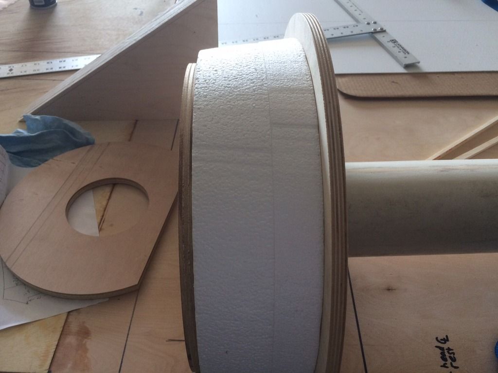

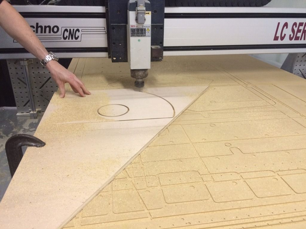

The cannons between the rear engine box and the front gun box changes dimension about 10 times over 3-1/2 feet. Each transition is a separately made combination of plywood frames and styrofoam bulk support rings. The fastest and most accurate way for us to cut these plywood frame is on the CNC router table. Hand routering or jig sawing them would work but would be much less precise. We tested the first piece on a left over piece of the 12mm plywood before committing a full sheet to the machine.
With a test front and rear frame, we glued and nailed three 9" long spacers in place. The rest of the open void will be filled in with foam to support the .090" thick fiberglass skin that will get wrapped around the frames.
Once satisfied of the fit, we cut the next batch. Inside and concentric to the O.D., each frame has a 4.560" hole cut that is center-line positioned 3-1/2 inches off the flat bottom wing deck.
This center hole is what will perfectly align each section on a center support alignment tube that allows the 12 foot long aluminum gun barrel to slide inside and run to the rear anchor point. The support tube is a 4" I.D. schedule 80 PVC pipe. The problem is, a perfect 4" outside diameter (O.D.) aluminum tube can't fit inside of a perfect 4" inside diameter (I.D.) PVC tube. The tolerances are just too tight, and we need to be able to remove the aluminum gun barrel for transportation and repair work. The solution was to split the PVC tube down its length using the rotary saw. We pried open this cut line and glued in 1/4" wide wood shims. This opened the I.D. about .030" and made the two fits very snug, but removable. So far we have been using Gorilla clue for the foam and wood work. This is our first time using this water activated urethane glue and we are very impressed with its versatility.

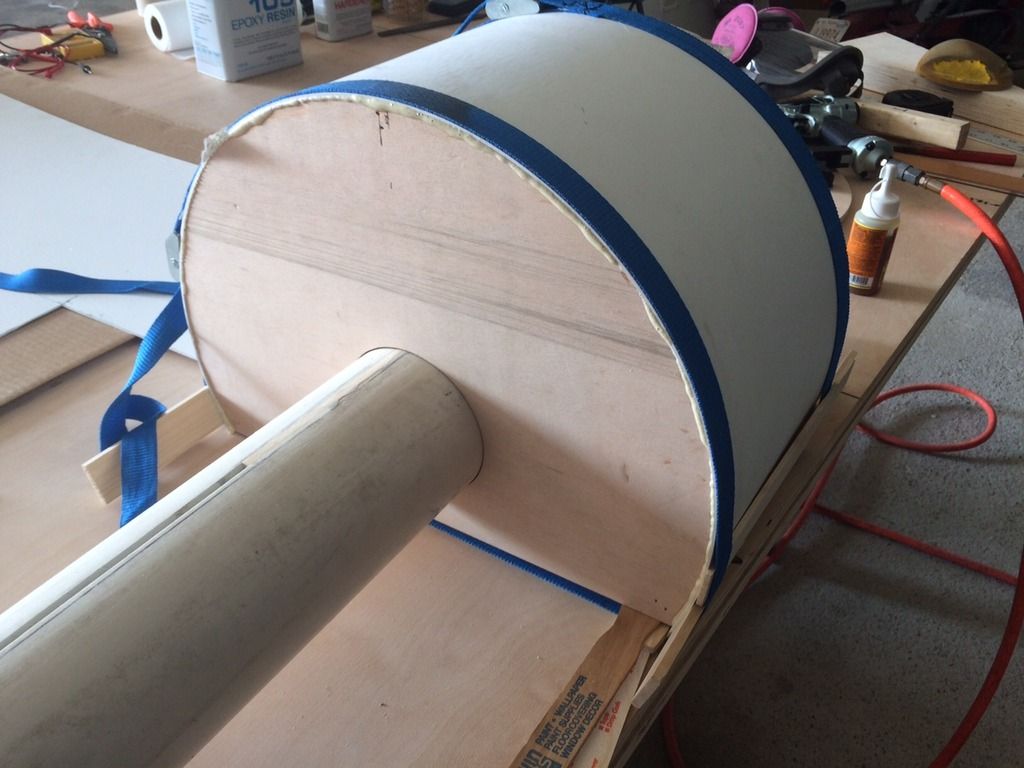

The foaming bubbles that are at the edge of the wood and the fiberglass skin is the Gorilla glue after it has activated and expanded. It's great for filling loose fitting joints or gaps in the foam support frames. After it dries, it is easily sanded or razor blade scraped off. Less expensive than epoxy, and quicker to work with since there is no measuring and mixing of A & B parts.
This is the largest drum diameter of the cannon body. 17.375" diameter by 10" long. The drum is glued into place on the PVC alignment tube. We'll start building the other diameters and assembling them the same manor. The blue tie down straps keep tension on the skin while the glue sets up over a 30 to 60 minute period.

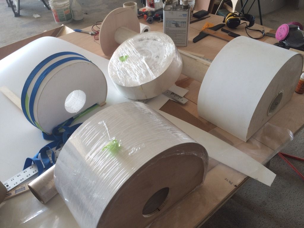

Building more of the cannon sections. The next step down is a tapered 2-1/2" long section.
Same process for the flat sections of the 4 and 5-1/2 inch long sections. We only have two blue straps so the others are being held in place by pallet stretch wrap. It's been a useful tool for holding parts together while waiting for the resin or adhesive to kick.

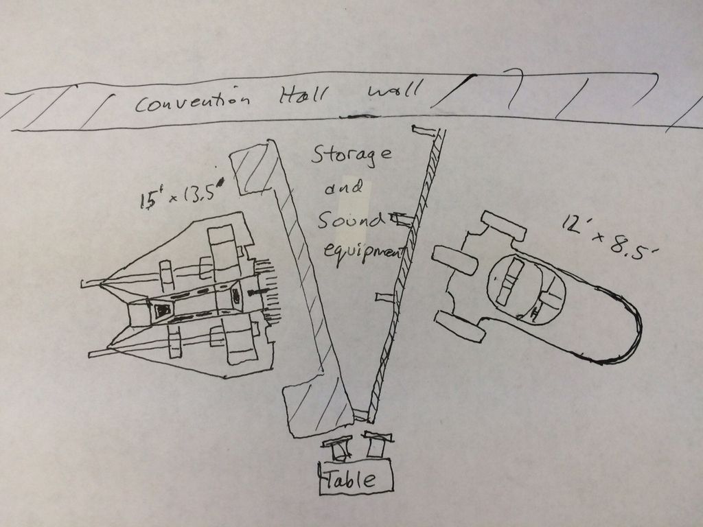

Talking with the ComicPalooza owner again today about how they want to stage us. I sent him this quick drawing of how he might consider setting us up in the room.

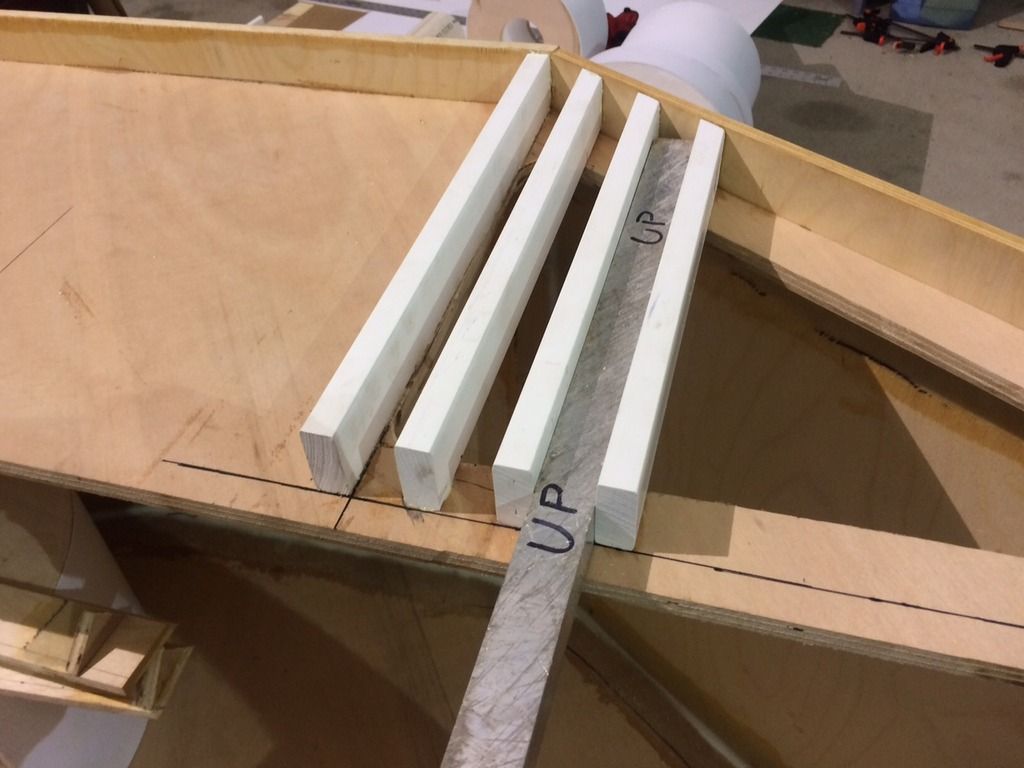

Cutting and applying the grills on 1" centers. 3/4" wide by 1-1/2" expanded styrene plastic grill bars. Great stuff, stable and solid to machine.
Gorilla Glue and 2" air nails. Speedy and precise.

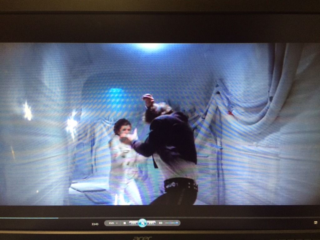

I found out how to do a screen grab from a DVD on my computer. The secret is, "ask a 14 year old." They know everything. We watched all of the Hoth interior scenes to get a better feel for how the ice craved walls looked. We determined everything seems to be made in 4 foot wide panels of random waviness foam panels panted glossy white with a few fake ice cycles added in places. That was exactly how I envisioned building my back drop hanger maintenance bay walls. It's nice to know mine will be produced the same as the original stage ones were.
We've ordered eight 4'x8' x 3inches thick slabs of 2 pound styrofoam from the guys that supply our regular packaging foam. We will cut the wavy lines in it with a 4' wide hot wire bowsaw.

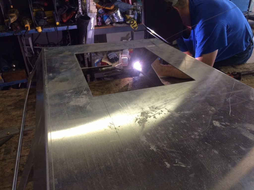

Welding aluminum is an art that we haven't mastered yet. Mostly we need a proper TIG welding unit and a higher amperage feed to the circuit box. The artist that did the welding laid down a beautiful 100% coverage bead along the two front panes of the canopy and the rear canopy mount housing.
As much as I admire the rugged, industrial raw look of that weld, the speeder canopy is supposed to have smooth rounder 1/8" radius edges. So out comes the air powered sanding wheels and away we go. Keeping light hand pressure and working an edge on the sander 80 grit and 120 grit pads, removes the high spots of the weld while feathering in the edge of the panel to a sharp angle. After the edge is established, repeated long stroke passes down the length of the edge sculpts a 1/8" radius into the corner that will match the bent folds in the other panels. Making the finished product look uniformly bent and making an observer wondering how it was made. When its done right, all evidence of a welded seam disappears. Ready for some light epoxy primer filler, sanding and paint.

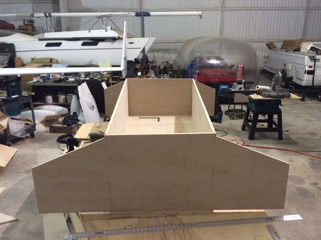

Once we had the canopy completed, it was time to begin the cockpit body and sub-structure frame of the undercarriage. Autocad has been a useful tool for solidifying design ideas that until now, have just been floating in my head. These are the bulkhead sections for the main body tub.
Bug help from you Autocad 2015 experts. At certain zoom levels, my dimensions text have all these random spider web artifacts. As I zoom in and out the disappear and shift about. No biggie, just frustrating.
The front bulkhead. 3/4" plywood.
Temporary 90 degree support braces tacked in place with the nail gun while the urethane glue dried.
Side walls . All 3/4" plywood.
Rear bulkhead. The stubby wings will be the upper supports for the speeders wing panels.
With the canopy in place just to see how it's gonna look when complete.
