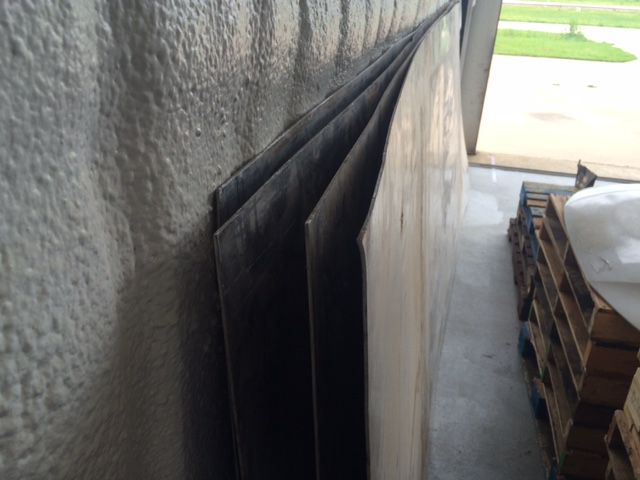

We spent most of the day dragging our 18' trailer through the side streets of downtown Fort Worth, avoiding construction and traffic jams. I'd purchased 300 square feet of 2024 aluminum. 15 feet long by 5 feet wide. .100" thick. Each sheet only weighs about 115 pounds, put each was like wrestling a bear to unload it off the trailer and into position against the front wall. This will be water jet cut into the individual armor plate pieces that will fully cover all of the wood substructure that we have been building. From the outside the speeder will be all aluminum plated. The wings will each weigh well over 200 pounds, of which 85 pounds will be the armor plate.
We had just enough daylight and strength to rough cut 4 panels and then precision saw the 4 stack bundle for the vertical front and back walls of the rear engine boxes. We'll cut the 6 top 26" wide panels tomorrow.
