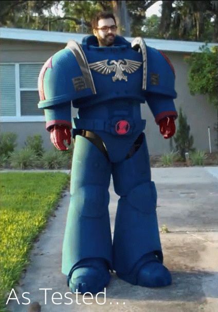

I did some video this afternoon after work. The fit and rigging still needs to be tweaked a TON. Many changes need to be made. The waist is too low, the chest will be moving up a touch, the stilts are too high and make the legs too long, yadda yadda. So don't judge the proportions too much just yet. Enjoy the show.
And here is a quick and dirty photoshop I did to explain the edits on the rigging I intend to make. It should help the arms look a bit longer. Still not perfect, but plenty acceptable in my eyes.
They do need to be longer. They aren't complete and the proportions are still off. They will always be a bit short, as I intend to keep the use of my hands. I do have plans that should help alleviate some of the problem though. A giant gun will take attention away from the arms as well
Alright! Here is the plan. The shoulders are moving up a bit. This will expose more forearm. The midsection is moving upwards even more. This will raise the waist of the costume. With the waist higher, the hands will break high in the thigh instead of the waist band.
All this means that the stilts will be shortened by about 2"-3". It's a welcome change, it means a lighter stilt and a more natural gait.
All in all I think these changes will have me looking much closer to anatomically correct and still have the use of my hands. Which is the goal.

After some welcome constructive criticism I took the plunge and hacked into my shoulders. I had trimmed 4" off of the height during assembly, but did not remove any width. This made they out of proportion. I suspected as much, but it wasn't ready to fix it until Tango89er shared my concern over the disproportionate width.
This was a pretty hard thing to do honestly. Hard to cut into something I had spent so much time on, and hard simply because it proved to be a real pain in the butt construction wise. But I think the results were worth it.
I think that the adjustments to the shoulders have definately helped the proportions, but the suit might look a bit more balanced once you have a helmet in place.
I have been working on the arms a bit, but mostly on the fit and function of what I already have.
MY stilts got chopped down over 3". This moved the waist up to where I wanted it and helped make the arms look much longer. Also, the shoulder chop-job I did was a big success in my opinion. Thanks for the feed back on that.
