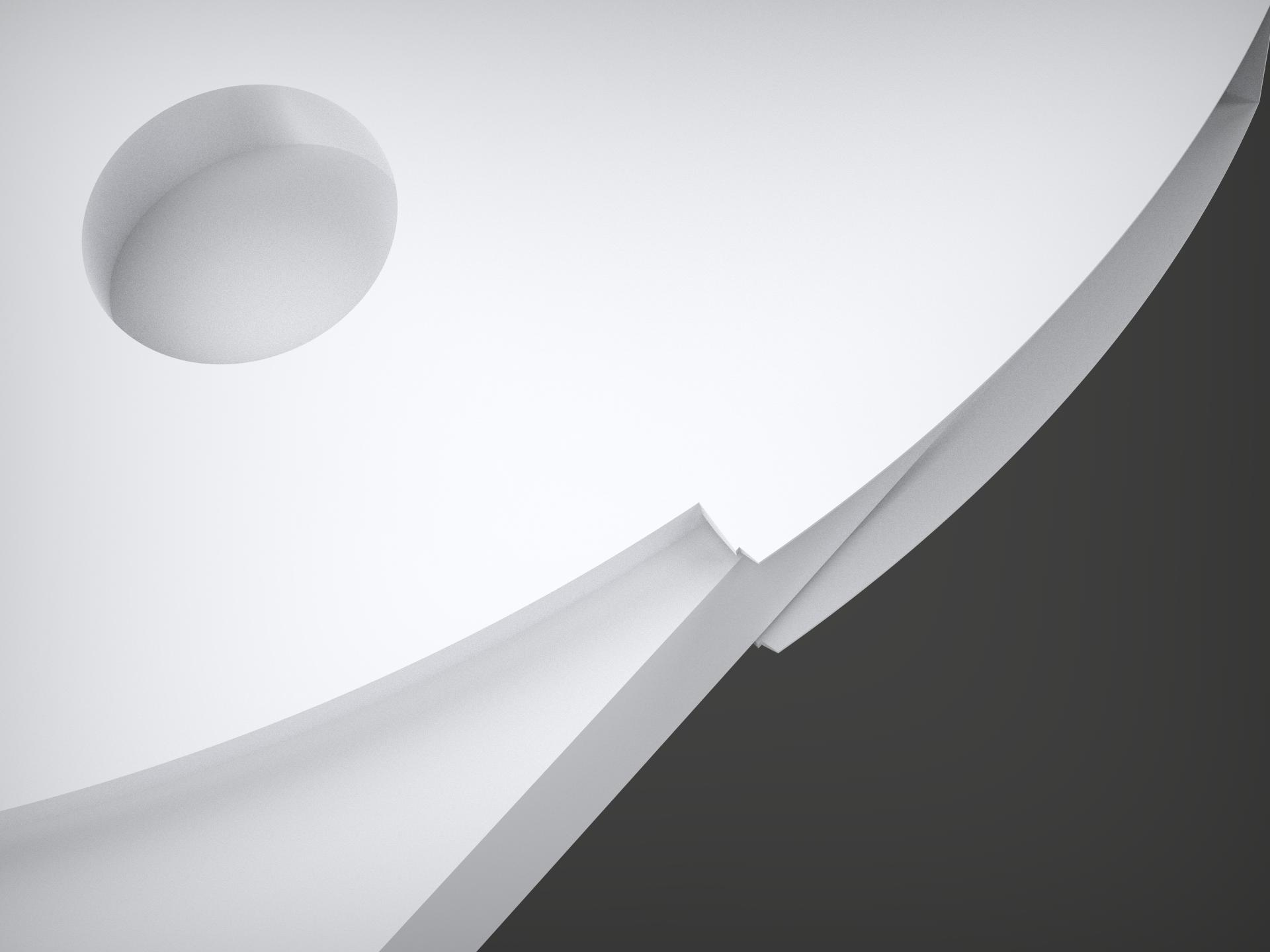

I updated our master model (both the 3D version and the PDF drawing) to version 1.1 - the main change being the forward cutout on the domes. It is doglegged; with the inner segment being radial and the outer segment being perpendicular to the mandible side wall. This last bit is 26.75" from the mandible nose and locates the Wankel transmission back edge.
https://grabcad.com/library/millennium-falcon-master-model-anh-version-1

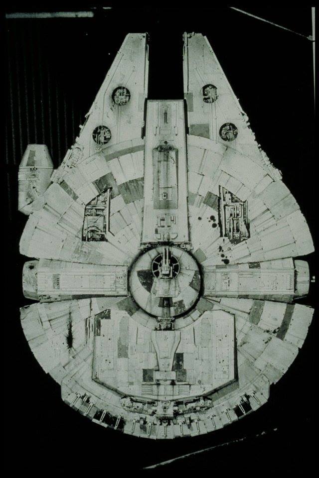

btw, I ran into this image the other day and thought it might be useful to some people here as well...
imurme
Oh Nice ! Thanks Imurme, This will definitely help with those bottom bays. Pics of the bottom of the ANH version are rare as hens teeth, Cheers,
Joe
Is that the 5-footer underside? --- what a fantastic shot, Imurme, I've never seen this before! Beautiful cannons and maintenance openings. The toe-in angle doesn't seem too pronounced - maybe the camera angle?
Yup, the 5-footer. The 32" always had the extra forward landing gear 'boxes'.
Irurme, what is the source, please? The file name looks like a Flicker notation (btw, if you replace the "n" at the end with an "o" sometimes you can get an original sized image...little Flickr 'hack')
Regards, Robert
Regards, Robert
I found that image while looking thru a Facebook page (SciFi2000)...there were a few more there:
https://www.facebook.com/media/set/?set=oa.779750862072499&type=1
