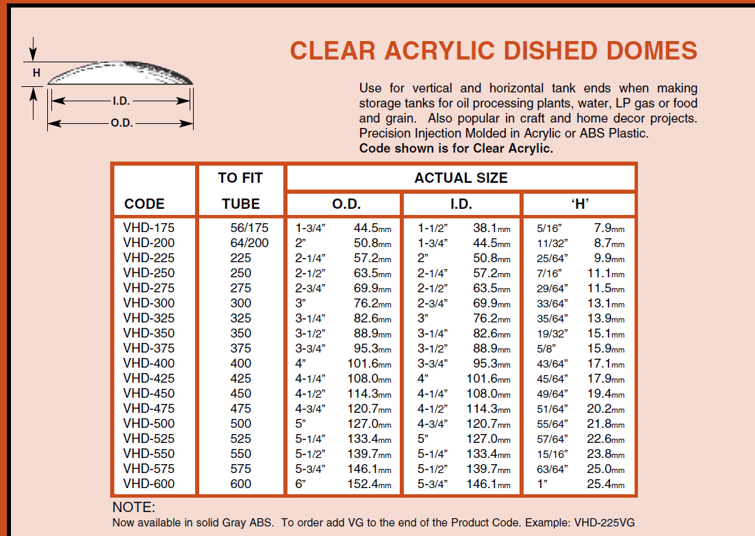

The elliptical domes are too deep, I'm afraid. I modeled and did some 3D track matching to the clear acrylic dished domes dimensions
I believe VHD-600 is the one we want for the "5 footer"...

Thanks Guys, I thought they looked thick, ;) Love this thread, many things are being uncovered. Cheers,

That's the correct dish size
However I'm not sure about the base diameter. I don't think it's that large unless you mean the outermost part. And still...

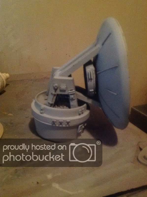

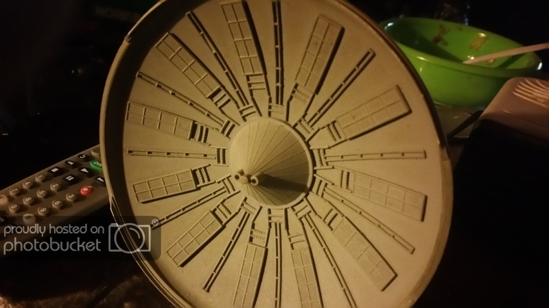

Unfortunately I made my dish before I started doing step by step pics. But I'll look thru my old stuff and see if I can help. I don't remember which dish it was but I do remember the diameter was 6 inches and it wasn't a very deep one. I do know that I made the dish base from pretty thick acrylic mostly. That was done to make it sturdy.

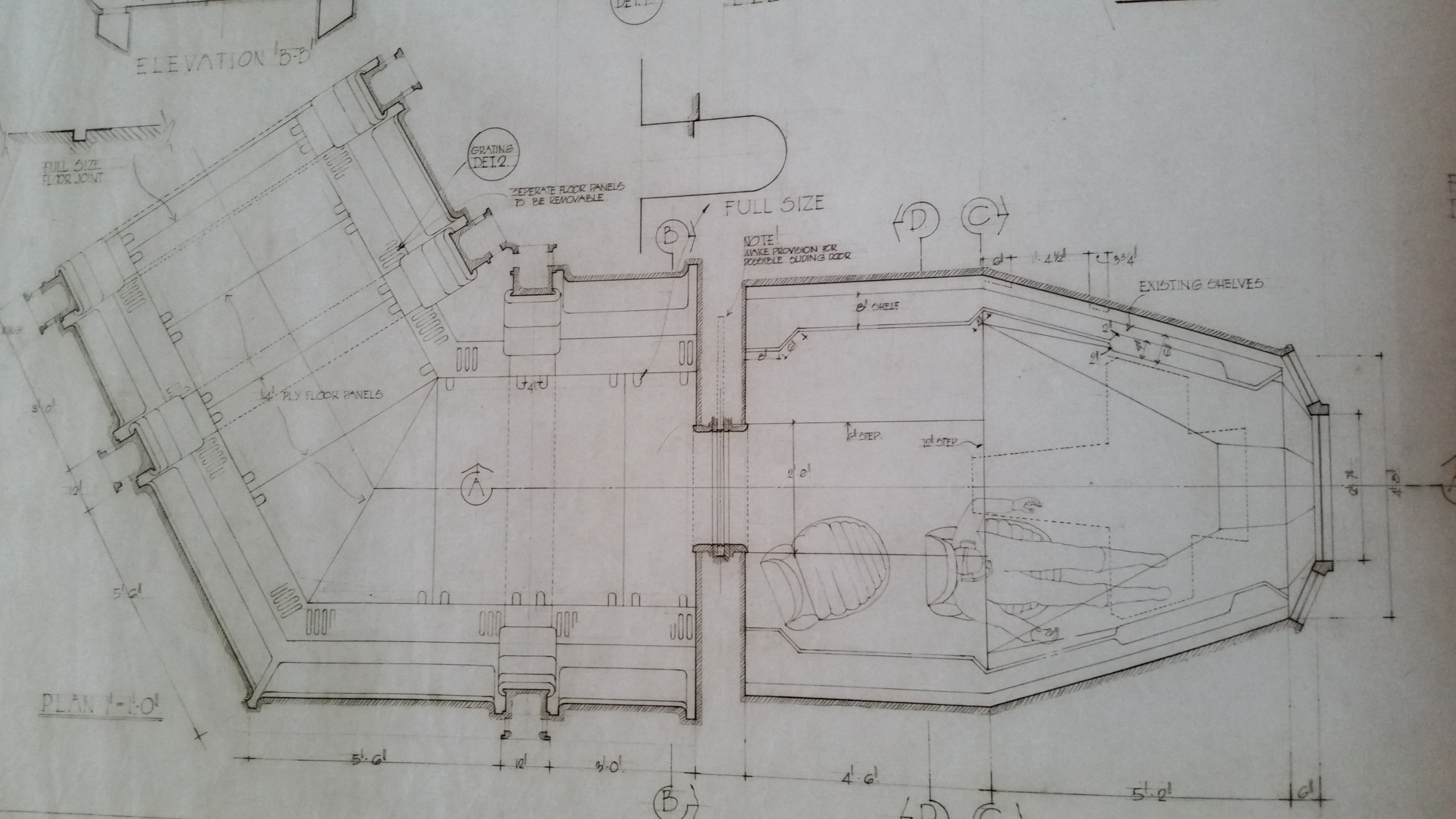

Here are 2 photos of the plans of the cockpit of the Falcon , always from the books I have !
I'll try to scan later with a hand scanner, maybe will be clearer for you :)
