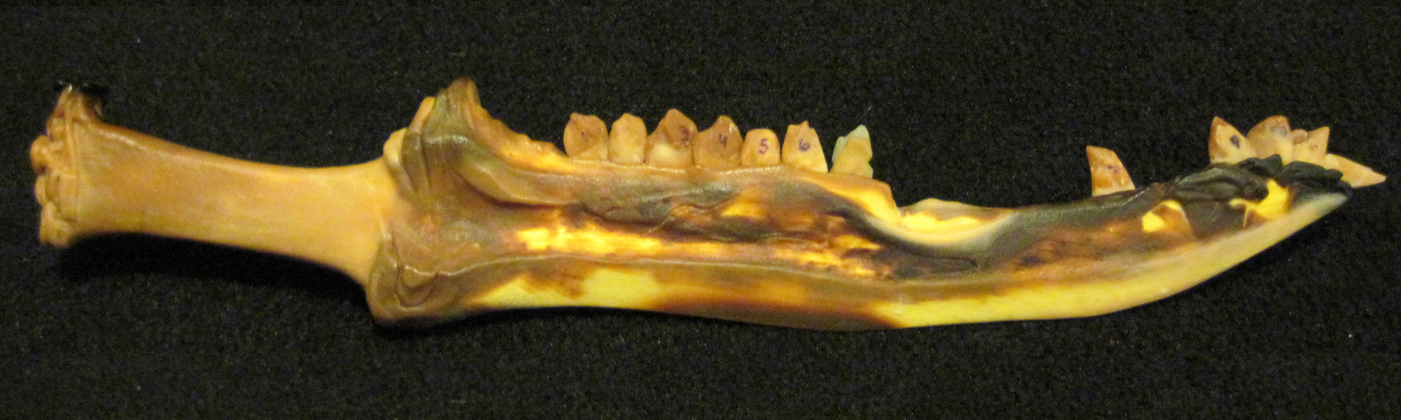

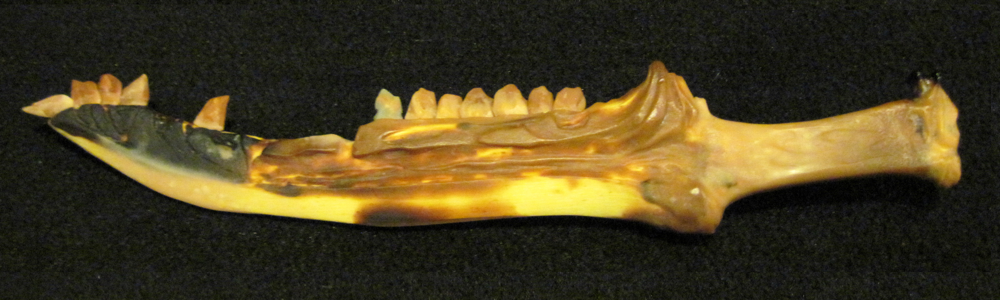

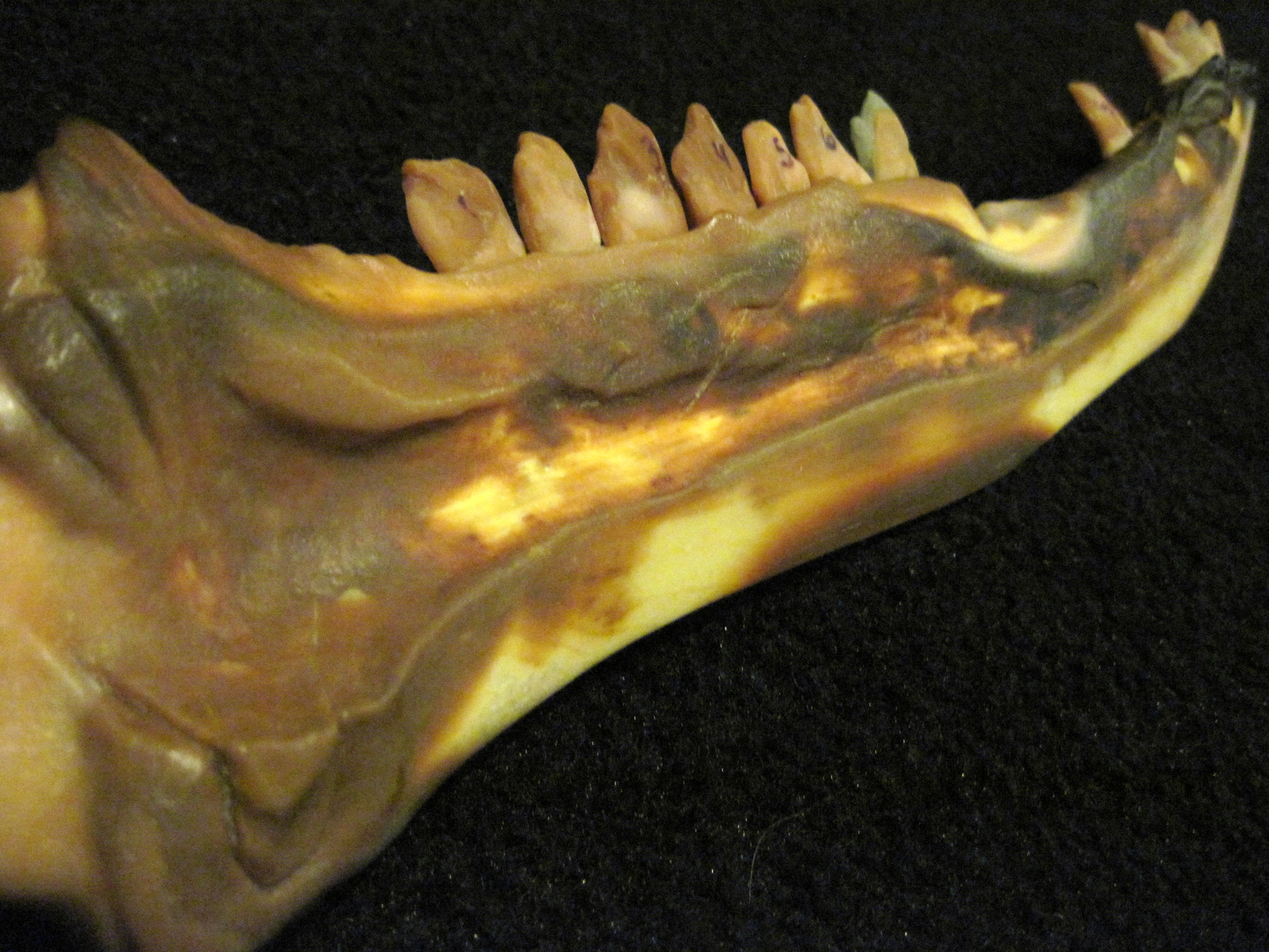

It's super difficult to see detail and texture in these because some of the Sculpey is the dark stuff, and some of it is Liquid Sculpey which is transparent, but here are some much better shots of the blade. I do believe the sculpt to be finished, unless anyone has ideas on how it might be improved. I'd love to do at least a primer coat of some sort, but I don't want some paint to screw with the moldmaking process...
Holy crap, that looks great! I bought my materials to start mine earlier this week, but if I can't get it to look the way I want (not the best artist), I'd totally love one of the kits!
Also, what kind of sculpey is that? I wasn't sure how much I would need so I bought 2 large blocks of terra cotta original sculpey instead of buying a lot of small packs of the colored Sculpey III.
As far as I know a proper primer coat shouldn't mess anything up, but I would check with a better resource before you do anything.
I don't know - I've never liked working with ORIGINAL Sculpey - it's like trying to sculpt with whipped cream. Super Sculpey is pliable without mushing when you touch it accidentally. And the firm version allows for very specific line/detail work.

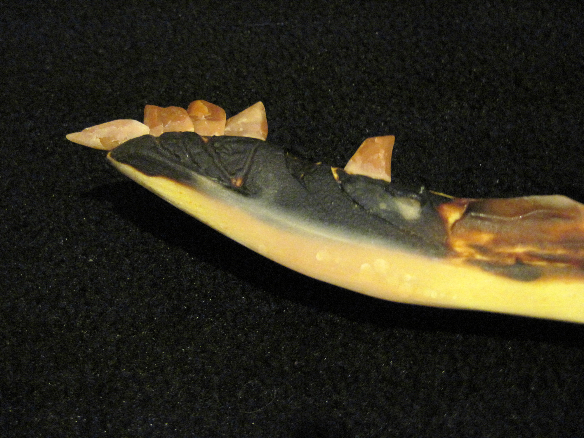

Going to go ahead and wrap up my paint job in the next few days and get some ACTUAL pictures up. I must admit, it's looking pretty good.
Here's a crappy detail shot:
