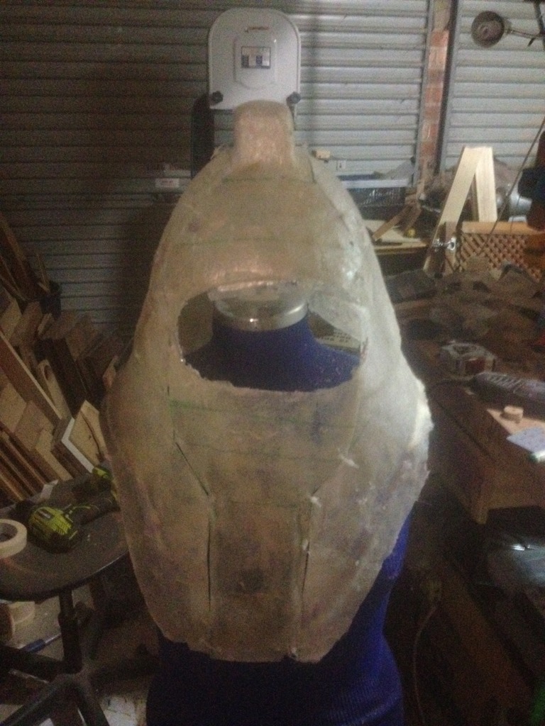

Its been a long time since i have worked on this costume because of other commitments.
I glassed helmet and i have finnally pulled all the crap out of the centre of it. I pulled the expanding foam and paper mache out. Now im left with a hollow shell :D
The next thing was cutting sections out to make it thinner to fit my build.
I hope you guys enjoy. I have a lot of glassing to go and then paint :D
