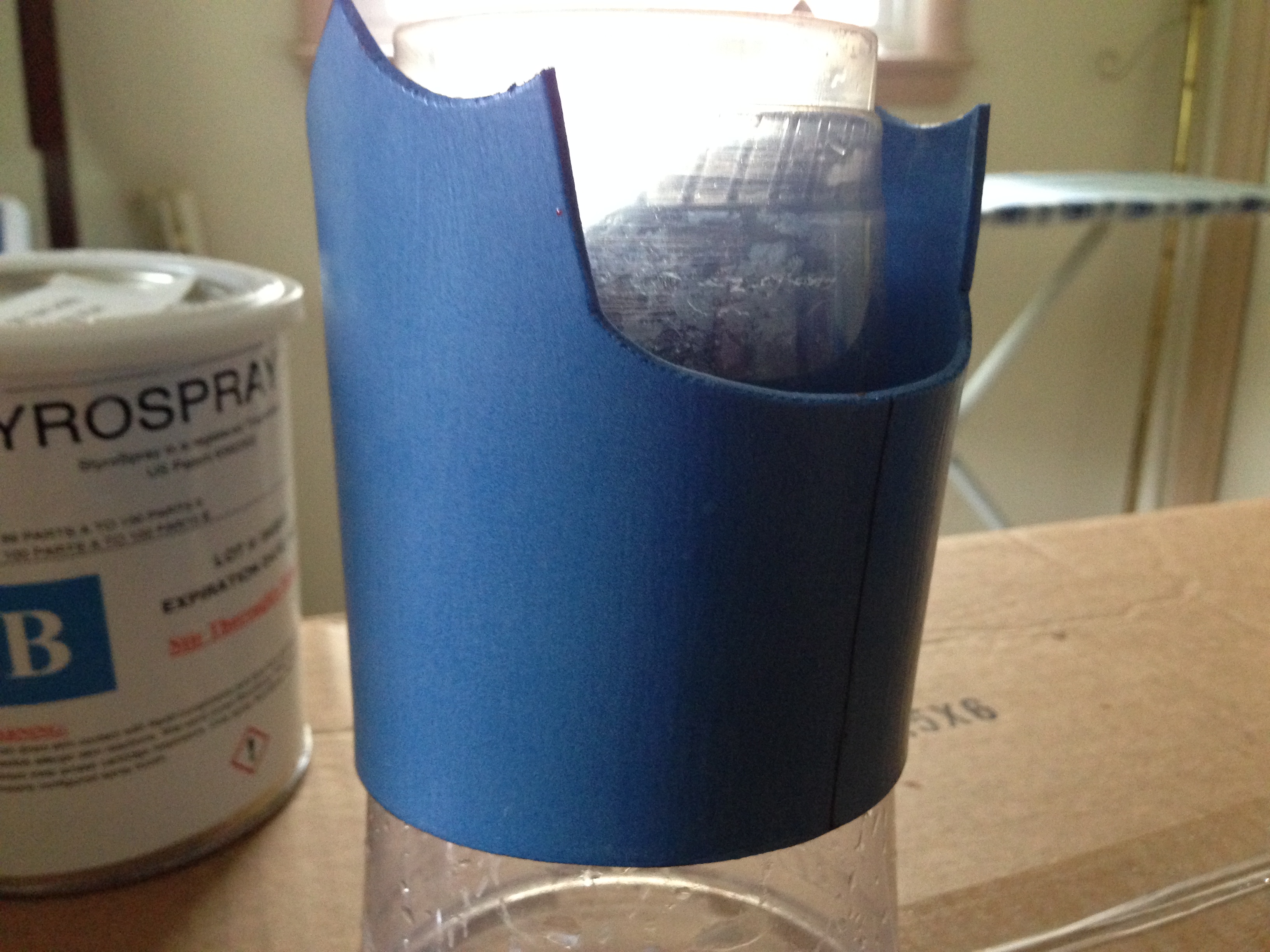

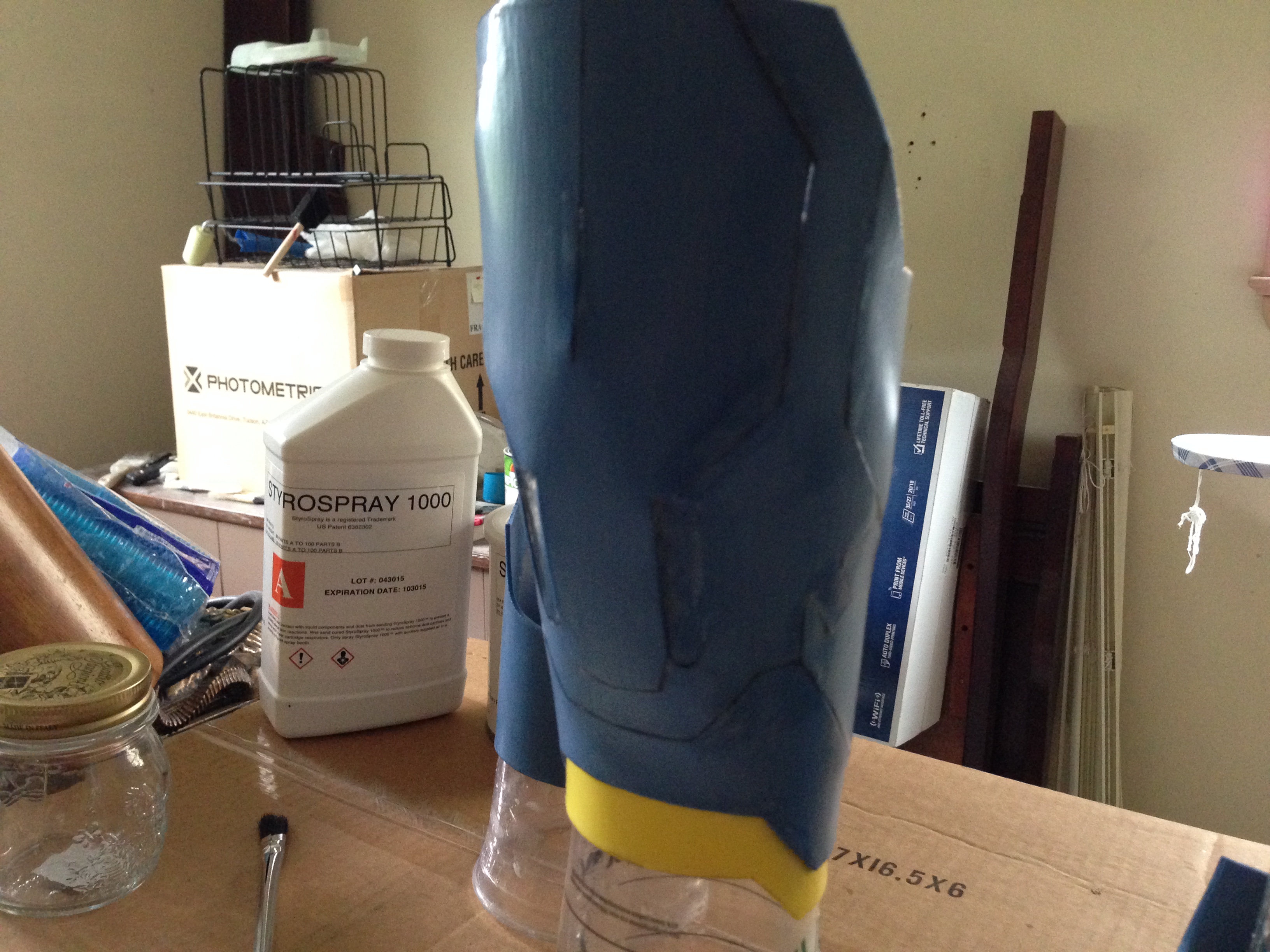

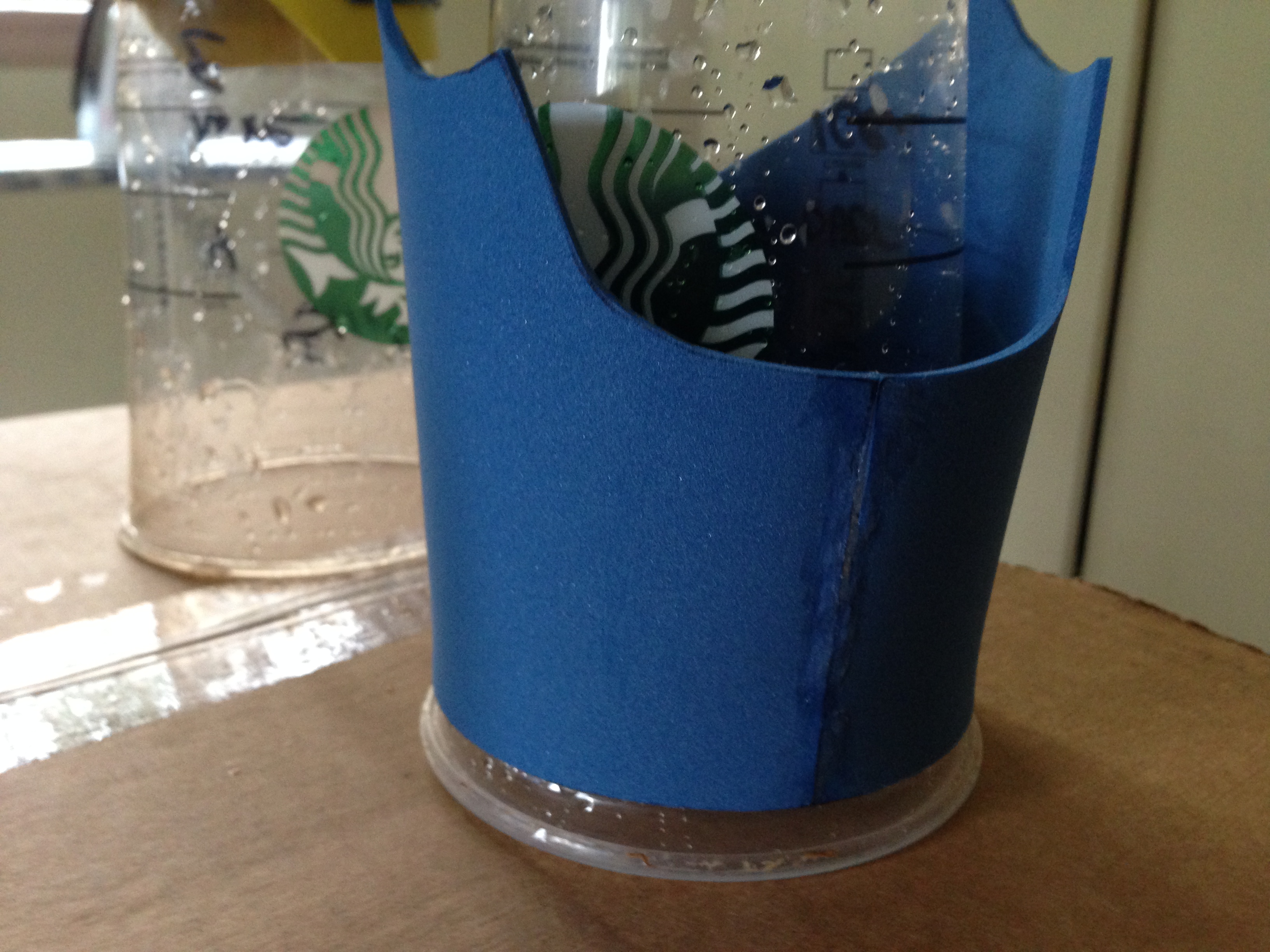

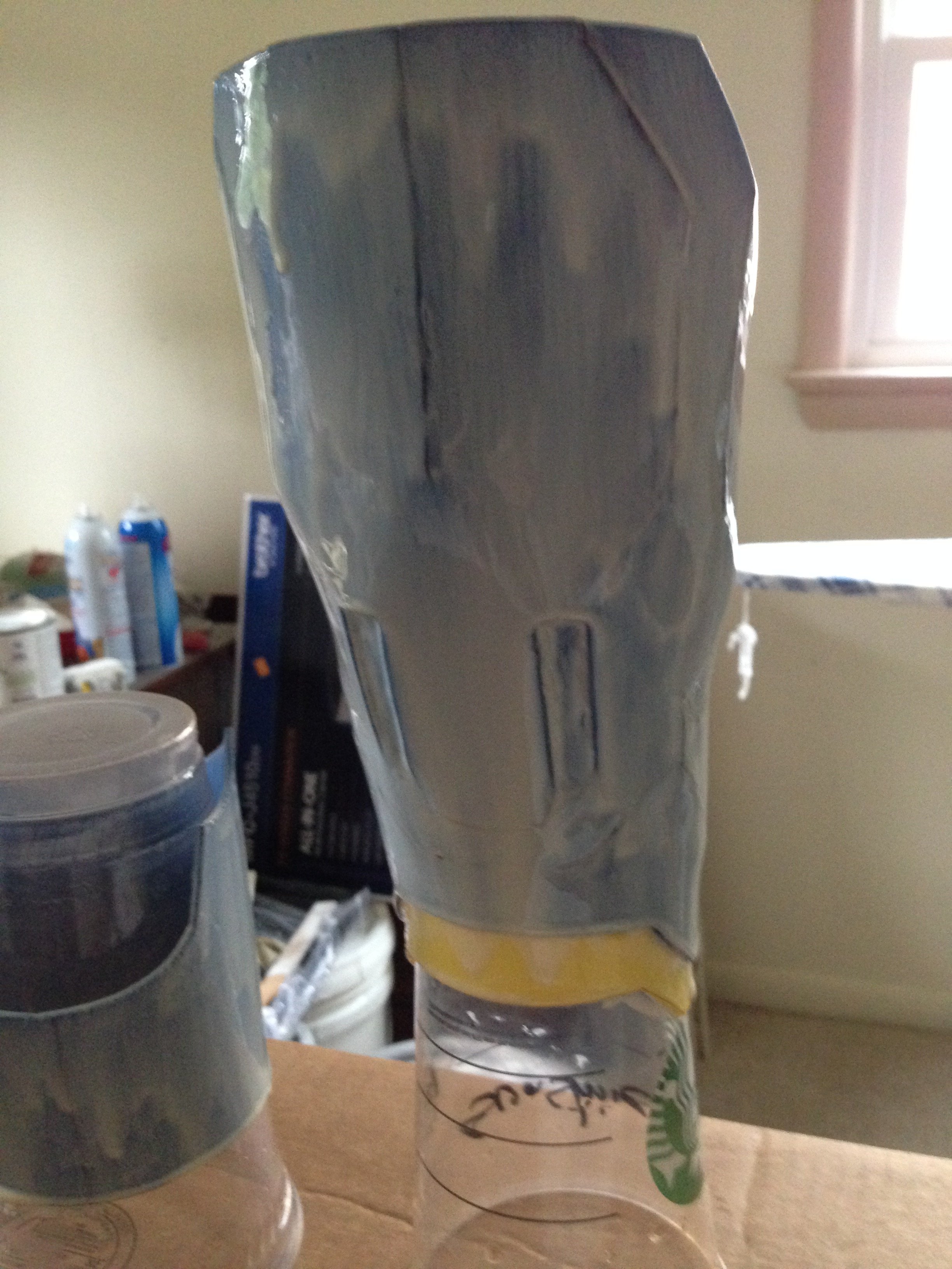

For this first test, I will be coating 3 "junk" pieces I made with 2mm foam from Jackieisrockin's Iron Man MK 42 files. These pieces are from the forearm, and has one piece coated with mod podge, and the other without. The 3rd piece is also coated in mod podge, and was also done to see how this stuff deals with more complicated surfaces.

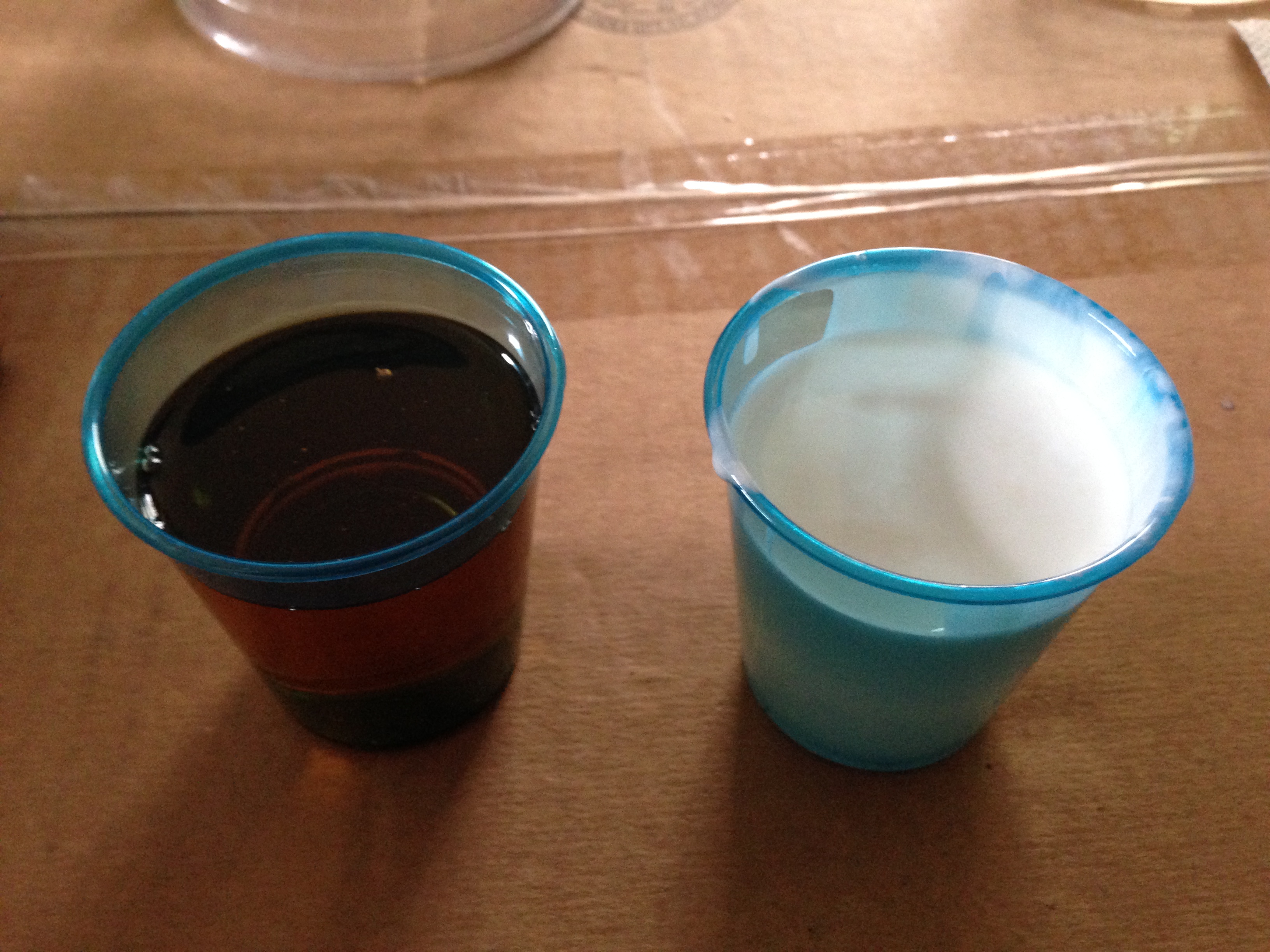

To measure my mixture, I used 2 small plastic cups. Since this stuff has a long work time when in a sealed container, I didn't worry too much about making too much. Part A is amber colored, and has the consistency of syrup. Part B is white, and is very thick. It's hard to describe, but I guess it's similar to honey with how thick and sticky it is.
When mixing the styrospray 1000, IP suggests using a large syringe for part B. This is because part B comes in a paint can, and pouring it will be messy in addition to its thickness making it hard to be exact with the amount. As I did not have one, I decided to spoon it into my small cup with a plastic spoon.
After being mixed, the mixture will have an off white color. It does take a bit of time to mix it completely, so be patient. Once it is completely mixed, it has the consistency of house paint.

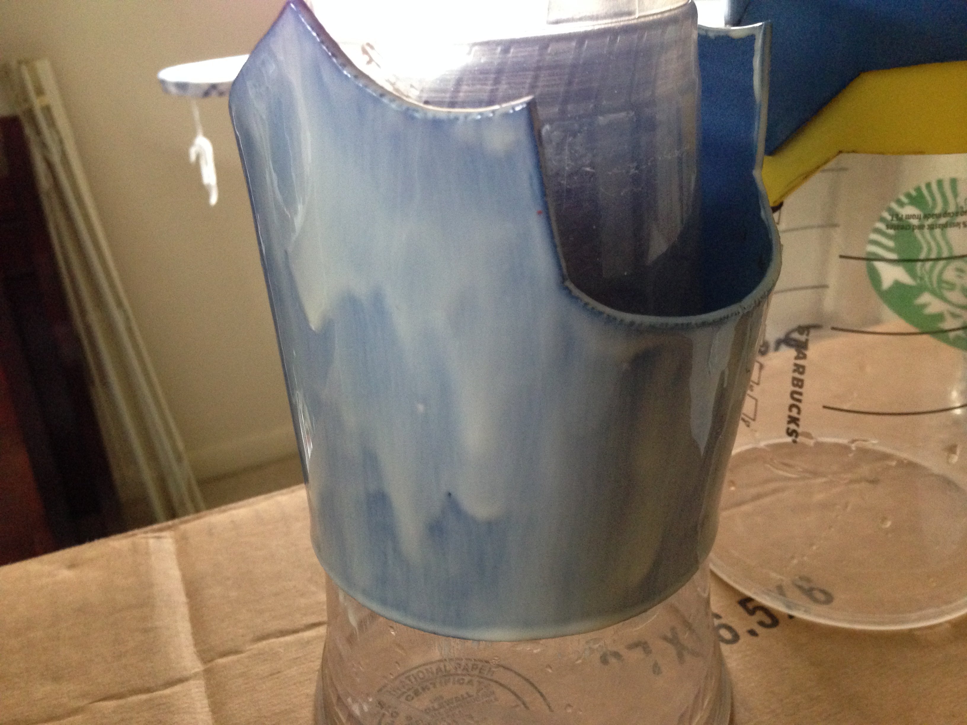

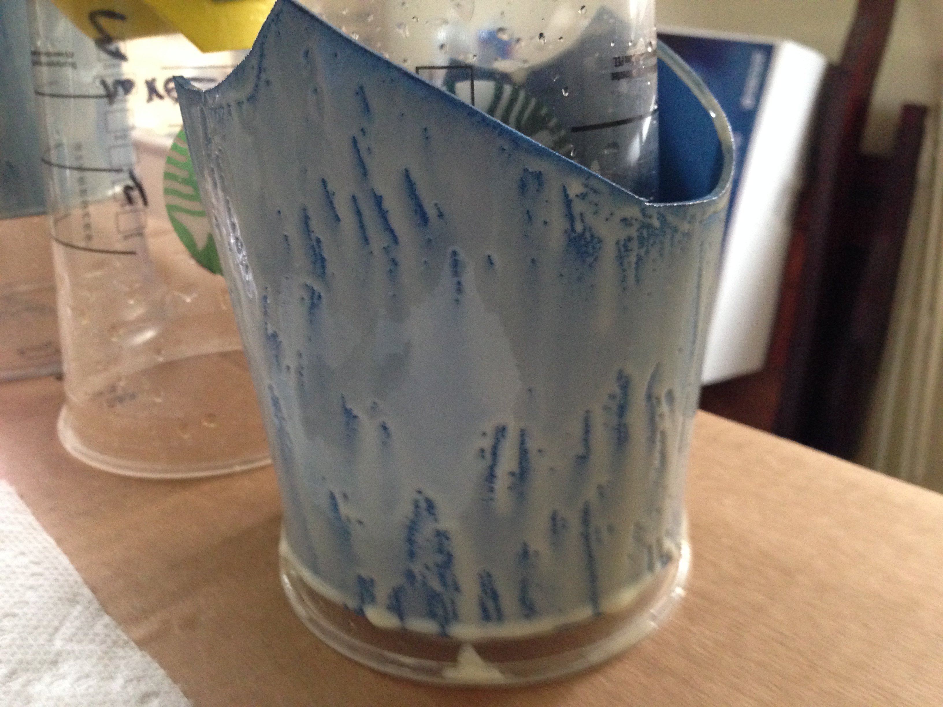

Using the brush on method, I was able to use the styrospray just like house paint. It was runny when globbed on, but very easy to spread out. This stuff naturally sets on its own, so I didn't have to worry too much about being perfectly even. I did immediately not that the non-sealed foam took the styrospray well enough, but it didn't go on smooth, and when fully covered, it seemed to separate in areas. As opposed to the sealed pieces that produced much smoother coats. This is also an issue with the pieces being vertical. Something that's horizontal, such as a chest plate, probably won't have this kind of problem, because the styro-spray won't be fighting gravity as much.

and ![IMG_0761[1].JPG IMG_0761[1].JPG](https://therpf-f28a.kxcdn.com/forums/data/attachments/220/220922-e065a2ec89398e85b8ac66bd154cccda.jpg)
