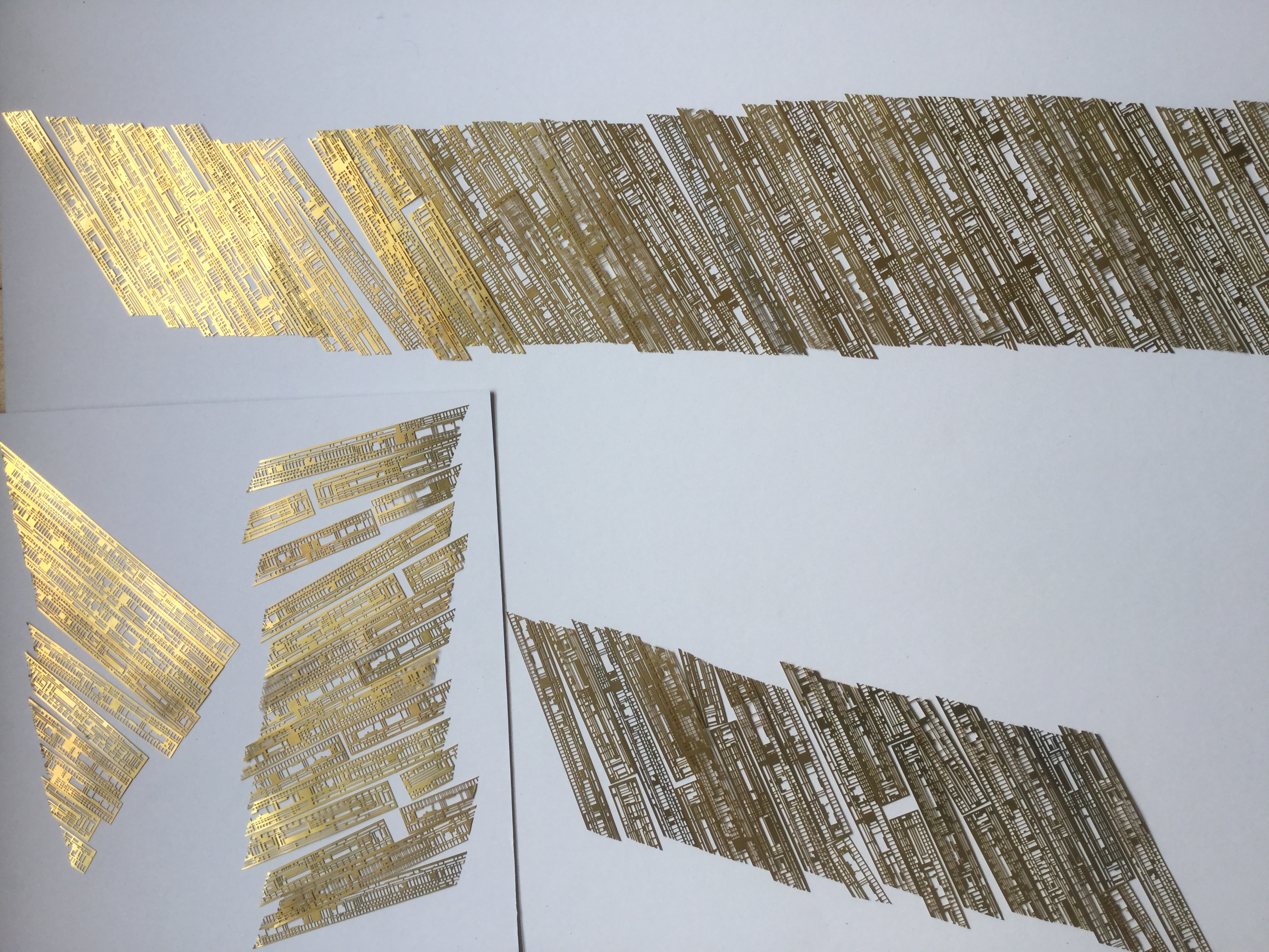

Here’s a image of the brass etch for buttress no. 2 which I cut today. All to be cleaned, soldered, fixed..........
