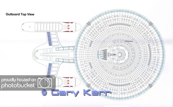

As some of you might know, blueprints of the C were published in a Trek calendar in 2002. These were drawn by Gary Kerr, who has been researching Trek ships for a long time.
I contacted Gary a while ago, and asked his permission to use his blueprints for making a studio scale replica of the C. He kindly agreed, and provided me with a lot of new insights into the original filming miniature, accompanied by new updated blueprints based on tracings of the original filming miniature and spare parts made for production.
The blueprints that were printed in the calendar were but a work-in-progress, but the publisher simply published them. There are a lot of differences from the calendar-blueprints, nearly no part of the calendar is correct, even though they're impressive as is.

the calendar blueprint:
