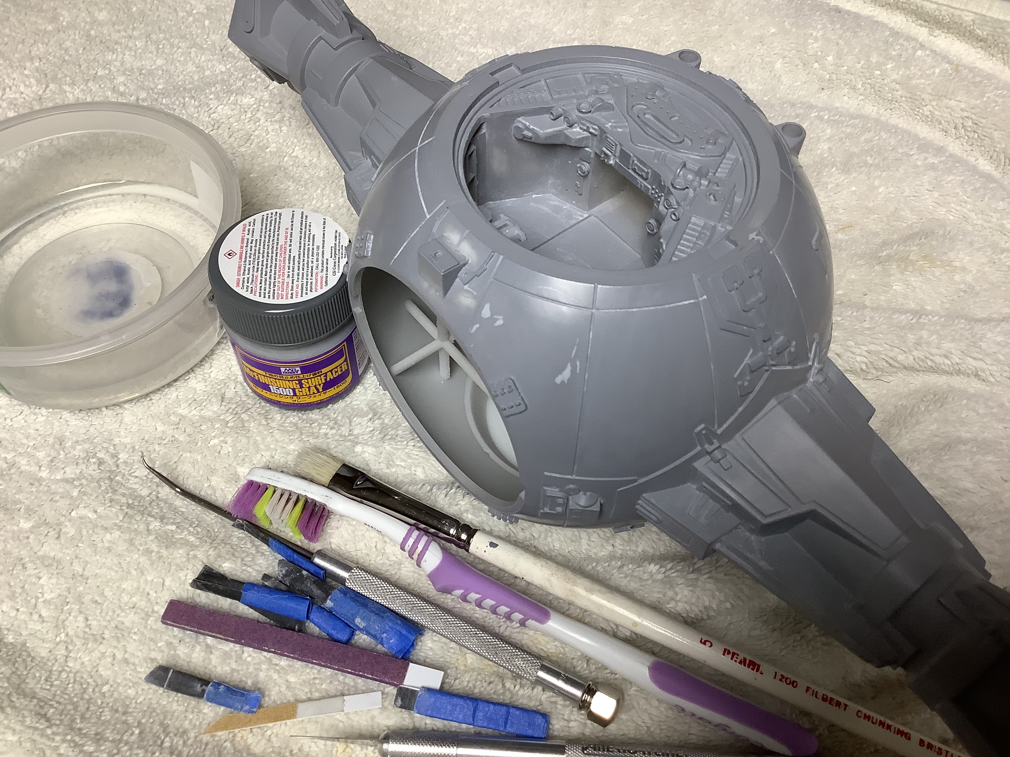

I have a quick update to share. There are some impurities in the factory applied primer and some artifacts left over from the 3D printing process. I am using 1,000 grit wet dry sandpaper and Mr Hobby 1500 to clean things up.
More to come soon. Thank you for looking.

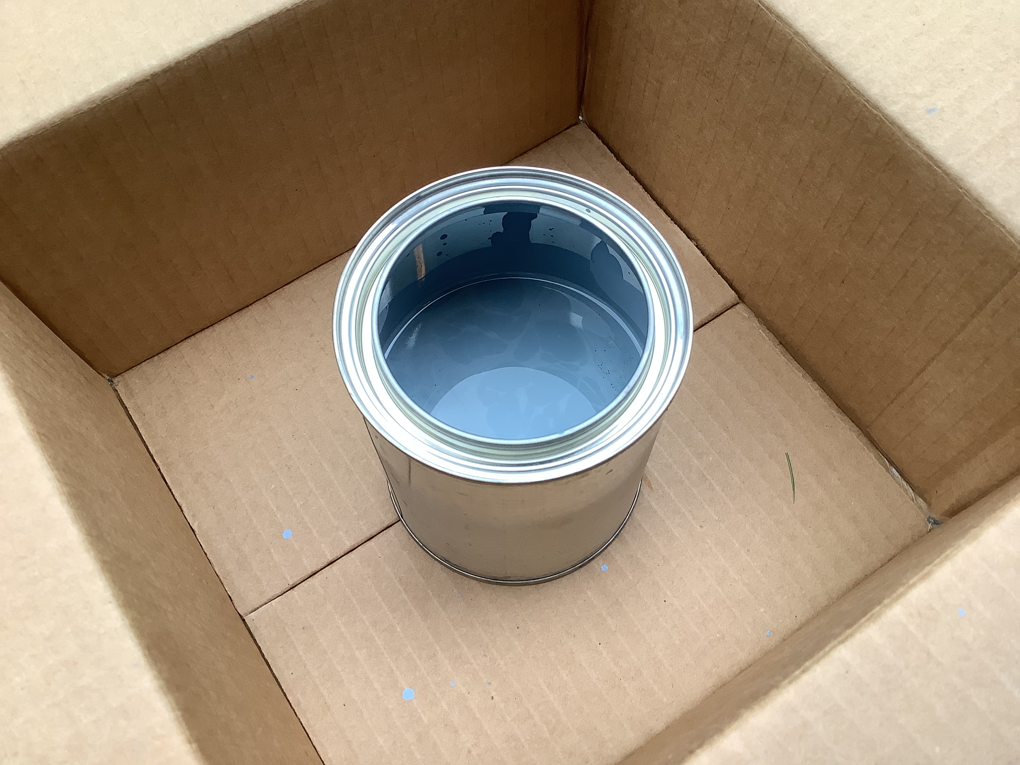

I have a quick update to share. It is my understanding that there are off the shelf commercially available paints that are a close color match for the Tie Fighter. With that in mind I went to my local Home Depot and purchased a selection of gray paint and primers to test.
The Rust-Oleum Enamel Satin Slate Blue looks like a good match so I decanted the paint from the spray can which yielded approximately 1/4 pint of paint.
The paint has a fairly thick consistency so I thinned the paint with Testors Enamel Thinner at a ratio of 50% paint to 50% thinner so I could shoot it with my airbrush.

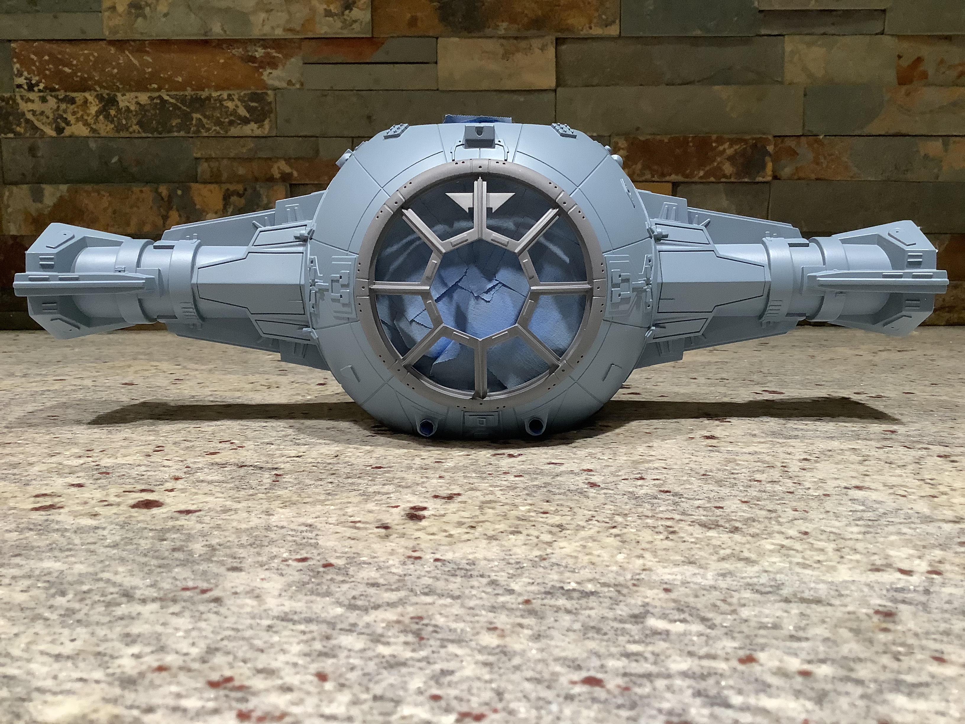

I’m getting very good results with the Rust-Oleum enamel paint. It’s a paint and primer all in one so it has excellent adhesion properties and it is very durable. I can sand it, buff it, polish it and use solvent based fillers on it and the paint won’t wrinkle or melt. The only downside is it takes a few days to dry, but that is par for the course when working with enamel paint.
That parts for the Tie Fighter are all painted with the Rust-Oleum Satin Slate Blue.

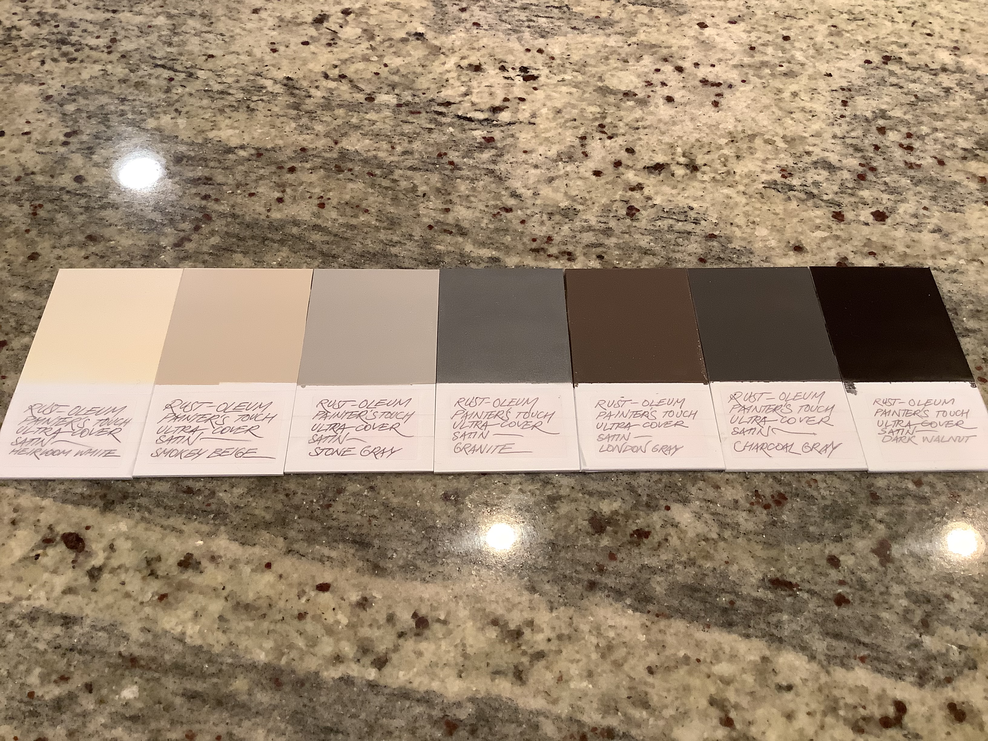

I painted the front facing canopy with the Rust-Oleum Flat Gray Primer but it lacked contrast.
So I made a run to my local Home Depot and purchased a few more cans of spray paint to test.
The Rust-Oleum Satin Charcoal Gray looks good so I tested it out.
The Charcoal Gray looks much better.

Hello, I have a quick update to share. I have been working on the Tie interceptor, using a scribing tool to clean up the panel lines and some 1000 grit wet dry sandpaper to buff out the primer. I should be painting the interceptor with the base color soon.

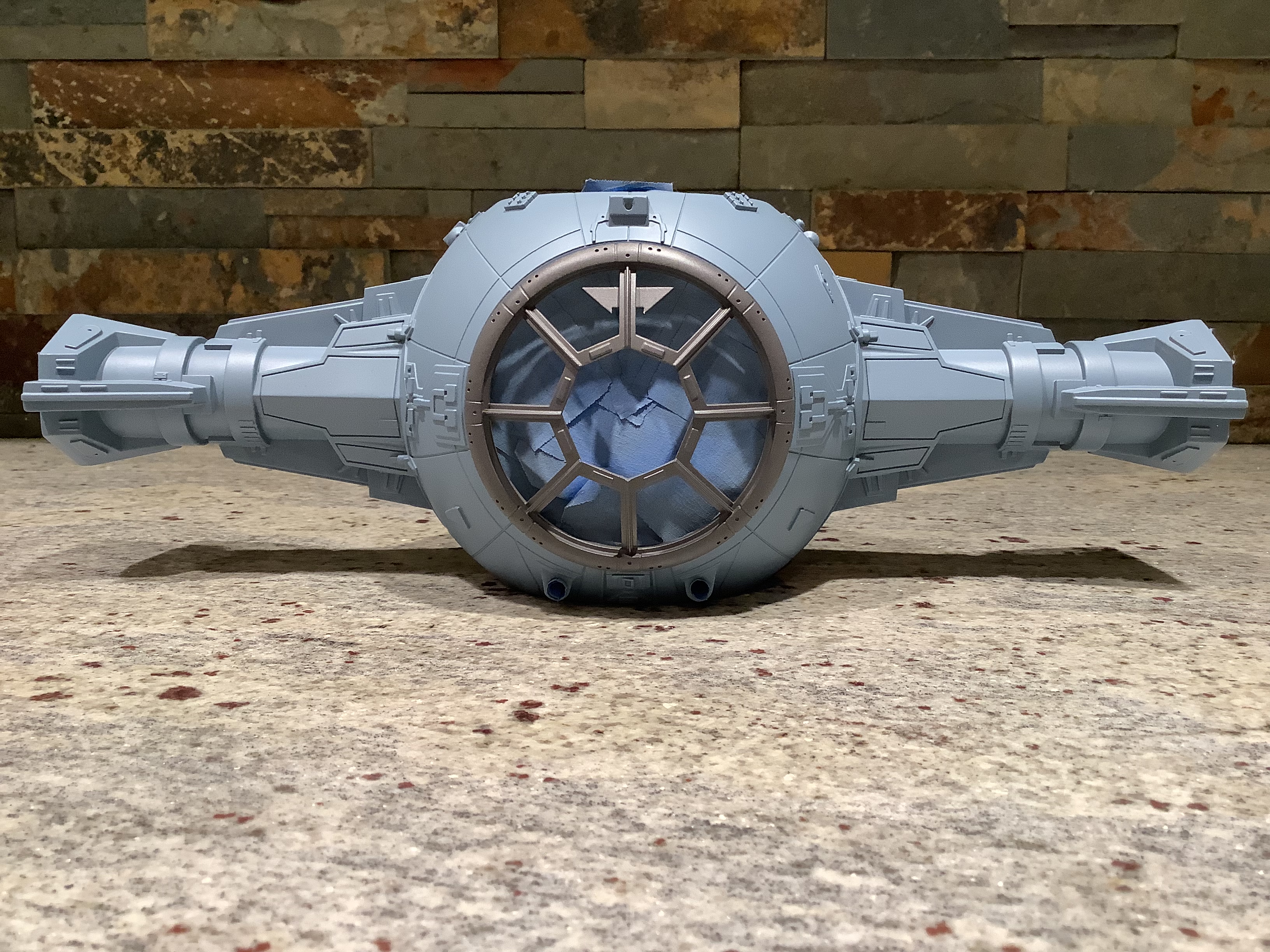

I start out by giving the parts a thick wet coat of paint at a ratio of 50% paint to 50% solvent, which highlights all the surface irregularities.
I give the parts a few days to dry so the paint isn’t tacky or gummy, and use some 1000 grit wet dry sandpaper and MR Hobby 1500 to correct any imperfections.
Then I shoot the finish coat of paint at a ratio of 40% paint to 60% solvent at 60psi, which knocks down the sheen a bit.
