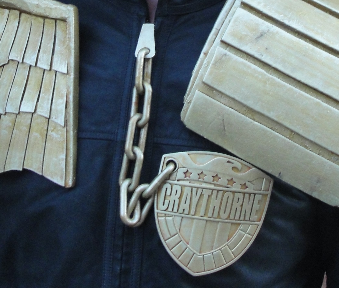

Also finally got some half decent chain.

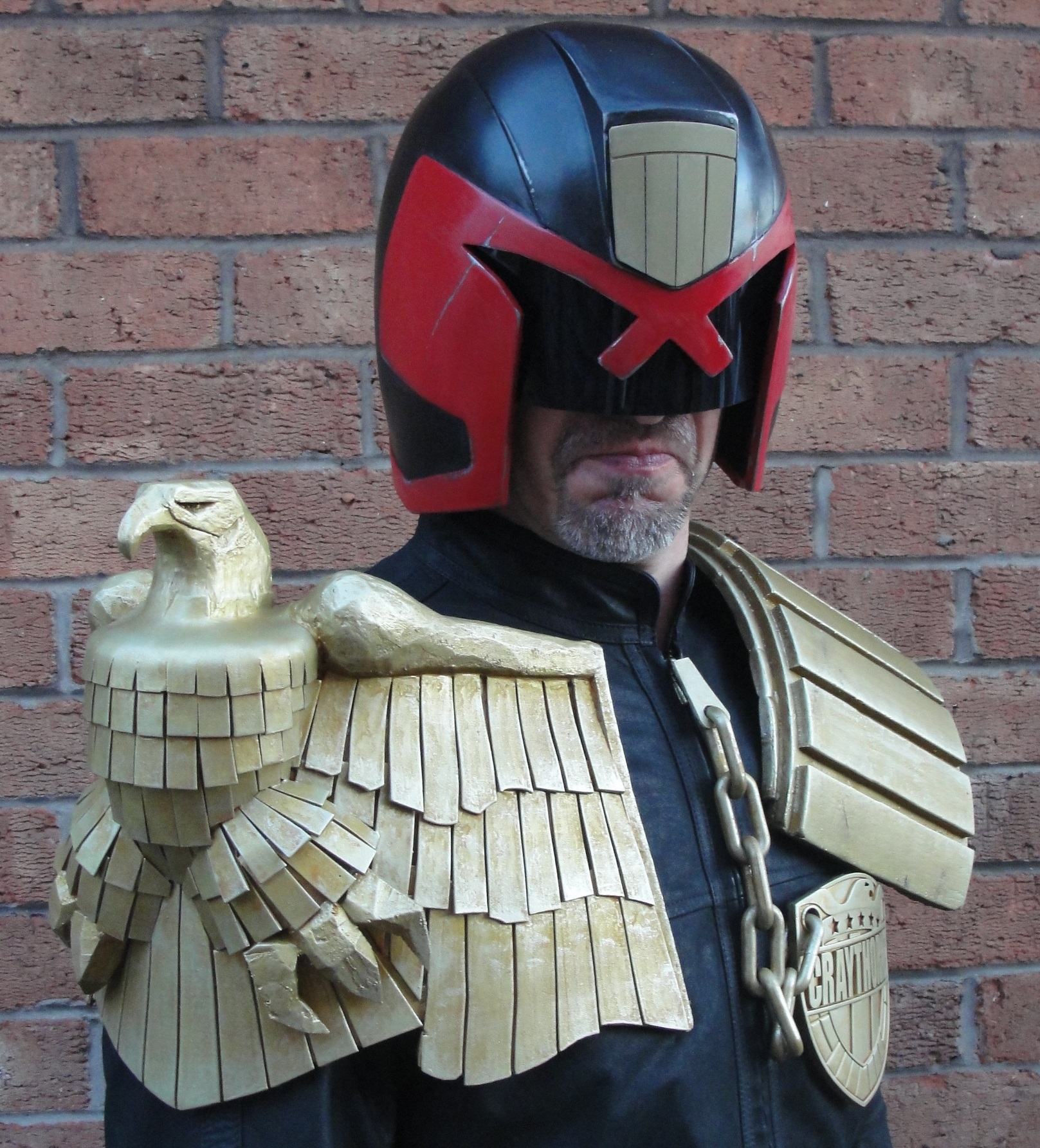

And this weekend managed to paint and weather it, and the name badge, and the eagle and shoulder pad.
..............so close to being done...................
Thank you for the painting/weathering details, will help me a lot when I start painting. Your chain looks great as does everything else. That shoulder eagle is amazing. Keep the pics coming, I love this build! I am picking up a pair of boots very similar to the ones you started with tomorrow. I will only need to paint the brown leather part that covers the calf black (Dredd 2012), as everything else on the boot is black. Do you think it would be worth ordering leather paint just for that or would acrylic craft paint work (all that is on hand in my area)?

Awesome! Looks great. Love that first kind of dark shot that's like the DREDD 2012 cover, others are very nice too. Are you going to a Con in this or debuting it at Halloween? Glad you posted this today, I needed some inspiration to get out of the house early and scavenge for Dredd items in the flea markets. Also, foam is not my friend! Will update my WIP with my foam beginnings shortly.
Wow! That's epic. I seriously am thinking about tackling a build like this after my 2012 build is completed. Inspiring, to say the least.

Know this is a year old but awesome costume and design choices and you gave so good details on what you did. Is there anything more that should be known about the shoulders? I'm attempting to do a comic Dredd look and this is my first cosplay/crafts project so quite new to it all. I've opted to purchase items like gun, helm, etc but bit baffled on how to get the eagle shoulder done.
Hey 'cobalt blue' thanks for your comments, and resurrecting this zombie thread, has it really been that long?
The eagle wasn't too bad, a bit of patience and lots of test fitting will see you through. There's heaps of reference and help here on the RPF.
