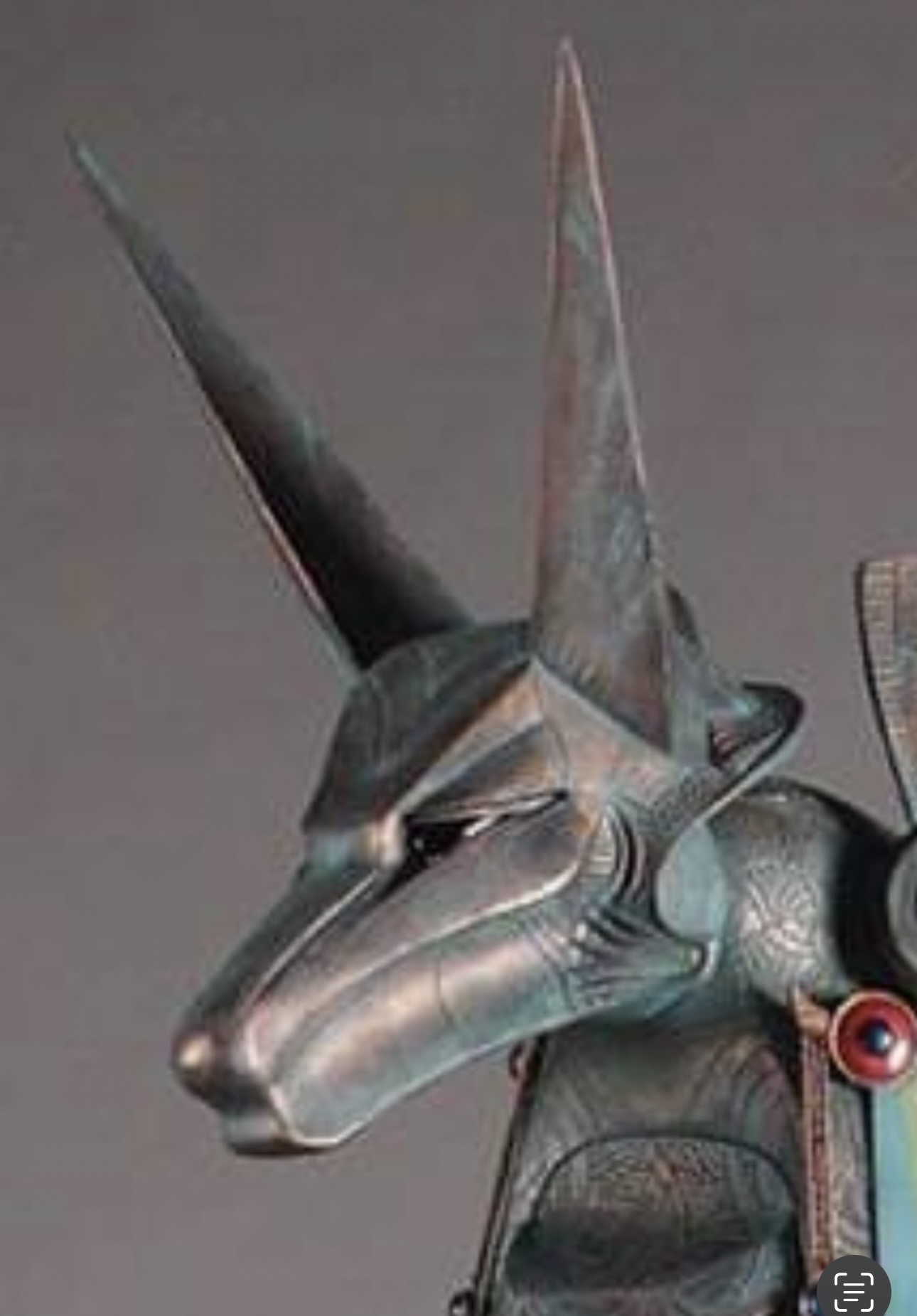

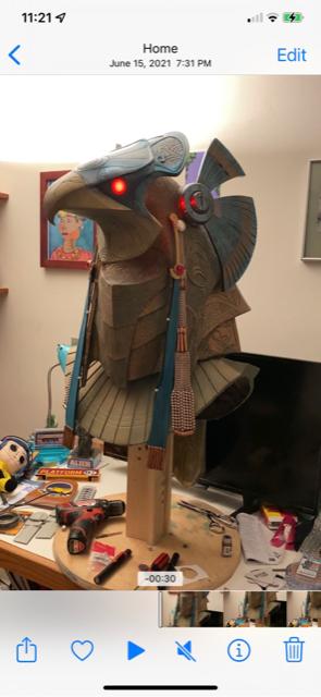

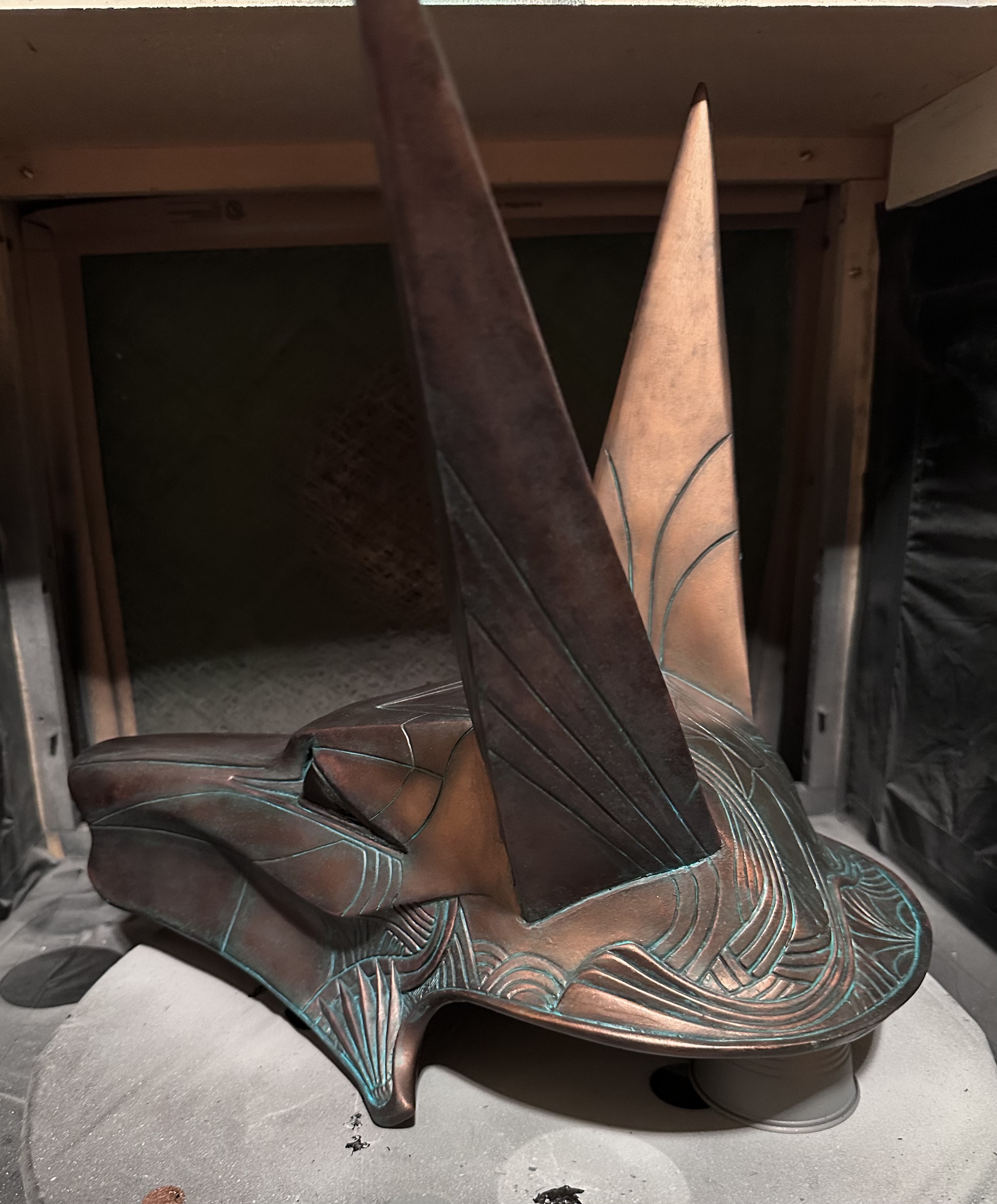

Here’s a pic I found on the net as reference.
Looks like I could use a bit more patina color around the jaw line.

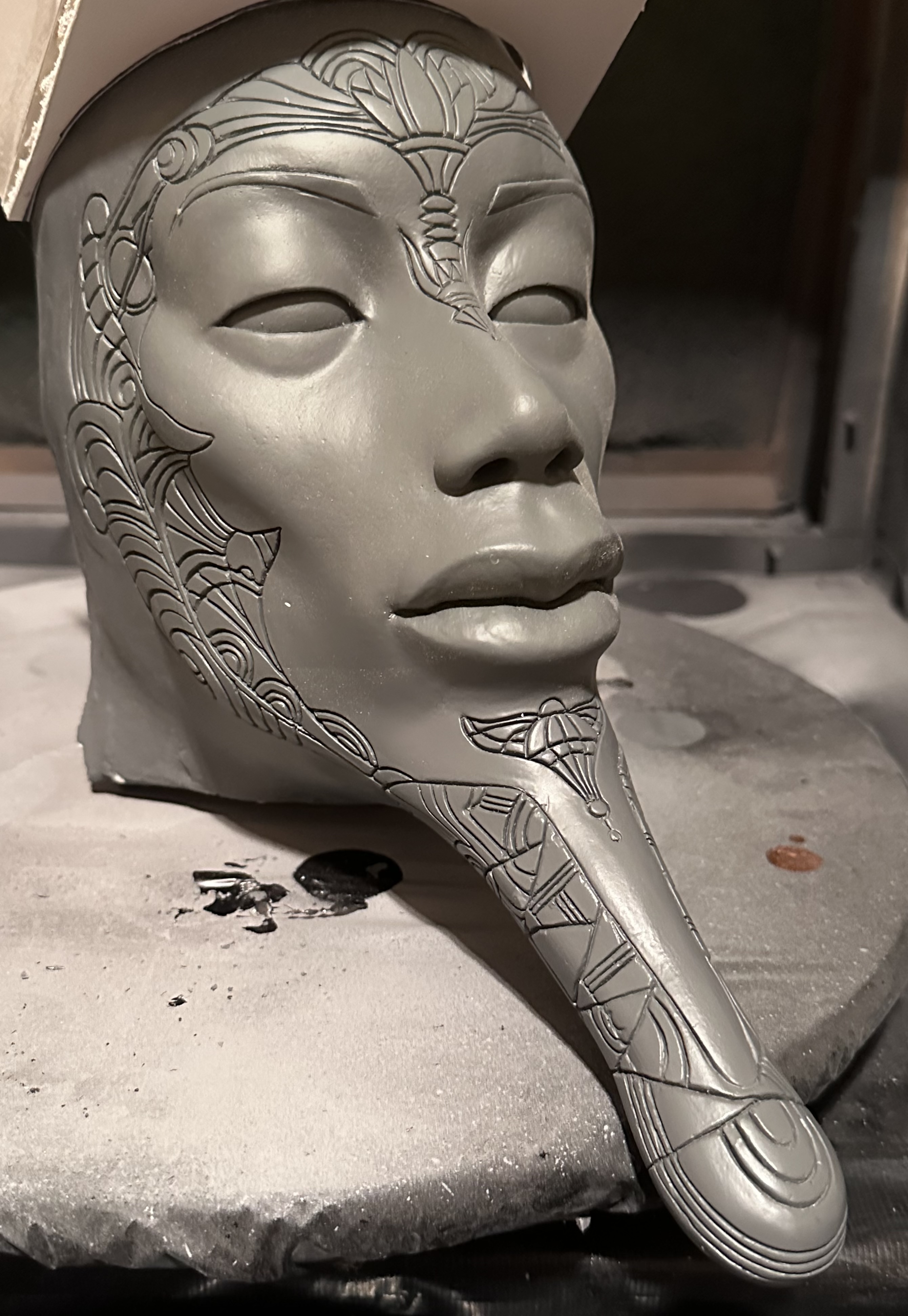

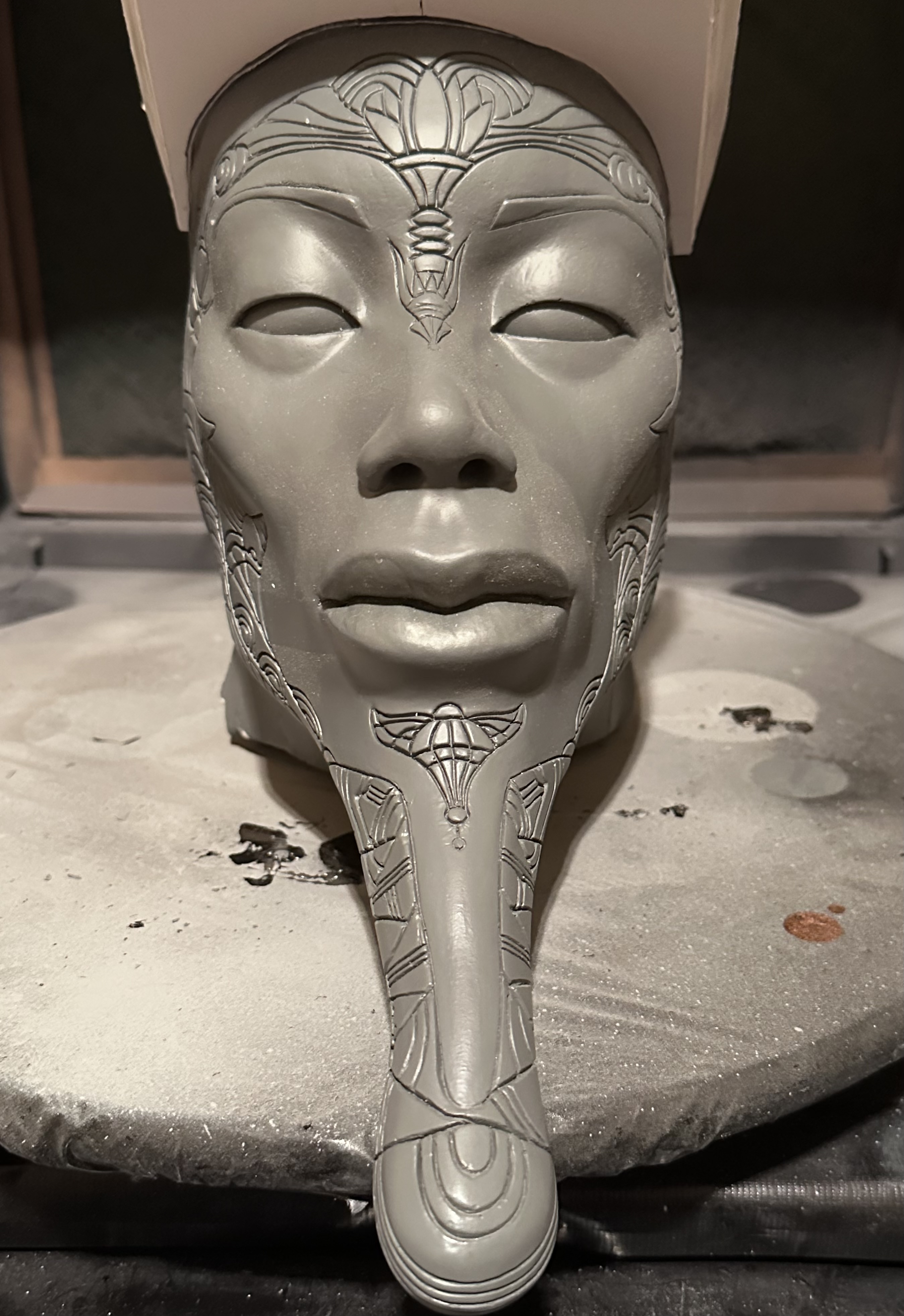

Here’s Ra! It’s just the face but I had started to build/ sculpt the rest of his mask. I ran out of steam but will get back to it one day.

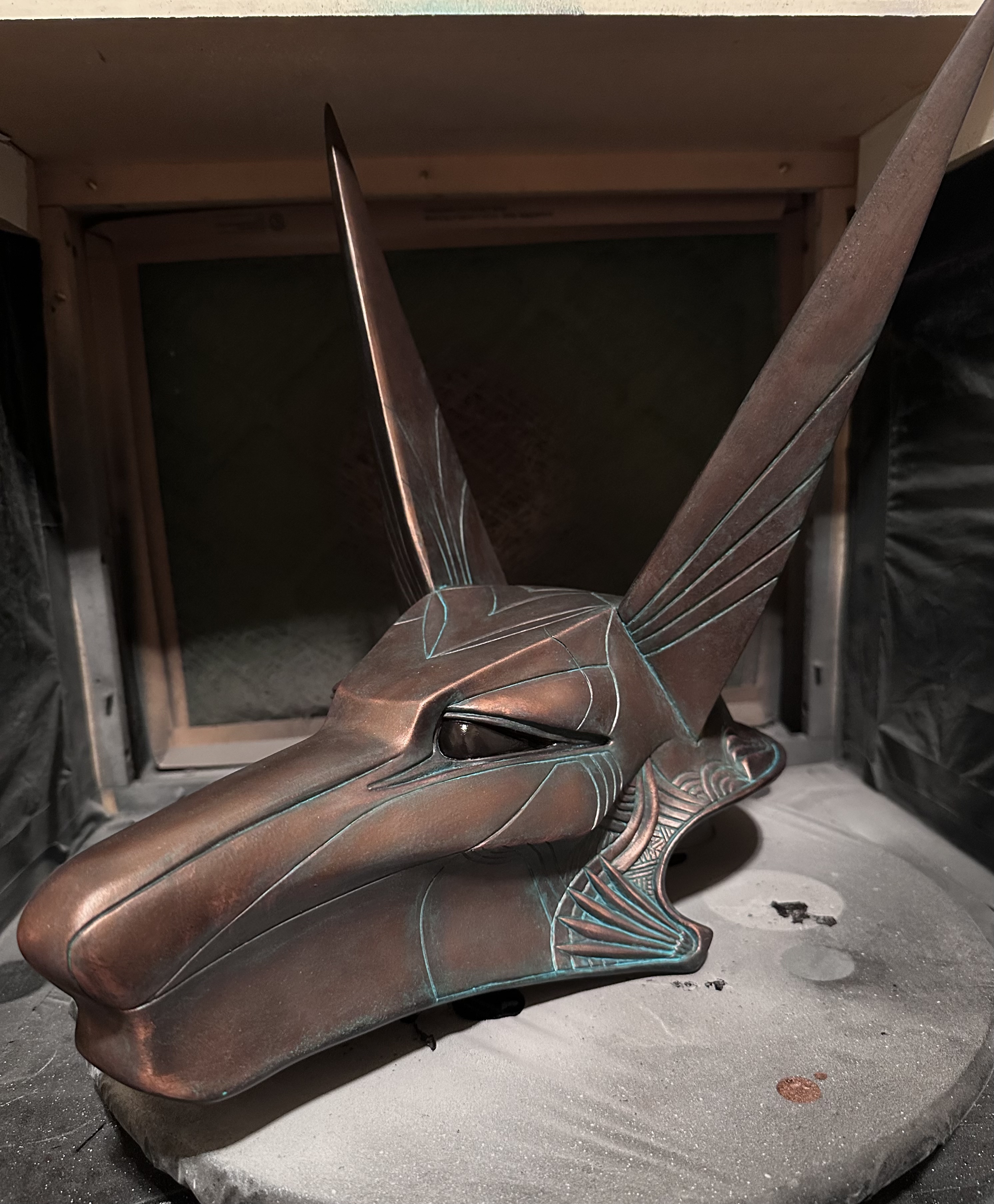

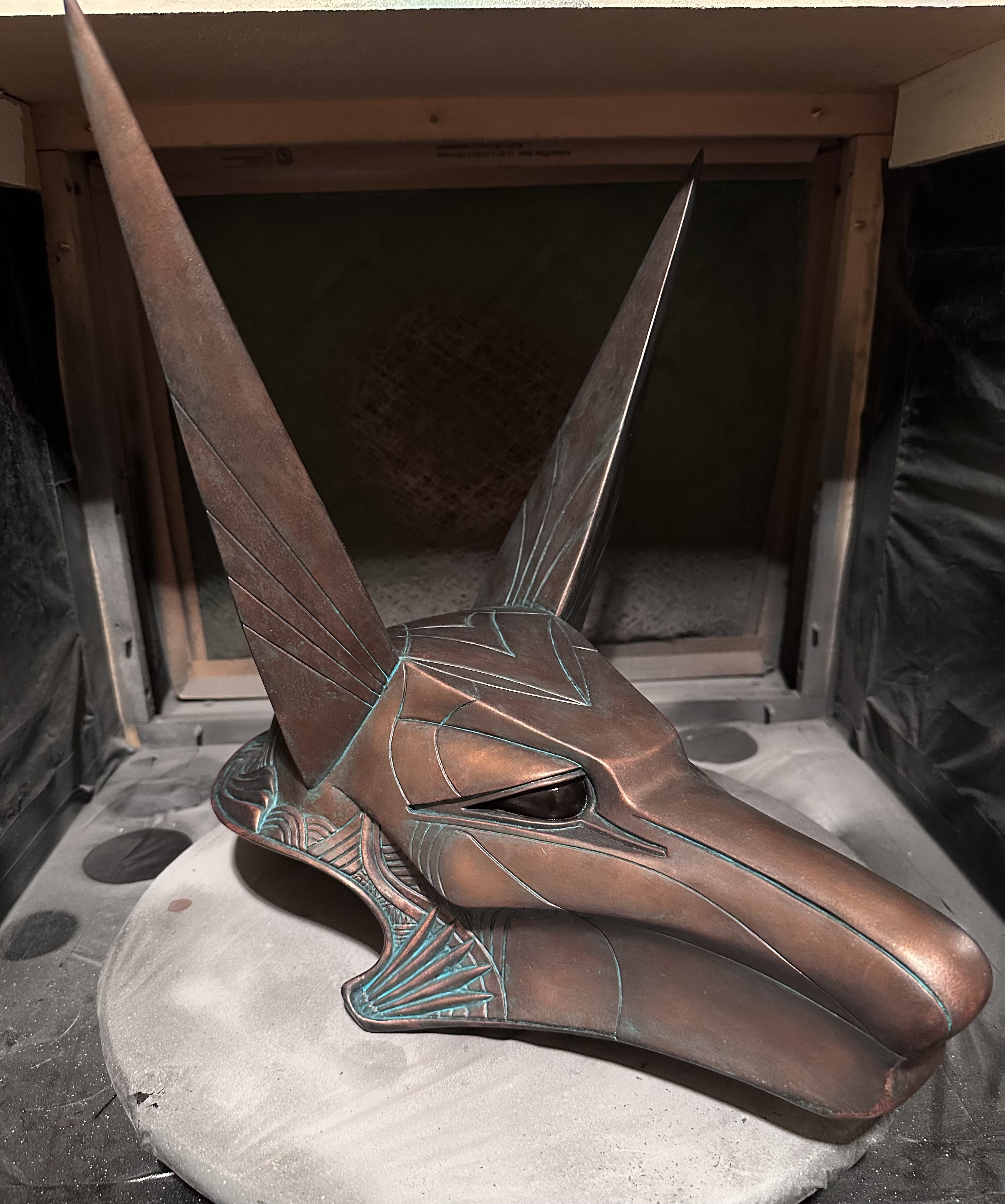

I think I’m calling this one done for now. Thank you everyone for the comments

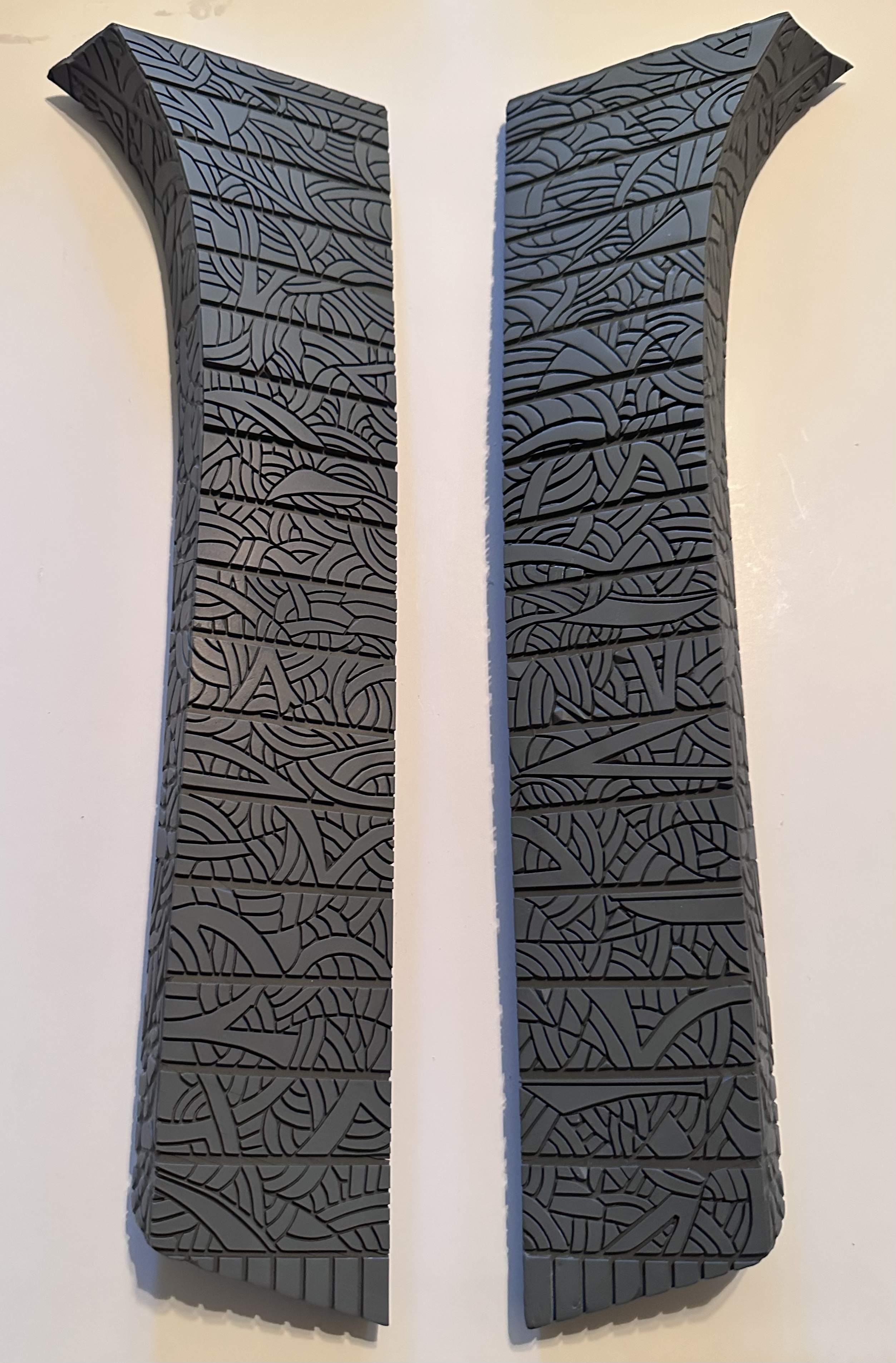

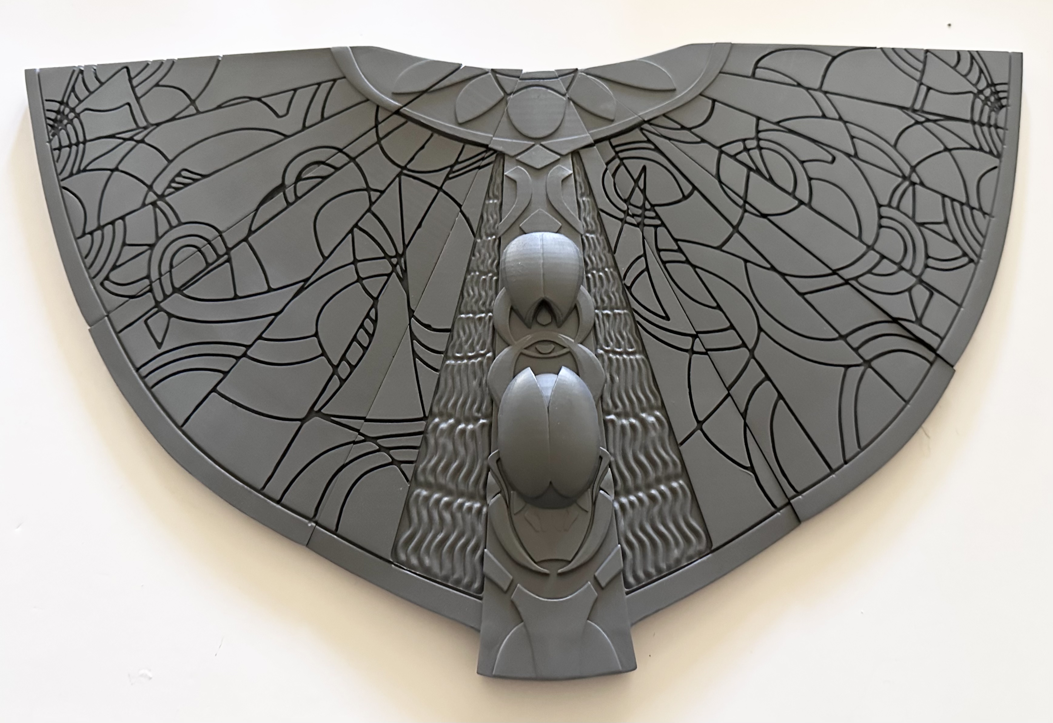

I’ve started the process of printing the digital Ra out and I had to scale it down a bit to fit the mask I have. I had to slice the files to over 30 pieces to be able to print on my midsized resin printer. My maximum build height is around 8.5 inches and takes 24 hrs for each run. Here are some pics of the progress so far and thanks for looking…

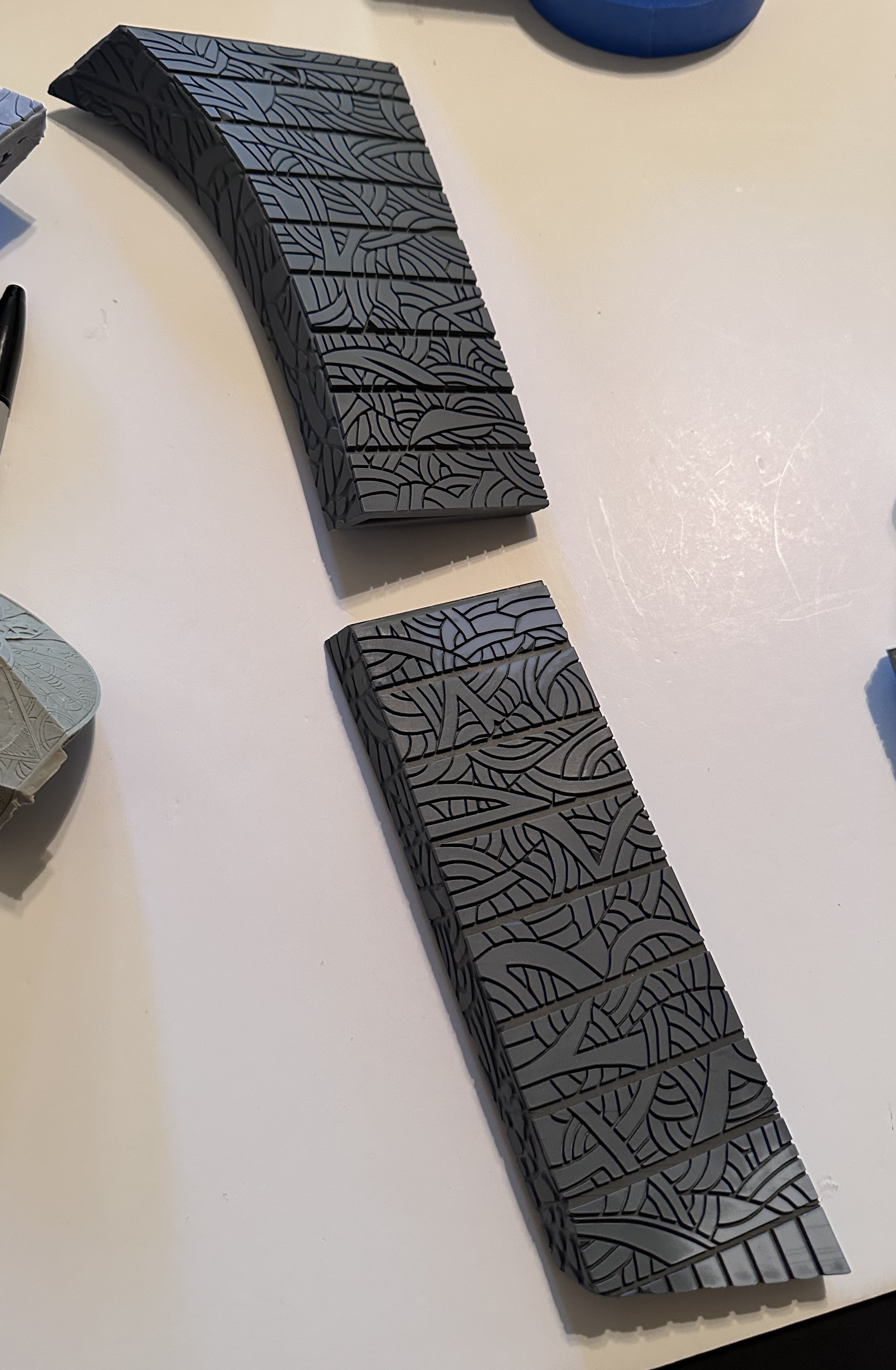

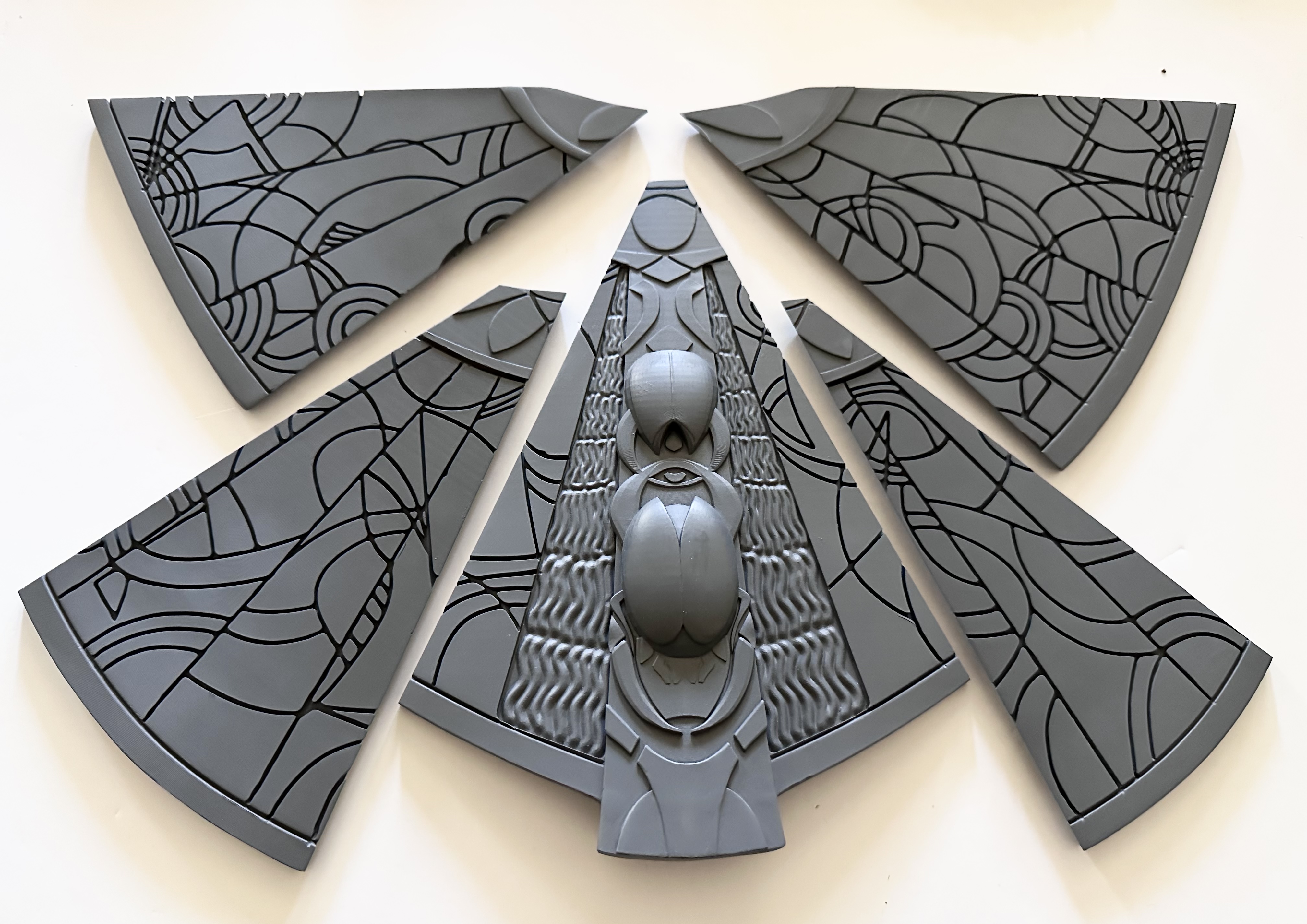

Here are some more parts cleaned up and primed. The front chest piece was cut up into 5 parts.
I don’t think super glue will hold this thing together. Probably will go with 5 min epoxy for a stronger bond.

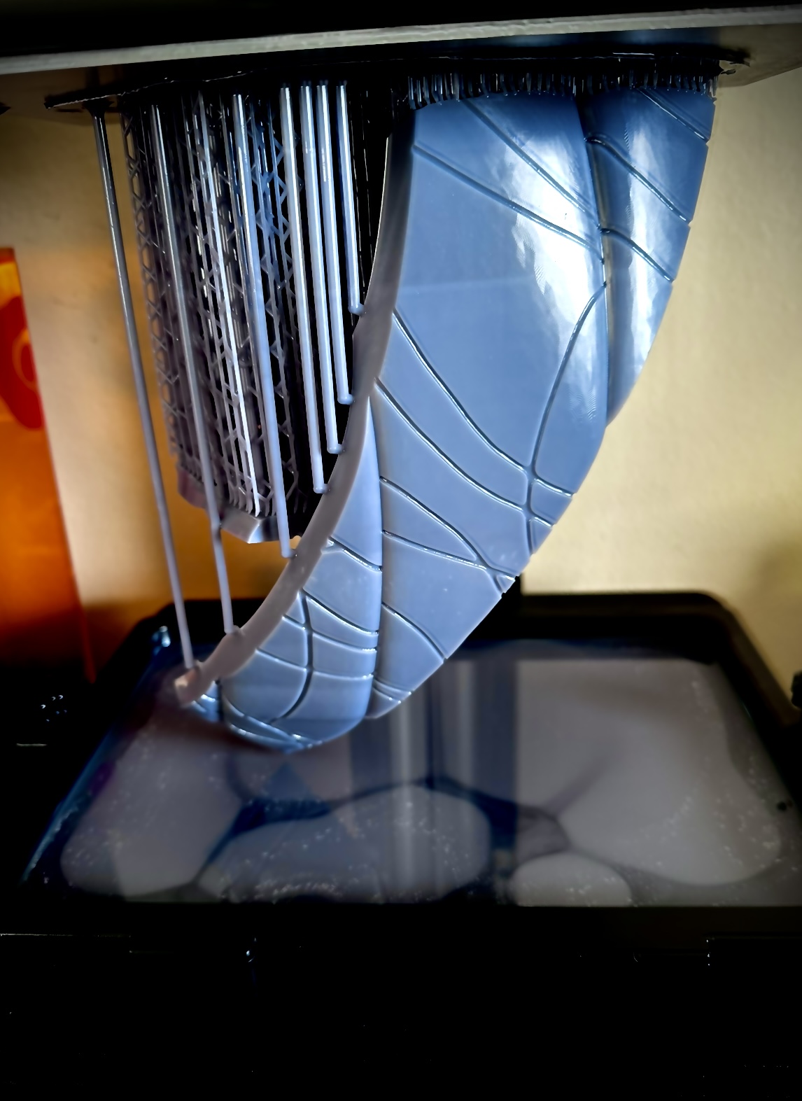

Thanks! Here’s one run coming out of the vat. Each part needed to be washed, cured, and lightly sanded before being primed
You should have probably strengthened it with brass pins between print parts. Or... glue strips across the glue joints on the back.
