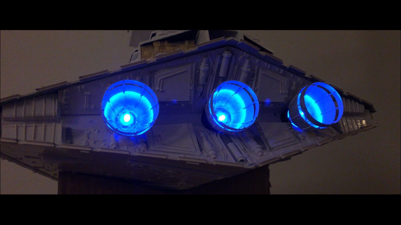

After some friendly advice on this forum I decided to throw away my engines and make some new from plastic eggs. To begin with I wasnt quite happy with the idea when I noticed how difficult it was to cut them staight, but it turned out great and im pleased with the result. Im thinking of adding extra details on the entire ship, seing the other destroyers in here is very inspiring :)
As you can see I had som problems with Light leaks and I fixed that with black paint. The rear is not finished at all, I just could'nt wait to light up those engines :-D

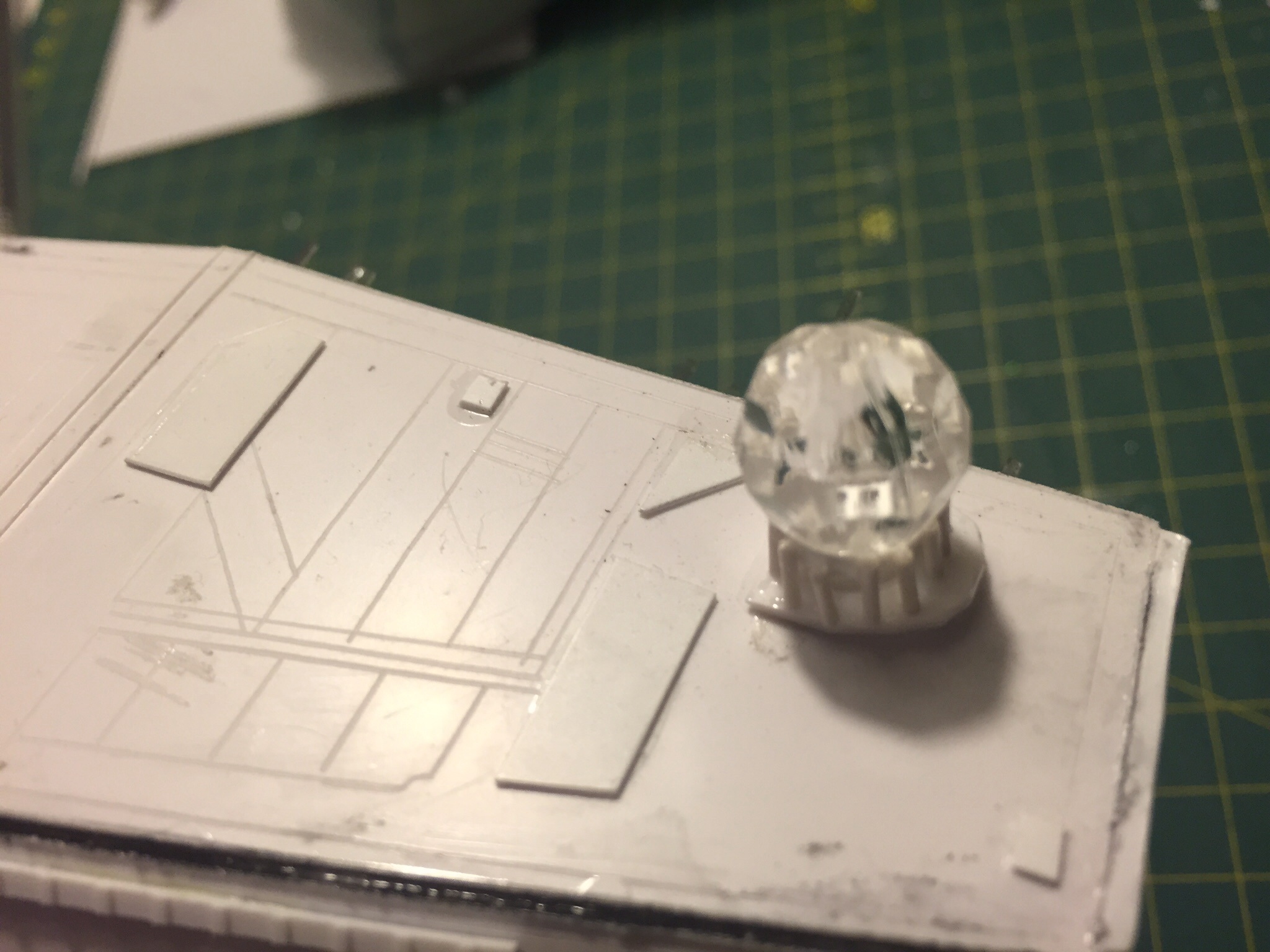

I have painted the inside black to prevent light leaks and started to concentrate on the bridge.

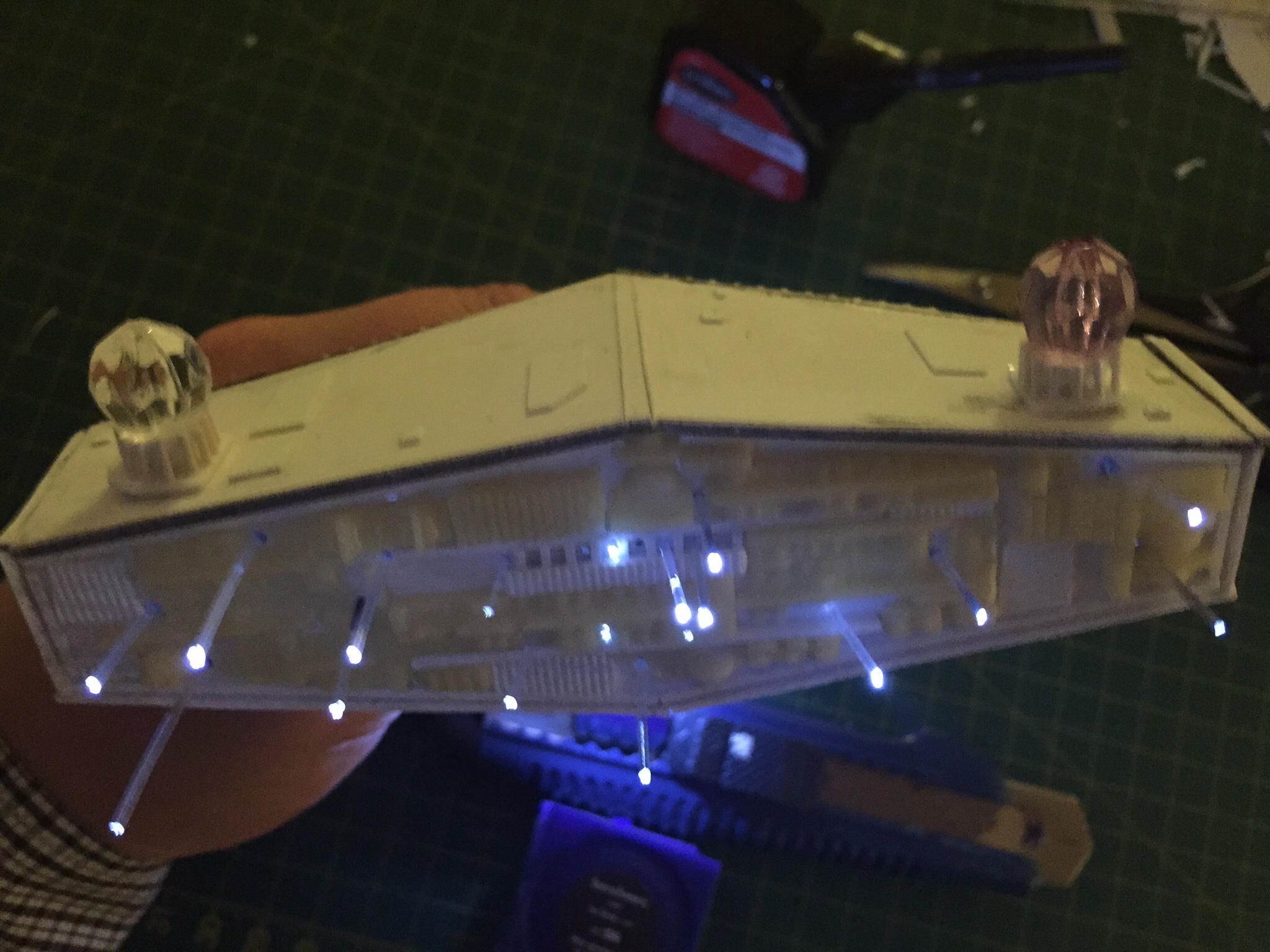

I couldnt help myself, I just had to see how the optic fibres behaved, so I took a small LED and lit some of the stuff up and it put a big smile on me :)

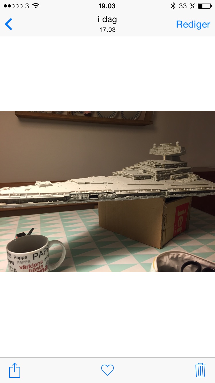

I have done the primer job on most of the structure. I still need to do alot more on the paintjob but I fell good with the progress so far. The scribing still doesnt show that much but I cant wait to do the weathering and I dont know what it is about primer, but I just love it maybe it because the first layers really show where things things at going yeeaa or maybe its just me who is weird ,, Anyway ! I've posted some new shots of her.
