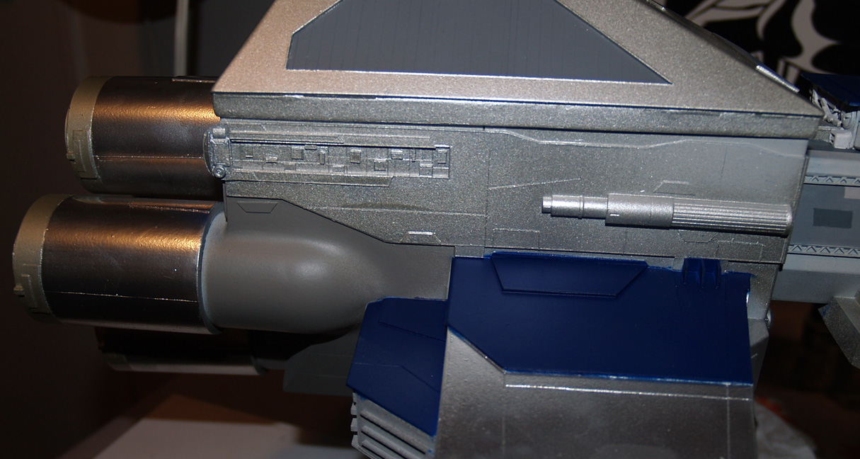

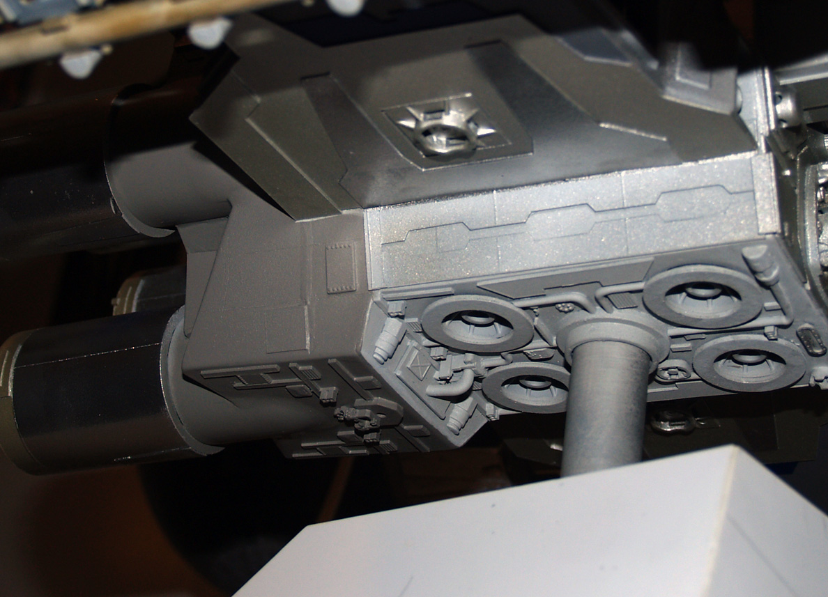

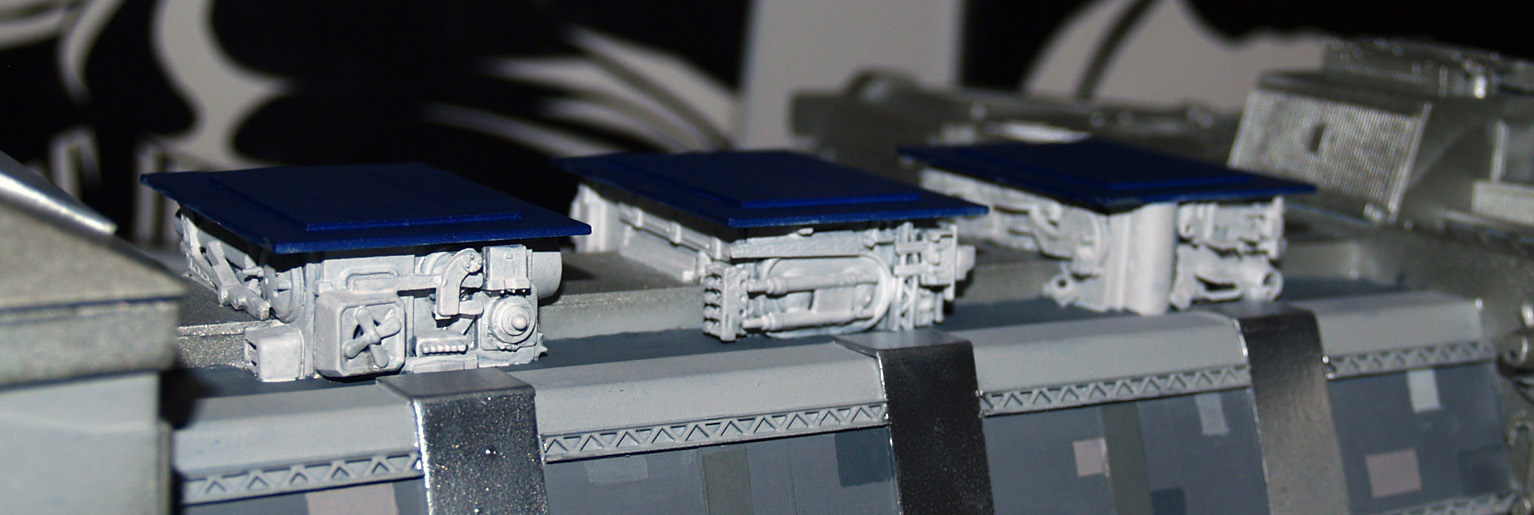

Started with painting the kitbashed part under the blue squares a whiteish but very light gray color.
I wasn't so happy with the color I had on the side bottom part that connects to the chrome thrusters, so I got a bit darker gray and resprayed it.
I taped off part of the bottom, as I'll paint that different types of grays.
Heres more I painted, mainly the really dark gray.
Closer shot.
Still gots more to do.

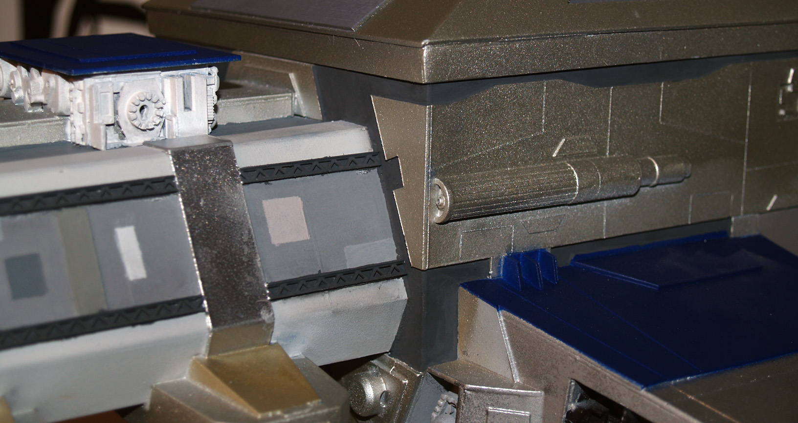

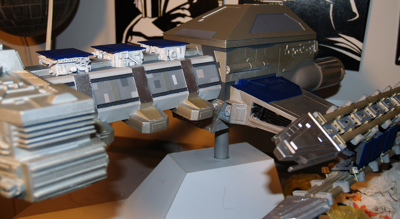

After looking at the neck part and seeing those random squares painted on it, I felt the sides were to wobbly. Mainly because the paint seeped through the blue tape. So I thought about it and decided that adding lines around each one should look pretty cool. However, I decided on using a sharpie marker....big mistake. Using a small piece of stryene as my ruler, I tried drawing them in, but they just weren't working out so well. The sharpie bleed out a little in places and the stryene piece would move in places even when taped down. Plus the sharpie would act like it was drying up, even when brand new.
Heres how that came out.

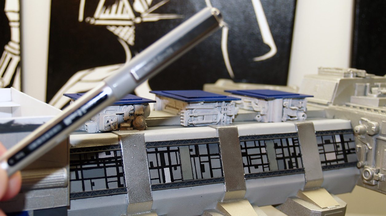

So after thinking more on it a few days, decided to use a uniball pen free hand. Going over the lines, adding more random lines and squares in places, mostly to cover up any mess ups, I think it actually turned out better.
And the other side, with the pen. Still not as perfect as I'd like it, but best I'm going to get it without redoing the whole section.
I will redo that part because that part is very obvious place you look upon the model. You should not leave it as it is.
Come on, it's only a few hours work.
I will spray black at the first place and mask there with some thin masking tape and paint multi tones of silver.
While I do like how the lines ended up turning out, still not as good as I would have liked. If you could elaborate a bit more on the masking tape silver thing a bit.
This is just an option but,
Spray black paint on that area at first.
Then put the usual masking tape on the glass plate or something.
Cut that masking tape with a sharp knife to make a thin strip of tapes like 2 mm width.
Put that thin strip of tapes on that area you sprayed black to make a grid.
Then apply silver ( gray ?) spray on that area.
Then put some square cut masking tape on some grid to cover up.
Spray another different tone of silver (gray) over that area.
That's it.

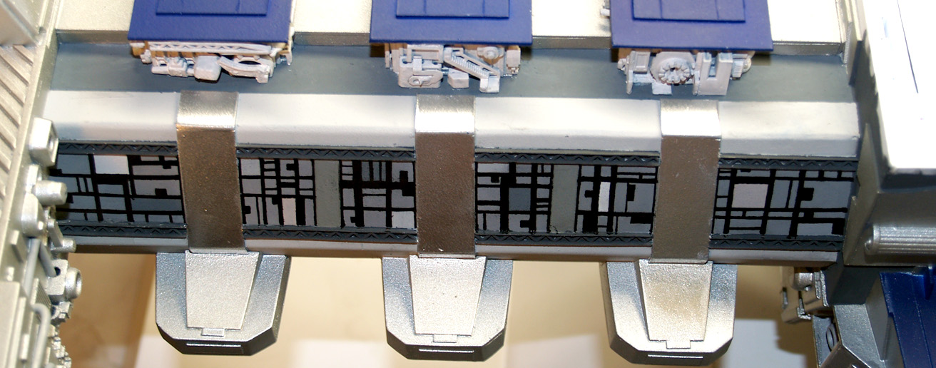

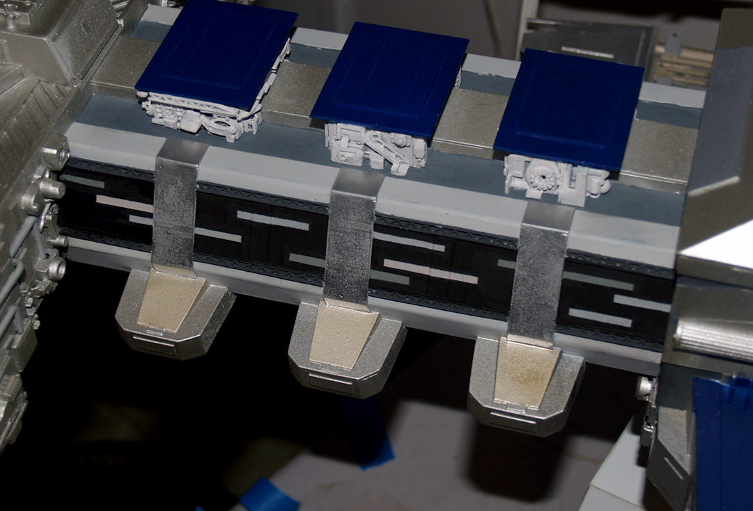

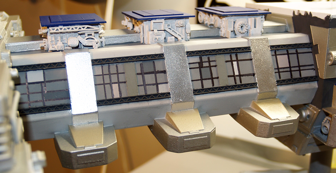

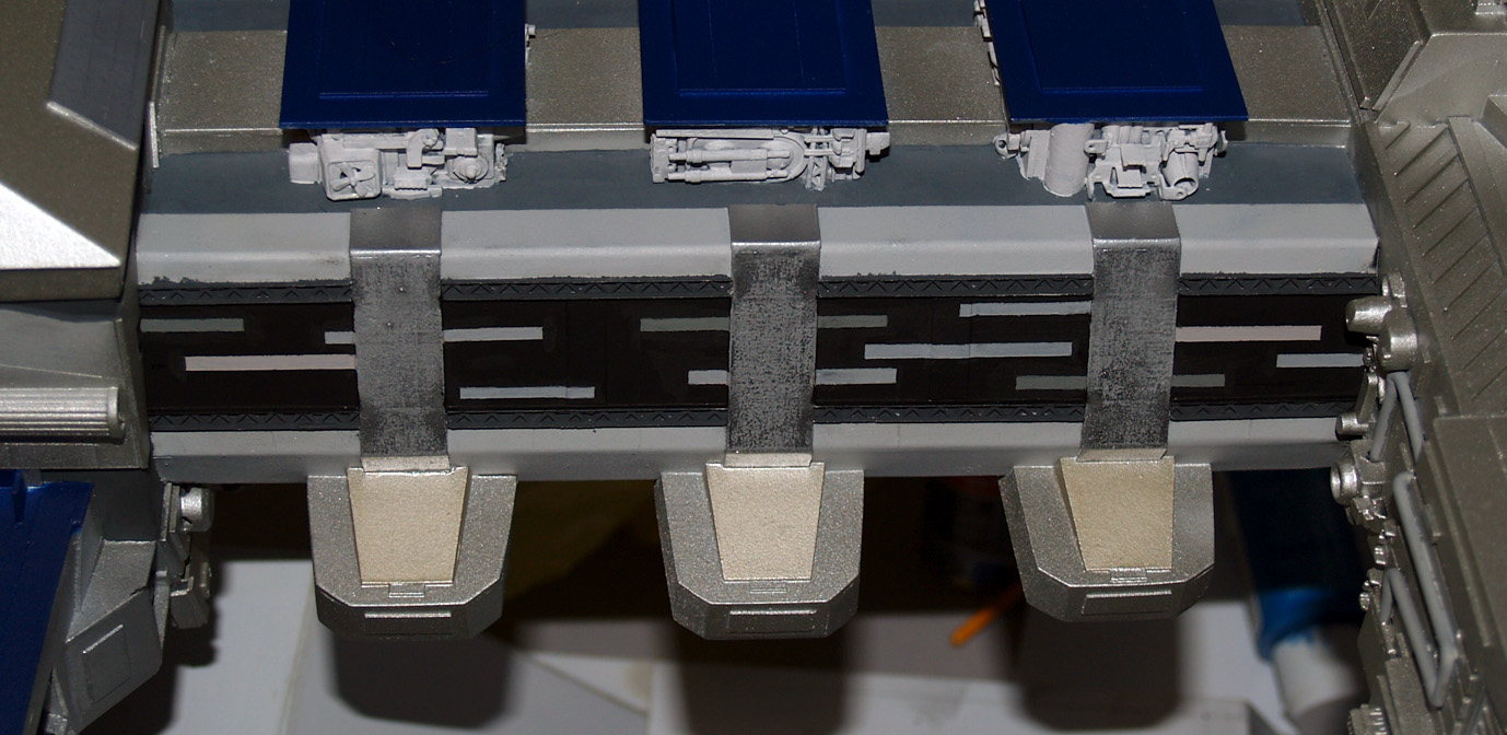

So I went and redid the neck, and it turned out much better. After looking at the pictures, since a camera always shows more detail, I will need to go in and clean it up a bit more. But does look much better than the sharpie lines.
Heres both sides. Used blue tape to start the outline, but still had a lot of paint leak out, so then went and free hand painted black around the edges. The problem with the squares I had before, was the background was a dark gray that I had mixed myself and didn't have anymore, so I couldn't fix the sides. My mistake.
The the trusses that outline the black will need to be repainted a lighter color now to stand out.

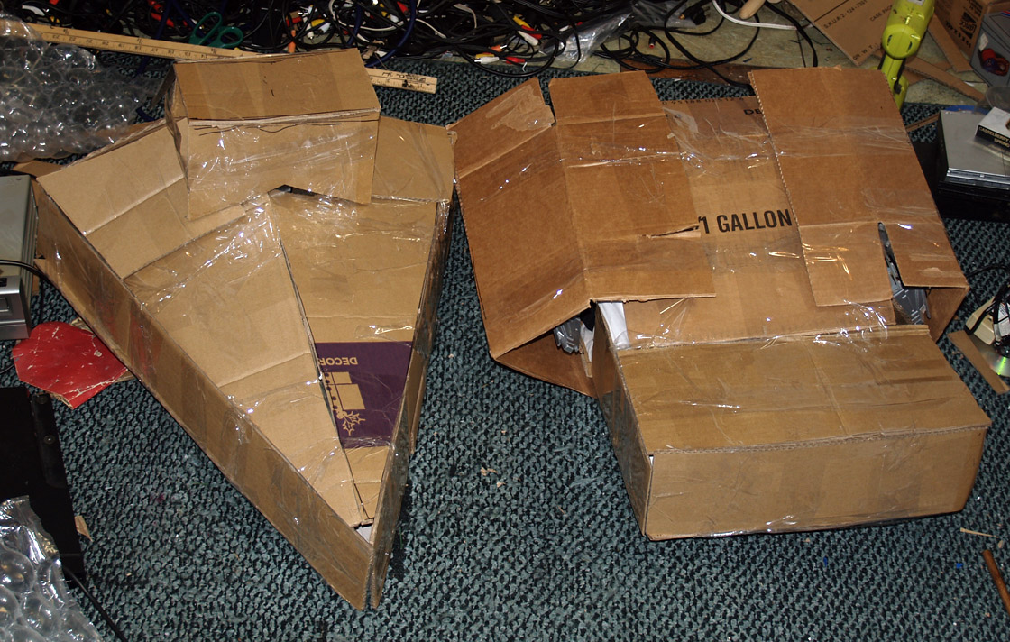

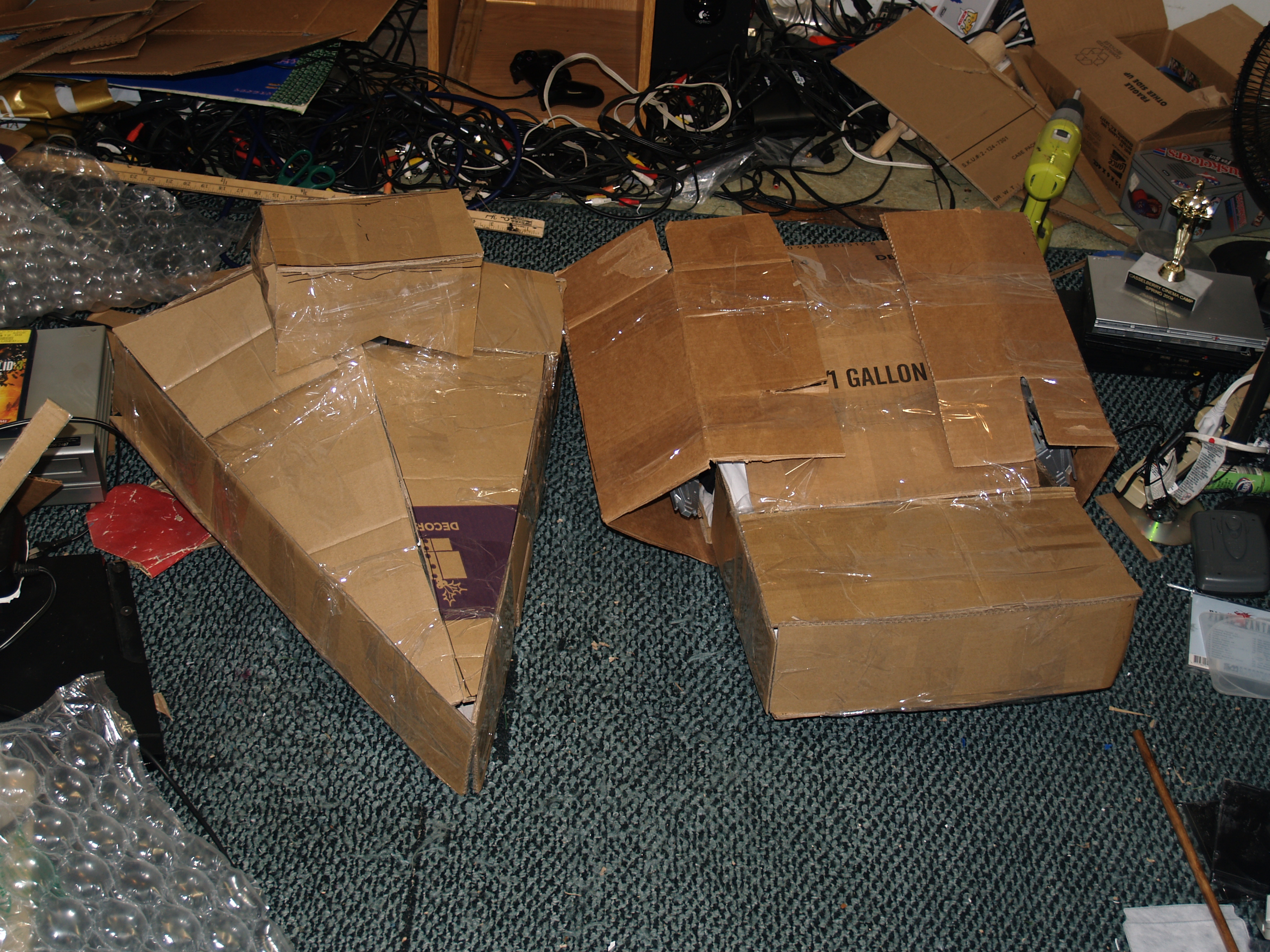

Well, this is it. Time to move from Florida to Idaho. Been packing these last few days.
So this is pretty much my whole life piled up into a bunch of boxes, which then will have to be stuff into 2 different small cars on Thursday.
And the last 2 things, my battle cruiser and way to short star destroyer. I sure hope they don't get damaged, I stuffed old shirts inside the custom made boxes for them both.
It will take 5 days to get there, which I might be able to check out the group, but not sure yet, as I still don't have a smart phone. Once I get there, I won't have internet at all, and not sure when I'll get it. But hopefully I can get to a computer every now and then. Hoping that once I get settled it, I can then do more work on this and then finally get some pics posted, but who knows how long that will be.

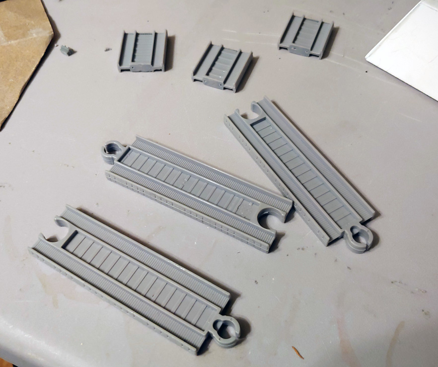

So I had bought these weird train tracks at Hobby Lobby in the sale section sometime last year. So I cut them up as seen in the top of the pic....

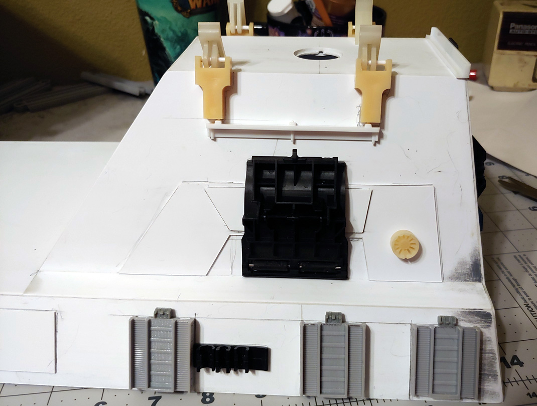

Glued 3 on each side and added part of a gun turrent on the top. I'll be adding much more detail.

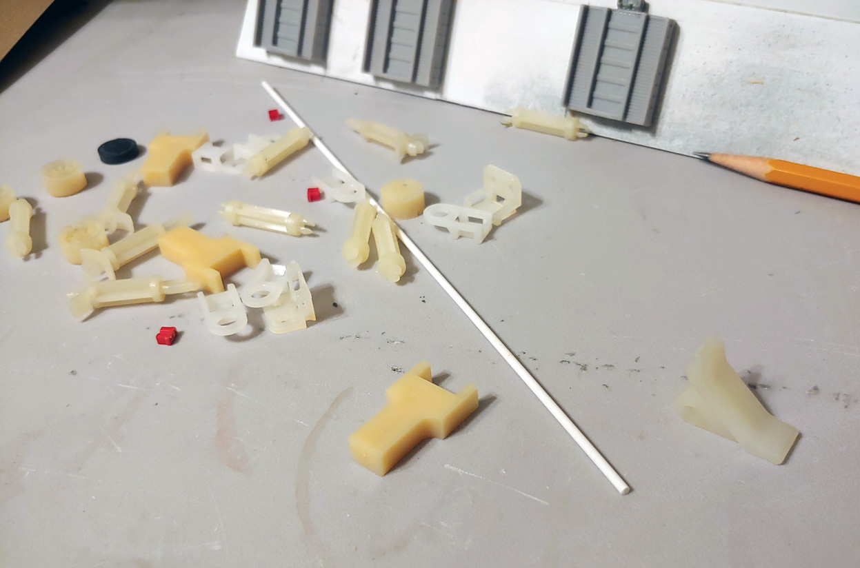

I have all these random parts I got at an electronics store for detailing.

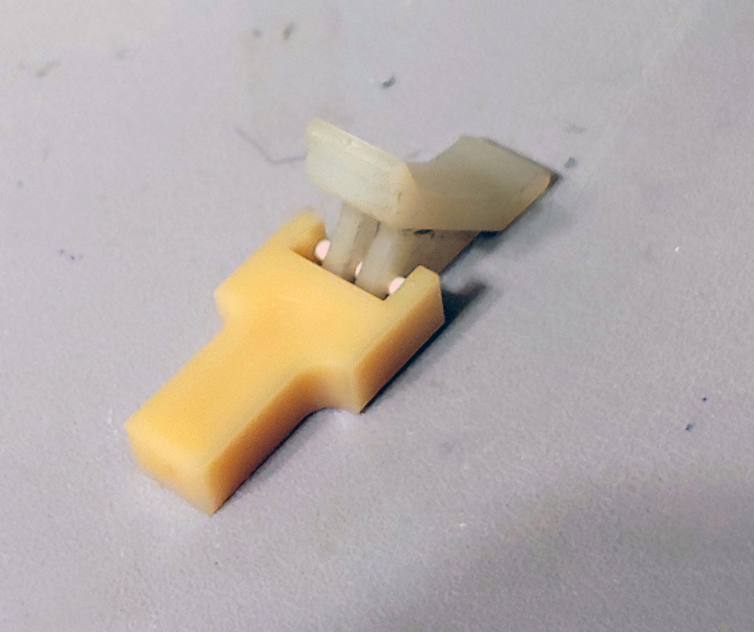

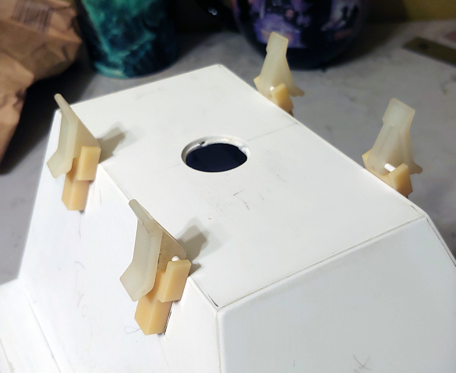

I realized that the long round dowel I have fit through the whiteish plastic part. So I cut it to size and glued it to the yellow part. But kept the glue off the 2 parts so it can move.

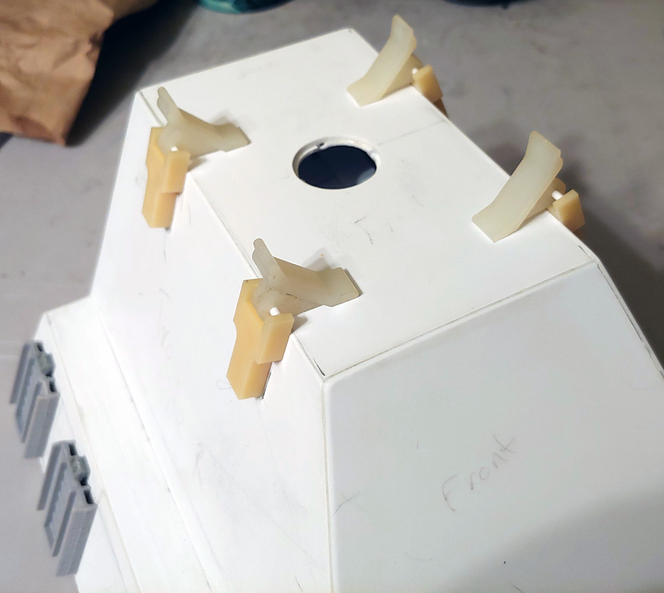

So for now, until I add more detail of course, these parts look like this, kinda like big clamps to lock onto the ship as its landing.
But they can also flip out like this as well for a nice little effect.
So thats it for now. Hope I can get more done soon.

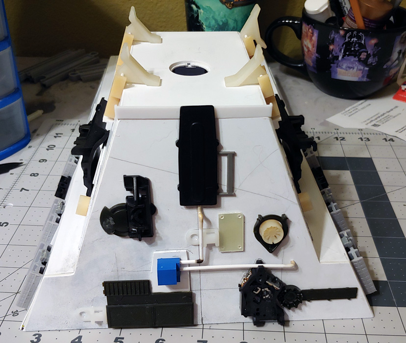

These 4 pics now means I've uploaded 301 pics for this project. Crazy.

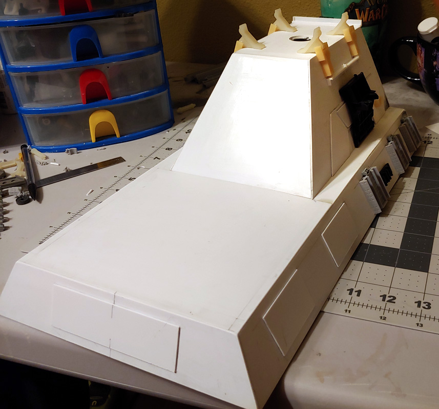

Heres the back of the base. Just kinda went crazy and did whatever, since you wn't really see that part too much anyways. Used a lot of the printer parts I had.
More of the side.
And the front. The big open flat part will have decals about the ship and the logo. The sloped part, haven't decided yet what to do.

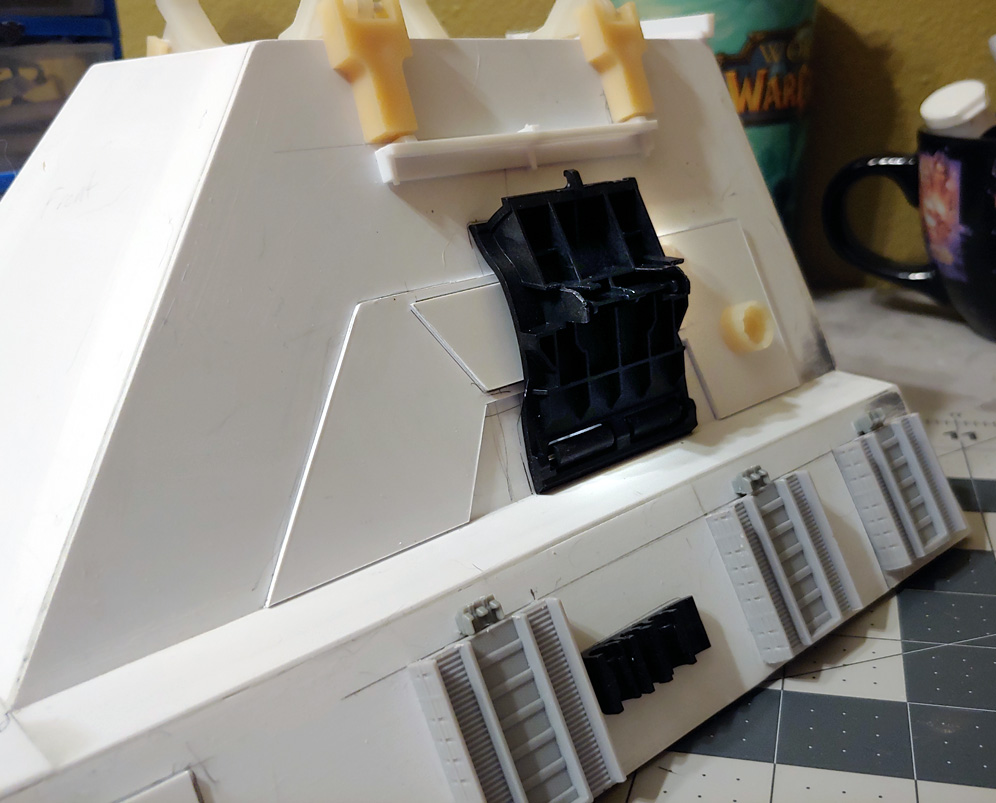

Close up. Still need to add more.
