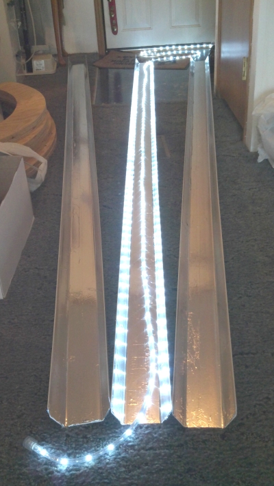

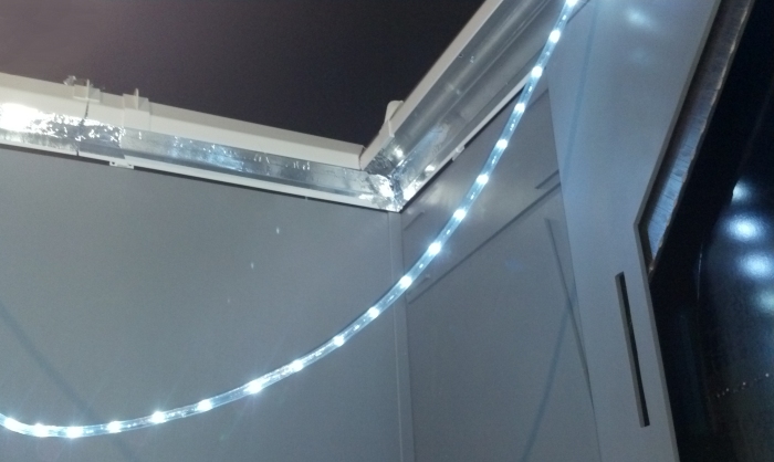

Picked up 3 more 10-foot vinyl gutters today. They have been silvered with the silver metal tape. Testing. Very reflect-y! These will be flipped over for more wall-washing white light. I get the 16-foot rope lights at Wal-Mart. More later.

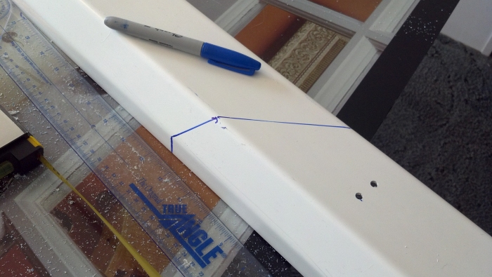

I have only 2 corners to mess with. Here, I'm marking off the 45-degree angle. A Harbor Freight plunge-cut tool is used to cut the soft PVC. It's a piece of cake to use. With that edge-cutting tool, you can cut materials while they are hanging on the wall, or cut them on a bench, either way. It's 10 times easier to cut with than a conventional saw. It's also about a third less accurate, depending on how steady your hand is. But for this project, 100% cutting accuracy isn't necessary. It all gets covered up with silver tape, lenses, edging, and a front "hider" panel.

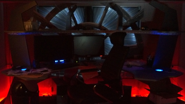

Today I lit the "lightspeed" window shades behind my computer desk. Lighting test! Ignore the desk, it's messy today. Nobody has seen this yet, just YOU guys! Shh!

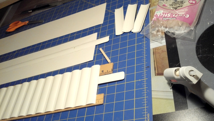

Here we have the different stages of construction for the illumination gutter's front "hider" panel. The panel will hide the front side of the gutter from view.
attachment.php
Start at the top of the image. First, I have a sheet of thick 140-lb watercolor paper {Hobby Lobby} that I have cut into long strips. This paper is not too different from the heavy paper that some lampshades are made from. Then reinforce the back of the strip with a whole window blind strip. Hot glue that sucker down. Don't use too much glue or it might pucker the thin vinyl or the heavy paper. Apply a thin bead of hot glue down the sides like it was window caulk. At the bottom of the image, I've hot-glued 4.75" vertical pieces of window blind. Each piece of blind is spaced apart with that little chunk of 1/4" wood, (see that?) used as a spacer.
Next step, creating a dozen more of these "hider" panels. Then painting these "hider" panels dark gray. Boredom is setting in, but I shall not... stop... building. :unsure

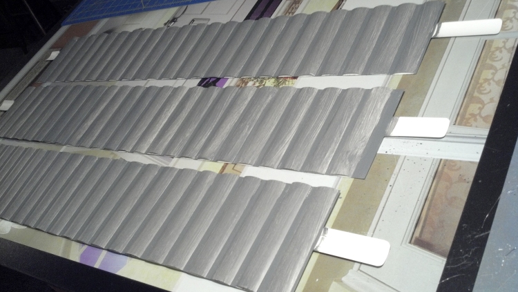

The first three "hider" panels have their first coat of paint.
attachment.php
While these dry, I'm cutting up more old mini-blinds. I have 10 more of these panels to make. Don't tell my wife, but I'm washing some dusty old mini-blinds in the bathtub. Well, I guess it's better than my friend who rebuilt a Ford truck transmission in his bathtub!

Thanks, man. I like how the lightspeed window really "pops" with the addition of the window lighting. I'm glad I used the iridescent blue colors and the sparkly paints. The smearing stars kinda shine and sparkle. It looks "busy" and almost overwhelming. That's what a jump to lightspeed should be, a visual overload.
Too bad my computer monitors block most of the bottom of it. I have two flat monitors now, will be three monitors by the end of the year. I threw 3 of my old prehistoric 22" CRT monitors out by the road. Somebody picked them up!

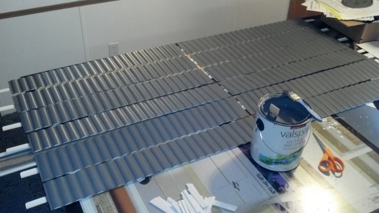

More progress today on my light fixtures. I built more of the "hider" panels. A couple of them have the first coat of dark gray paint on them.
attachment.php
Here's a dozen of them laying on the floor.
Ya don't need special skills to make something like this. If you can use a hot glue gun, and cut a straight line with scissors - you're good. Total cost so far $14. 3 pieces of heavy watercolor paper x $3 plus a pack of hot glue sticks $5 plus recycled miniblind slats $0 = $14

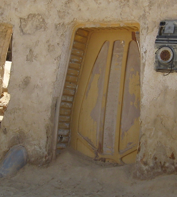

These panels under construction remind me of the detail seen on various Star Wars sets. Like, on the doorway edges in Tatooine and other places.
attachment.php
Above, Tatooine set building doorway edge

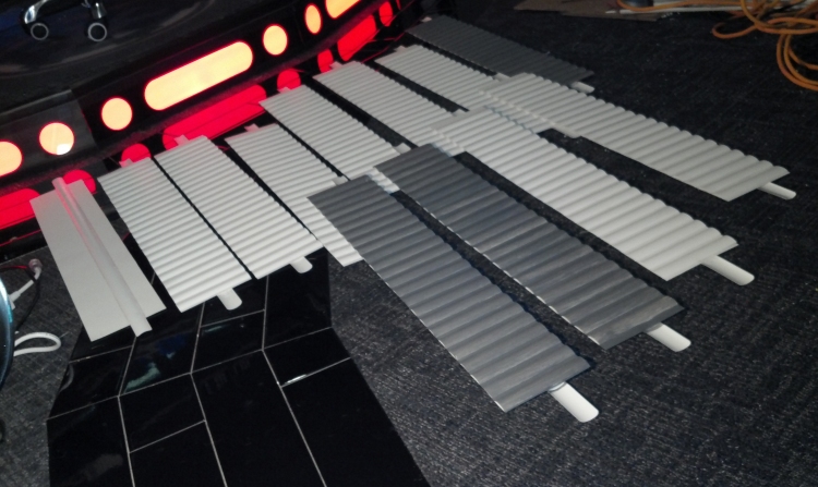

At last, the "hider" panels all have 2 coats of dark gray paint on them. I made 12 of these. Something tells me I will need 13 of them to finish it. Hmm.
attachment.php

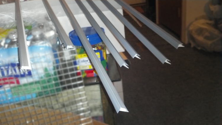

And some trim pieces are painted. They are the "F" channels that will snap on the underside of the light fixture and hold the lens in place.
attachment.php
