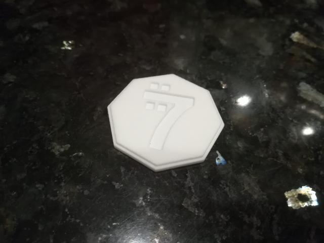

Just got the raw 3D-print!

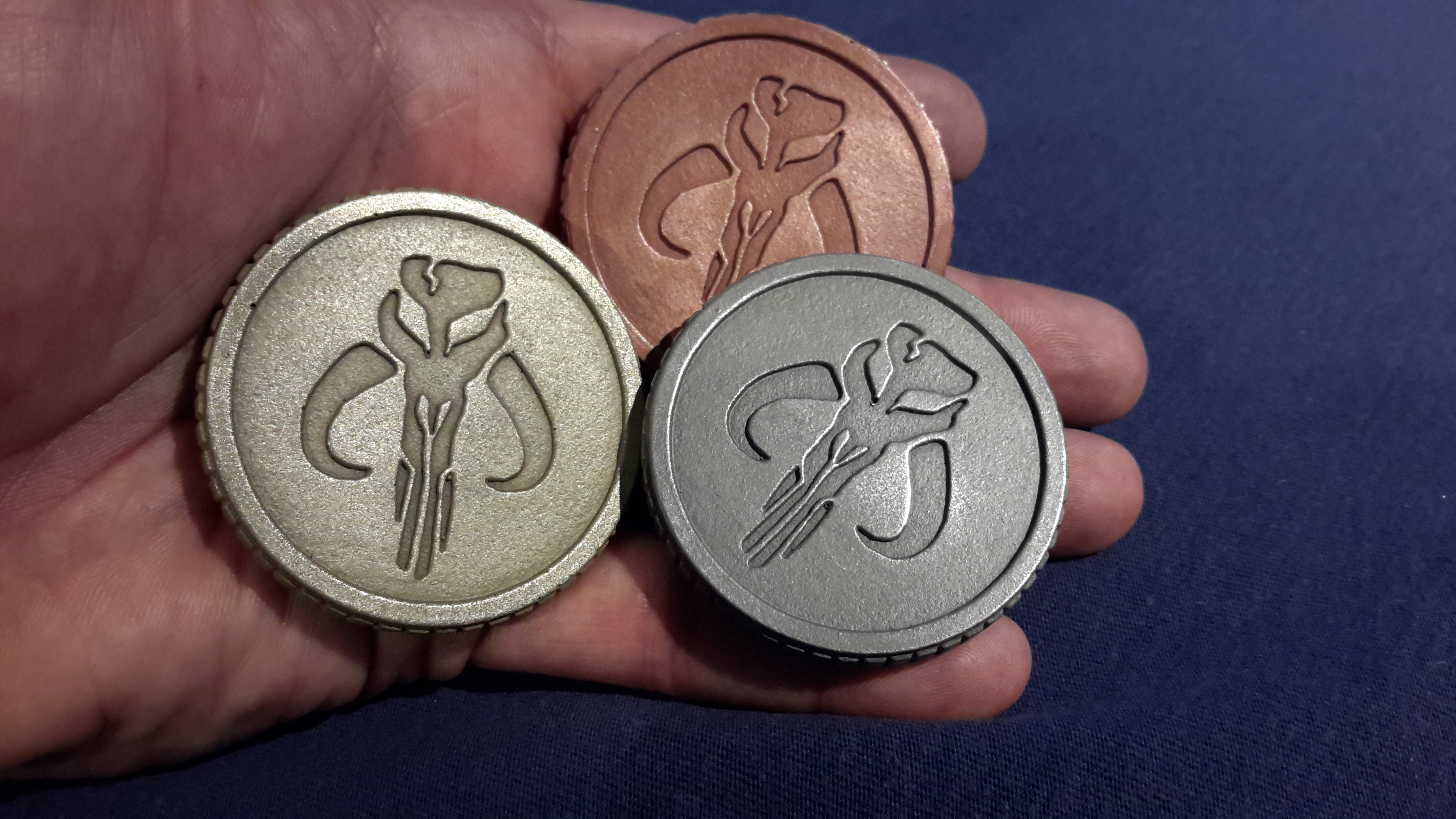

The Mandalorian Coin also:
At least, these two shouldn't be too hard to cast:rolleyes:
The real experimental work currently goes into this transparent crystalline coin:
First trying it the "official" way with transparent resin which is then painted on the outer parts. But getting bubble-free results is almost impossible without a vacuum-chamber...(n) And this transparent type of resin takes literally DAYS to cure completely:mad:
Maybe I'll try the two-component-approach on this one with putting a laser-cut acrylic part into a metal-resin-mix...:rolleyes:

Finally some time for updates.

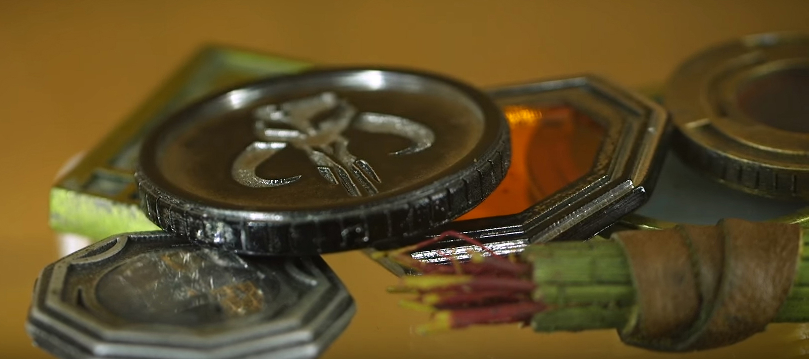

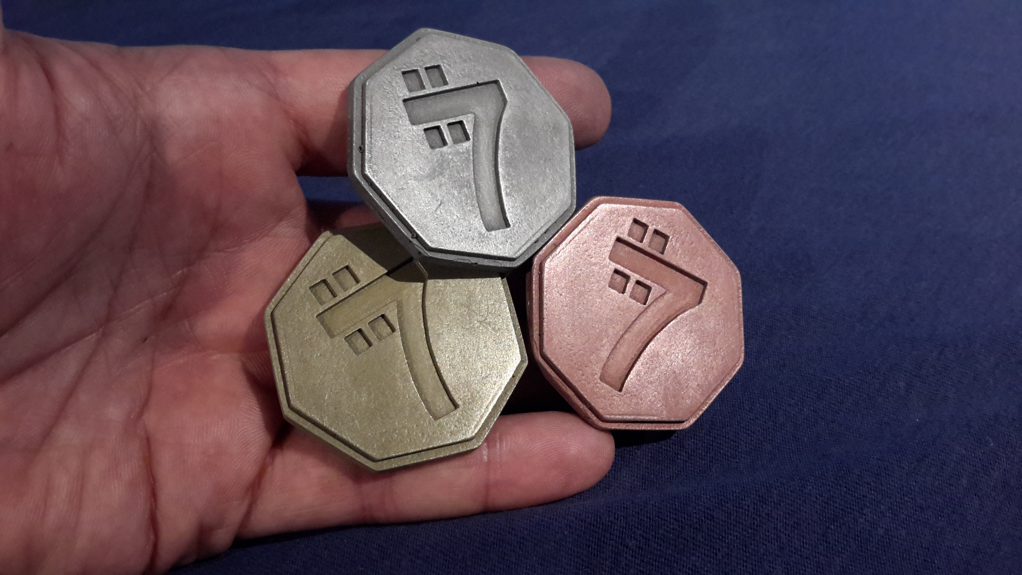

The Mandalorian coins and the simple galactic credits turned out quite nice:
But the ones with the transparent centers are still keeping me busy. Doing complete casts in red-tainted transparent resin didn't work out for me. Without the right equipment to degas the resin they just look to bubbly inside. So I went for my two-part method.

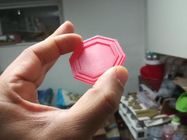

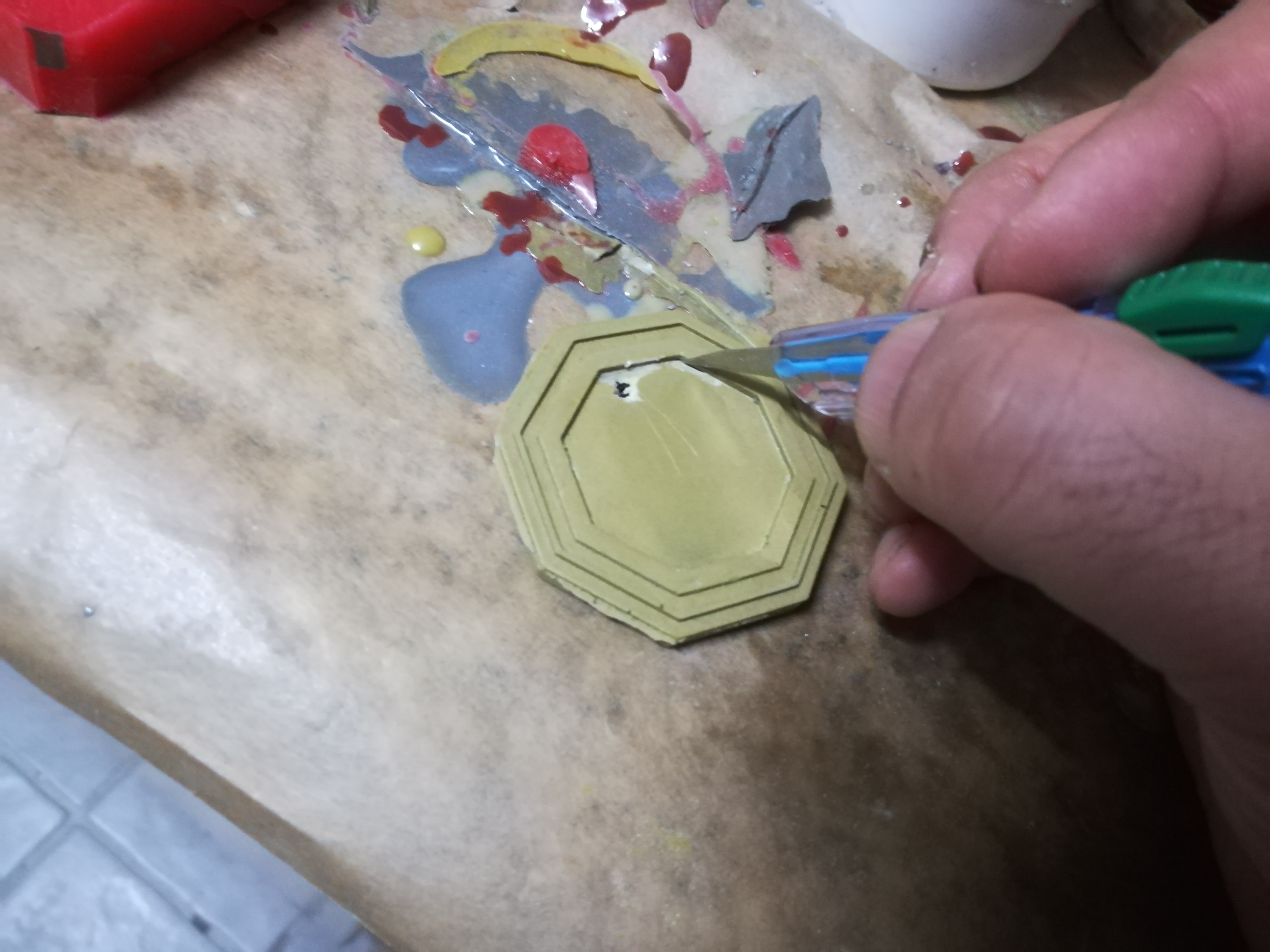

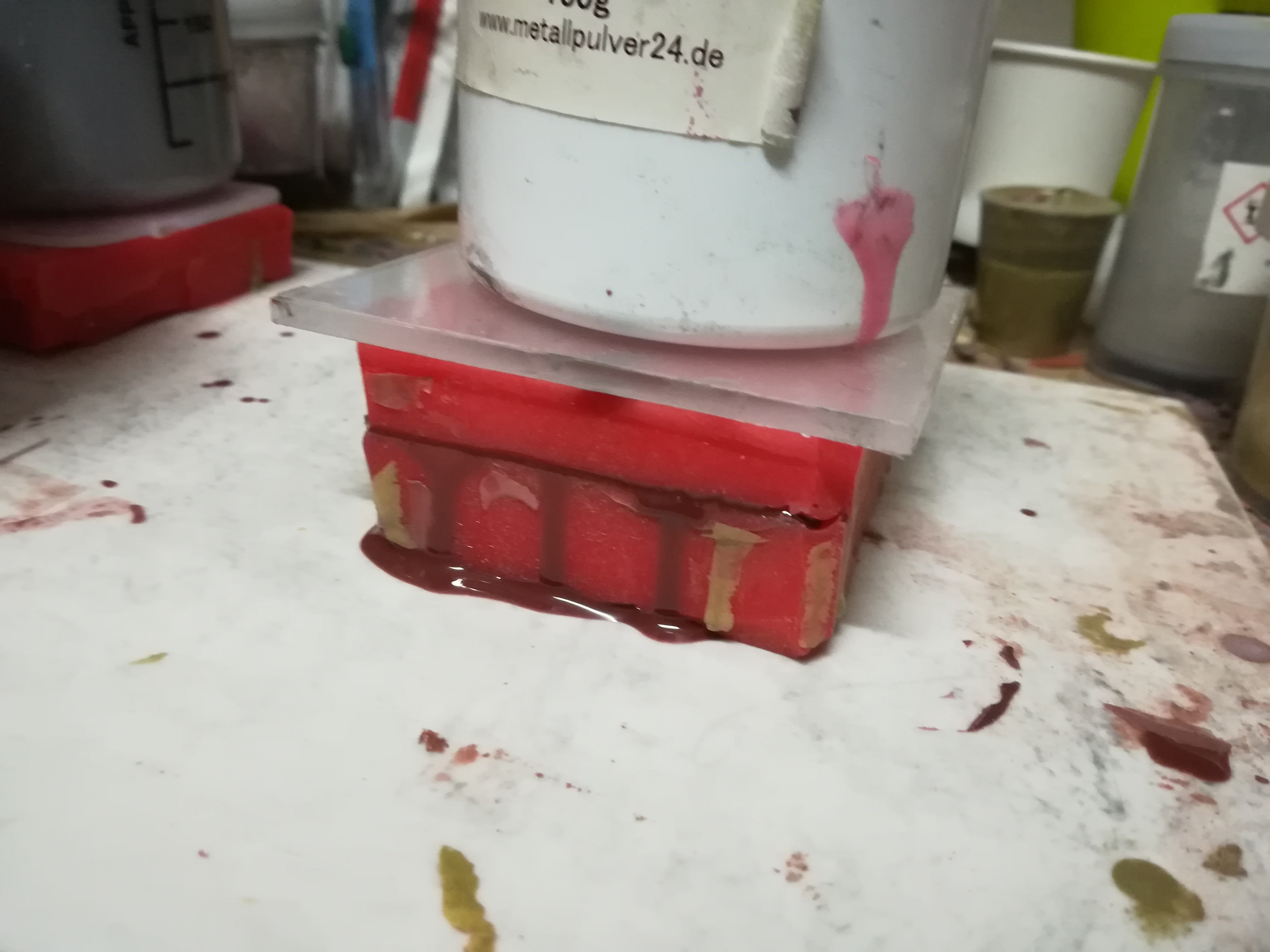

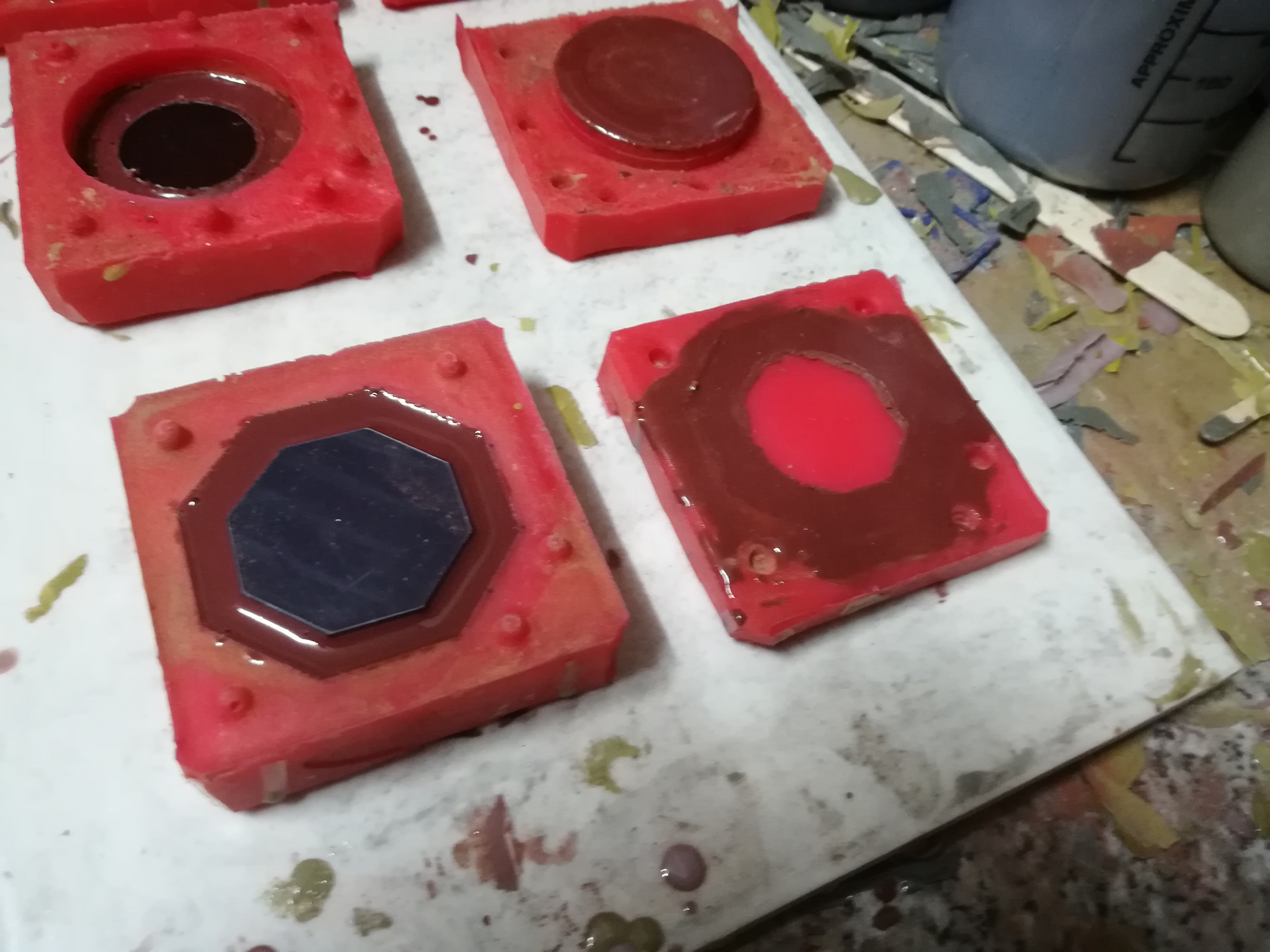

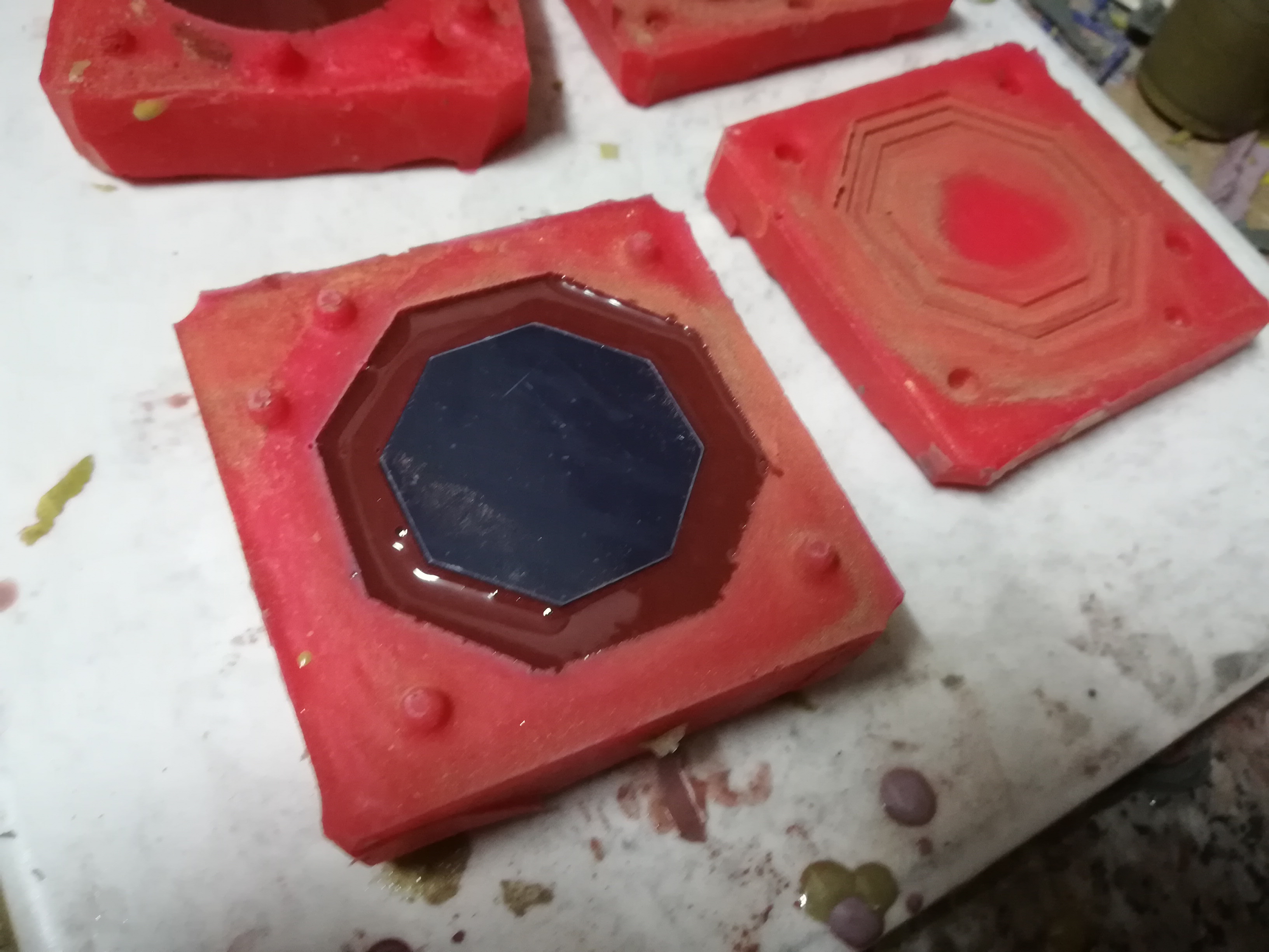

I had these acrylic octagons made:

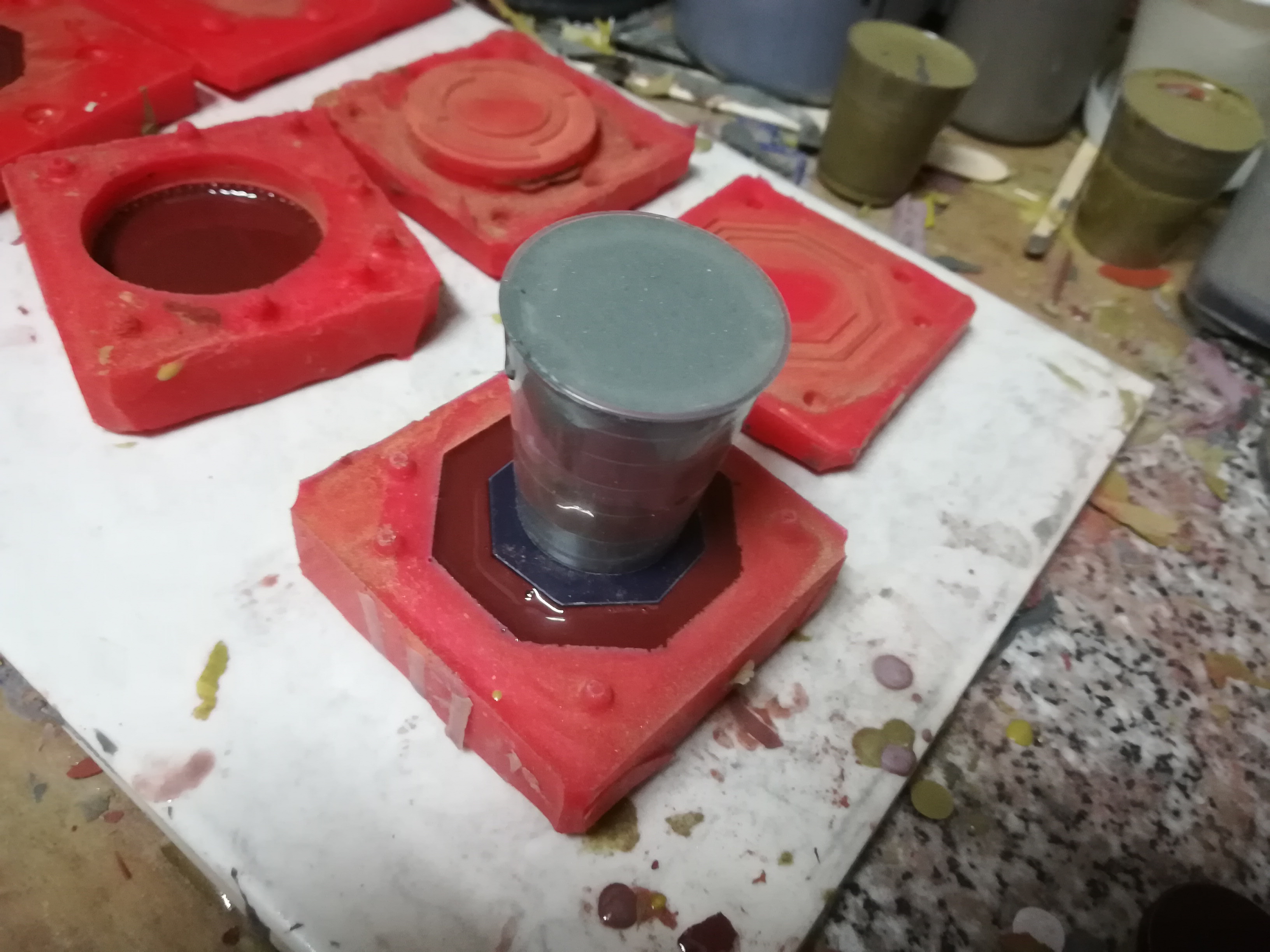

I made a two-part mold for the coins. I then poured a bit of the metal-resin mix in, inserted the acryl-part and used a weight to keep it in place:
(I tend to pour any excess resin into these small beakers for that purpose).
The two mold-parts are asymmetric, so one part is much thinner.
After the resin has cured a bit, I mix up another small amount, pour that in and squeeze both parts together.
(The resin I'm currently using has got a curing time of 3 hours, so I do this after about 1 hour)

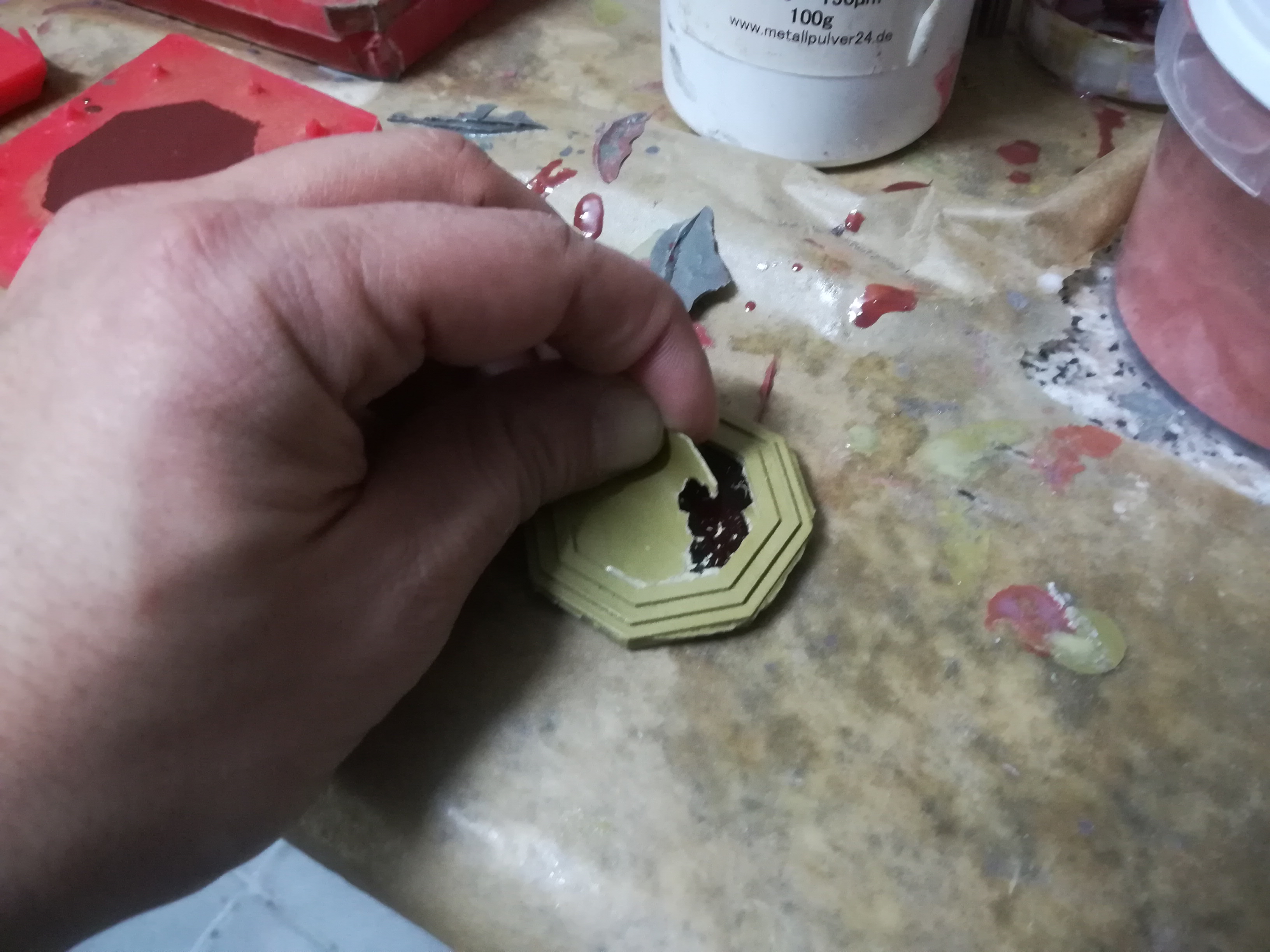

When the part is completely cured, I cut out the thin layer of resin in the middle and peel it off. (No matter how much weight I put onto the mold, there'll always be at least a minimal layer of resin on the crystal part).
This way I can have a heavier, metal-cast body and still the plain transparent center. Though this is surely not the way the original props were made, I'll still stick to this method, because I like the result better.
But there's still a lot to improve. I've already been told, that the red of the acryl is too dark. So I'll try to get some in a lighter red. And I somehow have to improve the process to minimize irregularities.
So if you people got any ideas for me, I'd be really happy!

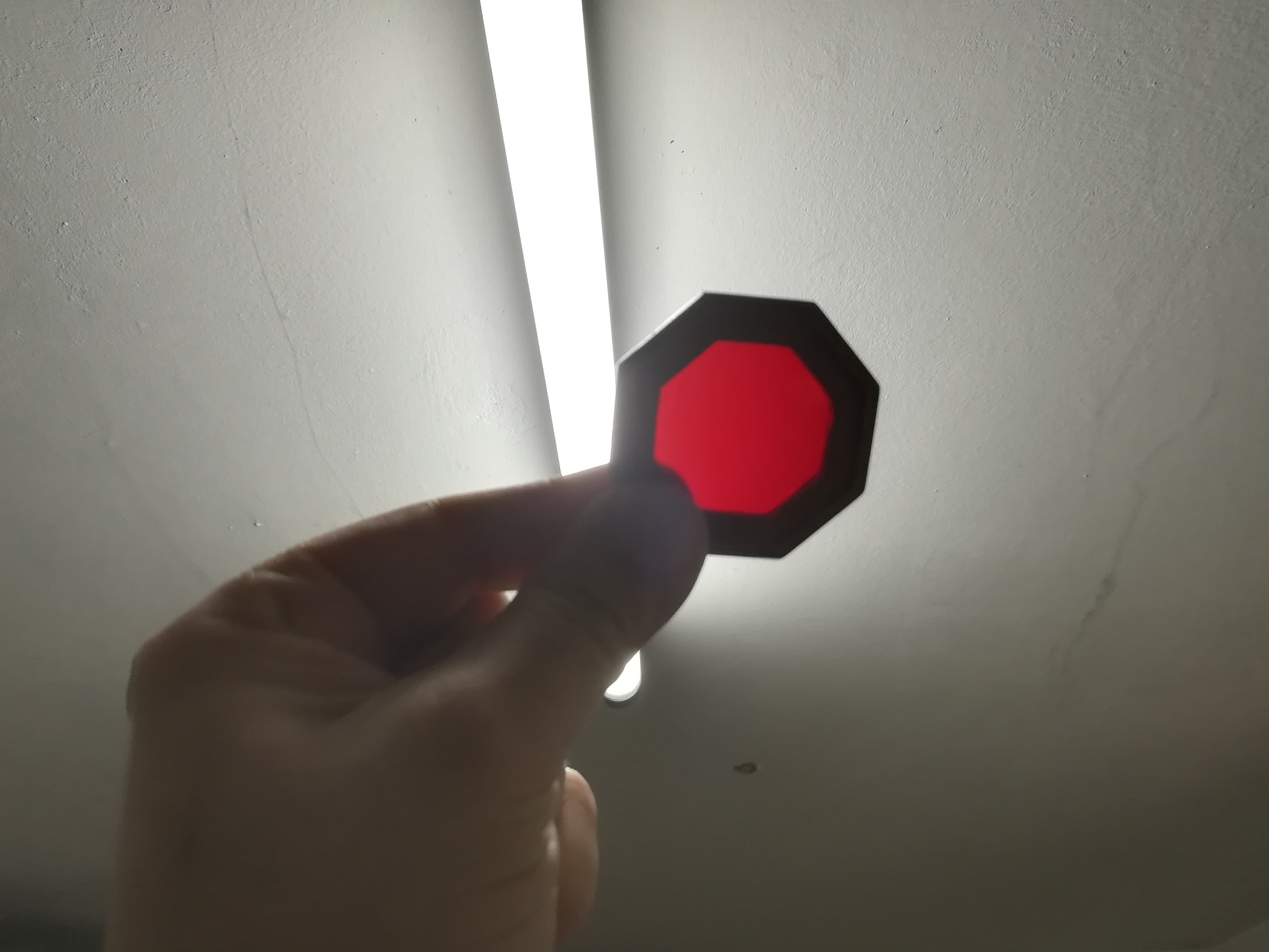

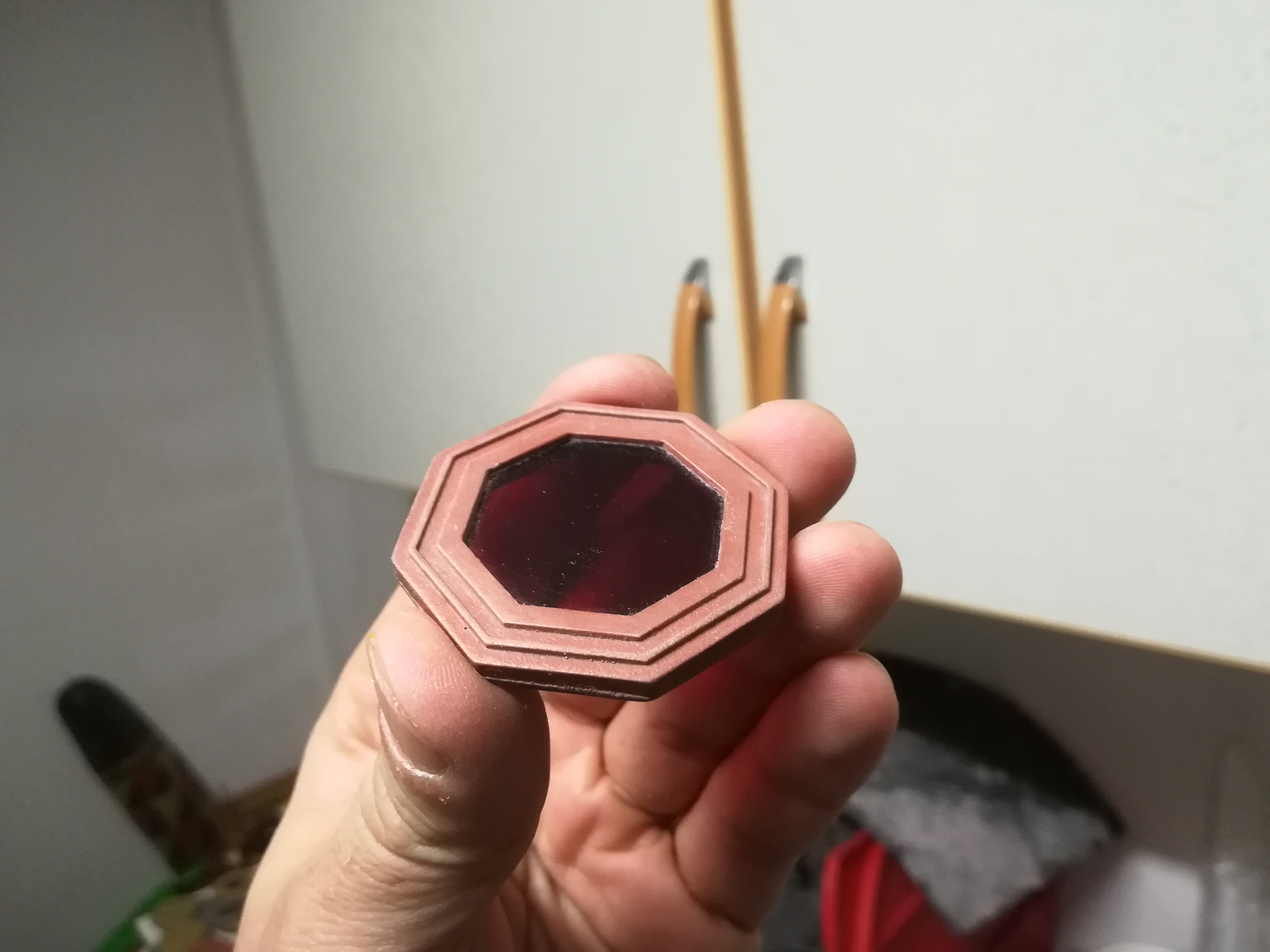

Great work! These are coming along fantastic. The Mando coins and Credits are spot on in detail.
The red center is a little dark. My reference has it closer to an orange. I did mine by laser cutting acrylic centers and gluing them in after casting.

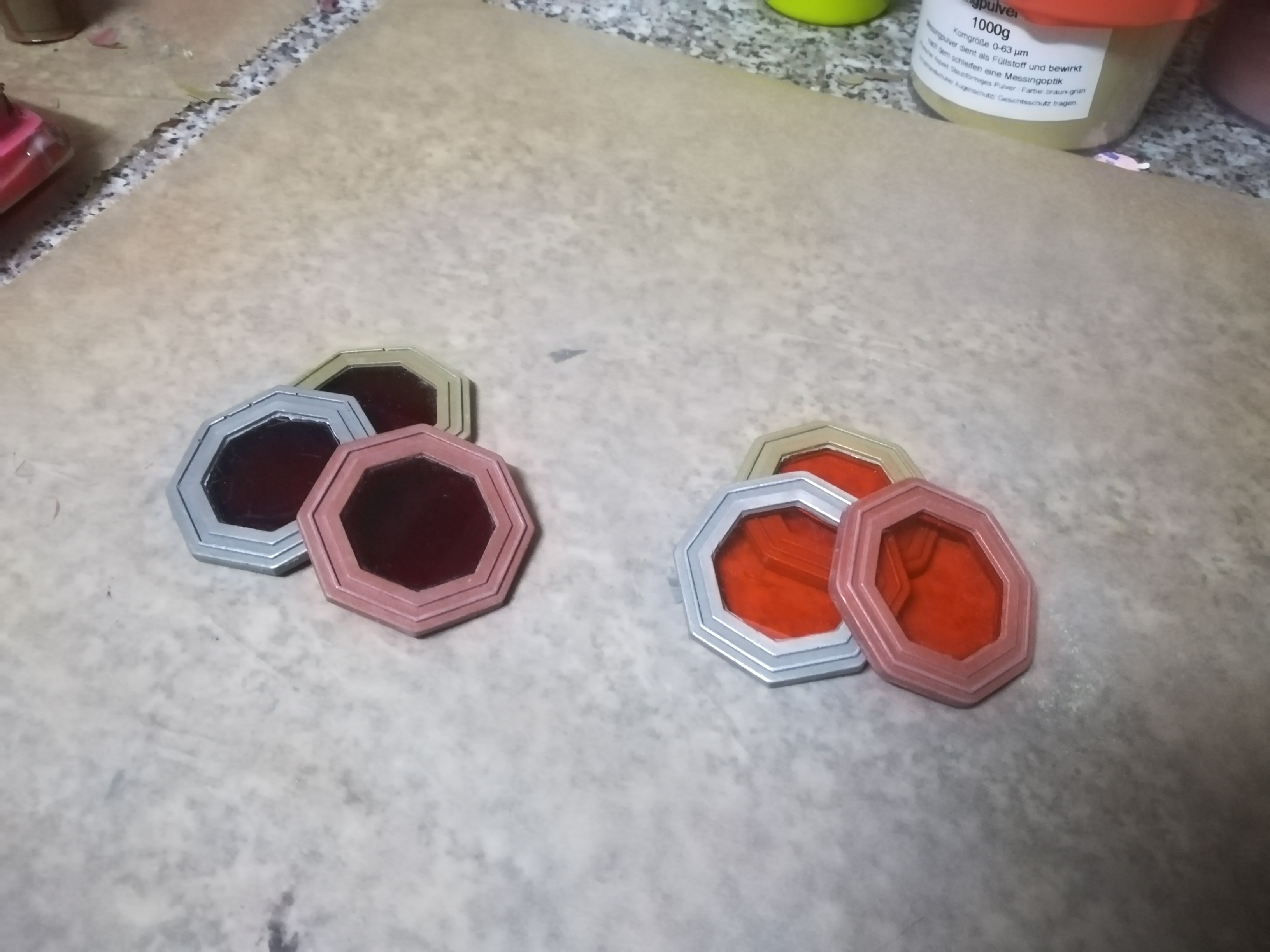

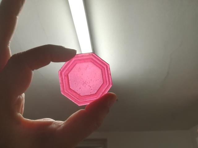

Yeah, you're absolutely right! I already had some new acrylic parts cut in orange, which seem far closer regarding the translucency:
So they are a lot closer, especially to the stills from the "Star Wars Show"
But all the coins on the other promo-pics seem to be a clear red. I don't know, if those pictures were all color-adjusted or something.
For some reason, transparent acryl is only available over here in dark red or orange, no bright red (despite some horrible fluorescent neon-red...)
What did you use for your parts? Would you share some pix of your acrylic parts for comparison?
(I'd even be willing to order acrylic-sheets from abroad, if they are a better match).

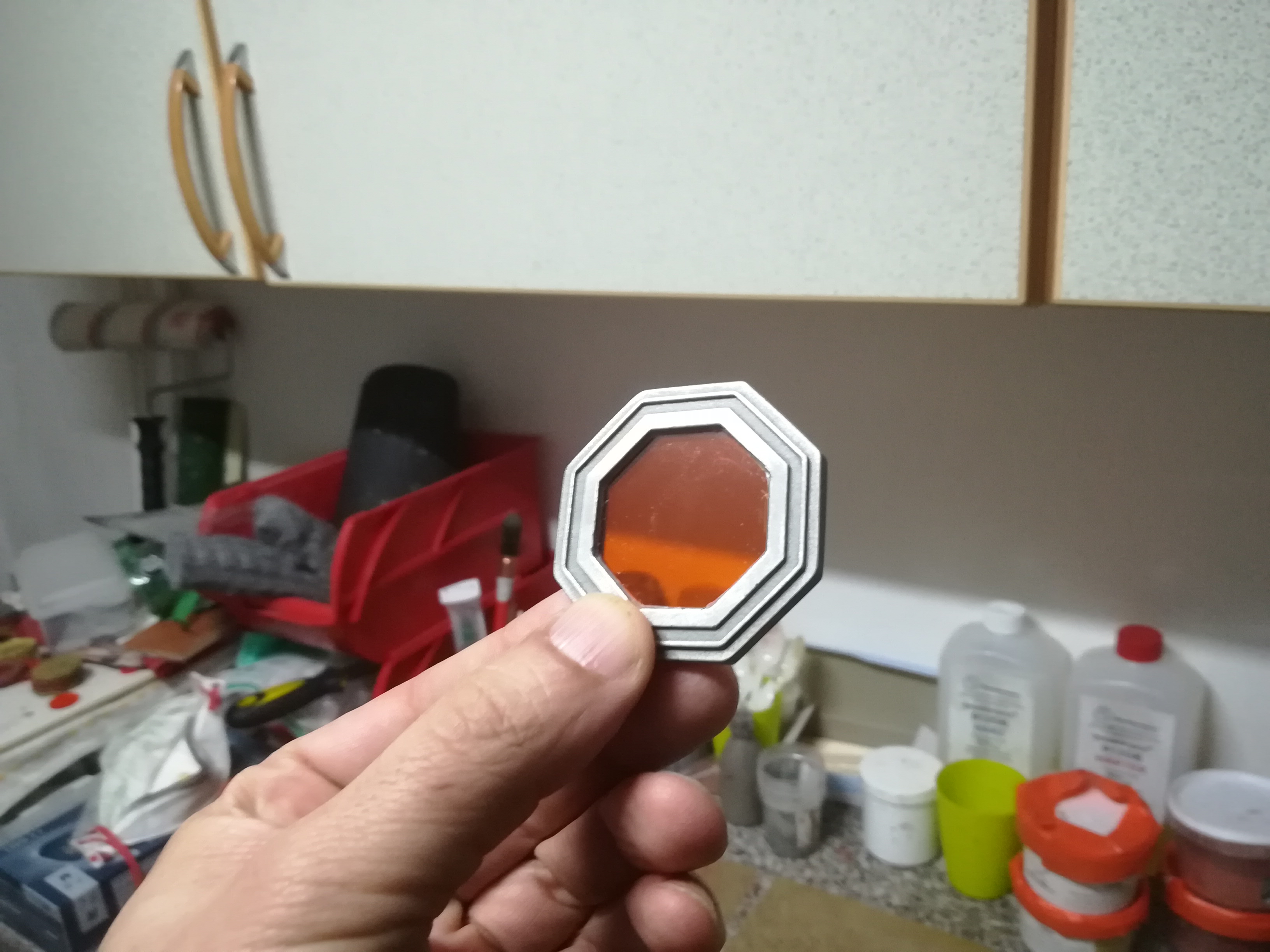

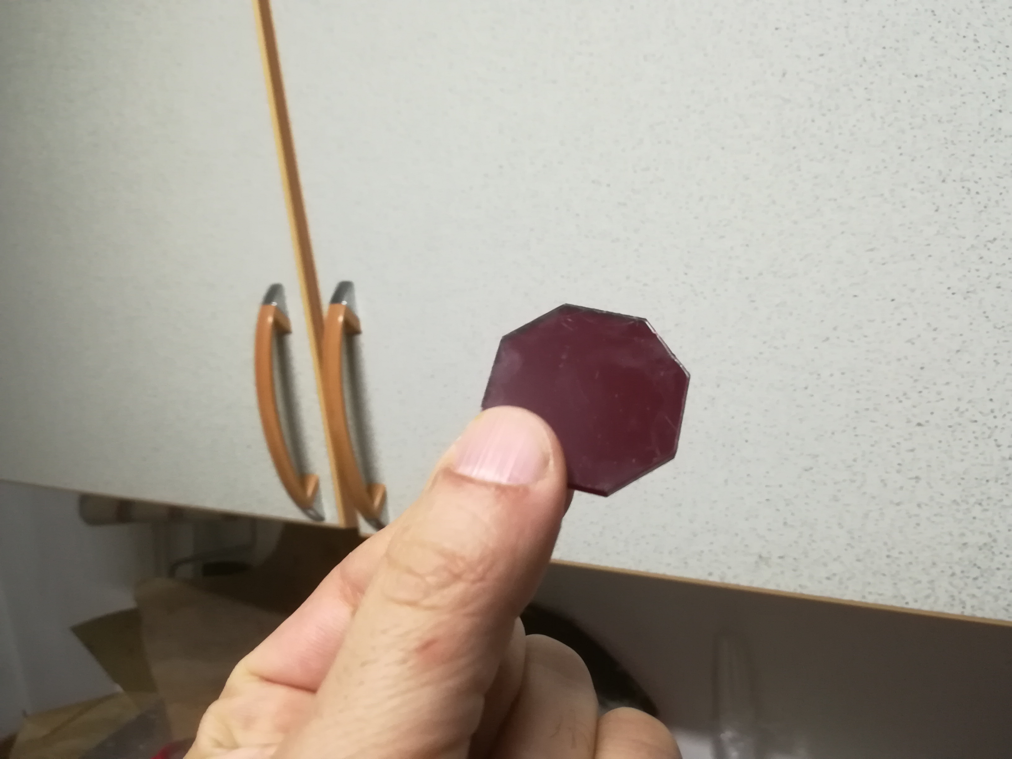

Here another pic of the "old red" and the new orange crystals:
For now, I like the orange ones better. But I still got the feeling, that they are not really perfect...
I'm pretty sure that the orange I used is the same as the ones on the right. I just added some patina aging. It really helps bring them into the right tone.
