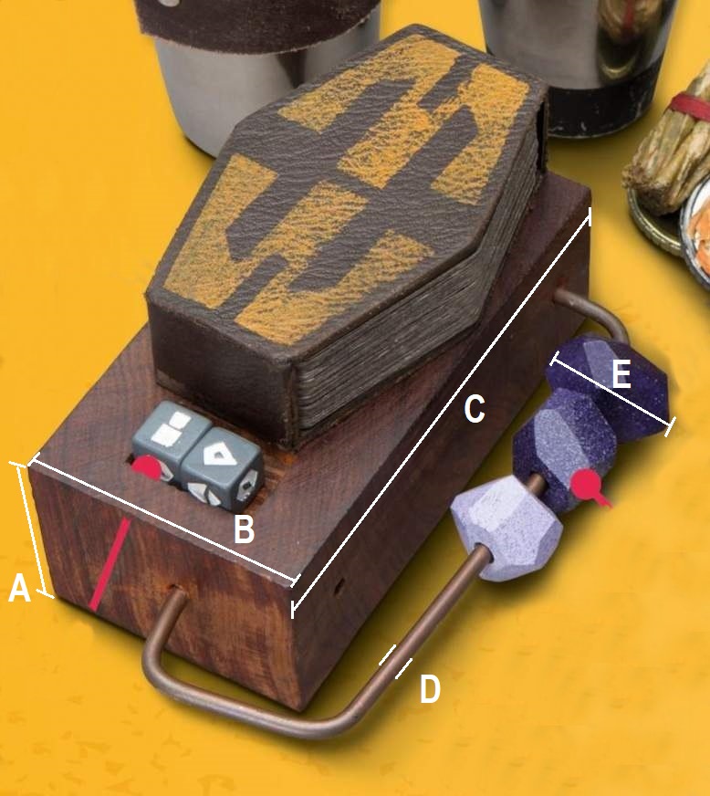

I'm thinking about building the wooden "counter block" on which the deck and the dice are placed. So I'd like to ask for some help with the measurement as well as the "honest stones" like they are called in the official guide. I think they are just used for counting the rounds. (see here www.youtube.com/watch?v=zm2NqofKUMA - 0:56)
Here are my eyeballed measurements:
A = 55 mm (~ 2 3/16 inch)
B = 80 mm (~ 3 1/8 inch)
C = 150 mm (~ 5 7/8 inch)
D = 5 mm (~ 3/8 inch)
E = 40 mm (~ 2 9/16 inch)
What do you think?
And has anyony an idea where to get those beads/stones?
Thanks!

Your dimensions seem about right to me, assuming the dice were made from regular blank 16mm dice, B should be 83,5 mm and the rod's gauge 5,5mm although I'm not sure if this is a standardized size (the trick will be to know if it's imperial or metric system... is 0.2 inch gauge wire a thing? does anyone know where these props where made?)
For the stones I was thinking about carving them by hand or making a 3D model, then make molds with resin. Maybe adding thermal pigments to the resin.

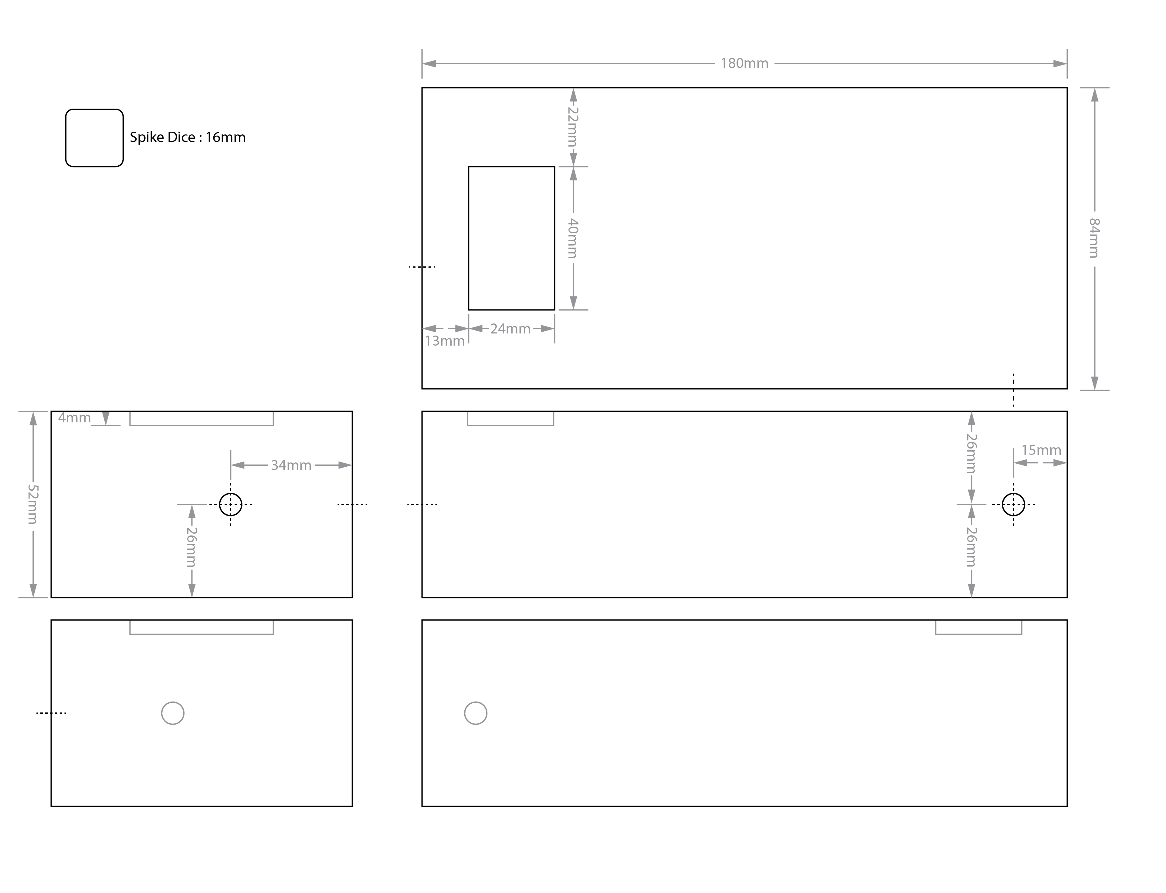

Haha, while doing research for the Sabacc deck myself, I was looking at how to create the dice, deck box, betting chips and wood block as well and came to almost the same size conclusions as yourself, going off the dice's assumed size.
I was actually thinking of making one and hollowing it out, and having the wood block have a drawer or something inside so deck, box, dice and chips could all go away inside and then if you wanted to play everything you needed was all together. The block is a bit tight though, so once you'd factored for draw thickness, there wasn't much space for anything, haha.

The picture is indeed from the visual dictionary. I "cleaned" it up a little to highlight the block.
I think the dice are custom made. To me the right one looks a tad larger. (on the picture from the Star Wars Show it's the left one)
IMHO basing the measurements on those will also bring some inaccuracies...
But honestly I personally do think 80, 84 or 83,5mm is all close enough. (y)
Only the length difference of 180 to 150 mm seems to be considerable.
I based the length (of 150 mm or ~ 6 inch) on the "16" mm dice and my 116 mm (x75mm x 33mm) card deck holder.
Thinking about that the card holder should define the measures of the block.
So if your holders are larger or smaller I suggest adjusting the measurements of your block.
