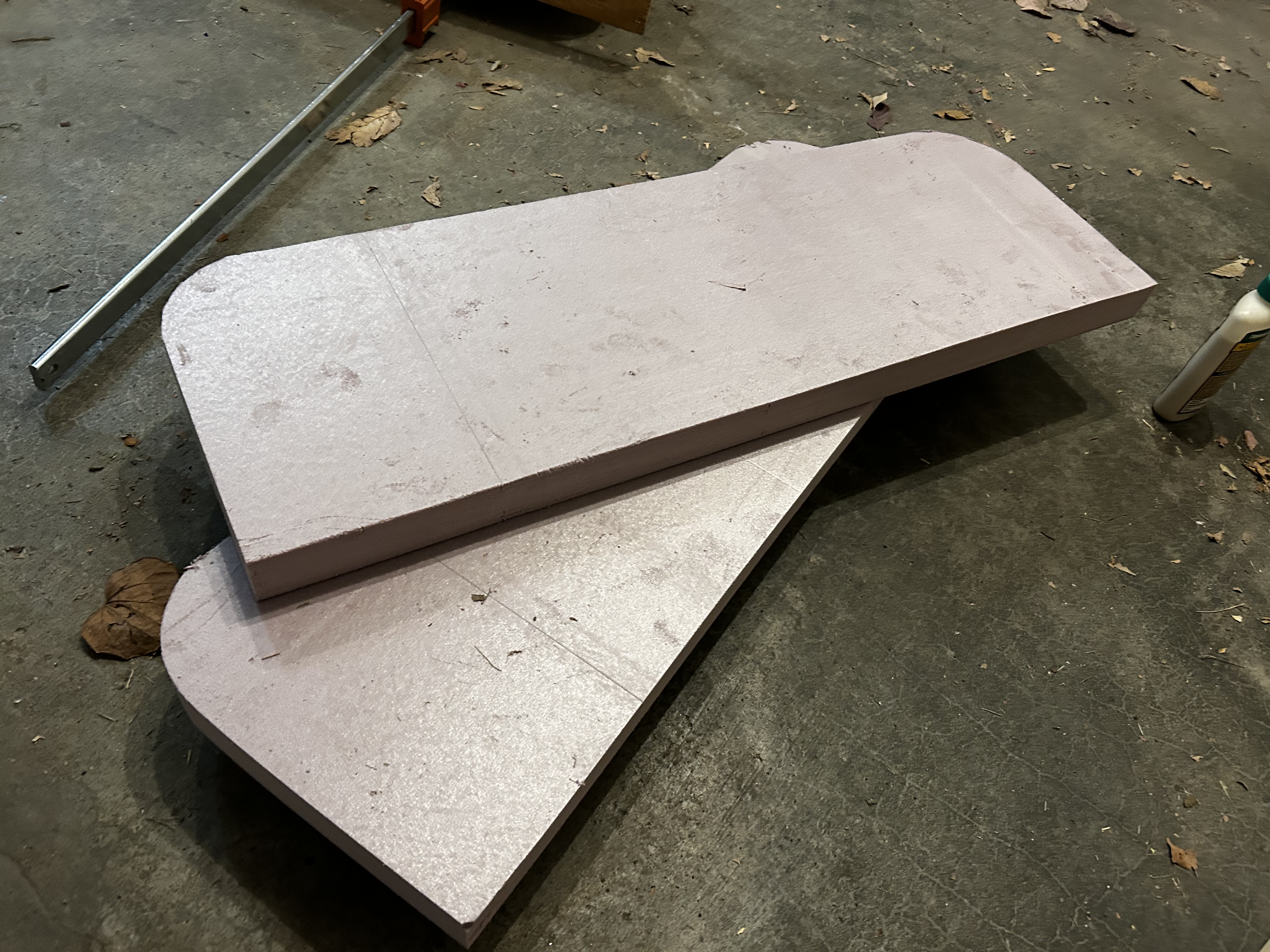

Interesting challenge. I’ve been using wood glue with foam for years and never had a problem. Of course for this project I’m having a problem with the glue not curing.
It’s always something .
I’ve glued up more of the structure. I’ll start skinning it next.
Jastor00
Liquid Nails works well on extruded polystyrene insulation. Model Railroaders use it to create scenery. Worked for me!

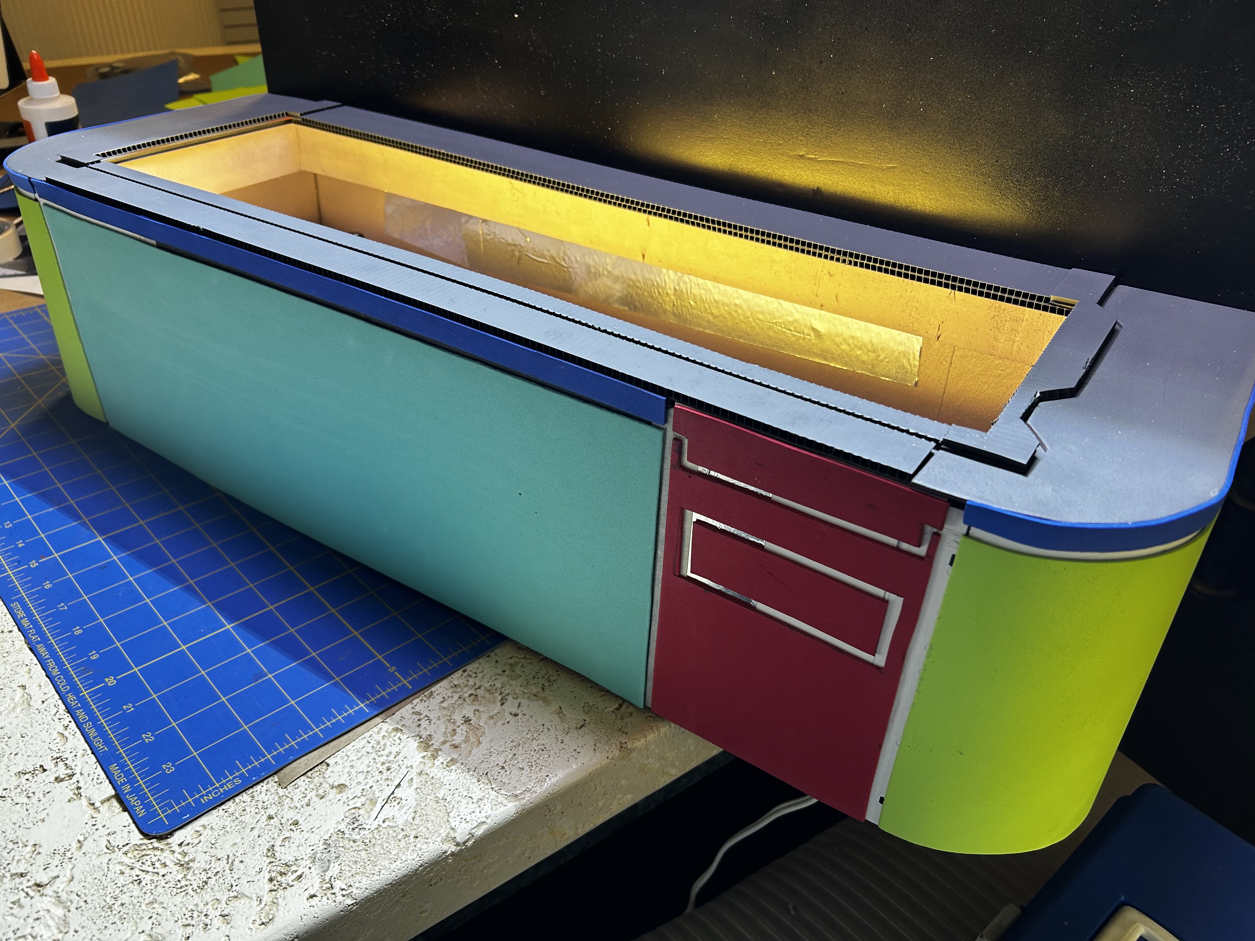

Very cool idea - are you planning on having it as a static display or will you add in any electronics?
I’ve installed lighting but don’t think I’ll do anything further. The LCARS display will be a transparency. The top and bottom sections will remain accessible, so I can always add a Bluetooth speaker or rethink electronics at a later time.
Adding the final details starting with the bottom section, craft foam attached with spray adhesive. I think the replicator is starting to look like a child’s toy with all the primary colors.

Craft foam is ubiquitous and inexpensive. I'm using a large pack I picked up at Walmart for about $4, I think each sheet measures about 11" x 16" and there's probably 20 sheets in the pack. It's pretty easy to work with, you can cut it with scissors or an X-acto blade. It has stretch to it -so it can cover for less than perfect angles or cuts, and has pretty good strength (though you'll tear it if you're too aggressive). It can be easily textured if you're trying to replicate leather and can also be lightly sanded.
The colors don't mean anything, it's a material primarily used by kids for arts-and-crafts so they're just bright and vibrant.

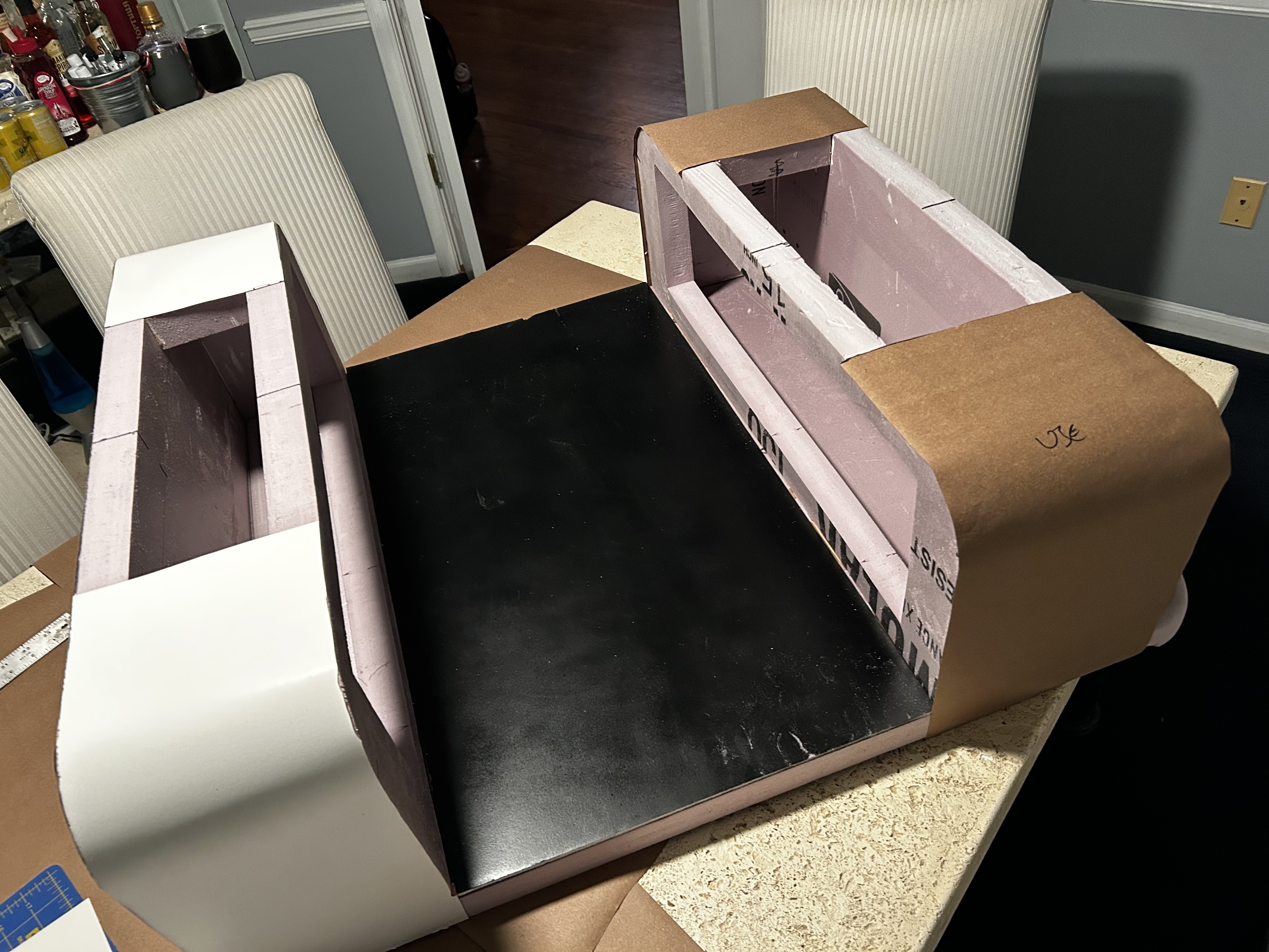

I’ve got the bolsters added. You wouldn’t guess it took a couple of days.
They’re connected at about a dozen load bearing points with wooden dowels driven through to the attached shelves to help support/distribute weight.
After they were attached, skinned them with poster board to cover the the connection points. Next step is to do the same through the back.
