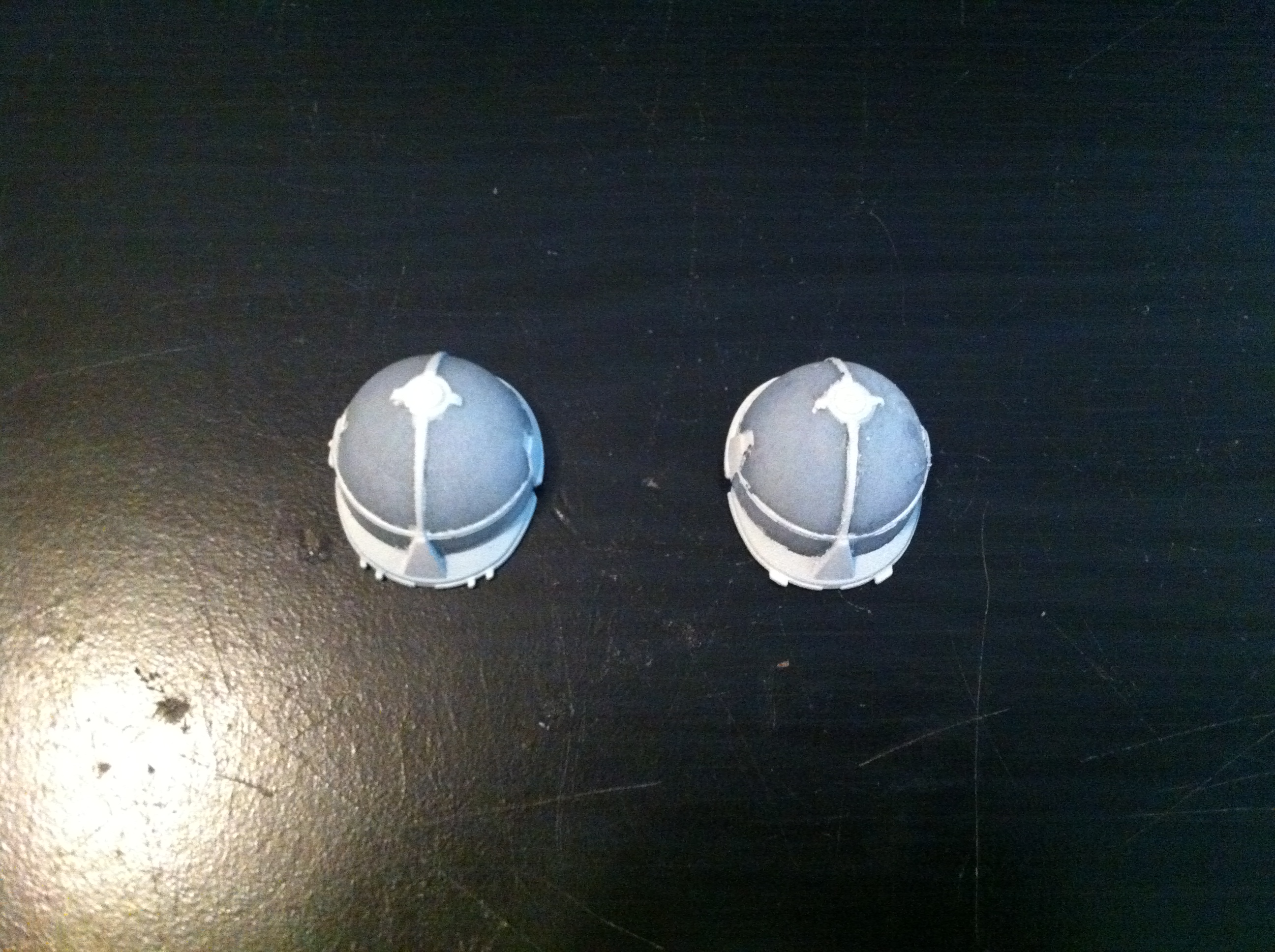

Did you frost your domes at all? In your video the blades almost have the illusion of spinning themselves, which is nice. However, in this video, the blades don't look like they are spinning at all.
Into Darkness Nacelle Test - YouTube
I was just wondering what you might have done differently to get that spinning look.
Hey DanielB, yes I did frost them using Rustoleum frosted glass spray paint. However it wasn't my first idea. I had seen a few modelers paint the bussards collecters with a shade of transparent blue and I first attempted to do the same with a 3oz. can of Testors transparent blue. After 3 failed attempts and cleanings, the plastic started to fog up so I frosted it anyway. I'm sure that had I been successful with the transparent blue the look would have been crisper and less faded, but overall I quite pleased with it.

If you are looking for a clear blue alternate, try the Tamiya TS-72, which I have seen good results from.

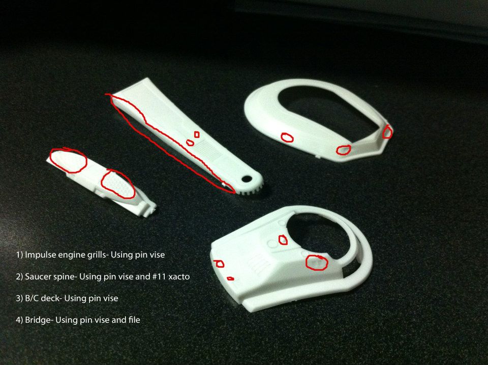

The next step in my process was to make the small changes to the kit for the bridge, bridge spine, engines, and b/c deck.

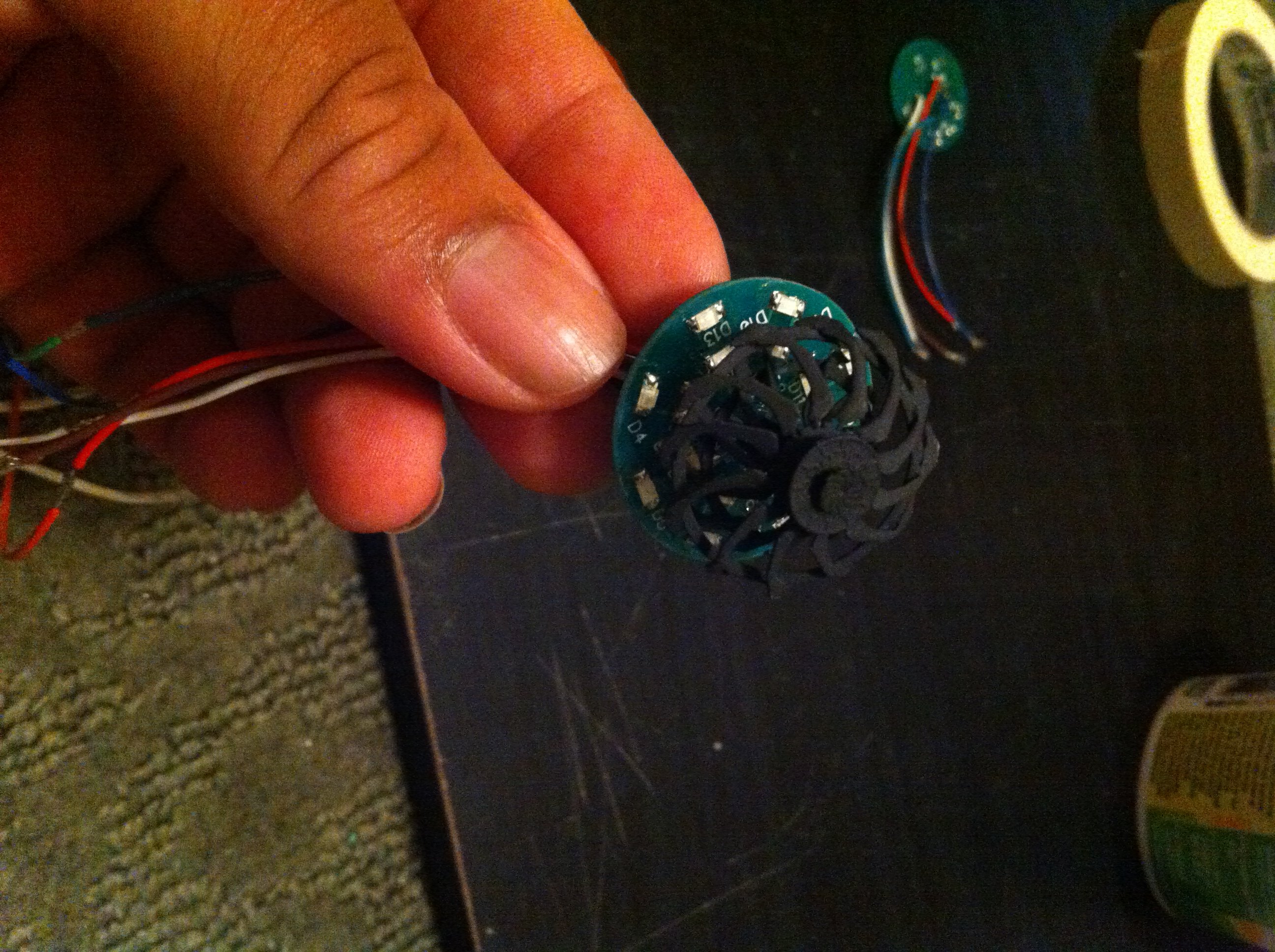

Next step I took was to finish applying the photoetch pieces, except for the impulse engine. Drilling the holes with a pin vise gives a really good effect on its own. I applied the field sensors to both sides of the secondary hull and around the deflector dish and I also finished the nacelle spinners, securing them to the spinner board with a low-temp glue.

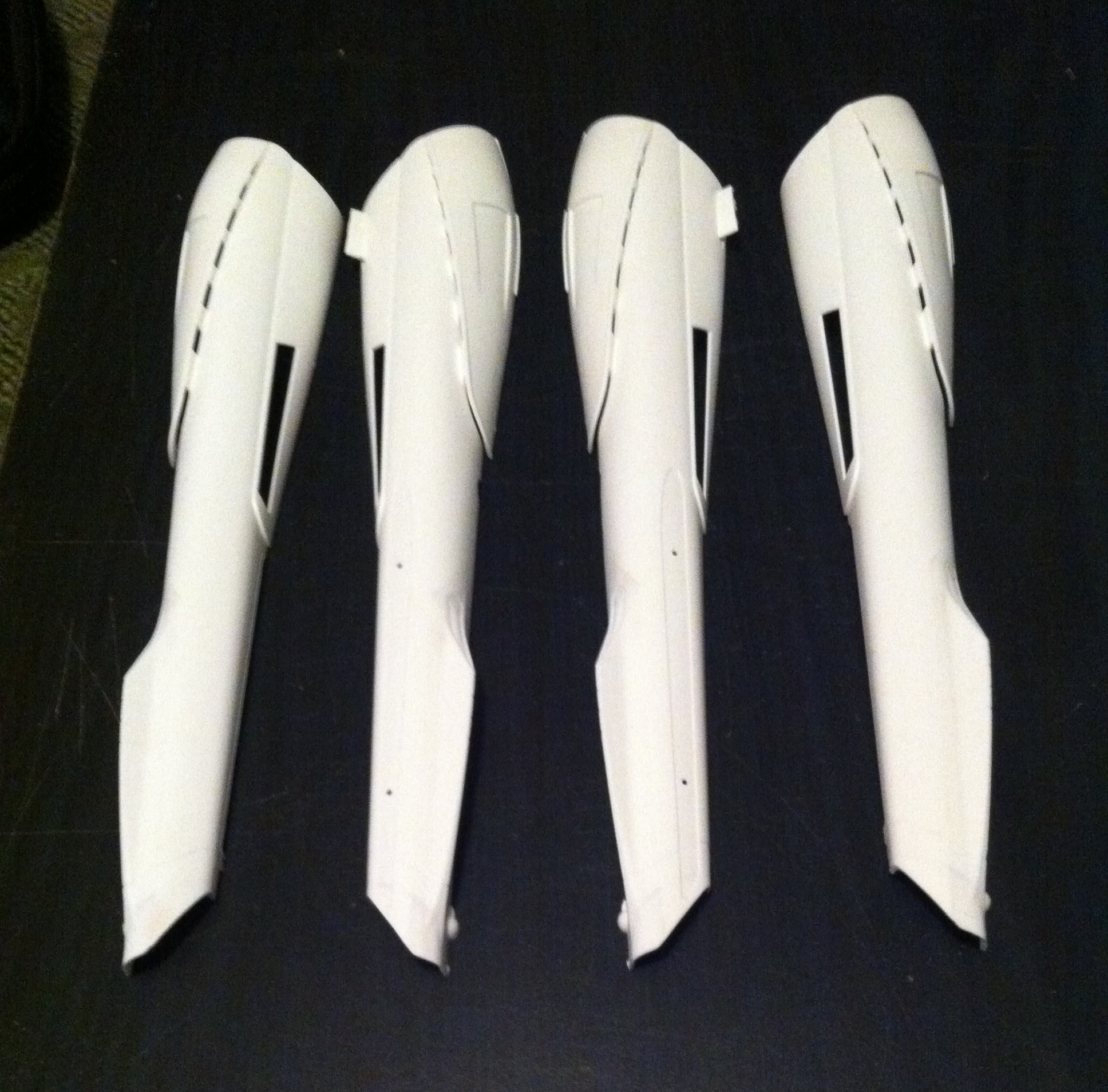

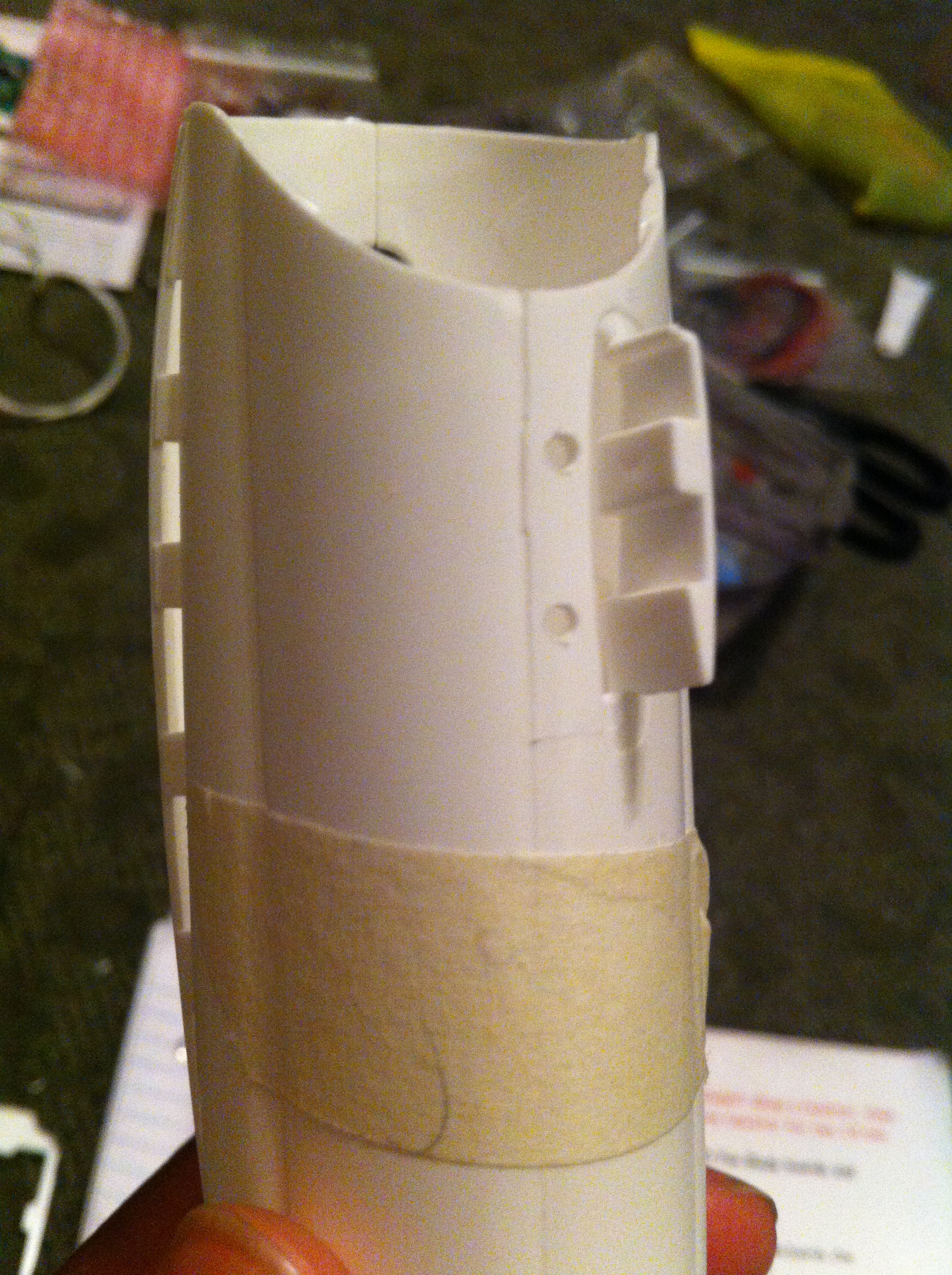

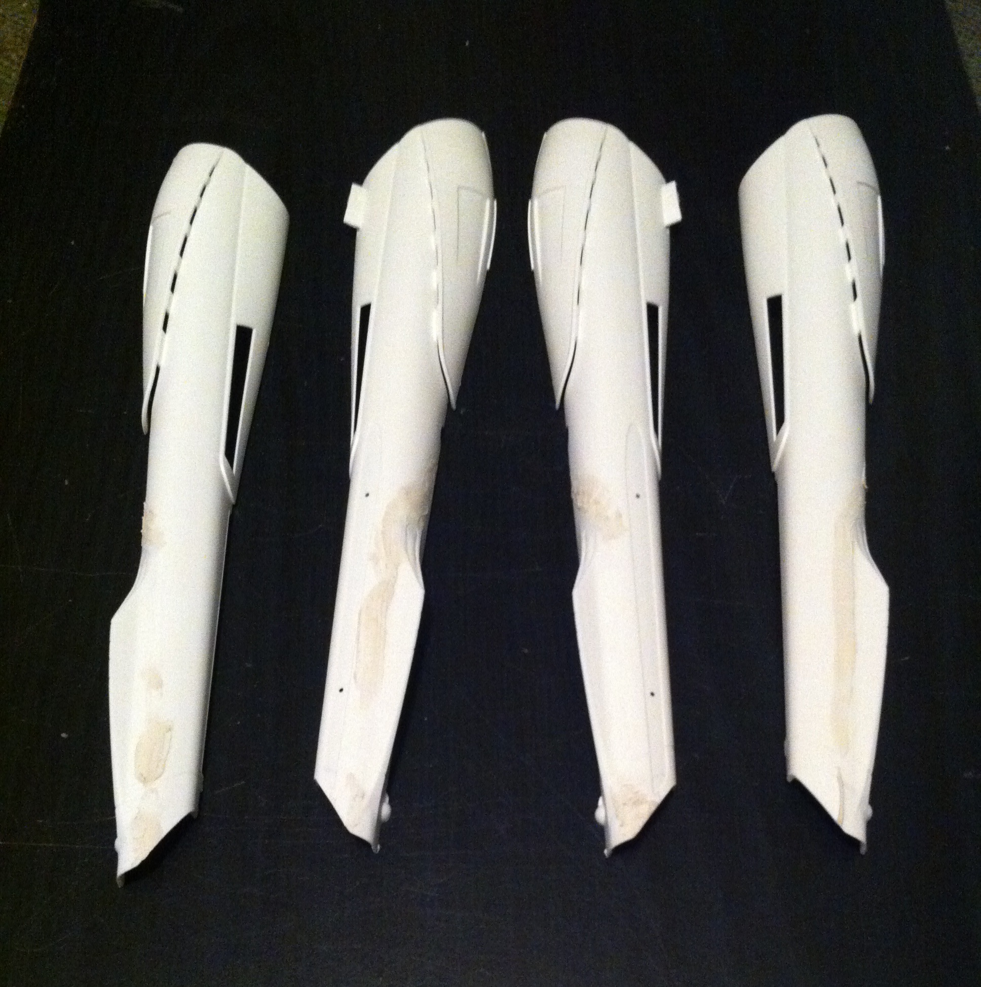

The first area of the ship I decided to work on are the warp nacelles. The board for the spinners were already wired so it was left up to me to figure out how I was going to arrange the lighting inside including the navs. My original intent was to included the navs at the very back tips of the warp nacelles(on the top and bottom) using the fiber optics that came with the kit, which I was able to achieve. But since this was my first time using them, I made some small errors installing them that caused me to scrap the idea all together because I had already sealed the nacelles. But before I get into the complicated details of that, I went about the business of assembling the nacelle pieces together, puttying and sanding some areas and drilling hole where the pylon floodlights would go.

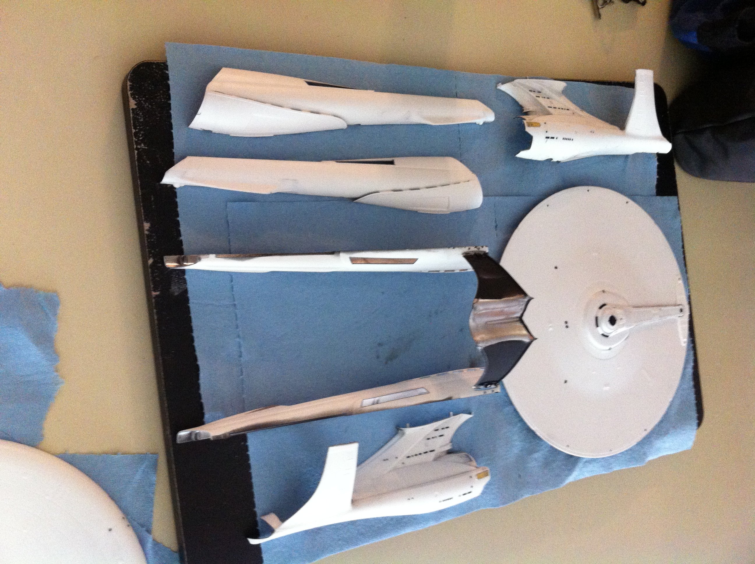

Then I glued the inboard nacelle half to the inner part of the pylons, which would allow me to just put the outboard nacelle half in place once the wiring was done. Afterwards, I started light blocking this and other parts of the ship using basic black spray paint as a base then using Rust-oleum bright coat metallic finish, which serves a dual purpose as a light block and helps bounce the light from the LEDs around the ship.
Also, I wanted to note that I only used CA glue to secure the nacelle half to the pylon. After allowing a few days for the glue to settle, I haven't had any trouble with nacelle droop, which tends to be a problem when assembling some Star Trek ships.

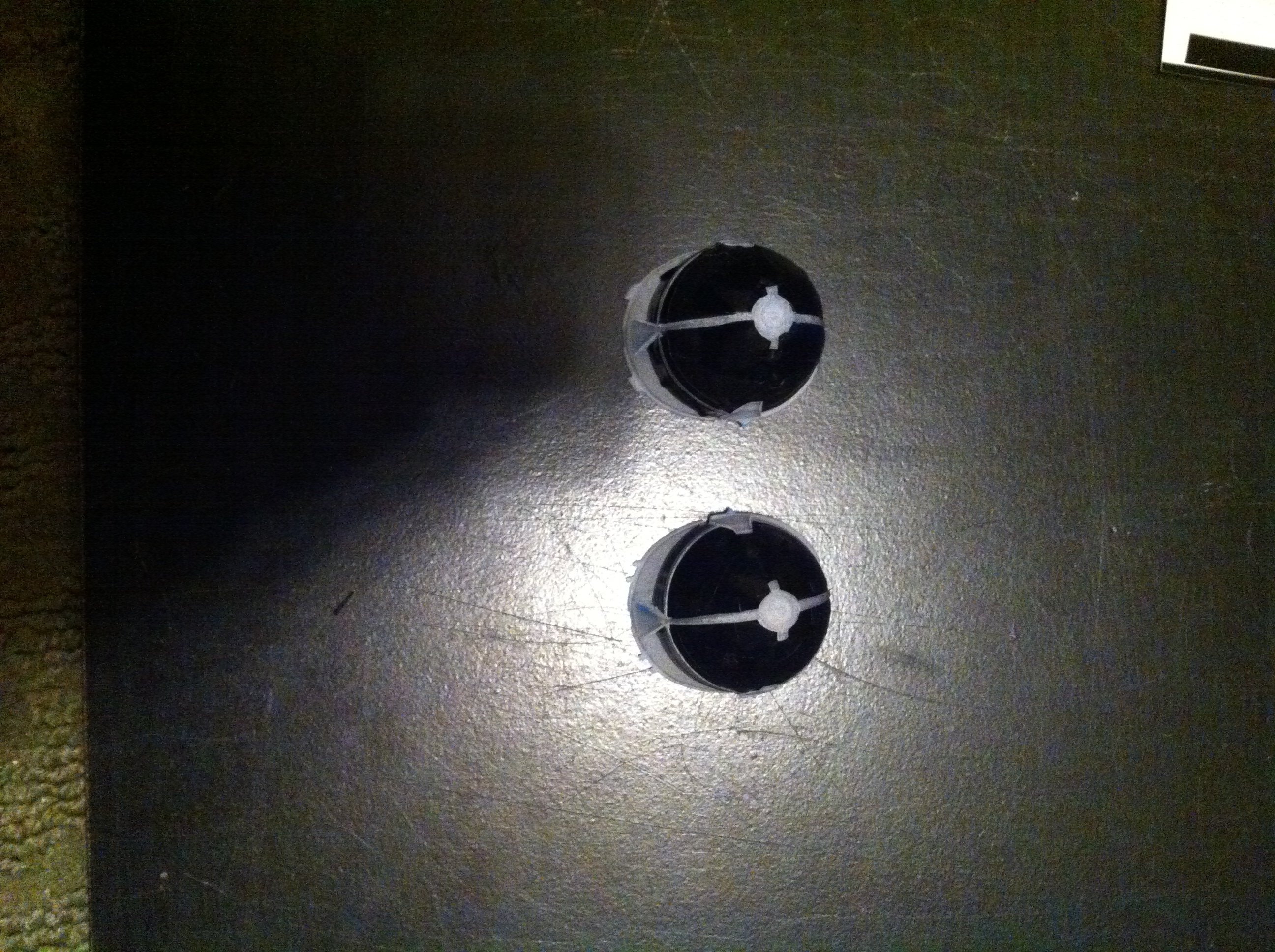

Next, I carved out a small opening between the brackets used to secure the nacelle to the pylons and allow wires to pass thru and created a third passageway, which allowed me to run the nacelle spinner, nav and constant lighting wiring thru the pylons to the rest of the ship. Then I frosted, masked and light blocked the bussard collectors. I used the Aztec Dummy set to mask off the clear parts. Afterwards, I secured the collectors to the nacelles with CA glue and after letting the glue settle, I installed the spinner board with the nacelles blades attached.
