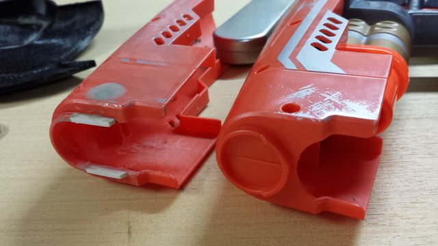

That'll come along on its own. More interesting might be the blasters. I started with a pair of the Nerf blasters, as many people have. I looked at 'em and considered how I wanted to handle it, since a simple repaint seemed like it wasn't enough. In my past experience at conventions, they frowned on working dart blasters, so right away I decided I could gut the guns and remove the firing mechanisms to buy a bit of space on the insides for me to play around with. To be more screen-accurate, the front and back sections of the outer shells of the gun should be connected, whereas the Nerf gun has a space in between with a bunch of plastic molded wiring detail. I will say I really liked the physicality of how the blasters opened up when you pulled the secondary trigger - the top and bottom guards on the gun fan out. This is a detail that never, ever happens during the movie, as far as I can tell, but it is really cool, and I liked the explanation in my head that maybe they would open up in such a fashion if they overheated from too much firing.
This was the first change - making it so that the tops and bottoms of the guns would be one piece, while still retaining the ability to open up. The concept:
An intact blaster, and the gutted pieces:
I've been cutting and shaping a plastic spacer to make the front and back orange sections into a single piece. I will be attaching them together shortly, then bondo'ing the whole thing and doing a lot of sanding to make sure they're strong and smooth.
I also cut the front end of the top barrel up so that I could extend a more screen-accurate tip out past the top guard. I'll probably model this tip up and 3d print it down the line.
Removing the actual nerf-dart firing pieces bought me a decent amount of space inside the guns, so I decided I wanted to add lights and sound to the blasters. The lights are simple enough - tuck some batteries in, and put an LED on a switch. The sound is a bit more complicated. The solution I've decided to go with are BigDawgs USB Multipush circuits.

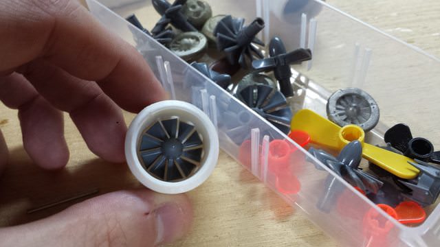

Last bit produced so far is the boot rockets, which are courtesy of @xMENNENx and the files that he generously released. I printed these on the Makerbot Replicator 2 at the architect's office. Still churning out a couple parts in my spare time, but these print quick and easy.
I had some lego turbines, and just on a lark I've started tucking them into the intake end of the rockets as an extra detail because, well, why not? I'm going to hopefully put some LEDs in the exhaust end of the boot rockets so I can light myself up for the sake of saying I did.
As far as the rest of the costume is concerned, I'm probably going to suck it up and buy the fjackets version of the Star Lord jacket, but in real leather so I can put it to dual use as a regular riding jacket for my motorcycle. The pants I haven't figured out a satisfactory solution for yet, but I might be looking for a seamstress to help me create 'em from scratch so they're close enough to screen accurate not to nag me.
