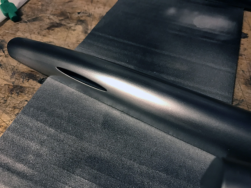

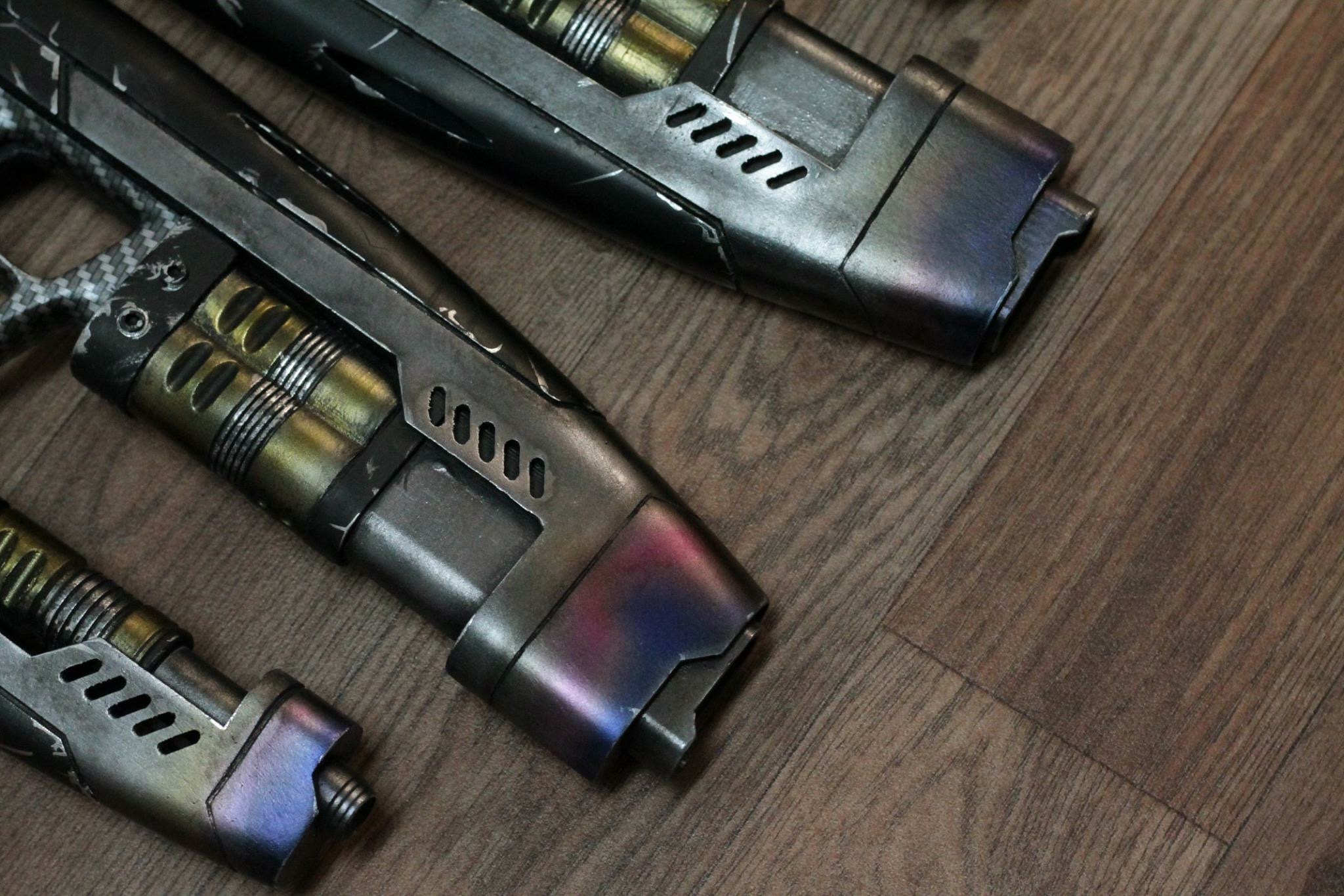

Protip for builders. If you plan to use an airbrush with a paint like Alclad II, you can get a nice aluminum-like surface if you rub down the gloss black basecoat with fine steel wool before spraying. The uneven surface, with very light scratches and patches of glossiness, will make Alclad "chrome" look more like brushed aluminum and less like "fake chrome".

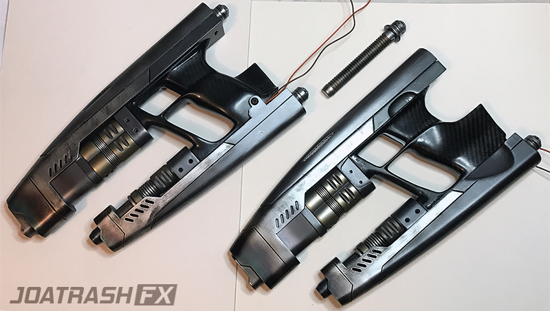

Also, here's an example of Alclad II Chrome applied with an airbrush over a lightly scratched/buffed surface. Sealed with a urethane-based 2-part automotive clear-cote (specifically, House of Kolor's UC35) that does NOT dull the sheen and is much more durable than rattle-can paint. (The photo is from the new set of Element Guns I am making for myself.)
that looks amazing! I wish I was half as talented.
Sent from my SAMSUNG-SM-G935A using Tapatalk
Thanks!

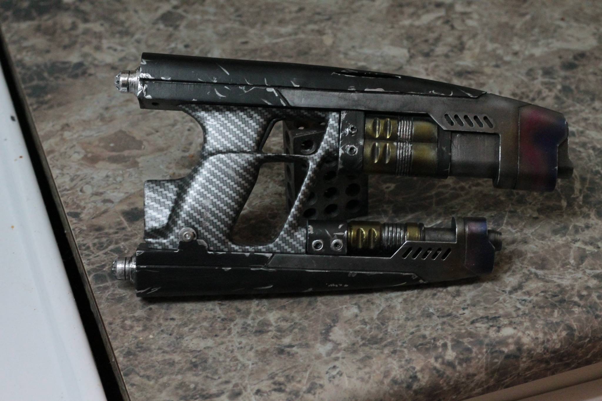

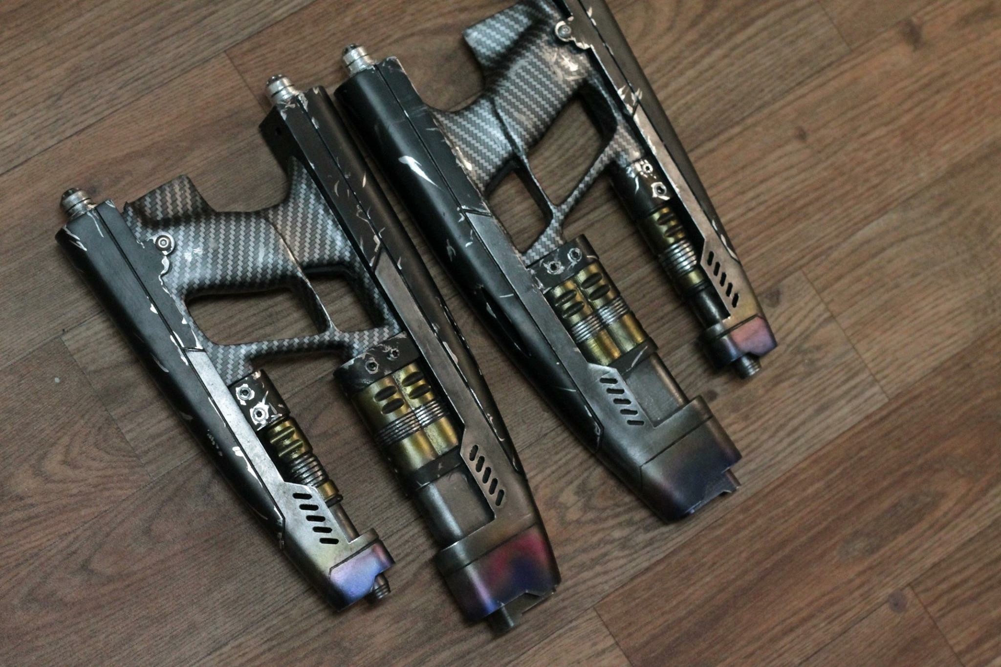

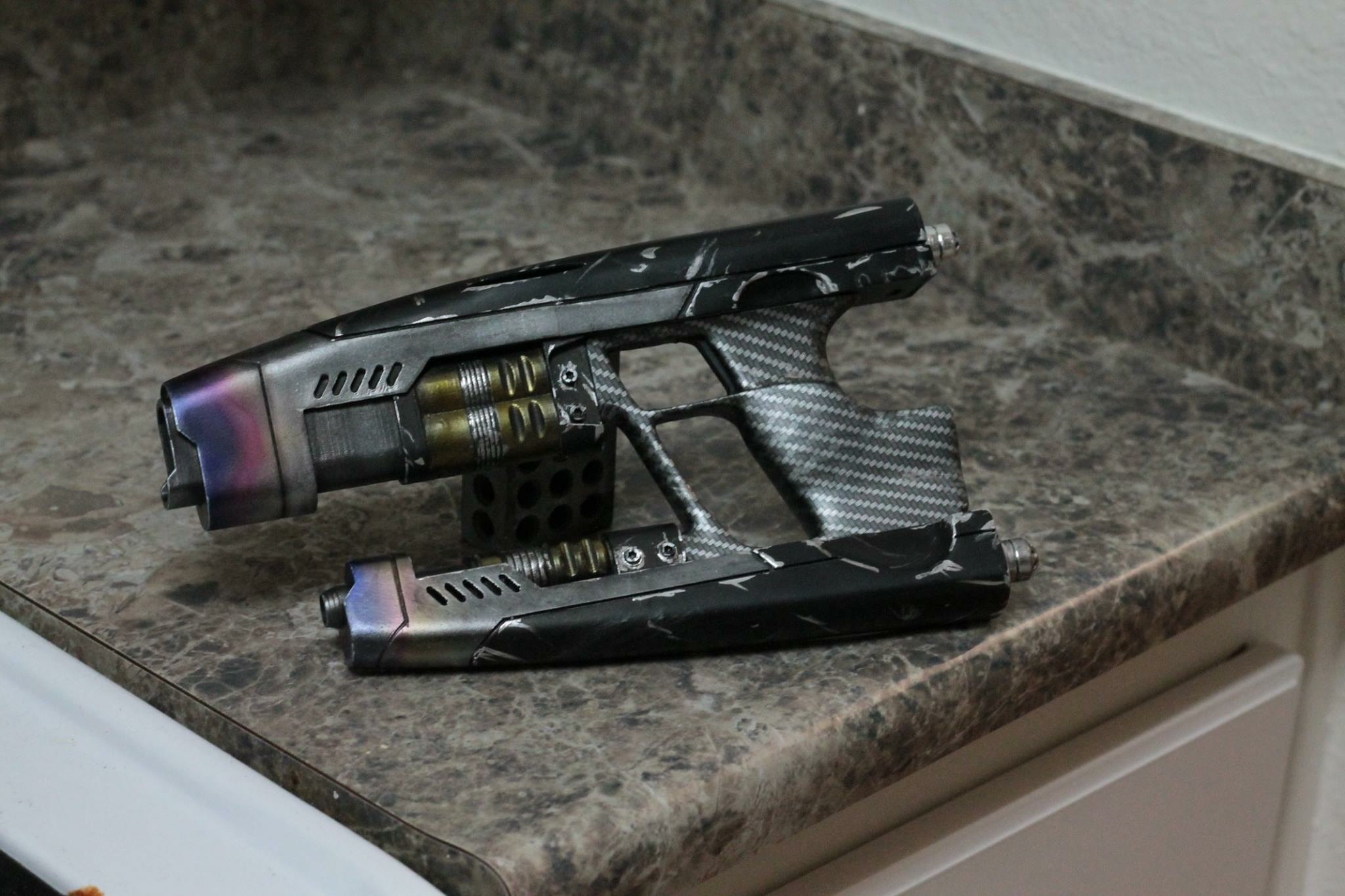

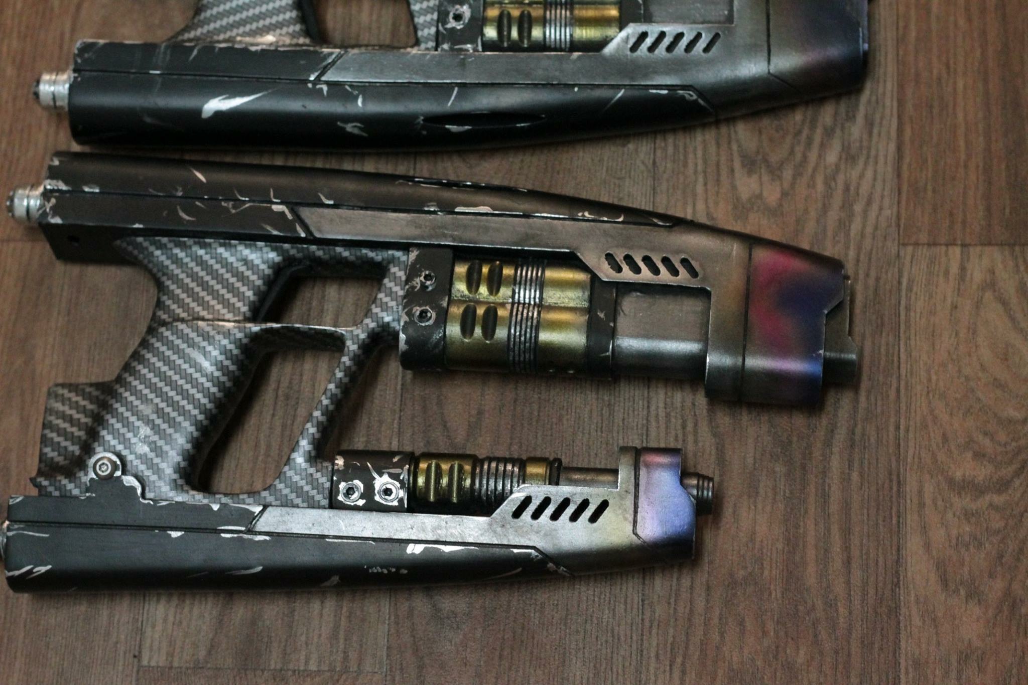

Finished up a pair of these a little while back. A bit exaggerated with the weathering but that's my style.. painted too many Star Wars props I guess. :lol
Great kit Joa. These were a blast... to finish. :)
Nicely done and thanks for the praise! Nothin' wrong with heavy weathering. Some of the original props that have been on display are pretty beaten up.
