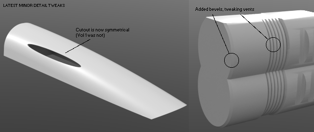

Hello all.

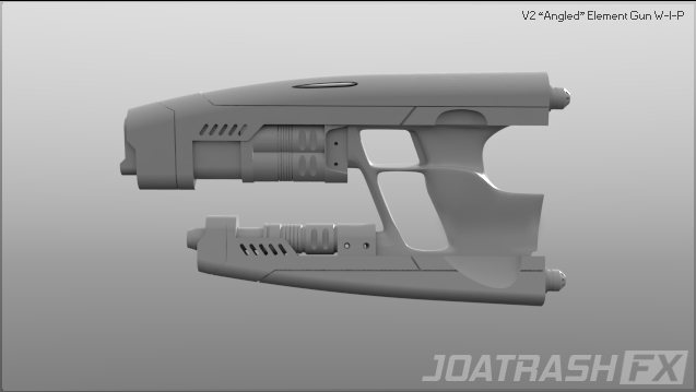

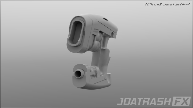

I've updated my Element Gun models to be accurate to the Vol 2 look. I can offer BOTH angled and straight versions, with or without side cutouts.
Changes include:
  • Cutout areas (or no cutouts optional)
  • Angled lower barrel (or flat version optional)
  • Slightly smaller size (the first ones were HUGE)
  • Muzzle alterations
  • Adjusted vent cutouts and barrel ridges
  • NEW FEATURE: Removable Power Cell/Battery in the upper barrel (twist-locks into place)
  • Slightly adjusted panel lines

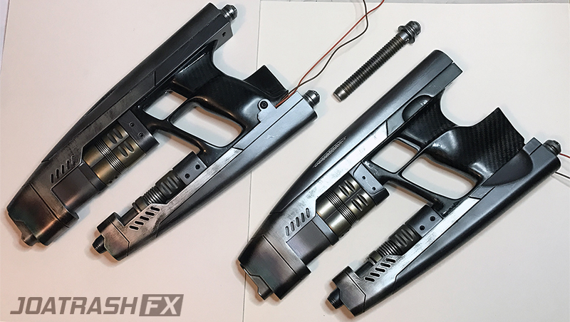

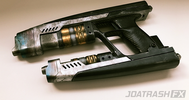

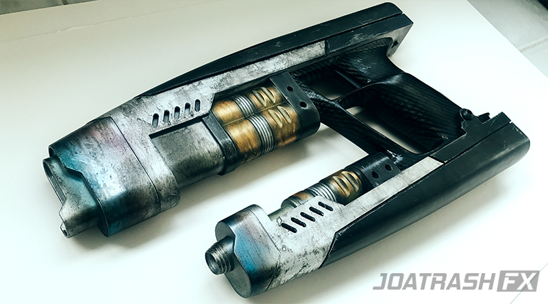

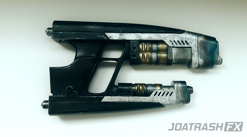

A set of (almost) finished guns of this kit:
Made for a static display which is why there are wires running out the sides of the grips, which were hydro-dipped. Alclad II paints were used for the bright metal, sealed with 2-part automotive clear before weathering. Gunmetal color is a mix of Vallejo's "Metalizer" range.

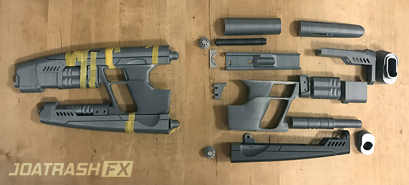

The "raw" angled kit glued/taped together and disassembled

Just to clarify some details: These will be a little smaller than the Vol 1, will have the wider muzzle, no emitter electrodes, bent grip and other details to conform to the Vol 2 "stunt action" version of the pistols. More renders will be up soon as I'm still tweaking a few things.

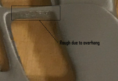

3D printed, correct? How is the print quality, can I see an up-close?

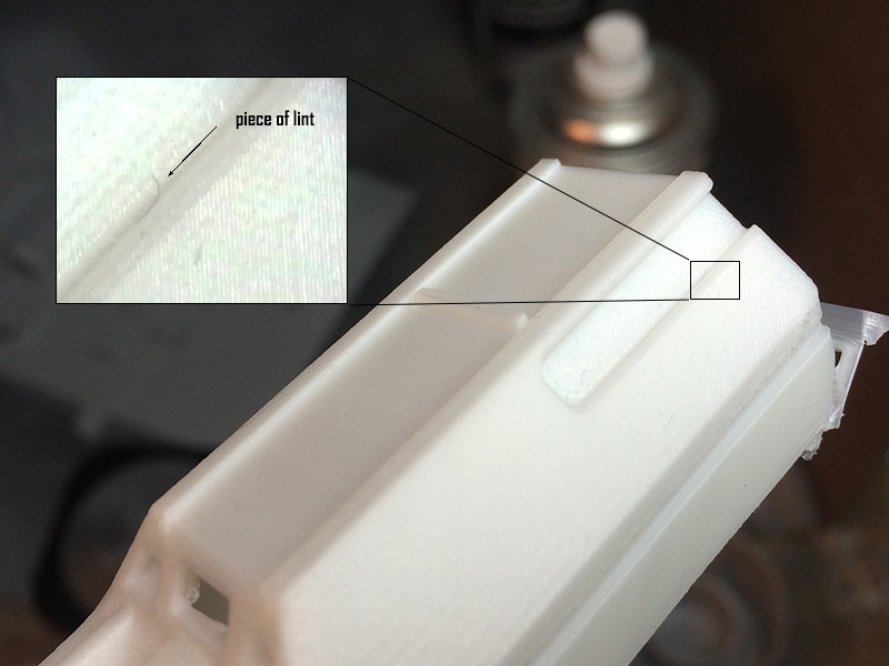

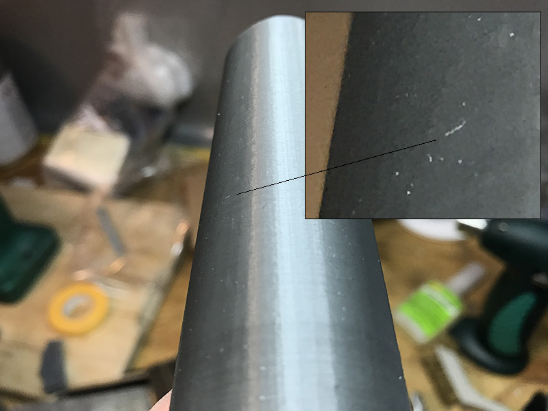

Sent from my SM-G935T using Tapatalk
It varies across the kit, depending on the part. A place with extreme overhang (like the underside of the trigger guards, see middle photo) will be rough and require more filler or higher grit sanding, since it's essentially printing in mid-air. Sometimes you have to accept a 95% perfect part with one area that needs fixing instead of a part that is consistently mediocre all around. Temperature variations also play a part and sometimes leave marks or dimples that need to be scraped off. But the photos below show typical smooth surfaces that make up most of any kit (lef and right) and one "worst case" area (middle photo). The one on the right was printed "standing"- if it had been printed lying down, the curve would have been full or "stepping". I am often told that my prints are among the cleanest folks have seen. You CAN sand them glass-smooth without using filler, because the PLA I use lends itself to sanding pretty well, but I always use spray filler-primer anyway because it does save time. (They can't compete with a high-end resin printer in smoothness or details, not even close, but they are more durable and don't cost nearly as much.)
