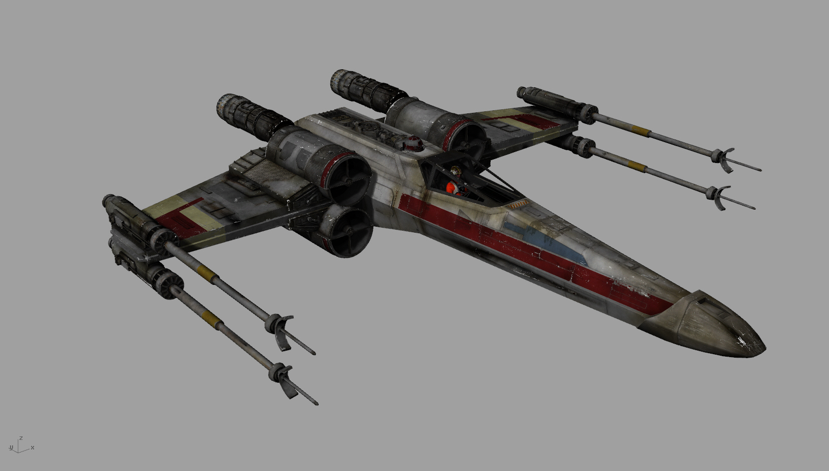

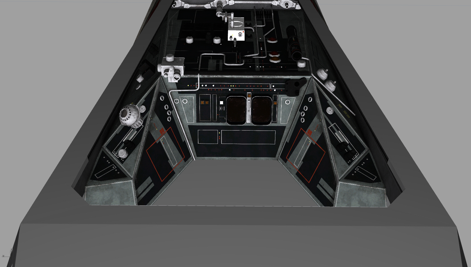

I also have x-wing model from Battlefront game with cockpit as seen in game. I do not consider myself expert, but I have studied x-wing cockpit and RED 2 x-wing for some time, so if you want to consult something I will gladly help.
View attachment 748661View attachment 748662
Where do you find these 3D designs from Battlefront?
I have them for some time now, I do not remember exact web adress. I found them accidentaly on some game mod development forum. If I find the link I will let you know

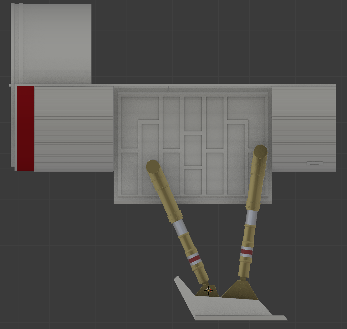

Main landing gear, showing the materials (from what I can tell, the main struts are entirely a metallic golden color, with shinier silver metal on the shocks, and on either side of the red bands. The gold extends to the mounts on the skid itself). Also a look at the details on the inside of the gear doors (texture with Normal Map, AO, etc.).
Now, here's where I'm stumped. I've modeled the gear as accurately as I can tell from the screens I have available. If there's better ones I don't know of them. The problem is: HOW do I make these retract into the wells in such a way as I can keep the design as accurate as possible to what we see on the films, while still accounting for the mechanics of the gear themselves?
As far as I can tell the fore and aft struts are the same, at least from what's visible in my screens. They're arranged in tandem with no left/right offset.
I'd considered some sort of mechanism that pulls the rear strut aft into the space behind the gear bay, with the engine components fitted around it, but that still leave what to do with the forward strut. Perhaps some sort of hinged joint in the upper part of the bay that pushes the top of the forward strut aft? The problem is that the rear strut would have to retract much too far aft for the front of the skid to clear the forward wall of the bay. Although looking at my model, I may have made the skids slightly too long and tall, so adjusting that should help somewhat.
Any thoughts?

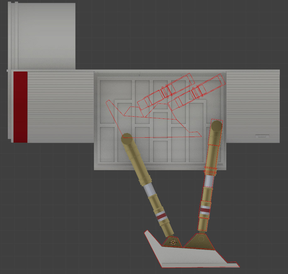

Some puling mechanism as you wrote and I would make some parts of the struts telescopic, where their design alows it.
Yeah, I'm already planning for the shocks to allow the gear to telescope a little. Another problem is making sure the struts are able to clear each other without clipping.
That could work. It then shifts the question to what's actually anchoring the struts themselves. As I'm sure you've noticed, the struts I've used so far don't extend all the way up into the bay.
After considering a number of options, I think perhaps the best solution would be one of the following:
1) Offset the struts, so that the forward strut is to the inside or outside of the main strut, rather than directly in front. This will allow it to clear the rear strut when retracting without excessive use of telescoping.
2) Suck it up, and put joints at some point(s) in the landing gear struts (particularly the upper portion) so they can scissor when extending and retracting. I think i can do this without significantly altering the visual appearance.
It may even require some combination of the two.
Here we go, I can use something like this:
To hinge the struts in such a way that they can fold to retract, yet without disrupting the shape of the struts when extended.
By Jove, I think I've got it.

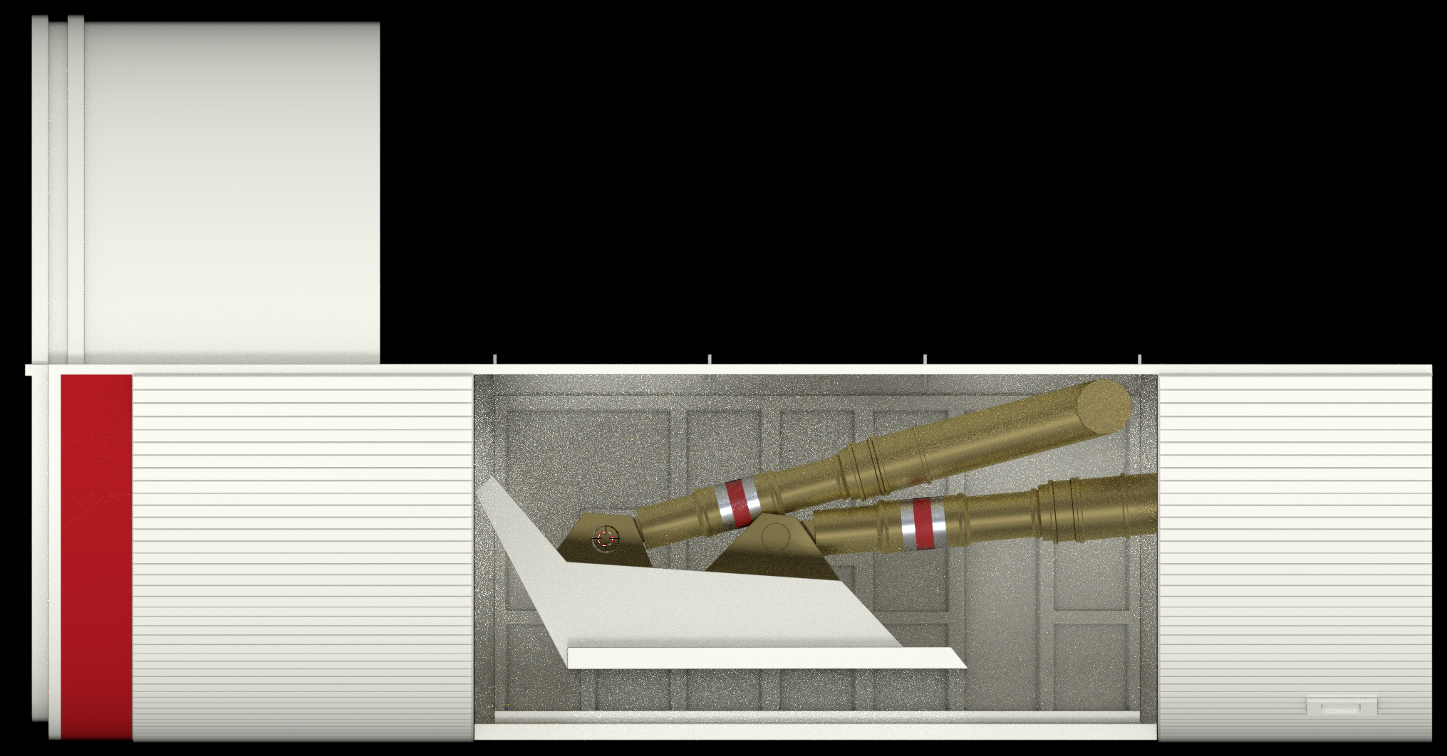

Tweaked the skid a bit more to fit the references, and slightly scaled down the front strut. There's also two telescoping points: The shock absorber itself is able to telescope completely for storage, and the upper half of the oleo is two telescoping pieces (I'm model some locking mechanisms). I was even able to fit it without having to offset the forward strut.
Now I just need to model the actuators that move the struts aft when retracting the gear, as well as create and rig the armature, and set the poses. I'll also have to figure out how to plumb the engine around it, but that will be relatively simple by comparison.
I think for the gear positions, there will be:
Retracted: Gear in their "stowed" state.
Extender: Gear in their fully "extended" state. This would be for when the ship's gear are out, but the ship is airborne (so the shocks aren't compressed)
Landed: Gear are extended, with the shocks slightly compressed by the weight of the ship.
Compressed: Gear are extended, with the shocks fully compressed by the weight of the ship settling as it lands.
