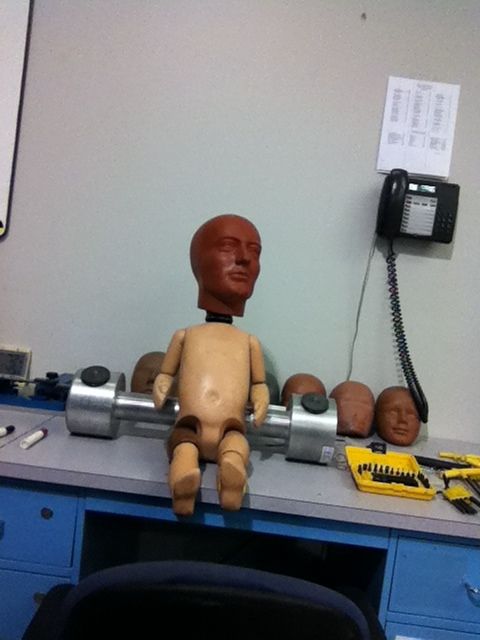

Got the cutter going and did a quick test cutting some parts for a PT-109. also molded some patterns for the Betty. and had a mini cone made for a future small betty. will cast the betty parts tomorrow. and a few pics from work, its been a crazy week.

eh up buddy i think you have been workin to hard,i was gonna to say you`ve been workin ya fingers to the bone,but i`m a little worried,i think you`ve not been eatin i can see ya ribs mym8........:lolpeza
Got a few parts made. and doing some design planning for the main engine and cockpit. sorry camera phone pics. was cleaning the shop while casting.
Heres a few pics.
Thanks for looking. feel free to comment.
