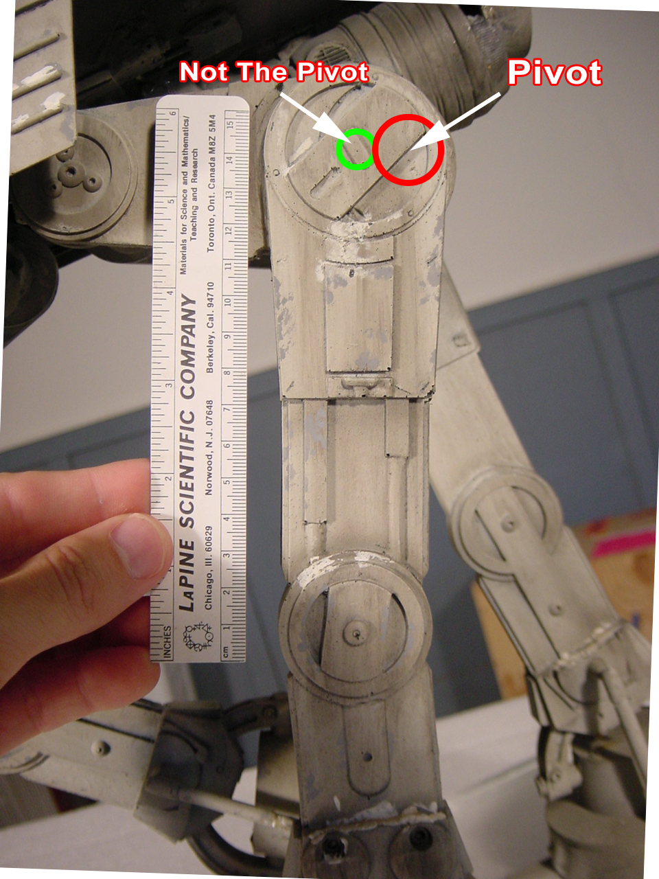

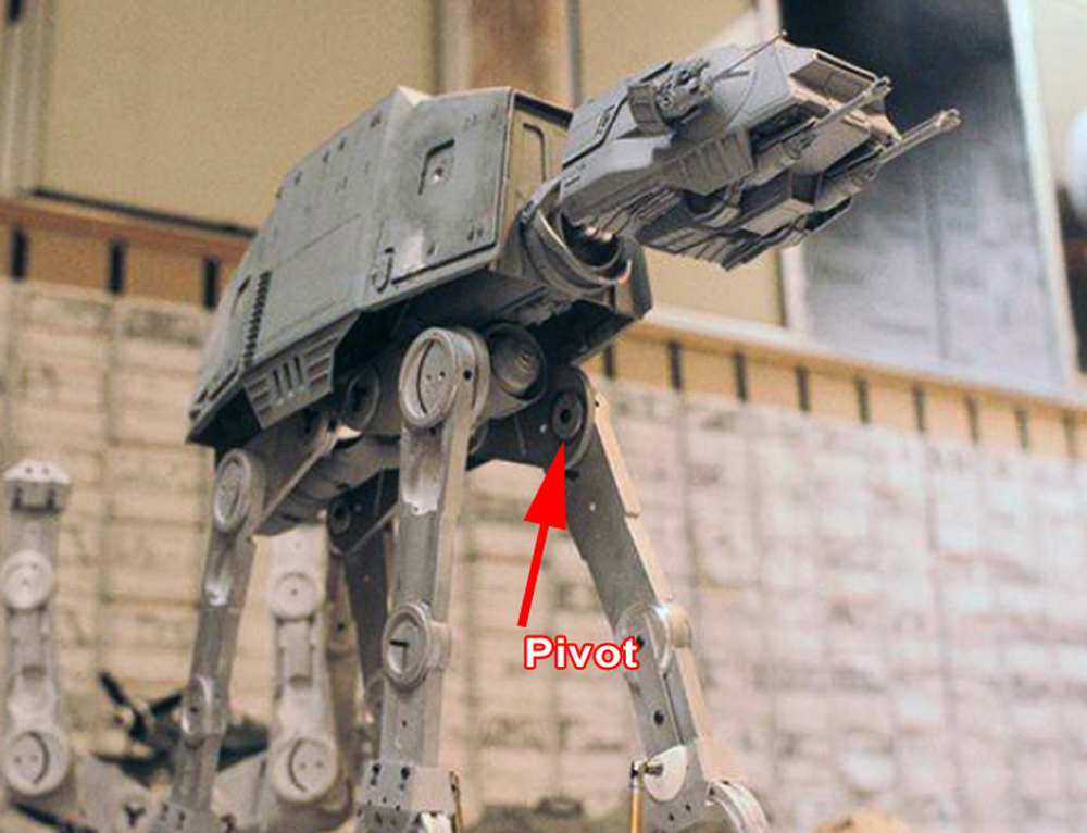

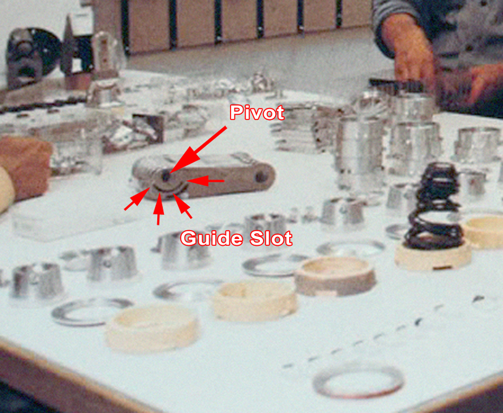

I've been really looking at the construction of the AT-AT, specifically the top leg joints, and I figured that the legs don't pivot in the center of that joint. The pivot is shifted forward or back as with the rear legs. ILM's photo displaying the armature parts, shows the upper leg parts to have an off centered hole at the top joint.
I've also noticed a 'pin' that extends outwards from the hip plate, thru a guide slot of the top leg joint. I'm guessing this pin assists in key-framing and/or providing a means to rotate the fly wheel. There's a lever that is next to the upper leg that appears to slide along that angled slot on the hip plate. Could that be a last minute thought for a 'tension lock' for the armature?
And one last thing, the round indent, below the top joint, appears to have a spindle and some rubber bands sticking out. A possible pulley system for the knee joint fly wheel?

Hey Wayne, I can see you've put a lot of thought into this, and for the most part you're on the money. I've been studying this for a while too, we'll hopefully have a working prototype leg in Julien's build thread soon incorporating all the known concepts. There are some issues with the original design, you can see that sometimes the pistons didn't move at all, got stuck, or in one case one of the round rods the square ones telescope over got sucked up inside the cavity. I've figured out a way to get quite a bit more vertical travel in the pistons than my first drawings so I'm hoping it'll achieve something maybe even a bit more consistent than ILM's design.
The lever/armature lock is put there for looks mostly, just to give some added movement/interest to the legs. But yes the mount for the upper thigh is off center, the "pin" you speak of is a slotted machine screw.
