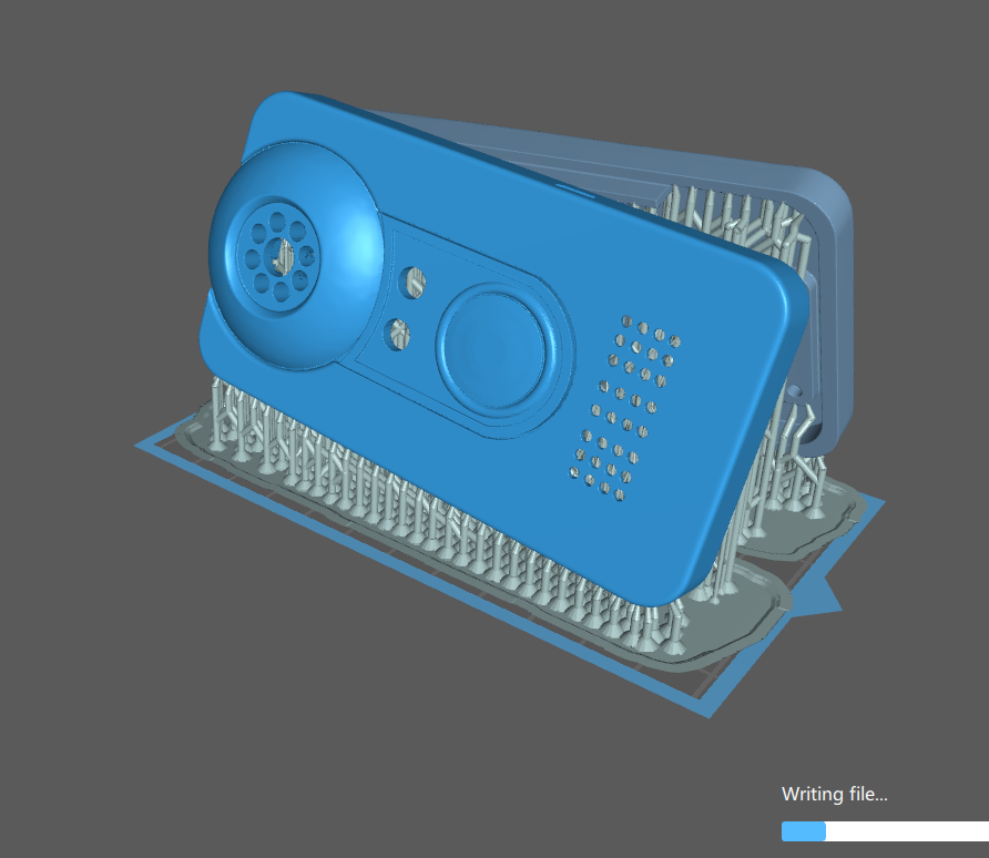

So, spent a few days trying to figure out what body-cam the Squid Games Soldiers used. Realized it didn't *quite* line up with anything out there that I could find in S. Korea marketplaces or US/International, and that this would mean fabricating.
Used a screen grab to get the proportions and details, and designed it- then used a stock photo of the harness- and sized it to a model of the clip that's on the front. Internal component carriers for a Raspberry Pi Zero-W, Pi-Cam2.1, adafruit 400mAh li-ion battery and charger, including port for charging it once assembled. LED cutouts go clean through the case- as do the speaker holes, though I'm only planning on wiring the yellow LED's.
Now, I think - it's about time to print :)
Figure I'll do print in FDM first to check sizing, then print it on the Saturn for detail.
No plans to release the STL set yet- debating doing kits.
Bah. Heck with it- lets see if it fits using resin first.
Will fit on the Mars2 Pro by the skin of it's teeth- so, don't have to wait for the saturn to finish first :)

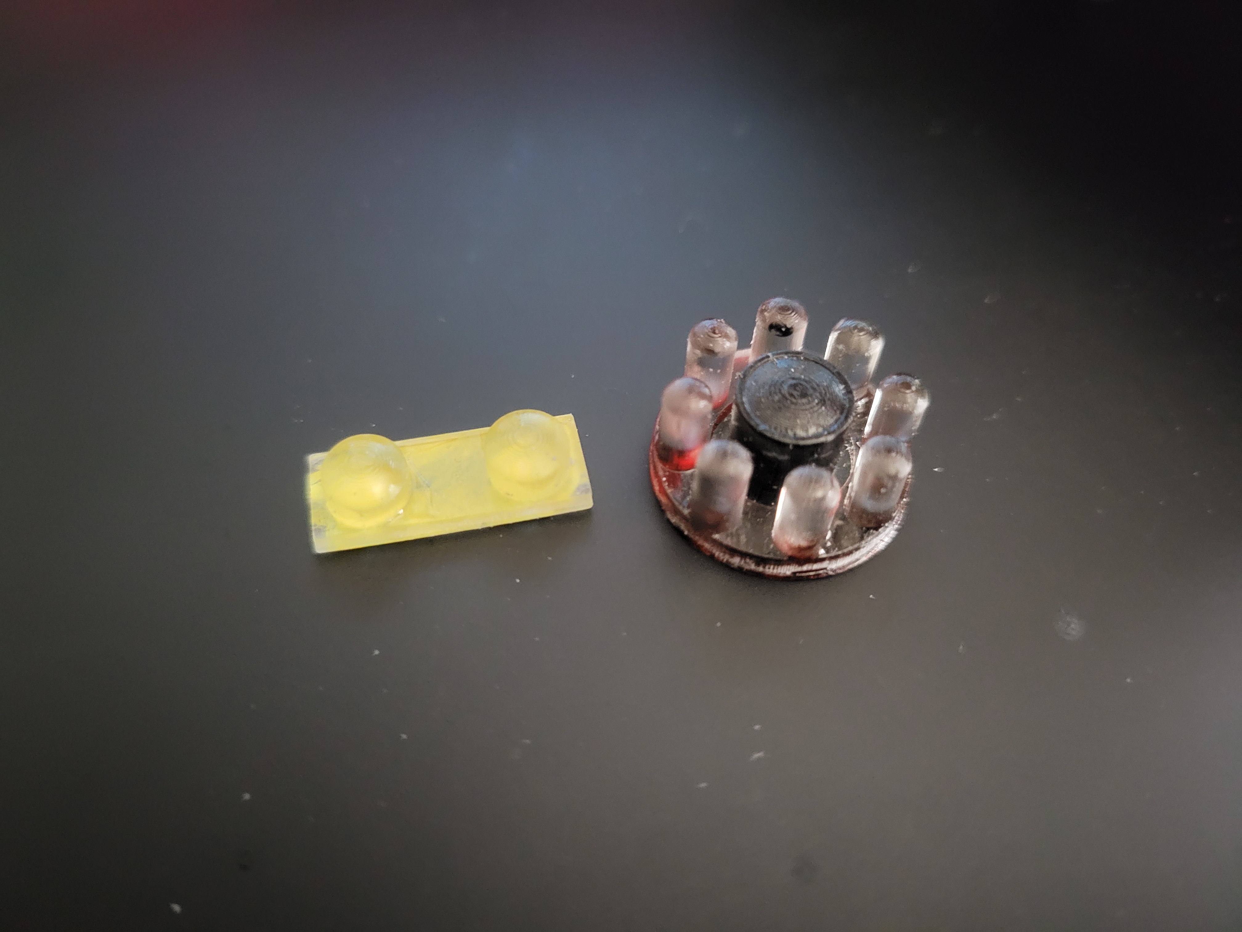

To make the black/clear labels you can laser-cut acrylic, mask off the backside for the clear areas and then used black spray paint on the rest.

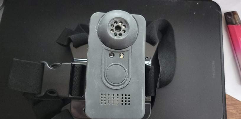

Test print of the camera body are a success. Just have to print a flush mount for the chest carrier. No post/ cleanup work done yet.

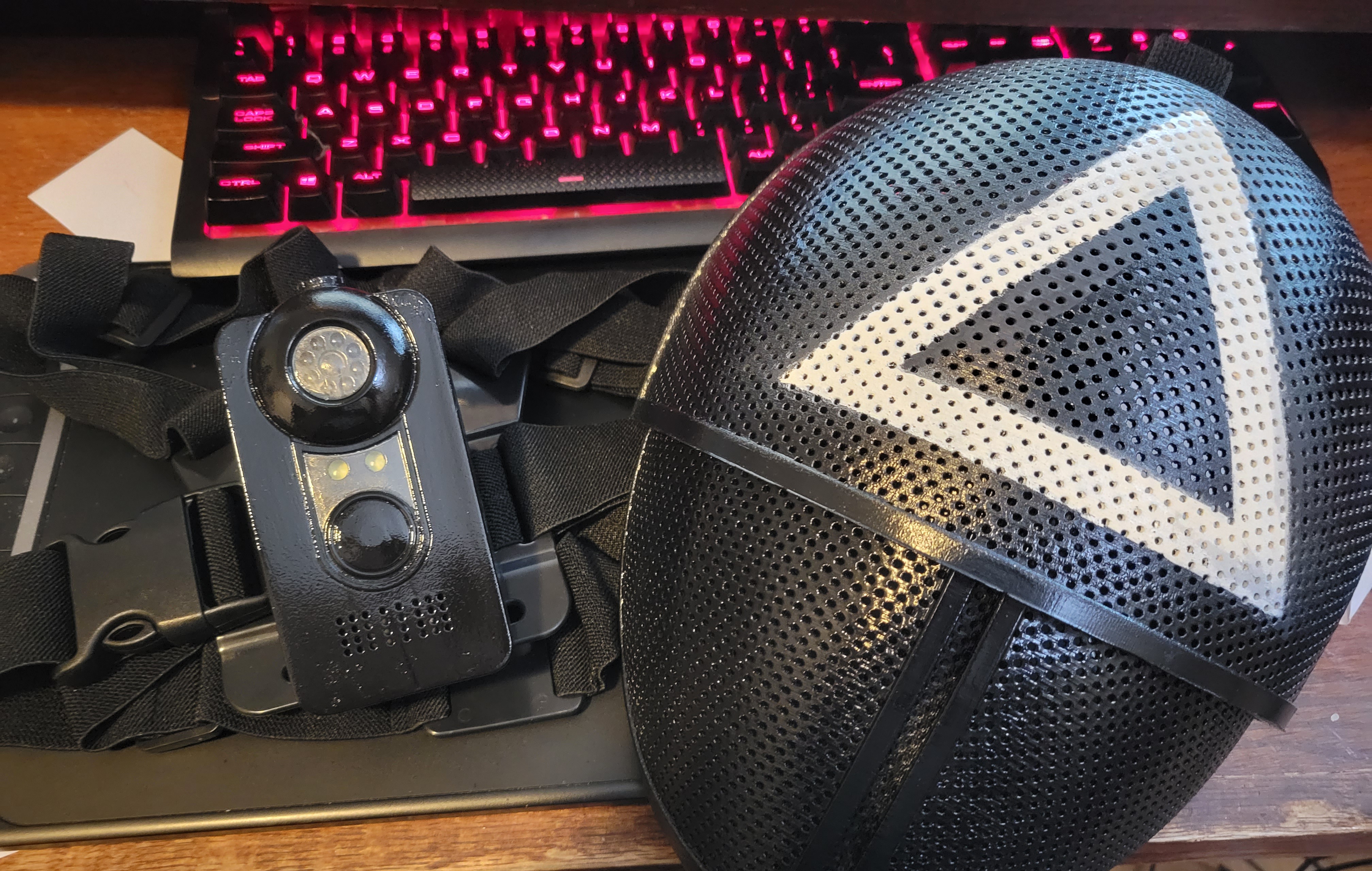

Hi, just discovered your amazing job. I’m making my costume right now. Can i comission one for me ? Thanks for your help. Wanna be ready for season 3
Hey. I know it’s been years but I personally think it’s an old intercom with a camera.
But dude could you PLEASE share the STL files for this camera. Because it’s an absolute work of are and I’d love to print it and have it on my cosplay!!
