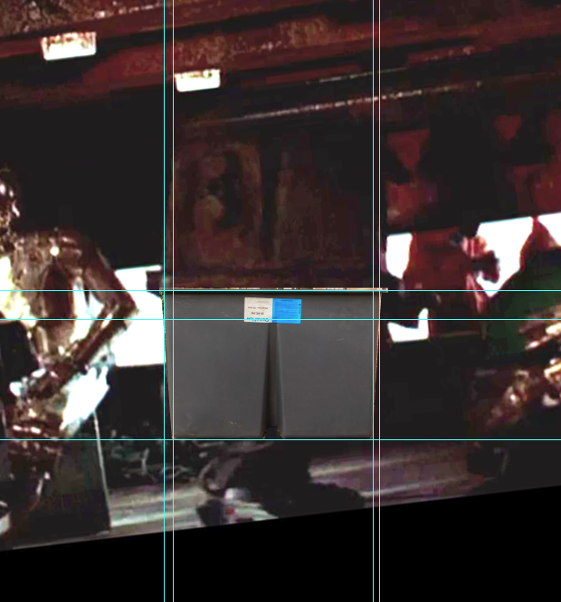

I'm going to photoshop pics of these tanks over screenshots to see how well they match up.
It's possible that the tanks available in the mid 70s had slightly different dimensions.
But to my eyes these new tanks look spot on.
OSMA 25 vs. GONK
The 25 gallon OSMA cold water tank lines up great, though I had to take out the perspective on the photo for it to match up just right (and how much perspective to take out can be a bit of a guessing game so I could be fooling myself).
If we could get a straight on photo of an OSMA tank from far away - with no skew or perspective - we could make a better judgment. Basically it comes down to how sloped the sides of the tank are and the size of the top compared to the size of the bottom.
The guide lines are the dimensions and side channel height of the original screenshot box.
If anything the side channels on the original gonk seem to be a bit thicker and chunkier?
But in any case - wow!

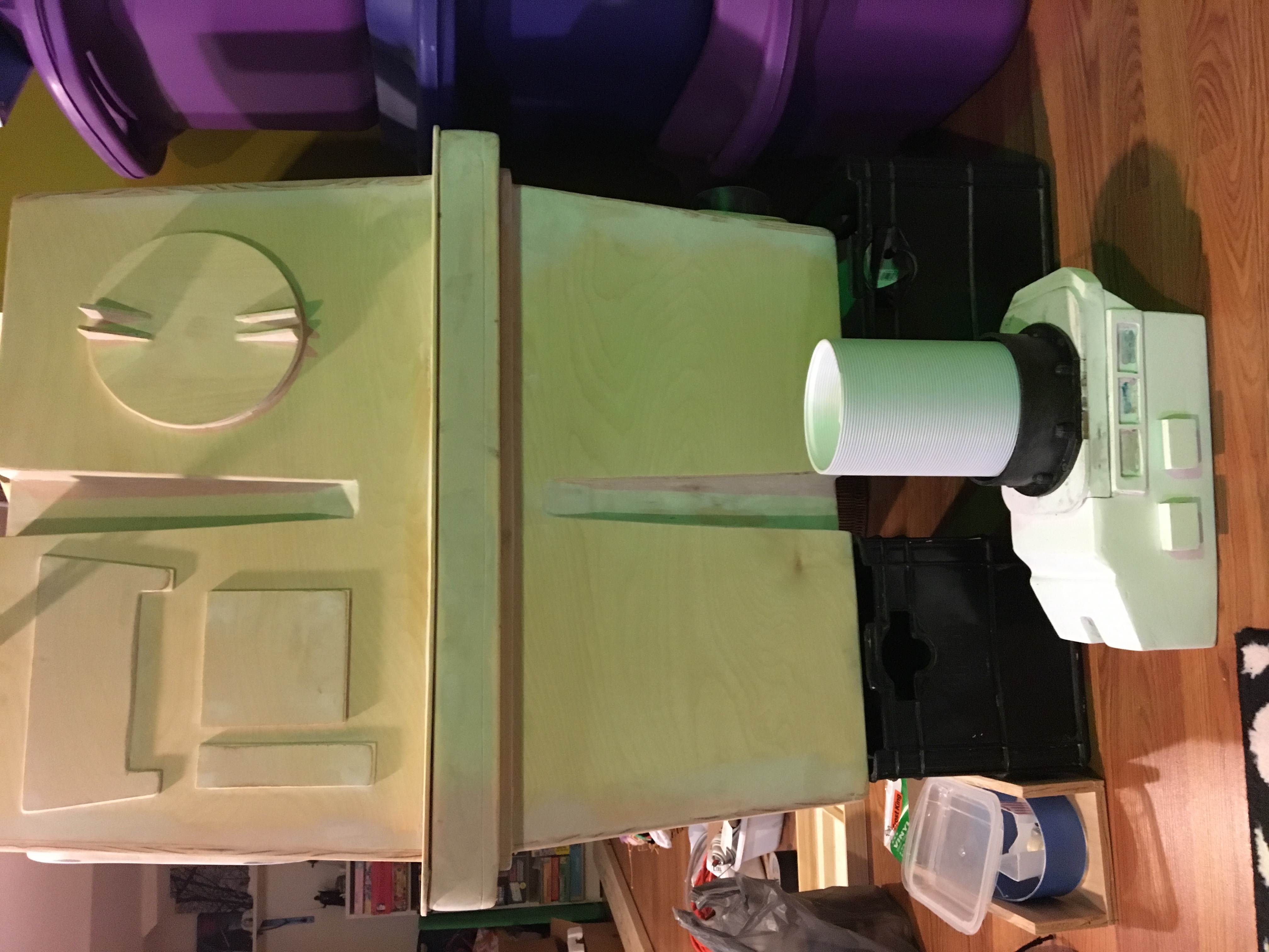

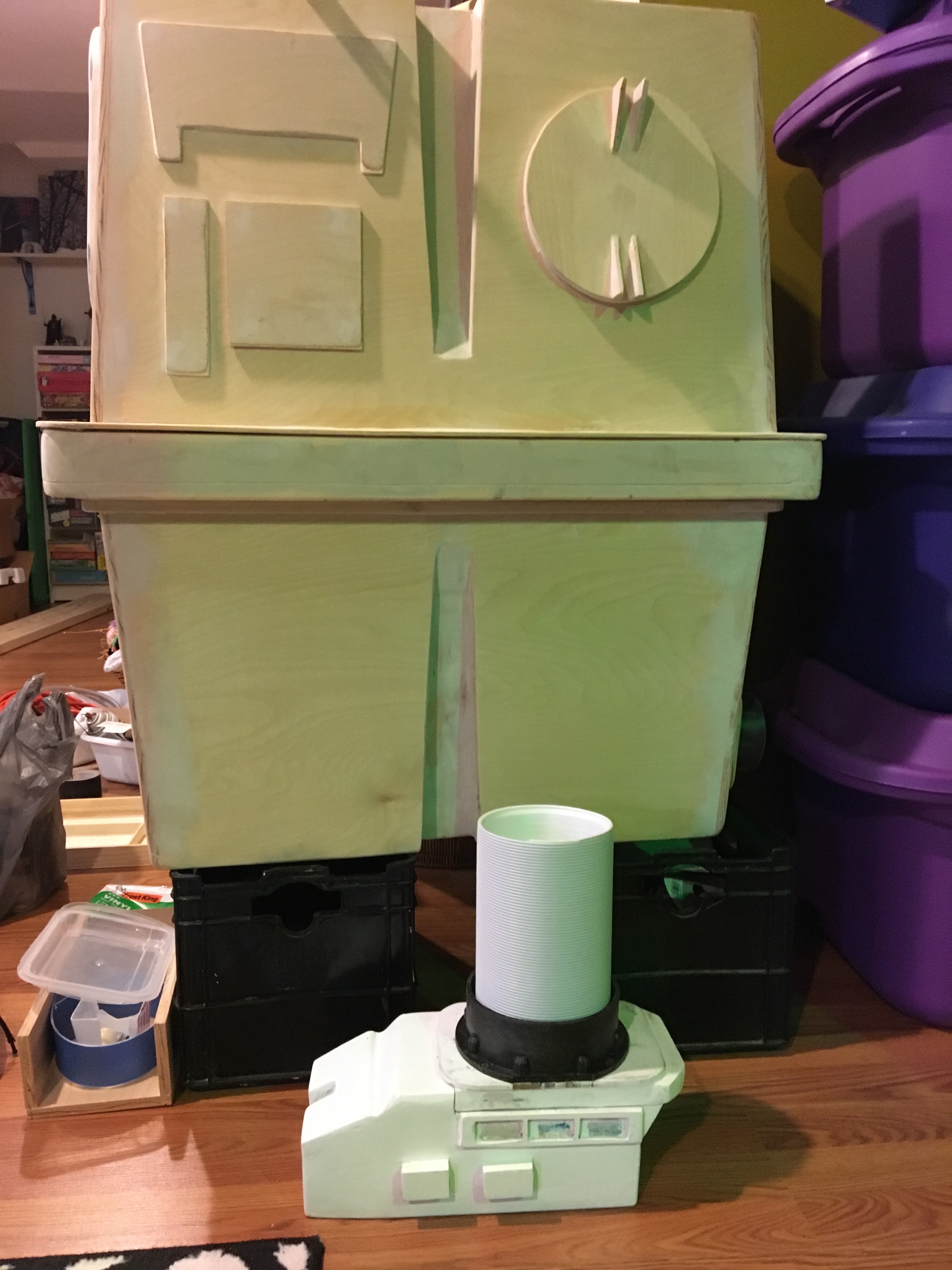

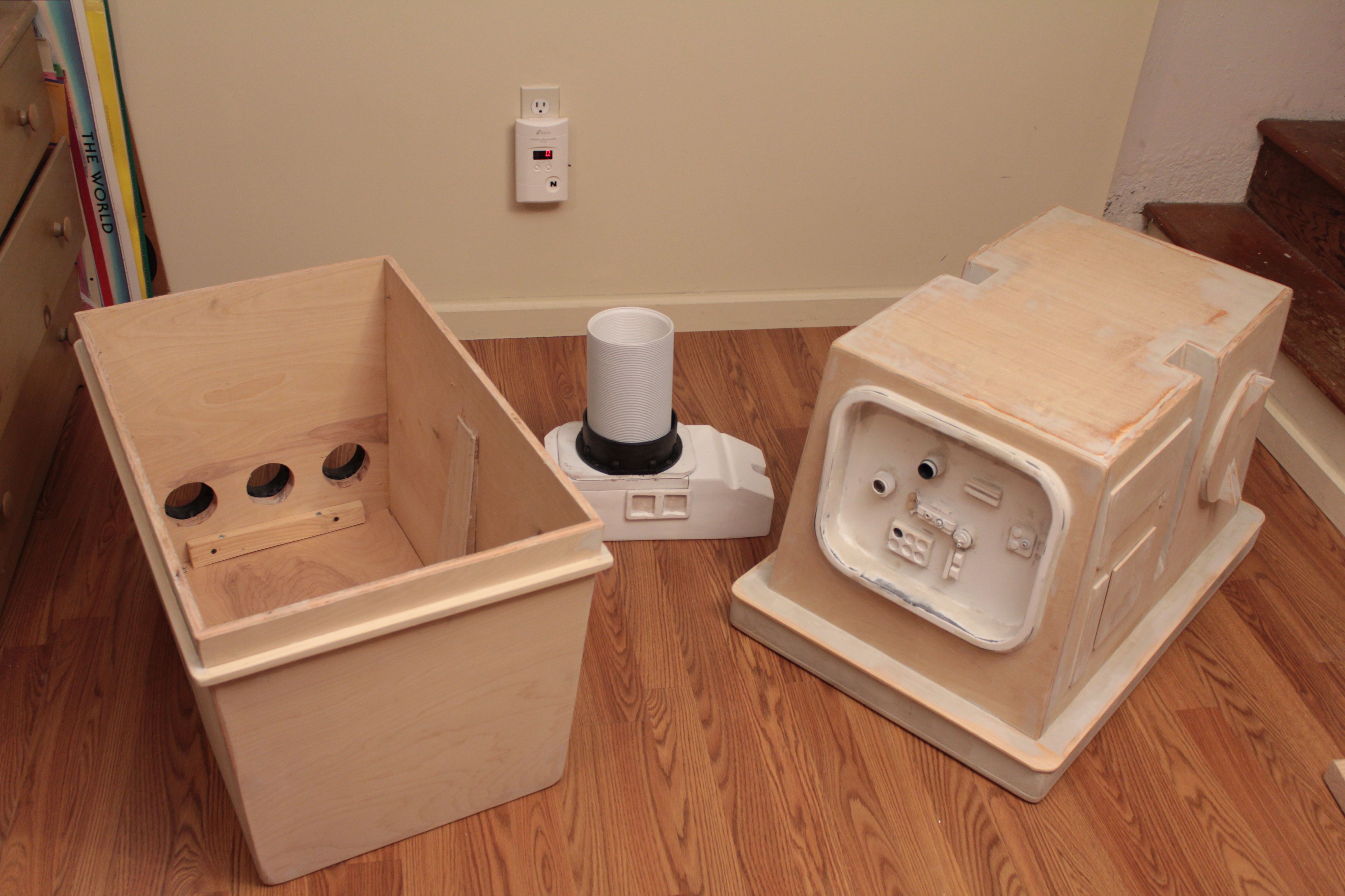

So that's it, after all this time. And here I've been wrestling with saws and bondo for the last 6 weeks. Feel like I'm close to the Osmaflow tank thanks to Spacebob's dimensions.

That's looking so good @ChrisN I think that's the most screen accurate sandcrawler gnk in existence :)

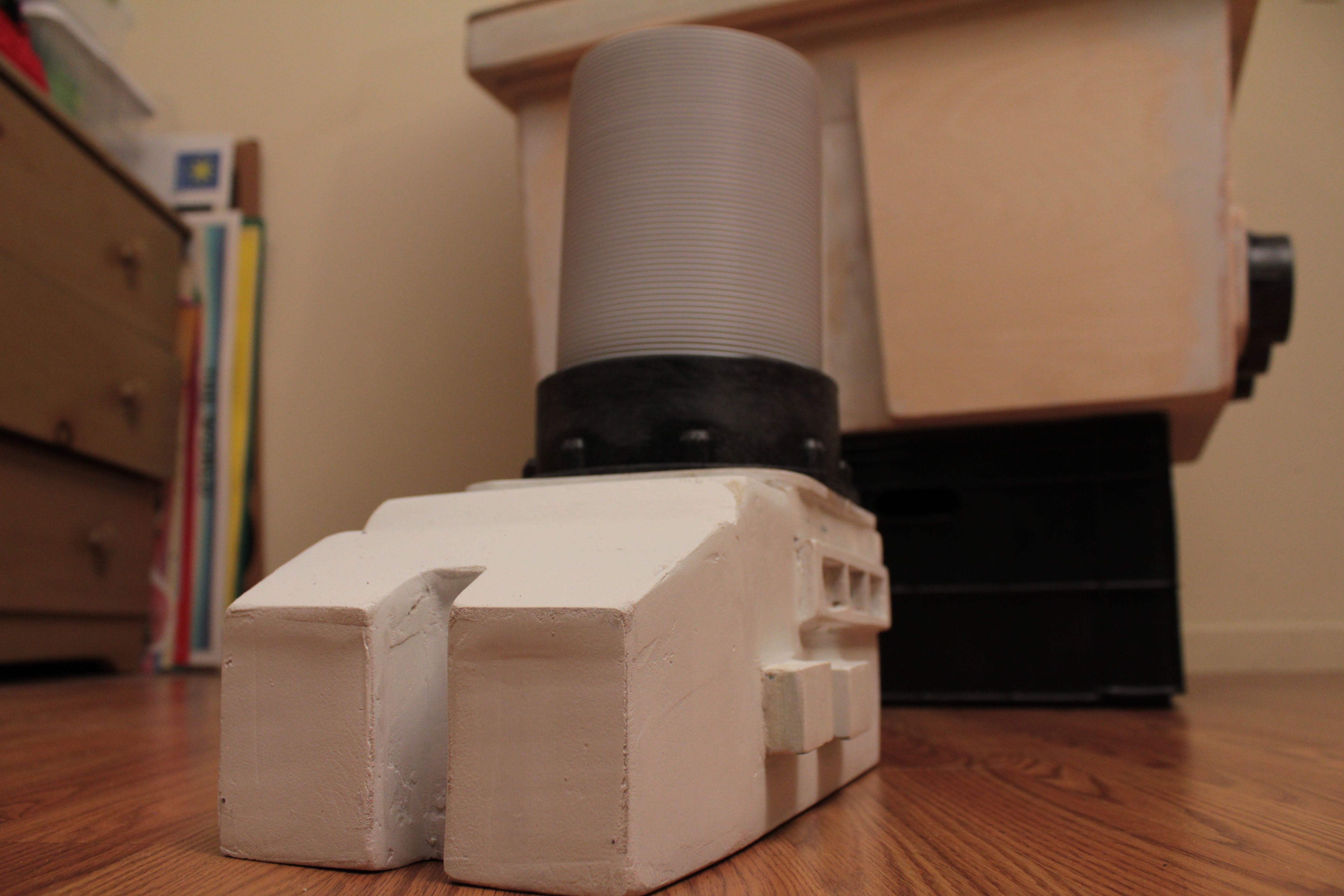

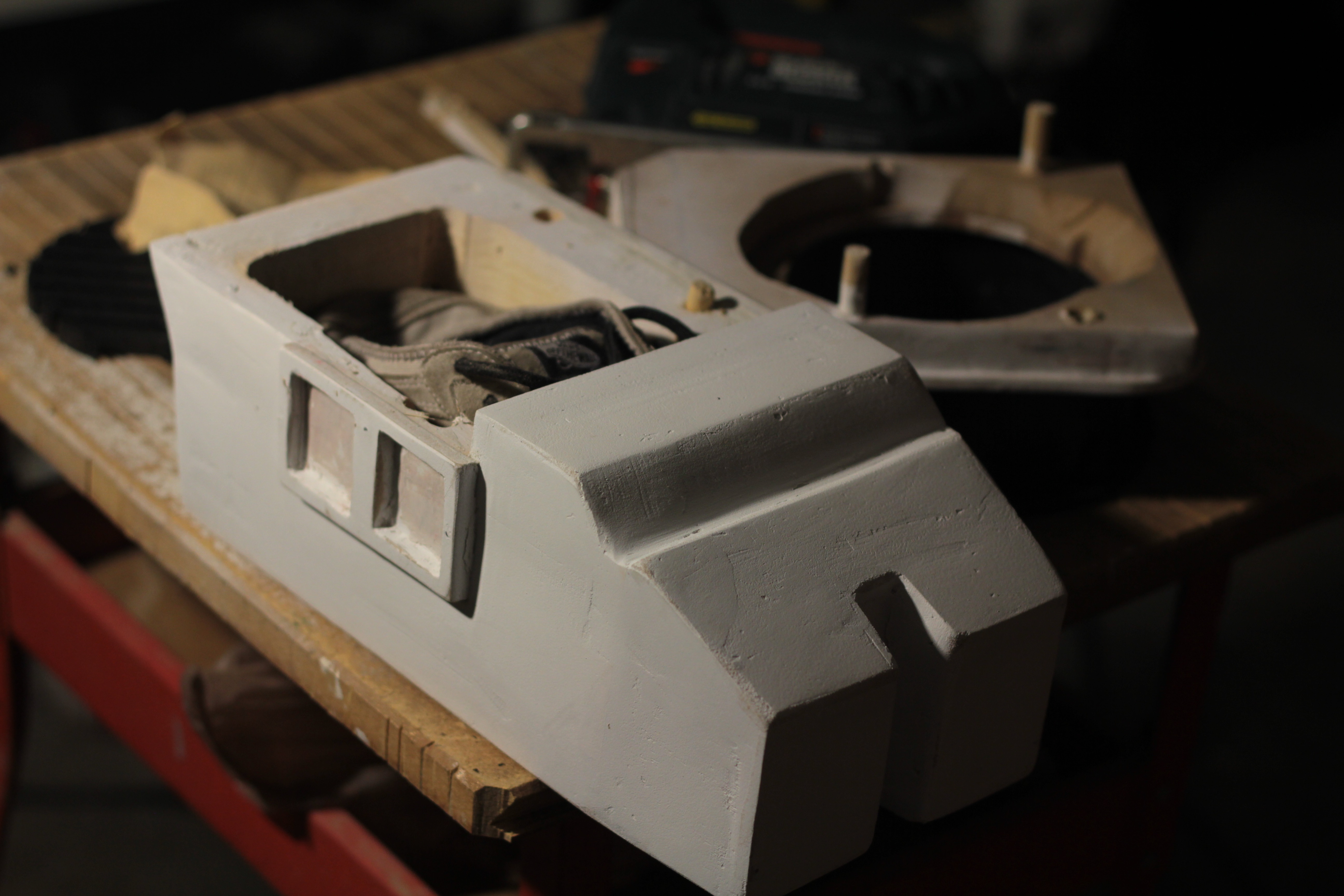

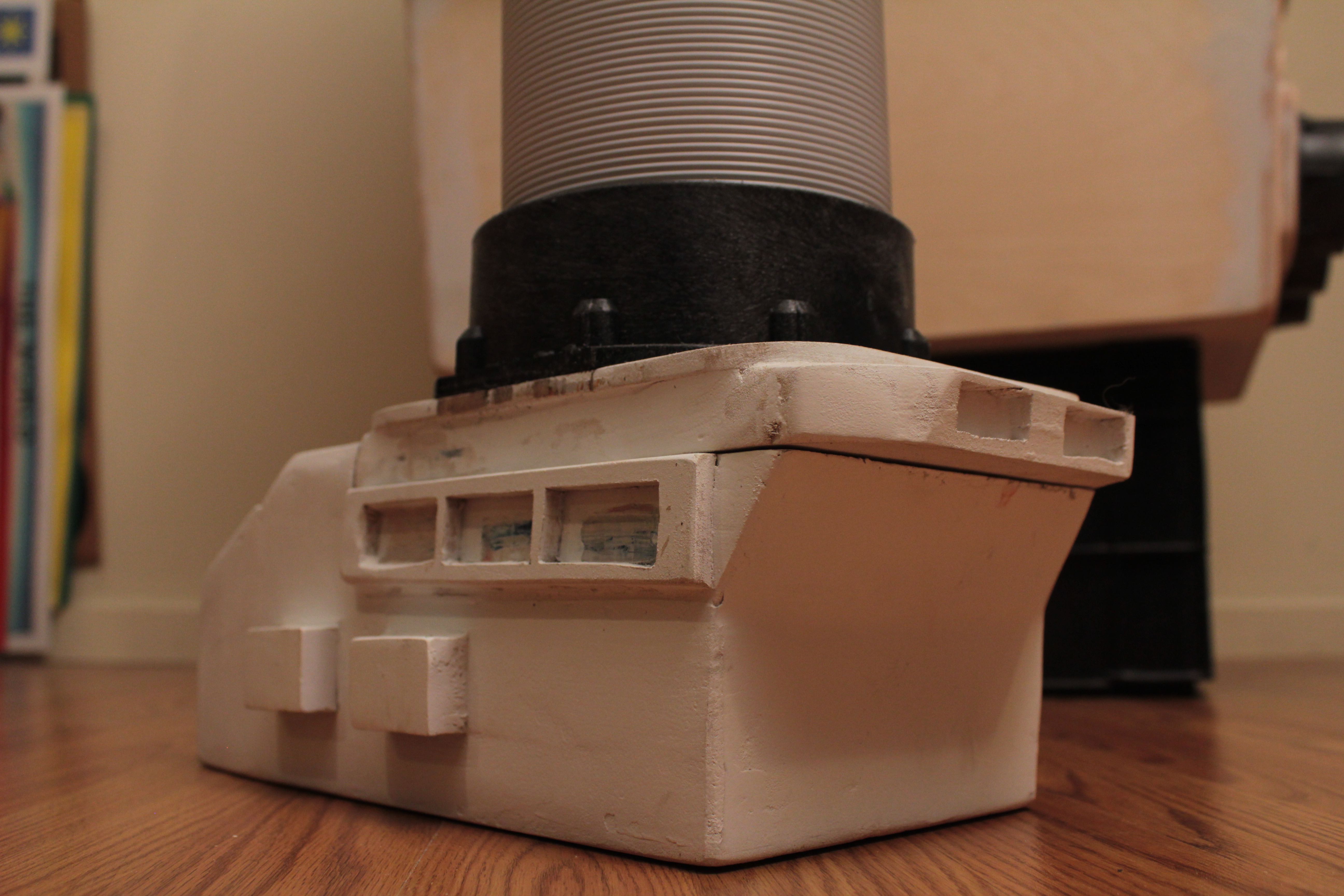

I hate the foot I've built. It looks too cartoonish compared to the rest of body so I'm considering this a prototype. The film's feet are curved and have small inset details - hard to accomplish with wood for someone lacking in fine carpentry skills. My detail is raised (except the back of the foot) to at least give the impression of what's suppose to be there. Also, I need to make them solid enough to put my foot in and walk around.
As for measurements: The length (heel to toe) is about 31cm and height (bottom to base of black leg collar) is 13cm. Width is 15.25cm. I think I mentioned earlier that I took your plans and roughly increased everything by 10% so that I can just barely fit and wear it as a costume. The foot had to accommodate a size 9" shoe so I can have a little snug control while walking. Even 10% bigger than the real foot I can barely contort my own foot and was experimenting with a removable top so I didn't have to struggle to fit. That's why the earlier pics have pegs in the wood but I think I've eliminated the need for this.
I settled on a 5" (almost 13cm) leg diameter which I had to order off Amazon because 4" and 6" seem to be standard in the local hardware stores.
I'm going to match this foot with another to have something presentable sooner rather than later but eventually I want to completely redo it. To my eye the length looks right compared to the body but it shouldn't be as high...might be a 1/2" -3/4" too big to be totally accurate.

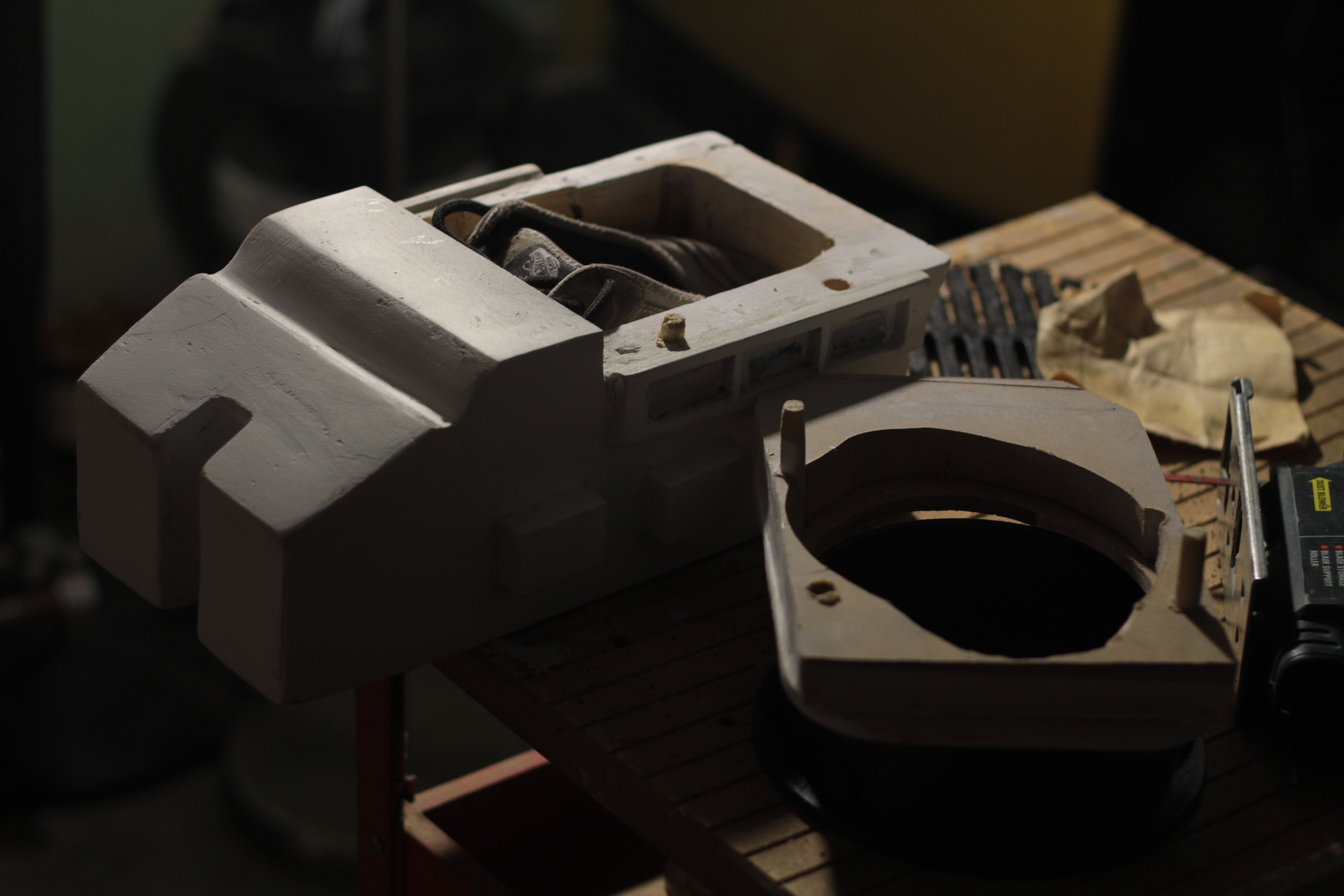

This is a nice stab at the feet that I made for my 1:12 study model ..
I think getting the top curve is an important detail over all.
They may be a tiny bit big, I erred on the side of stability and the toes are more rounded over on the real ones i think.
I have a couple of better pics of the real ones I'll post later :)
