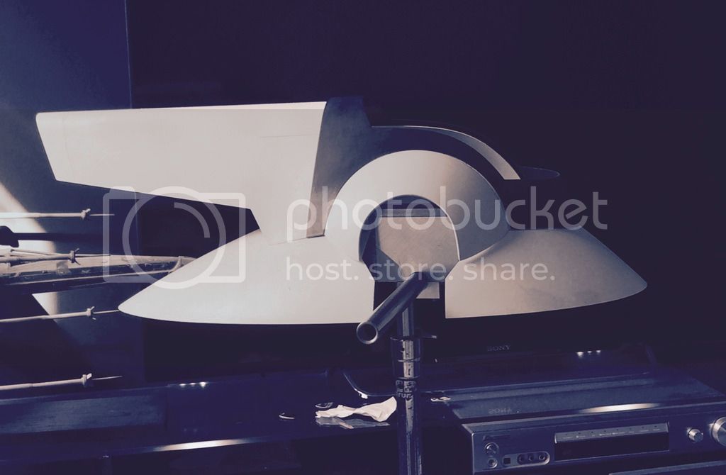

This I'm now calling the mad Panda !! Todays efforts in parts roughing in. Its def a testing build
It's looking awesome. Great work. Only the nose seems not to be aligned properly... it looks a bit... twisted... ;-)

Saw another one of these in the flesh the other night, the tiles were a different colour though! :lol You don't really appreciate the size of this thing in the photos, it's huuuge...
Cheers all, I can tell you this the head scratching that Ease must of done building this must have been huge. If I can get it half as nice as the original I'd be ecstatic

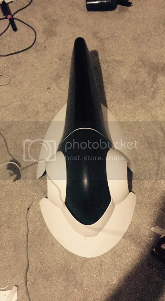

My first big headache is the 1.5mm pulls in black have kept they're thickness at the top of the hull but are perfect at the skirt end so, I think it's best to stick with this rather than go too thin at 1mm but I can sand it slightly to get a closer result. Also I think they pulled everything straight off the Buck where as I've added trim lines so have to pull over a pull or could spend a lot of time filling and cleaning up. Though this will cause a slight deviation but it's worth it having the trim lines as cutting this accurately without would take an age and open up for serious errors if wrong.
My plan to make master templates that sit inside the black sheet is working so far, one step at a time and the Mad Panda will slowly come to life, loving the ABS so far re trimming and sanding

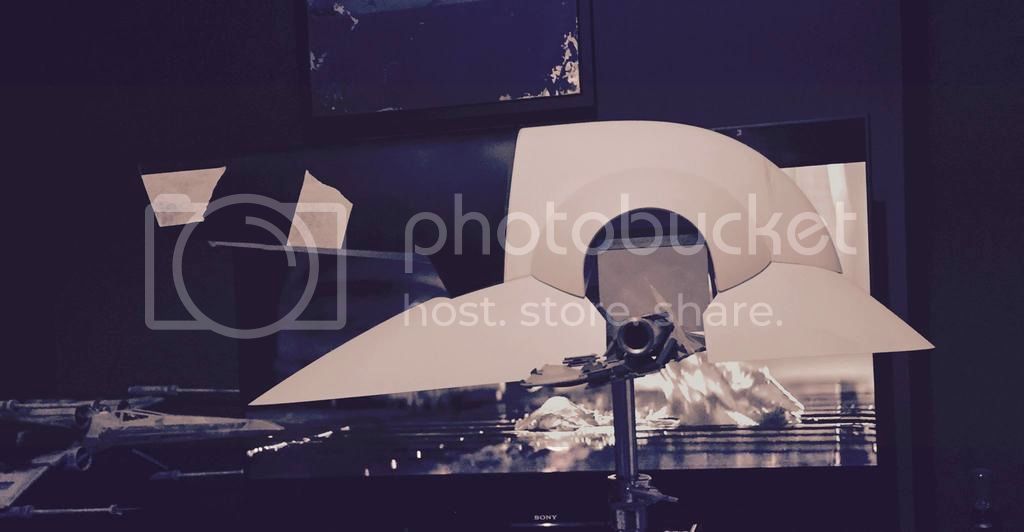

Next plan is carving up the Skirt to allow for the cockpit to be sunken slightly, I'm trying to reproduce as much as I can of the original, obviously I went my own way on mounting it all together as the vintage shots really don't show much, but they show enough to show theory...the rest is logic and a bit of forethought

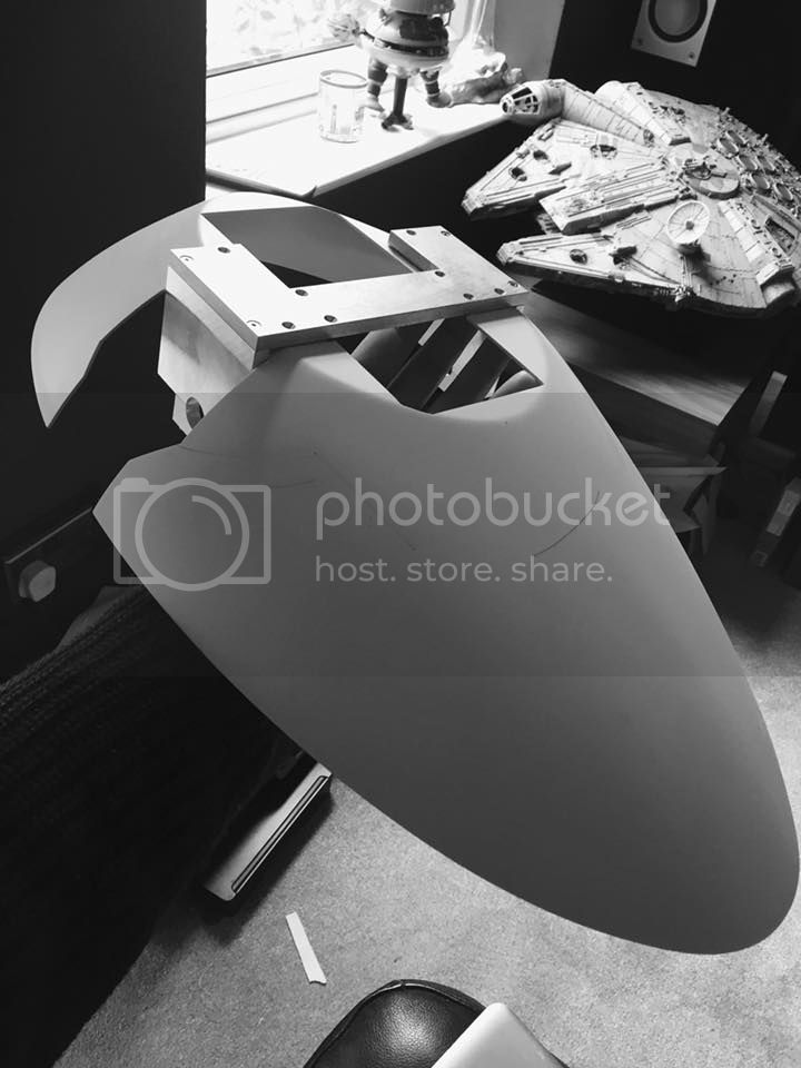

One of the huge differences about this V.4 to any previous version I worked on is the angle of the ship in relation to the horizontal, this time the ship is pointing upwards just like the original, the hole internal armature and overall design is hugely different. I would've never of got this correct position had the old one come to fruition for me. Its such an important factor to the over all look of the ship when displayed from the belly mount, so the armature position in relation to the hull was at the completely wrong angle previously.
Cheers bud, it's slowly coming together, I just wish we had more old pics to view, there's a few things that I think they did but aren't sure. Which way to go. I'll be glad when the hull is all done so I can get on with the detailing. Really have to take my time trimming the skirt plate as to re do them once it's all bonded would be hell

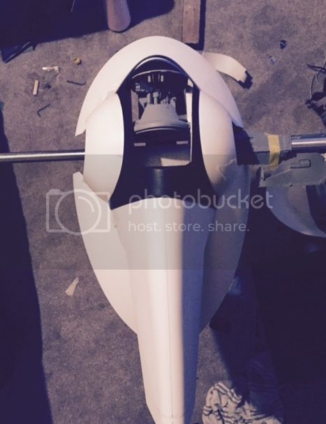

The pic with the inside of the cockpit in place brings tears to my eyes! Man, that build is epic for sure:cool
