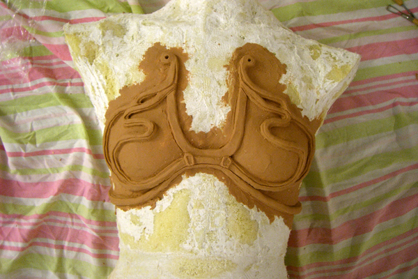

I made a plaster-of-paris-strips mold of my body, then poured (2-part) foam into that - so I had a body double. Make sure to spray a release agent into the plaster of paris mold so you can get the foam body out.
I sculpted the bikini parts onto the double (using oil-based sulphur-free clay, and some silicone chalking for the bottom half)

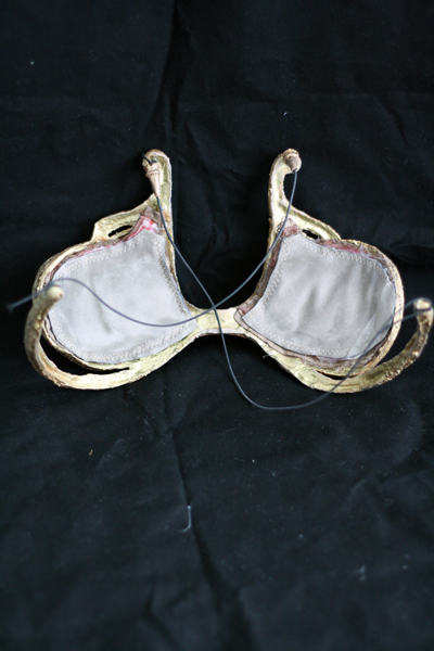

Next I casted the pieces in latex. I painted layers of latex into the mold, and halfway through filling up the molds, I embedded armature wire into the bra and bottom halves.
After that, it's painting the latex and gluing the fabric parts to it. I cut apart an old bra and cover that with the Leia fabric, then glued that to the latex frame. I used hot glue at the time, but now I would recommend using E6000 instead.
